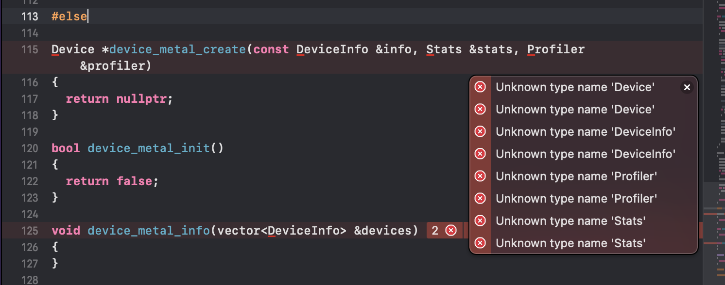

I don’t know. I got it to compile but having issues with the patches at the moment it seems.

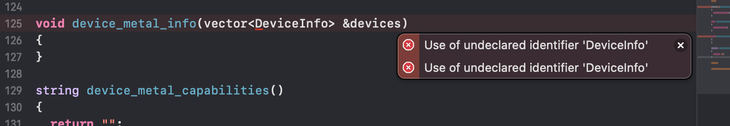

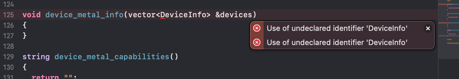

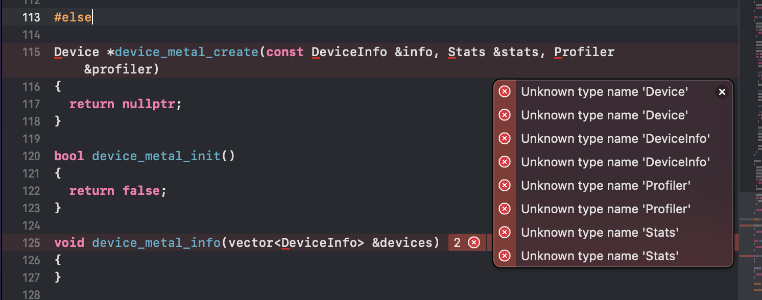

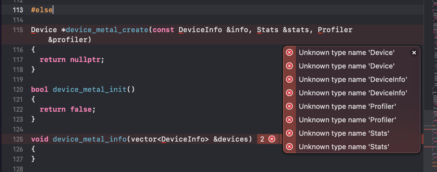

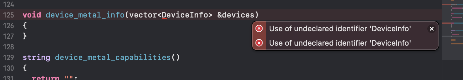

cant get it to compile with the patch.
any ideas?

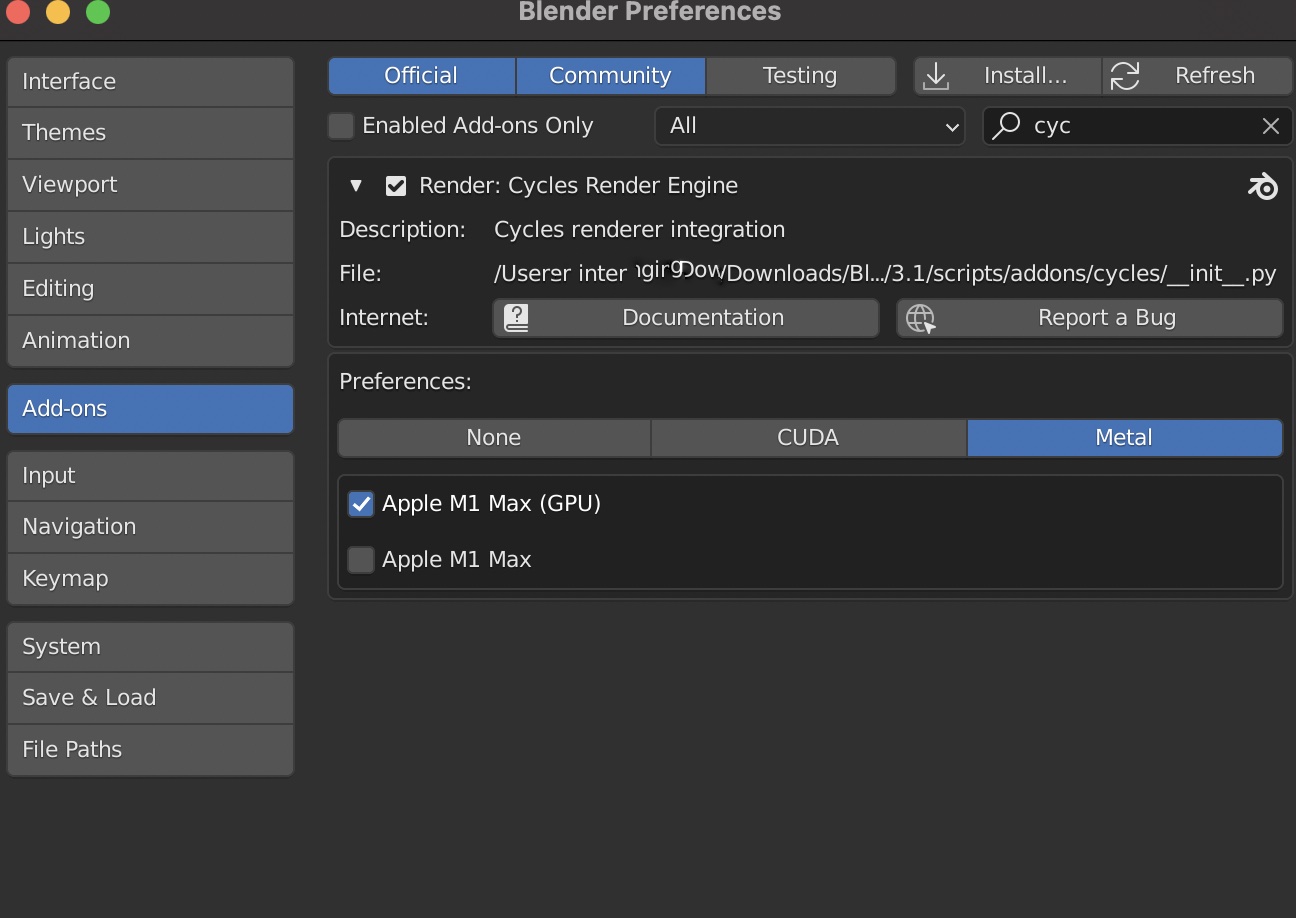

ok so got it to compile with the patch..I got as far as getting blender to load, then I had to go into the blender cycles add-on and there was a metal tab. Unfortunately after it finished loading kernels it crashed. crashes every time I try to enable gpu compute cycles.
but here is the window that gave me hope up until that point..

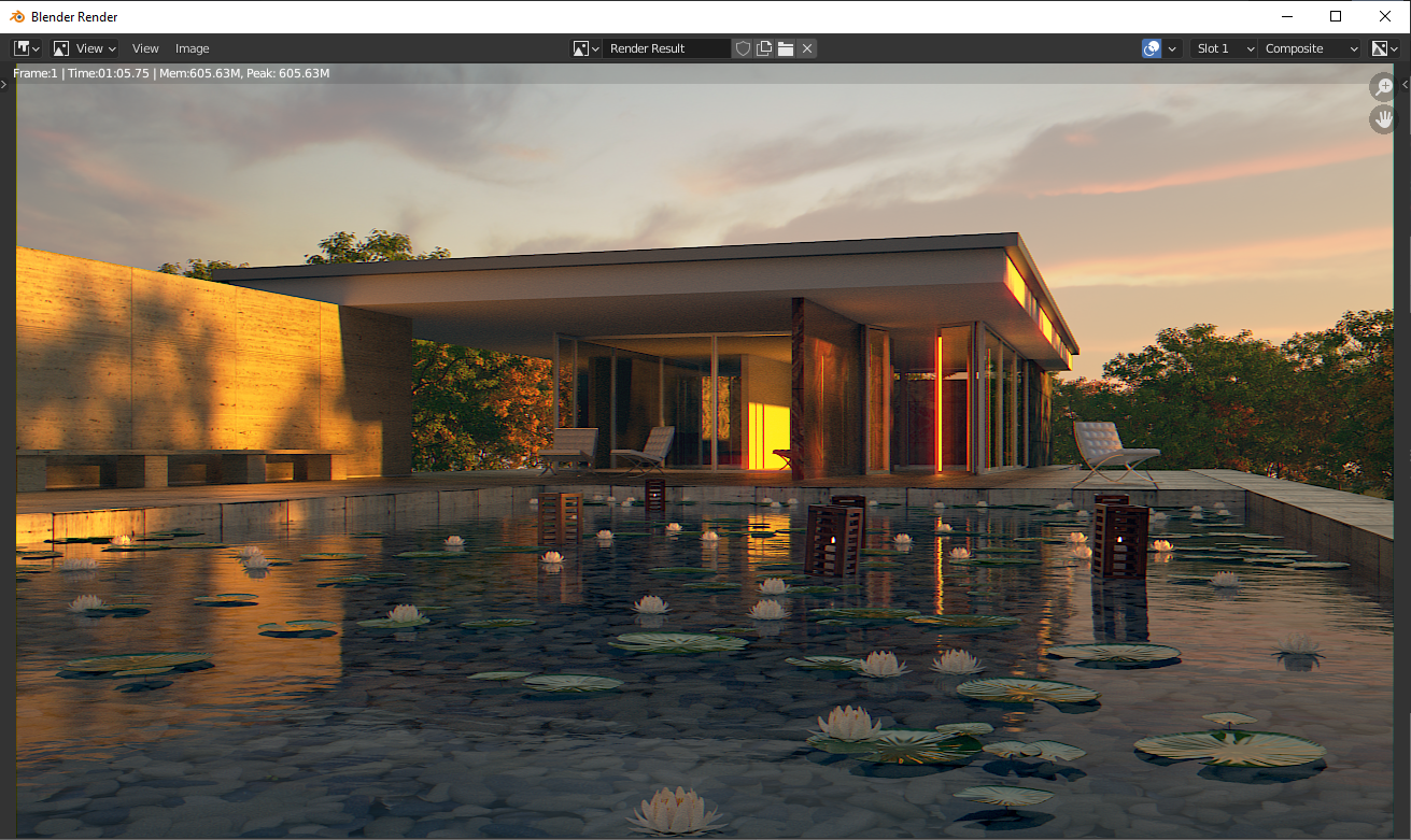

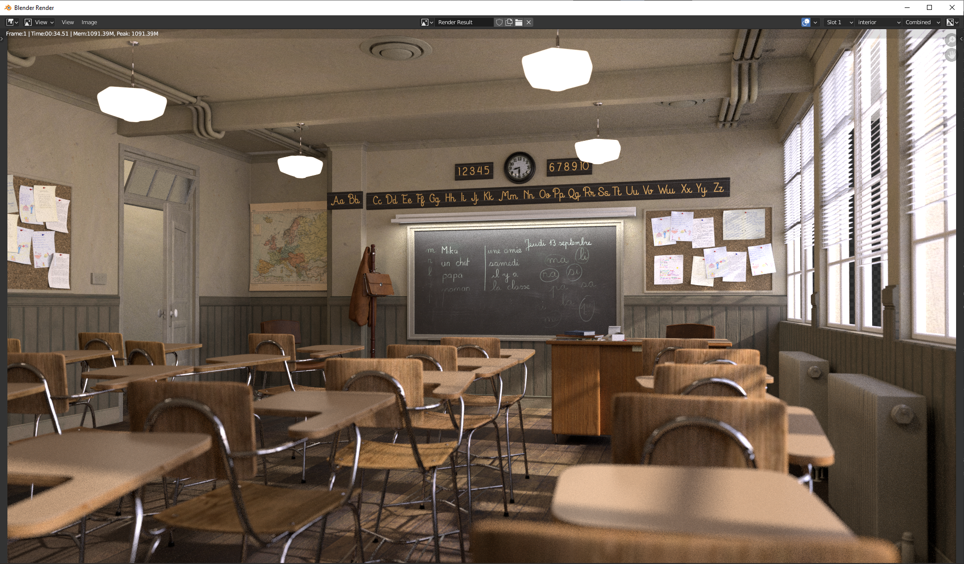

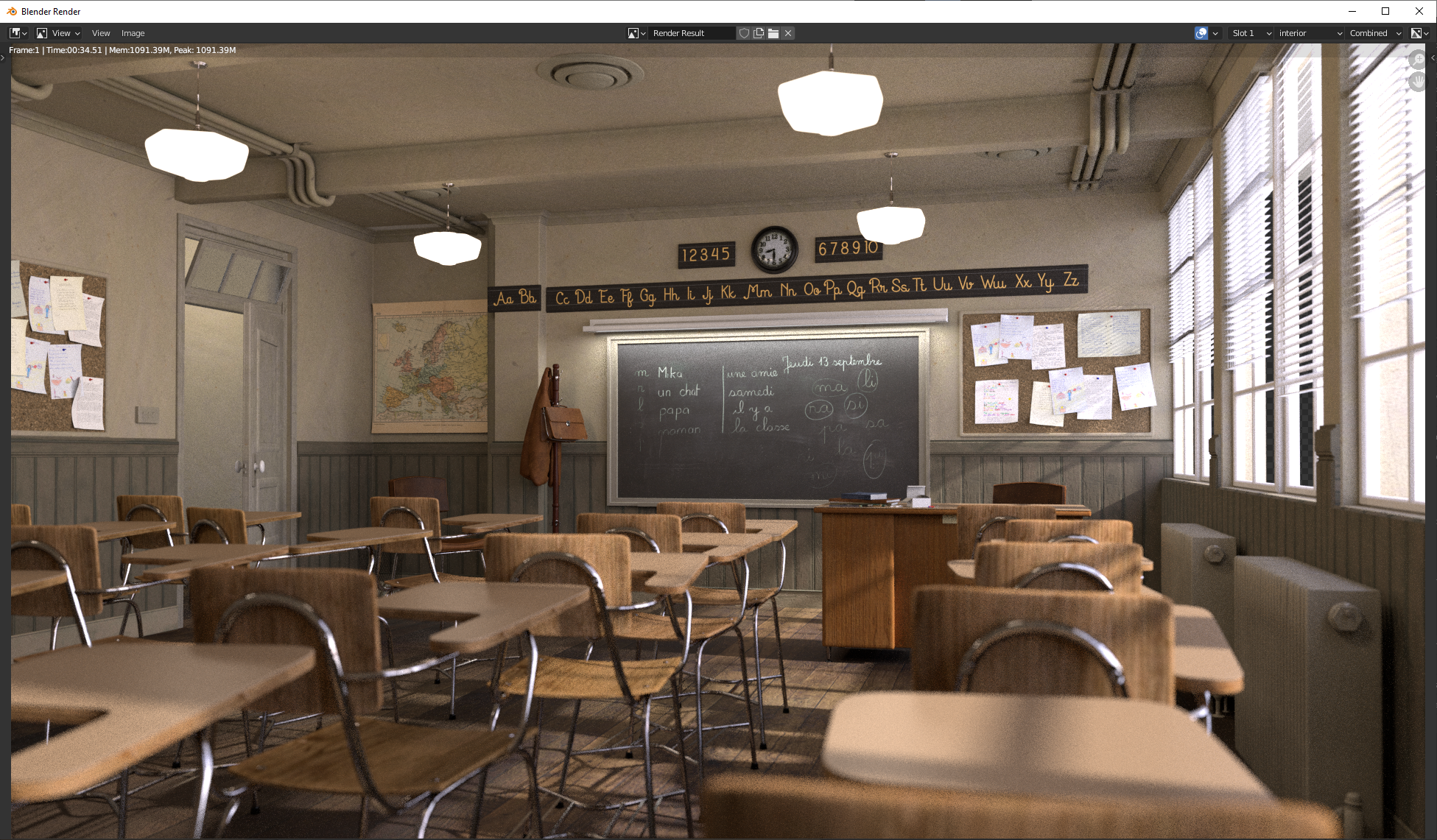

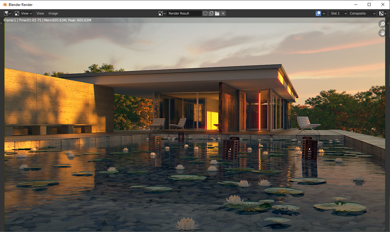

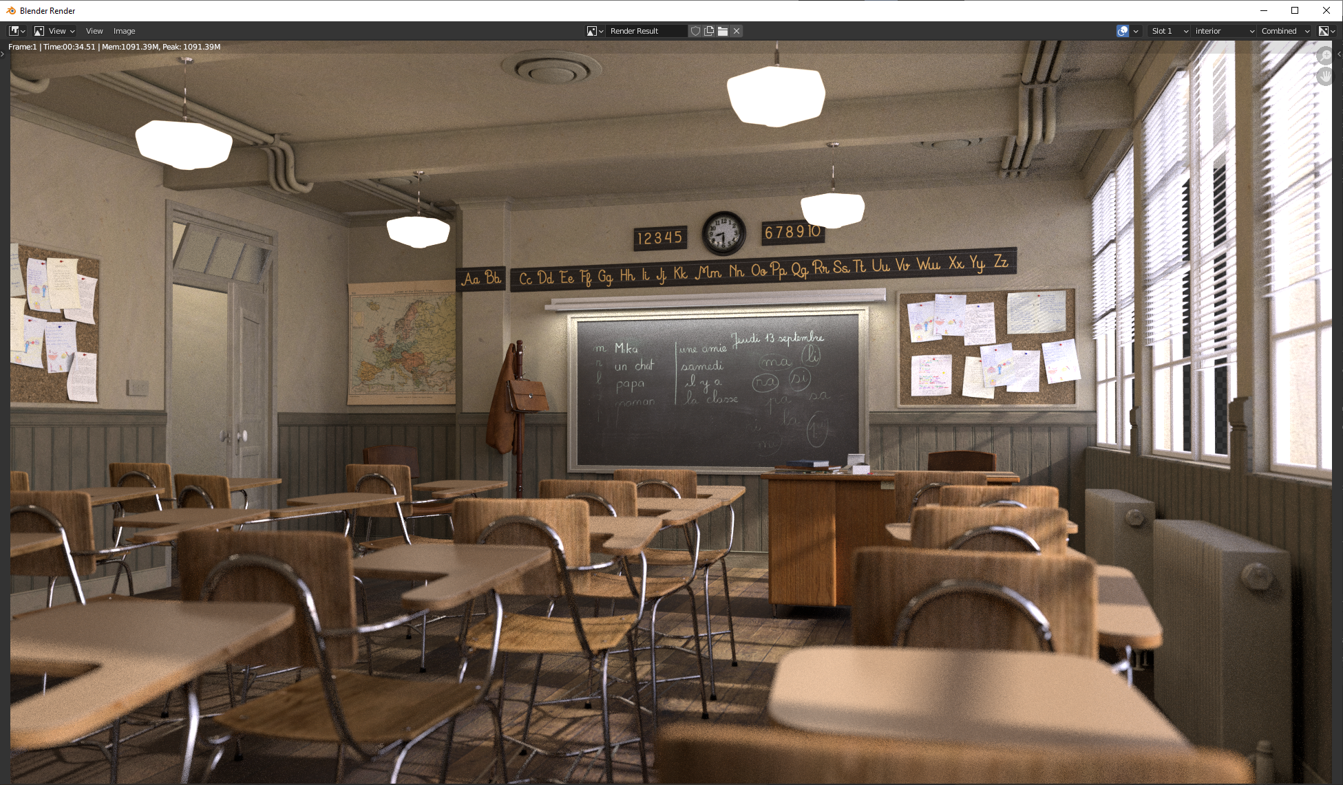

Classroom 34.51s

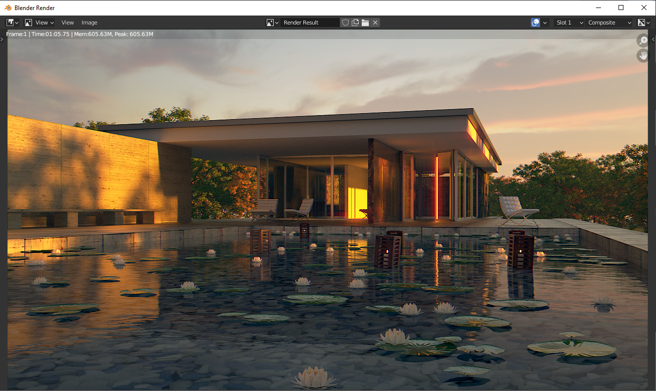

Pavillon Barcelone 1:05.75m

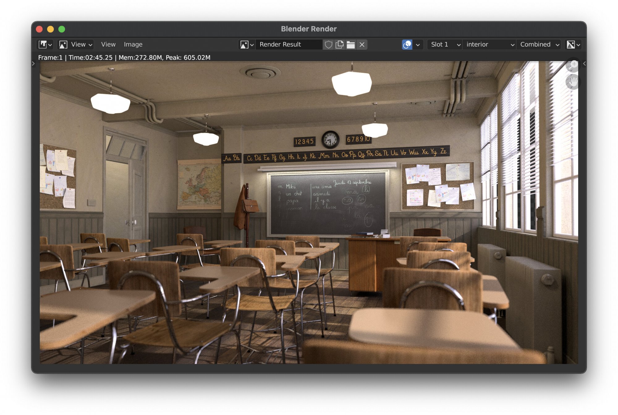

M1pro with early metal patch, GPU and CPU. Not too bad only 5x slower than the 6900 Xt but also 6 times less power as package power draw was like 53 Watt.

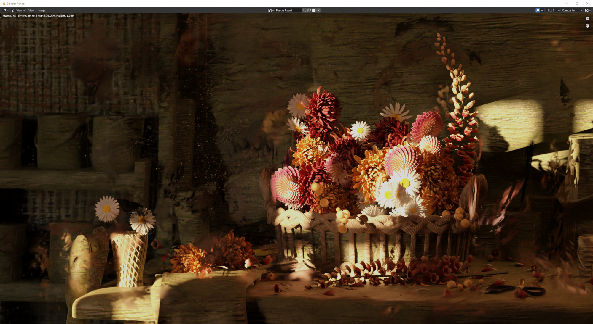

Furthermore, the non-default settings influence render times. And, disabling denoise and noise threshold not only make the render results look terrible but also make the AMD render times about 38% worse on Sprite Fright render demo.

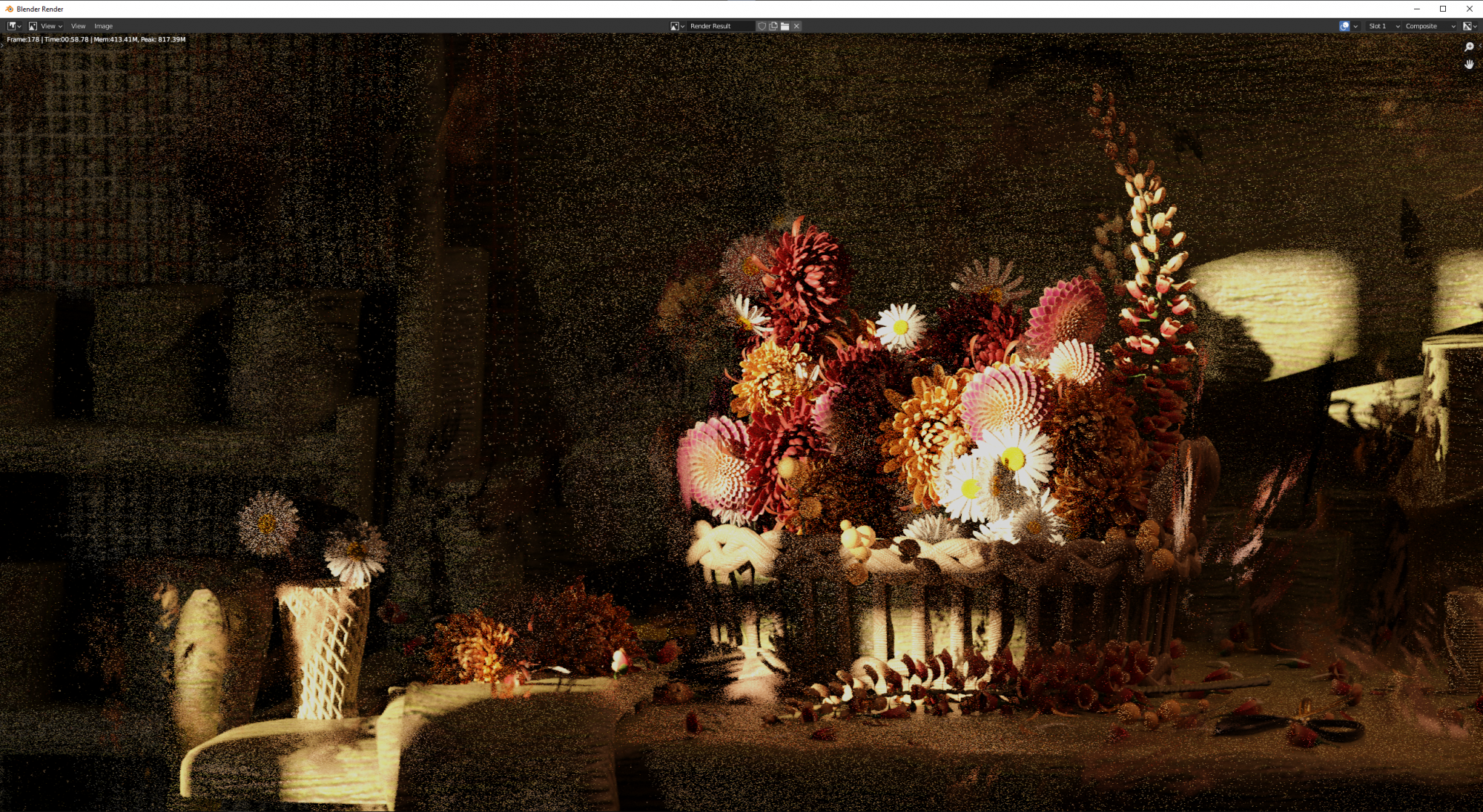

Still Life denoise and noise threshold enabled (open full screen to see noise free)
Still Life denoise and noise threshold disabled by Techgage for whatever reason (open full screen to see excessive noise)

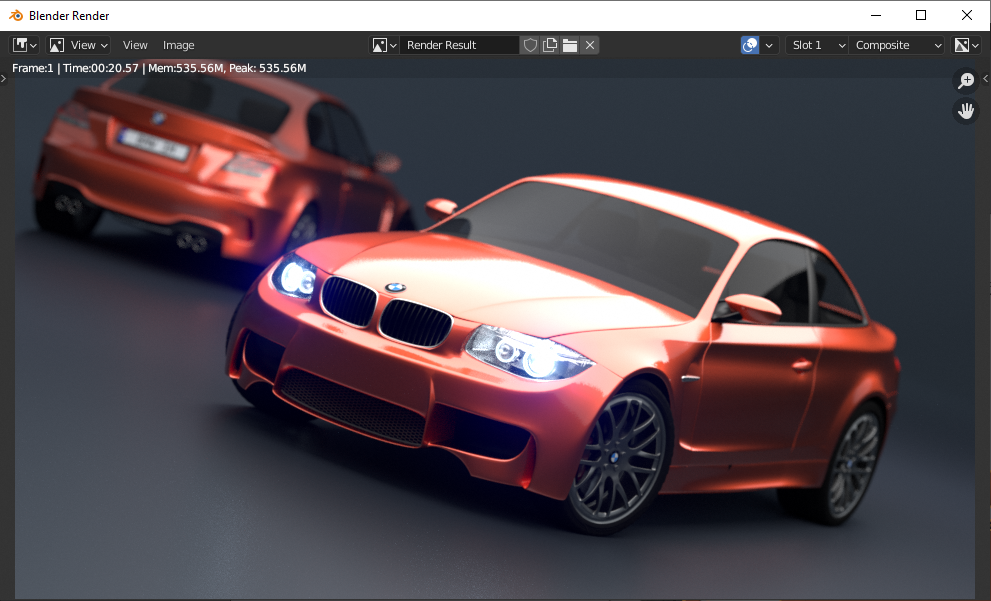

yeah im currently experimenting with the patched metal cycles version and was able to complete the bmw gpu render in 43 seconds..not bad but nowhere close to my 3070 on 3.0 running optix.
