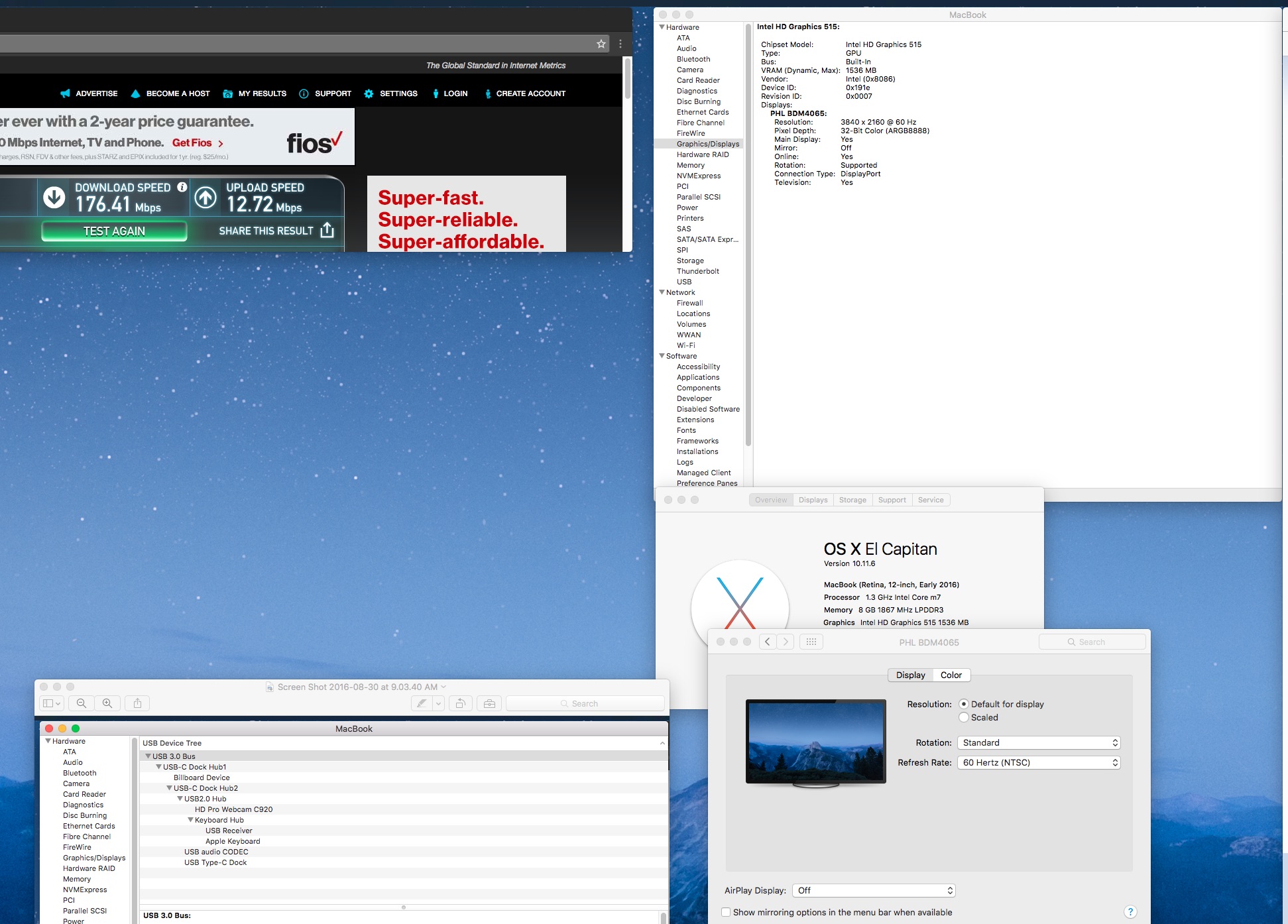

To clarify, how do you know that it runs in 4k at 60hz? Have you bought one and tested yourself?

WoW nice! Does the dock charge MacBook while hooking up to monitor at 4K 60hz? Also, do you notice if your MacBook getting warmer whU outputting4k 60hz?
Charging works perfectly while docked. It does warm up after about 10 mins (maybe less) of some video or browser based games but it also gets warm in those same situations when using it standalone.
Thanks! I just pressed the "buy" button from a local online retailer.
By the way, do the other ports on the dock work? Ethernet port? Usb ports?
USB, audio work just fine. Ethernet I had to install the following driver:
http://www.cypress.com/documentation/software-and-drivers/ez-usb-gx3-software-and-drivers
It was listed on the Acer support site for Windows, figured Mac would need it as well
Interestingly, it seems like the Kensington Dock is using the same chipset (I also bought that but was unsuccessful with it). The Kensington dock seemed to use the same driver as well.
Thanks for the info! And May I ask what monitor/TV you're using this dock with? And you're connecting it through the display port right? The HDMI port on it isn't 2.0 though I believe.
Philips BDM4065UC 39" 4k connected via DP
