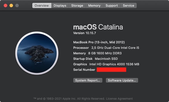

I have the MacBook Pro mid 2012 (non retina)
Which card should I find for that model to have 802.11ac and do i need some adapter?

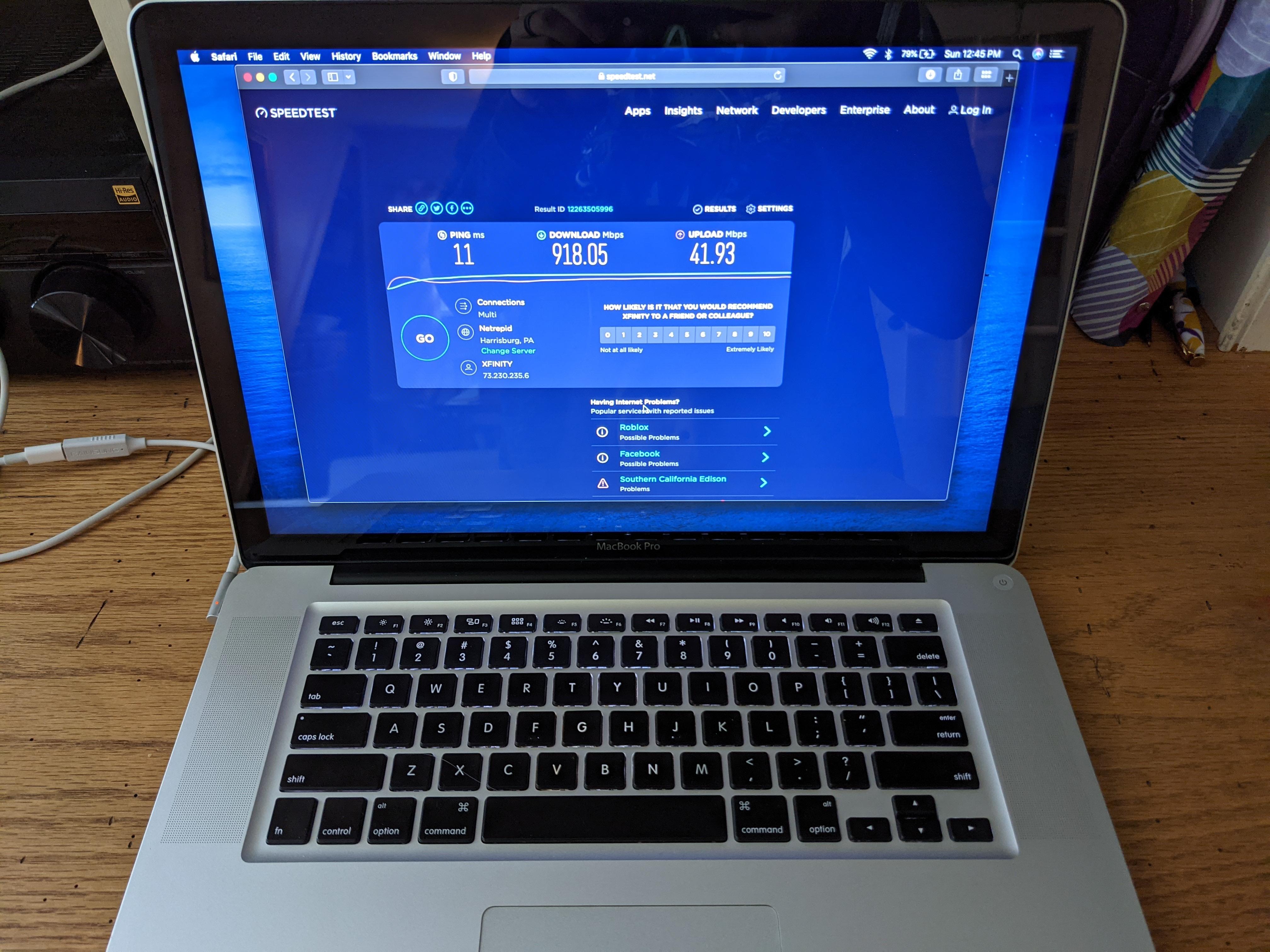

Hey guys, just wanted to post that I ordered the adapter kit from intriguing Industries linked earlier for my 2012 15" Unibody and it works perfectly. Shipping was about 10 days from the UK and the price was very fair. highly recommend!
