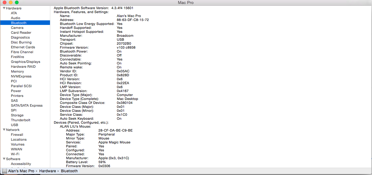

try contacting user macvidcards on this site or get support from them directly.I ordered a pair of BT4/ac cards from MVC and installed them into a Mac Pro 5,1 and a Mac Pro 4,1. The Mac Pro 5,1 worked without a problem, but the 4,1 is acting up. The 4,1 is not recognizing the card as an Apple model the way the 5,1 is. It knows that it's a Broadcom card, and it can use the wifi and the bluetooth, but none of the advanced features are enabled. No low energy, and so no handoff etc. It's reporting as Chipset: Unknown. Any suggestions on how to sort this out?
