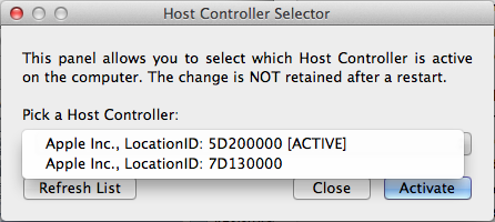

I launched Bluetooth Explorer and selected Utilities > HCI Controller Selector. Opening the dropdown revealed this
I selected 7D130000 and clicked Activate, but the new HC wouldn't activate. The old one stayed activated.
Right. Time to get serious about pulling out that old BT card.

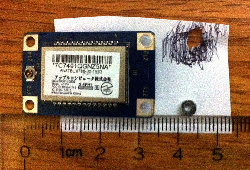

Thinking the factory might have used an adhesive to keep the screw in place, I gave the screw head a shot of heat using the tip of soldering iron. I heard a small pop as the screw expanded. Tried using various tools to turn the screw, but no budge.
Next I decided to try drilling out the head with a 5/64 bit and inserting the smallest screw extractor I could find (EX-1 by Irwin Hanson). I was not keen to risk metal shavings flying onto the motherboard so a) I used a slow speed, and b) I cut a small piece of paper with a hole positioned over the screw in order to catch debris. The drill bit was magnetized so, at slow speed, it did a pretty good job of holding onto shavings. I also carefully vacuumed the area immediately after drilling.
The extractor was the right size, but I still couldn't get the screw to budge. Dang!
In the end I ended up drilling the screw until the head popped off. The head landed on the piece of paper when I pulled back the drill so was easy to retrieve. The BT card lifted up easily. That screw post will never be usable, but if for some reason I ever had to install a card in the old location, the other screw post is clear. Obviously it only requires one screw to hold the card in place.
Booted up the machine and the new card activated as expected. And, with no old BT card lurking in the system, I expect trouble-free performance from here on.
I've seen more than one user comment on stripping screws while trying to remove the old BT card. Maybe this tale will help you solve the problem!
