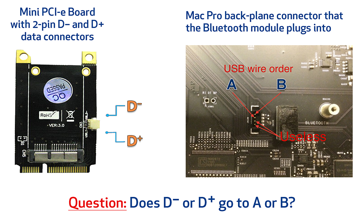

Anyone able to confirm which pins on the back-plane connector go to the D- and D+ pins on the mini PCI-e adapter card? The connector on the motherboard sits vertically, and the D- and D+ wires from the mini PCI-e adapter card are supposed to be connected to the two top pins, but I can't confirm whether the D- connects to the top or bottom one, and vice versa for the D+.

Looking at my wiring configuration. Data positive corresponds with wire "A" as seen in the OP photos and data negative corresponds with wire "B".
Went thru this entire 28 pages on this posting and found the answer to my question on page 9, post 221.
D- goes to the top pin on the original Bluetooth connector on the backplane (the connector sits vertically).
D+ goes to the 2nd pin down.
