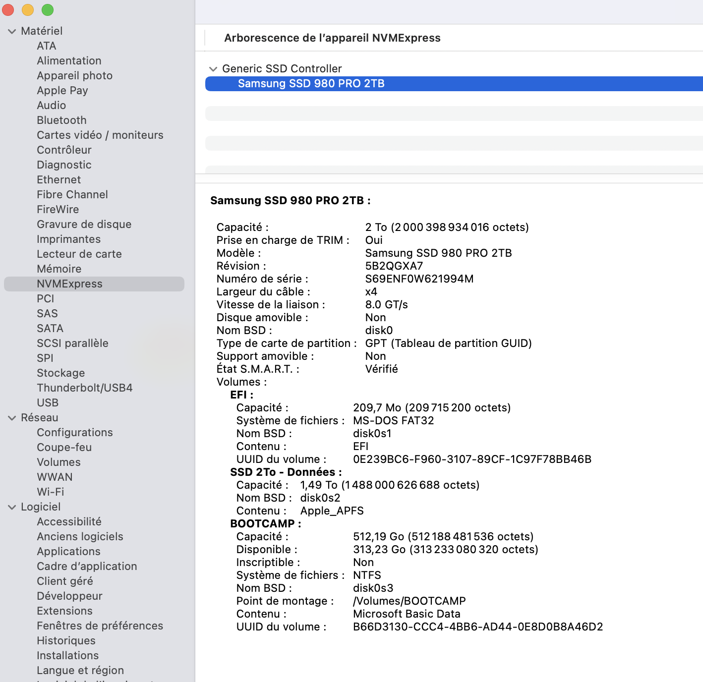

hello,
Sharing data from an iMac I've just bought
Blade only - no Fusion Drive
Device: Retina 5K, Early 2019 - (i9-9900, 3.6 Ghz - Vega 48 pro)
Blade upgrade: 512GB -> 2 TB Samsung 980 pro
HDD upgrade: N/A
CPU upgrade: N/A
Speed test: 3076 MB/s read, 2964 MB/s write
OS: Sonoma 14.4.1
Adapter: unknown
Heatsink: unknown
Issues after fresh OS install: the sleep issue is present, bootcamp working fine
I attached NVMExpress data

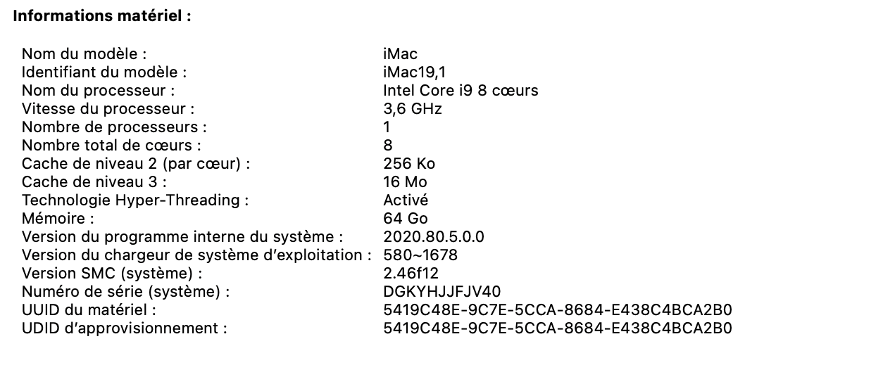

thks for your reply
i do see this in the system
the SSD FW version is :5B2QGXA7
