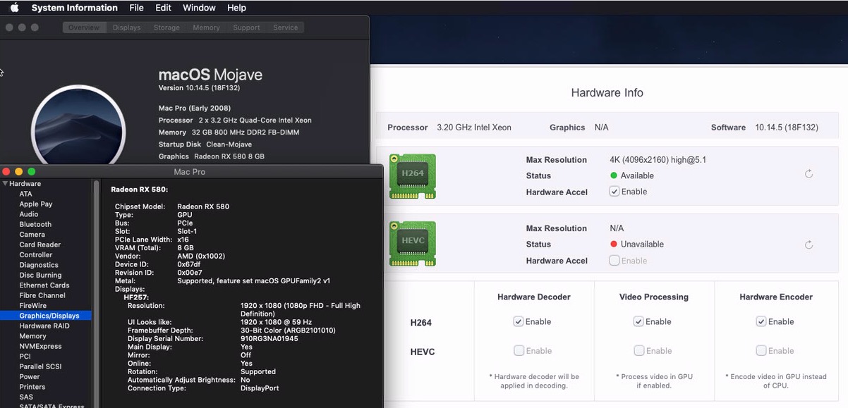

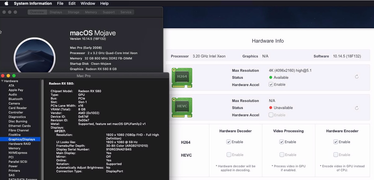

Yay! finally got this working in the 3,1 with a RX 580.
AirPlay doesn't quite work yet though, not sure what magic sauce is missing there.
The AppleTV goes black like it should get an image but nothing ever shows in Display Prefs for the second display.
Thanks for the confirmation that this mod can work on 3,1.
Airplay not working is a known issue. This function require HEVC hardware encoding, which we still have no idea how to get it work yet.

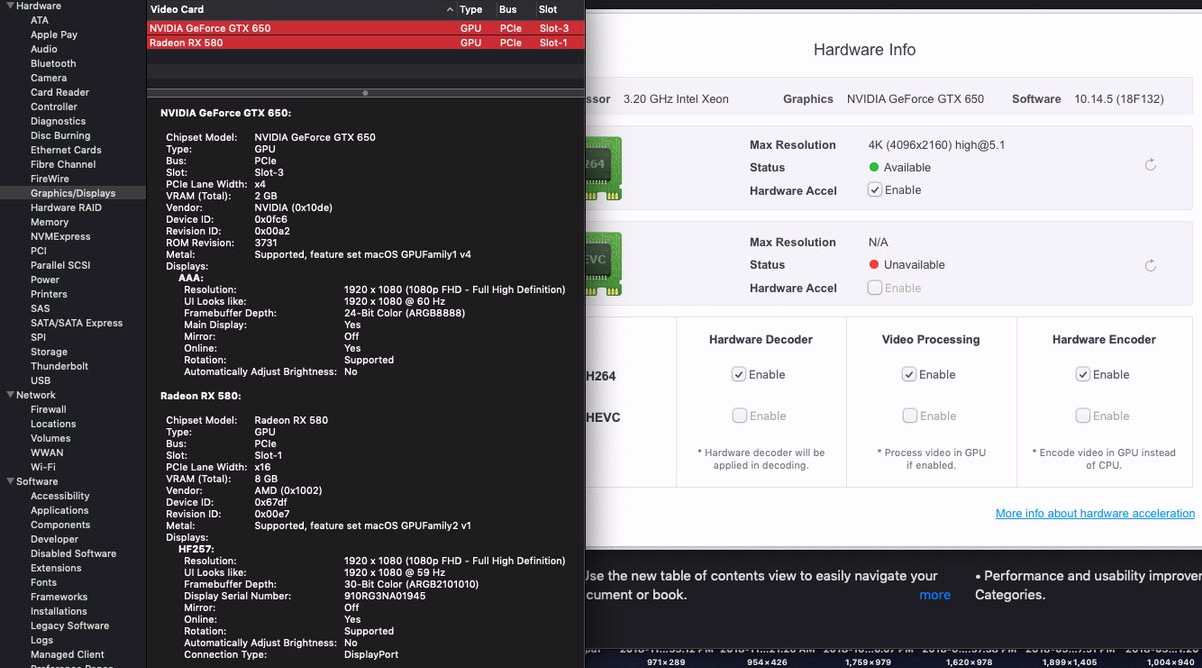

While this may venture slightly off topic ... tried running both GTX650 and RX580 (testing for boot screen retention).
VideoProc seems to be able to leverage the card, but the display attached to the card doesn't work to display an image (black screen).
It is, however able to be used for VideoToolbox H264 encoding, a test of a 1080p source video encodes around 20fps using an appleTV preset using CPU, but is around 65fps and GPU processor is reported at about 50% usage for the 580. It's possible this could go faster as I was just testing this from a file located on a NAS with a 1Gbps link vs local file system.
The point being here if you want an AMD card just for video acceleration for encoding video only this works.
Note that the display connected to the GTX650 isn't able to display the HW accelerated decoded video (meaning I can't watch the jellyfish UHD videos)
Would be nice to understand why MacOS has such an issue with Dual GPUs these days, I wonder if Catalina will change anything there.
This mod sure won't able to activate any Nvidia card's hwaccel. That GTX650 has nothing to do with hwaccel, just cosmetic error same as "N/A" if no other GPU installed.
But it's good to know that now allow 3,1 to watch some demanding videos that was not playable, also has much better H264 encoding speed.
