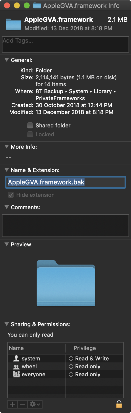

5) single click the ORIGINAL AppleGVA.framework
6) Press “Command + i”
7) in the pop up window, rename “AppleGVA.framework” to “AppleGVA.framework.bak” (the file icon should now change to normal folder icon)
8) Rename the duplicated “AppleGVA copy.framework” to “AppleGVA.framework”. (This file’s permission should be wrong at this moment, but tests shows no adverse effect. In fact, make it easier for us to mod. For beta testing, I intentionally keep this “wrong” file permission)

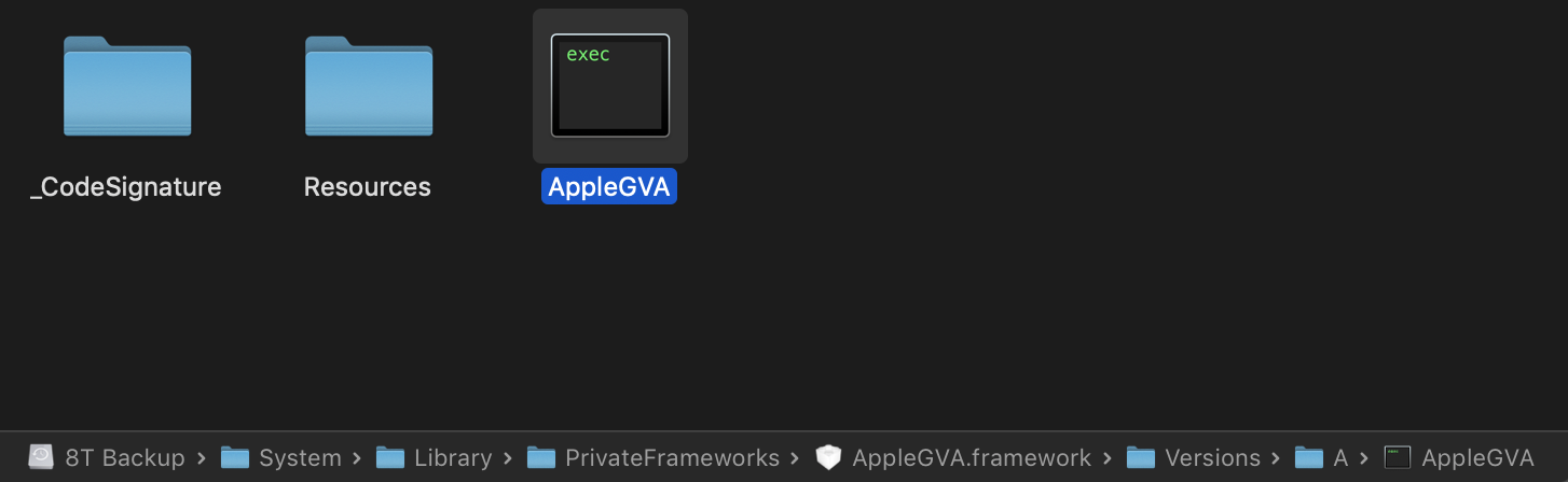

10) continue to Version -> A, and locate “AppleGVA” (this file has no extension)

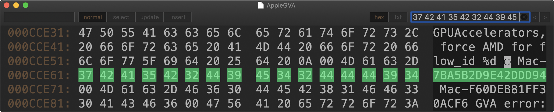

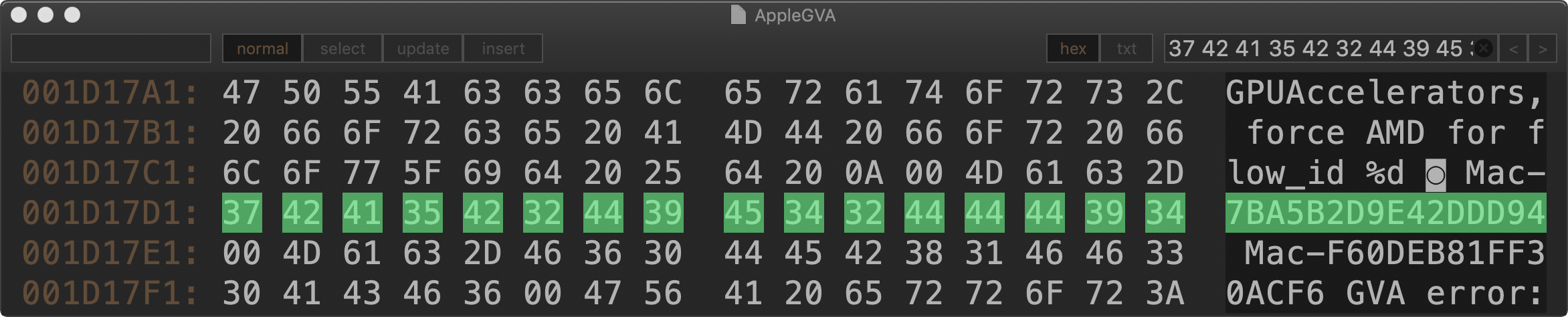

11) open this AppleGVA file with a Hex editor.
12) find 37 42 41 35 42 32 44 39 45 34 32 44 44 44 39 34 (should have TWO match result in Mojave. If you want to try this in 10.15, you may find only one result)
13) replace BOTH by 46 32 32 31 42 45 43 38 00 00 00 00 00 00 00 00 (make sure you replace the original byte, NOT insert).

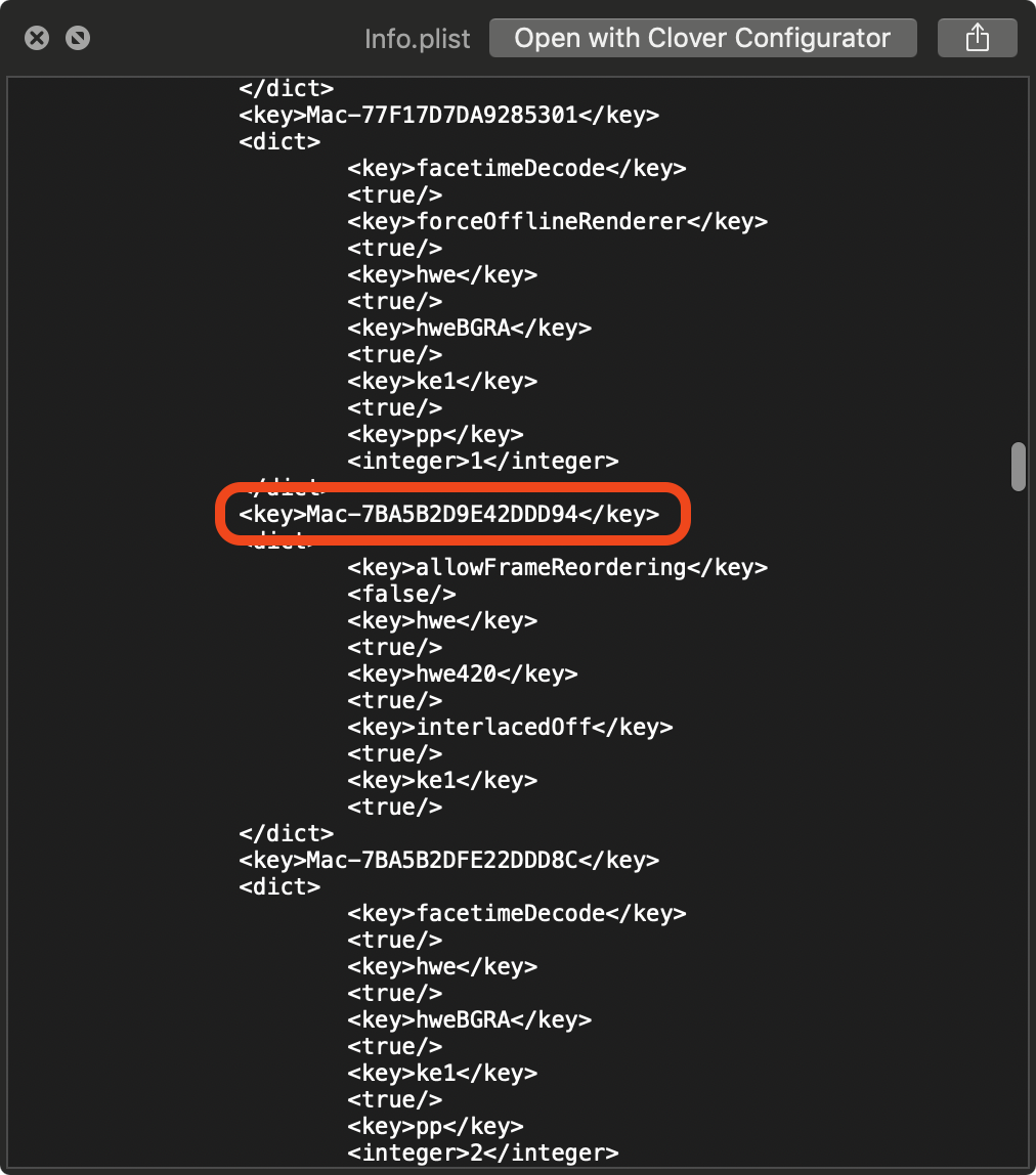

18) open the info.plist with text editor

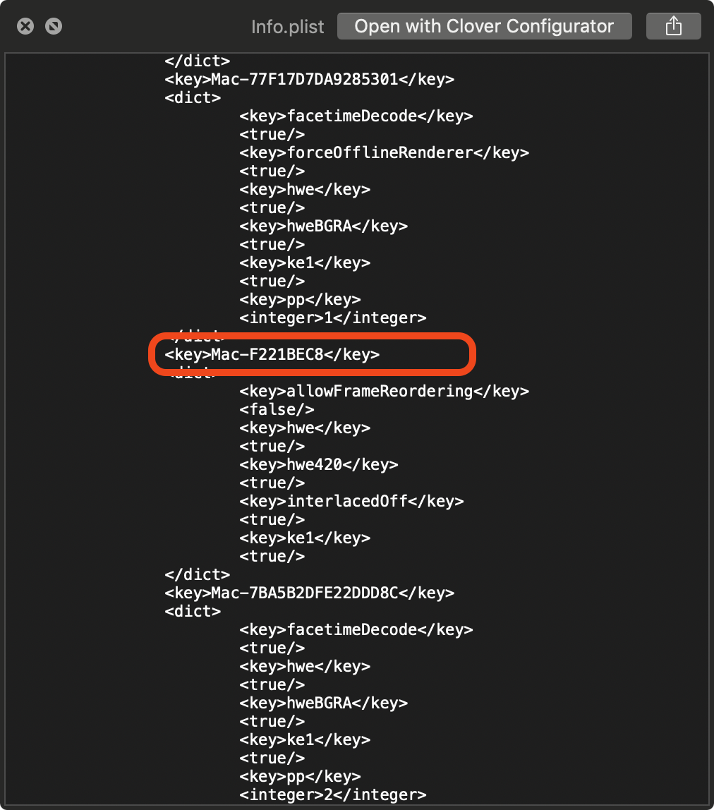

19) search 7BA5B2D9E42DDD94
20) replace that by F221BEC8
21) Reboot.
