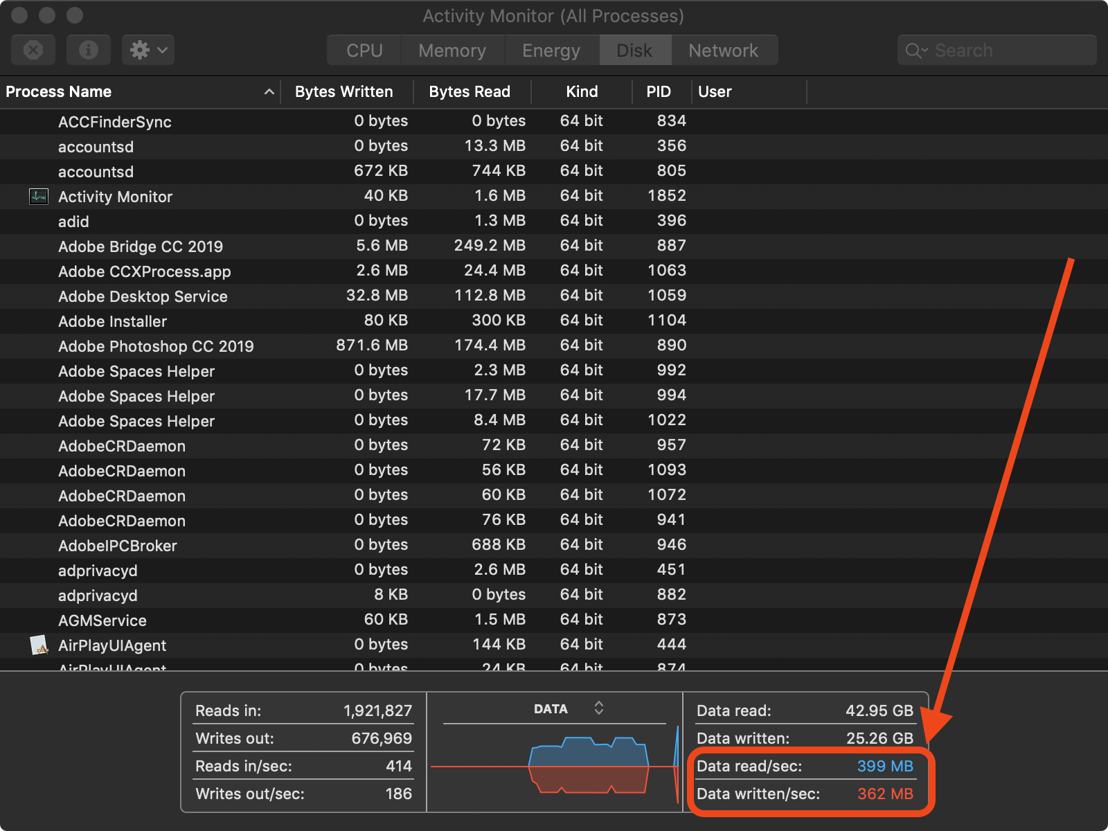

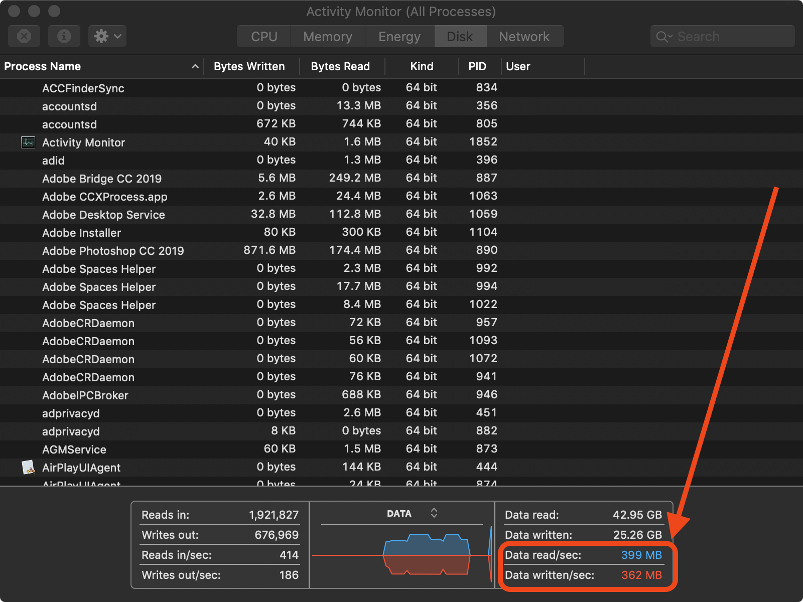

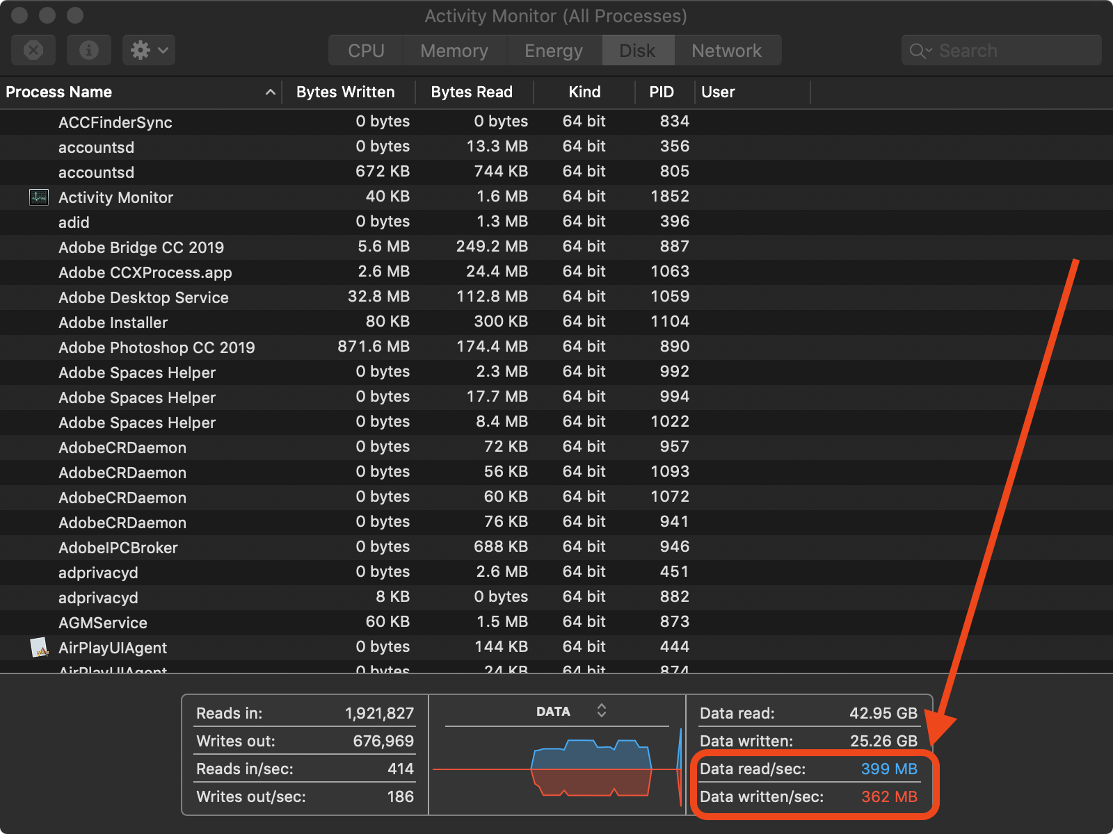

The project was on the PCIe SSD? Did you check activity monitor what’s the storage throughput when you playing the rendered timeline?
Yes, the project and the library are in PCIe SSD.
You tell me where to check the storage throughput data exactly.
Thank you.
Thank you.

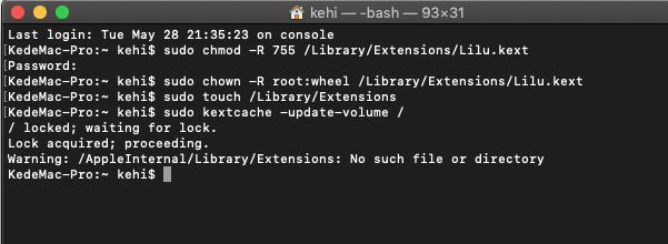

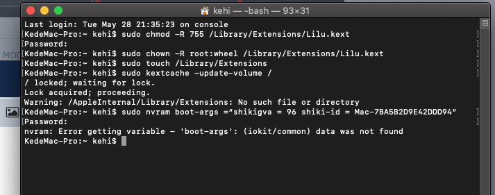

When I went to step 13, I came up with this.

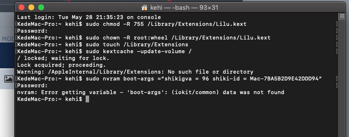

[doublepost=1559051663][/doublepost]what should I do? Which step is this problem?
And I don't understand how the first step works,

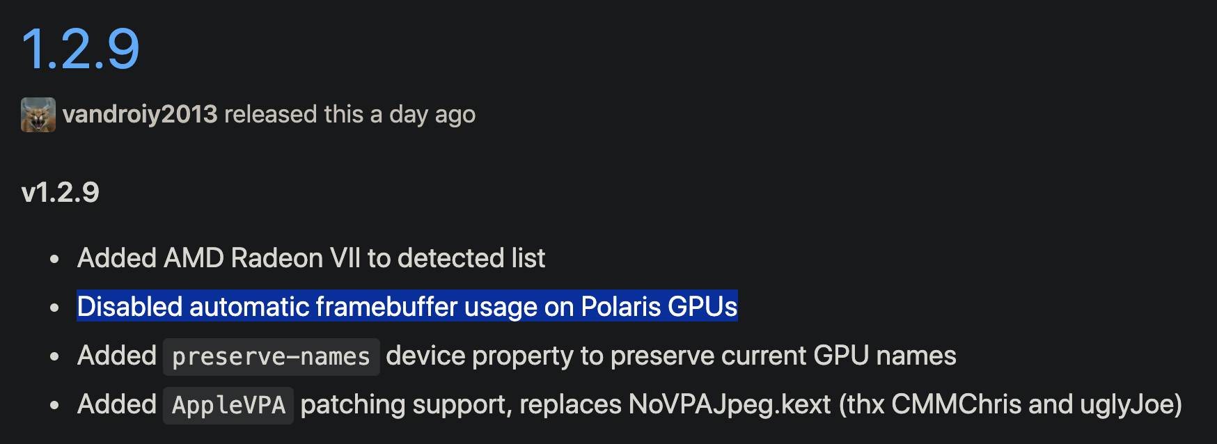

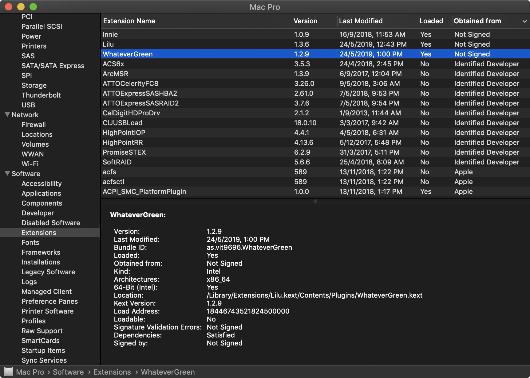

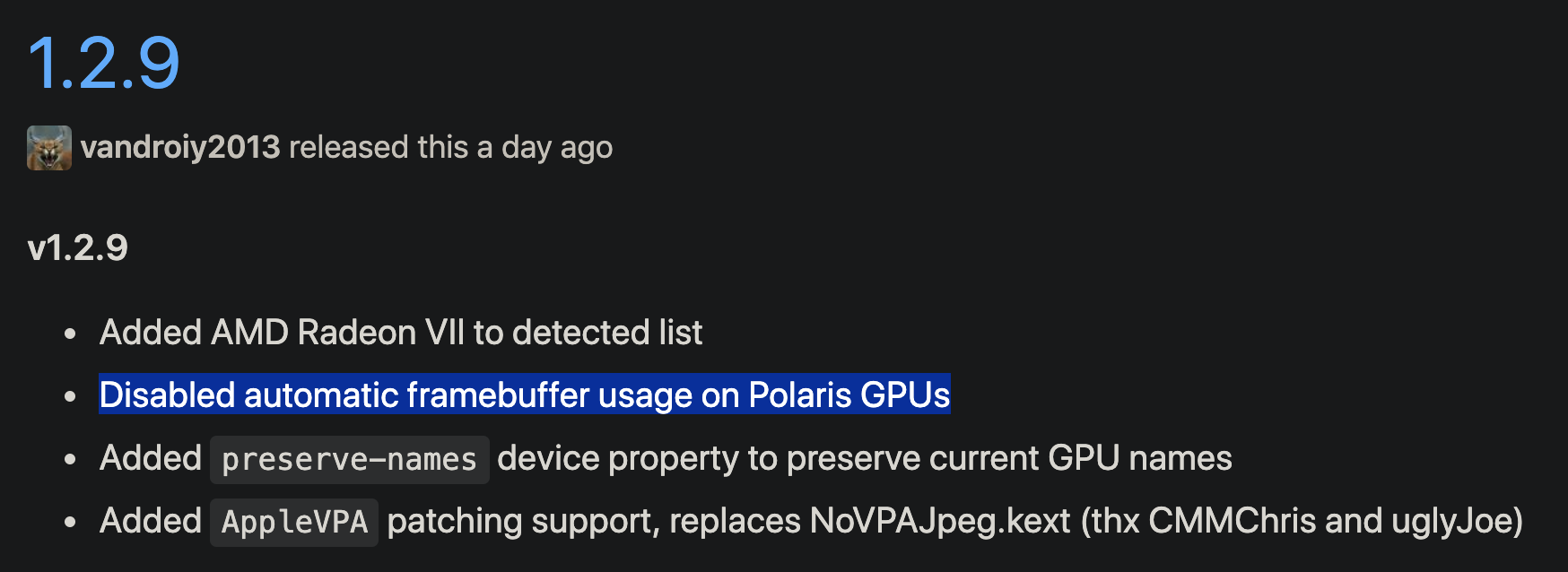

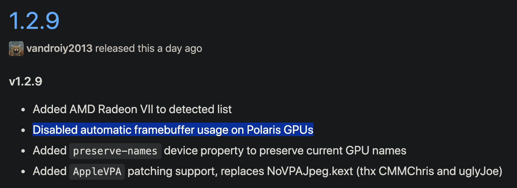

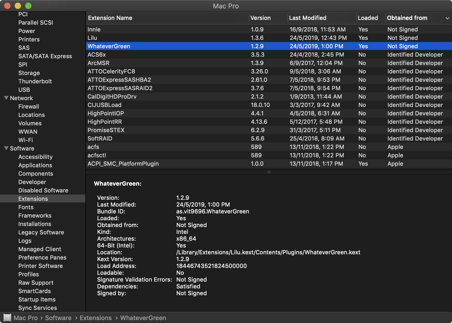

I can only say the new Lilu and WhateverGreen still works, but not sure if that make any difference on my RX580. I haven't experienced any freeze in FCPX or Preview since I found this mod.
But since there is some change for the Polaris GPU. It may make some difference.
Can confirm - using WhateverGreen 1.2.9 on an RX 580 I saw no acceleration. Using 1.2.8 I do.
when the clip has been rendered the reading is: data read between 30-65 MB
before being rendered it is between 10-15 MB with peaks at 18MB sometimes.

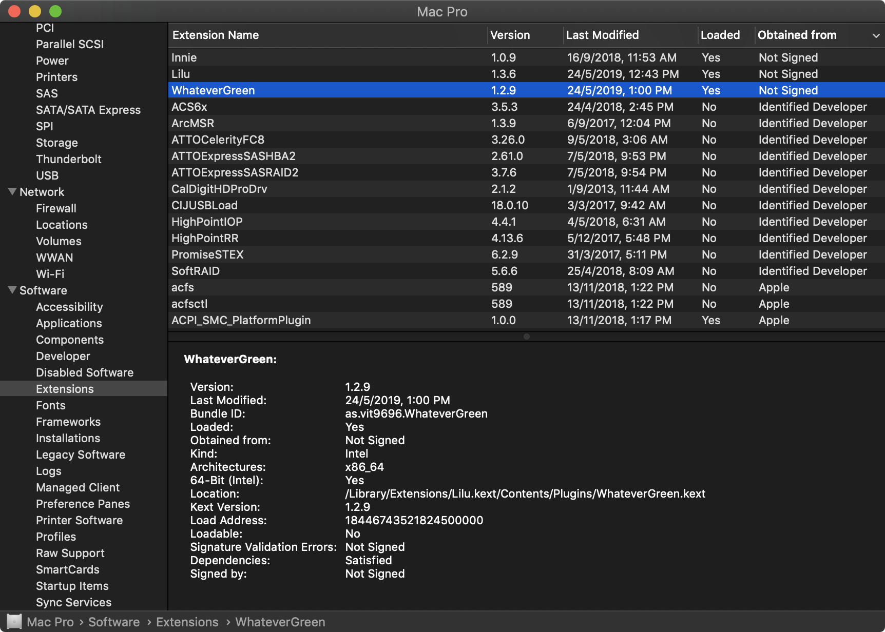

To add some good numbers here. I'm on a 2010 MacPro 5,1 with dual 8 core xeons, 48 GB of ram, an RX 5580 (Saphire Radeon Pulse) and MacOS 10.14.5. After installing Lilo (v1.3.6) and WhateverGreen (v1.2.9) I'm definitely getting h.264 and HEVC decoding but what's better (since I do a lot of video editing) is the h.264 encoding speed in Compressor now. Using the standard Vimeo (up to 4k) setting on a 1 hour long FCPX ProRes 422 video my encoding time has dropped from just over 1 hour to 23 minutes. Loving it.

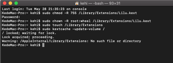

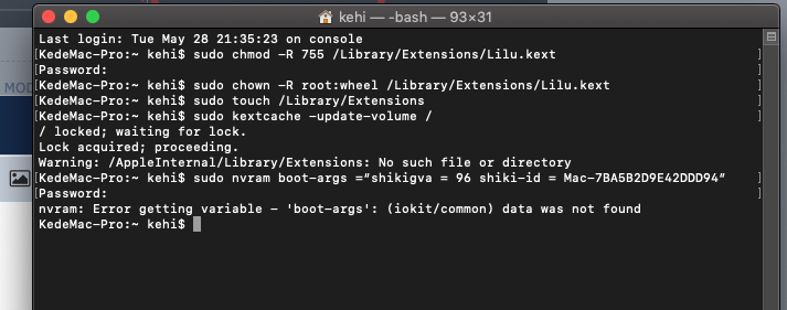

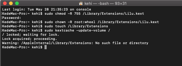

Getting this in Terminal at step 13 -
Mac-Pro:~ gianluca$ sudo kextcache -update-volume /
Warning: /AppleInternal/Library/Extensions: No such file or directory
What is the issue? :/
13) Enter
Code:
(you may get some strange return with this command, don't worry about it)
Don't worry about it, just go to the next step
