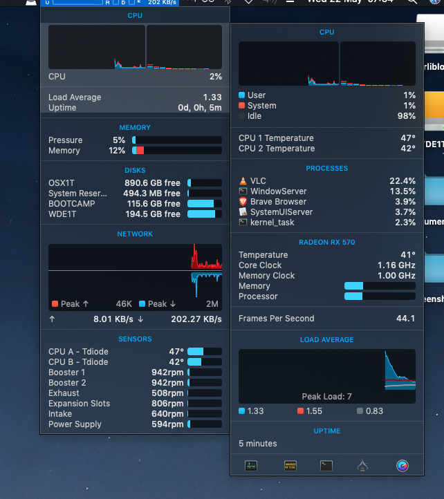

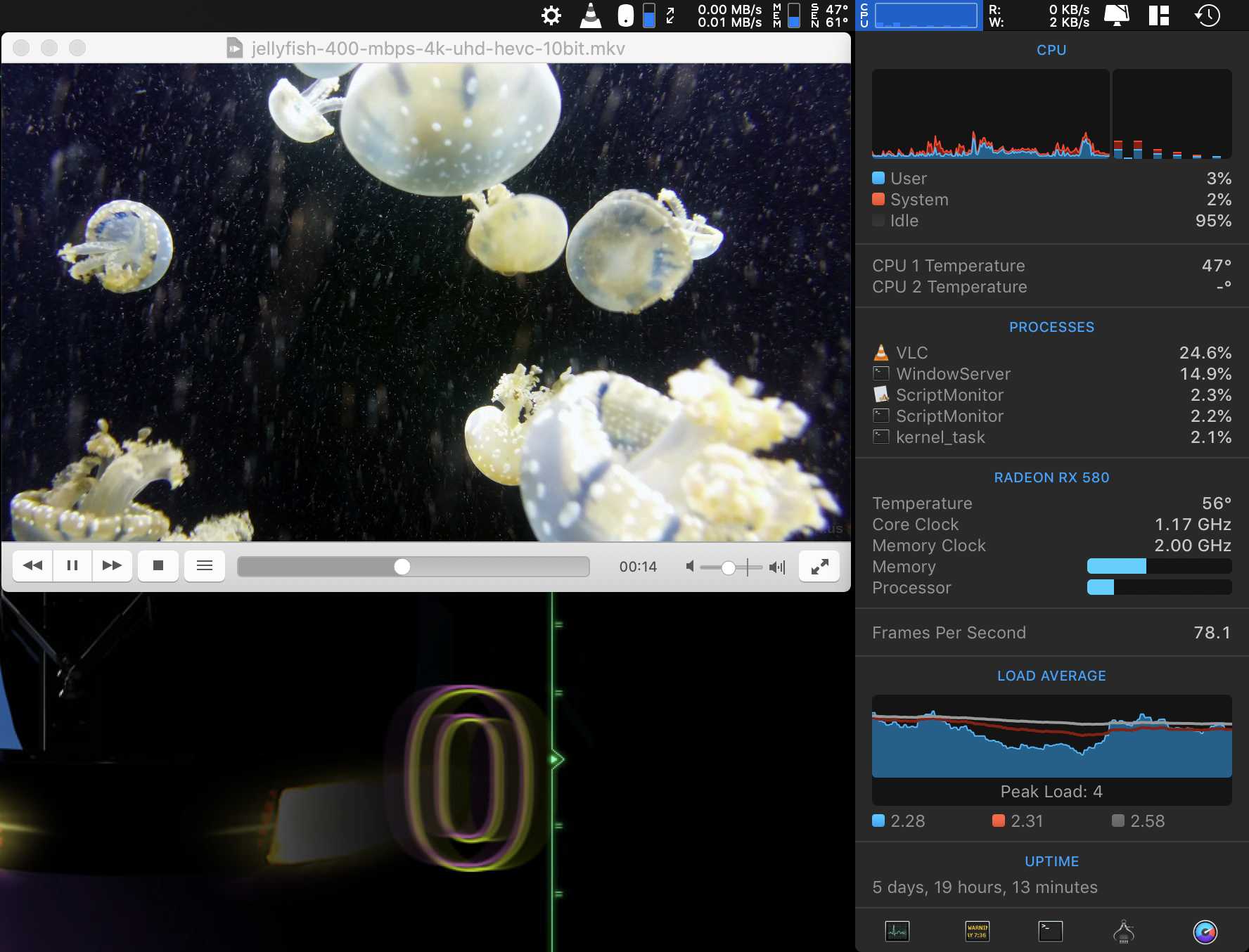

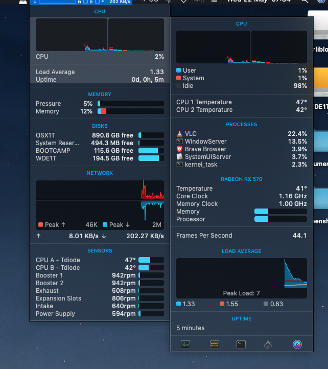

Thanks for the info. After some quick test. VLC 3.0.6 and play that video in window mode, will able to play that video smoothly with much lower GPU usage.
The bigger the window (even just black bar on both sides) will increase the GPU usage.
IINA has trouble of CPU performance. For some reason, even use hardware decode. There is still a thread that require quite a bit CPU power, and that thread can become single core performance limiting in this particular case, which eventually causing the shuttering.

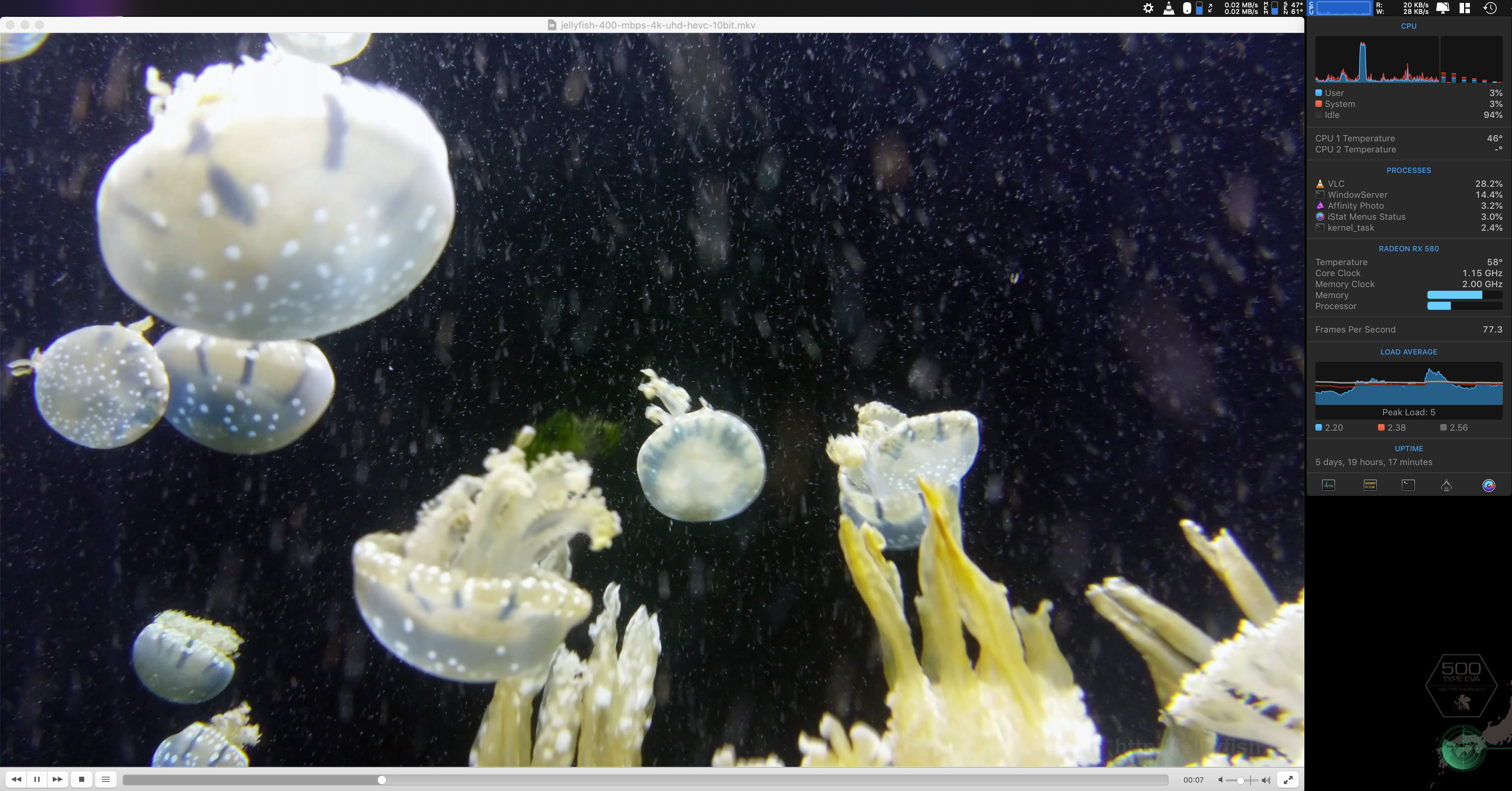

I tried full screen, not much different in CPU and GPU usage compared with window mode:
I guess your W3690 vs my dual X5675 cause the different in GPU usage.

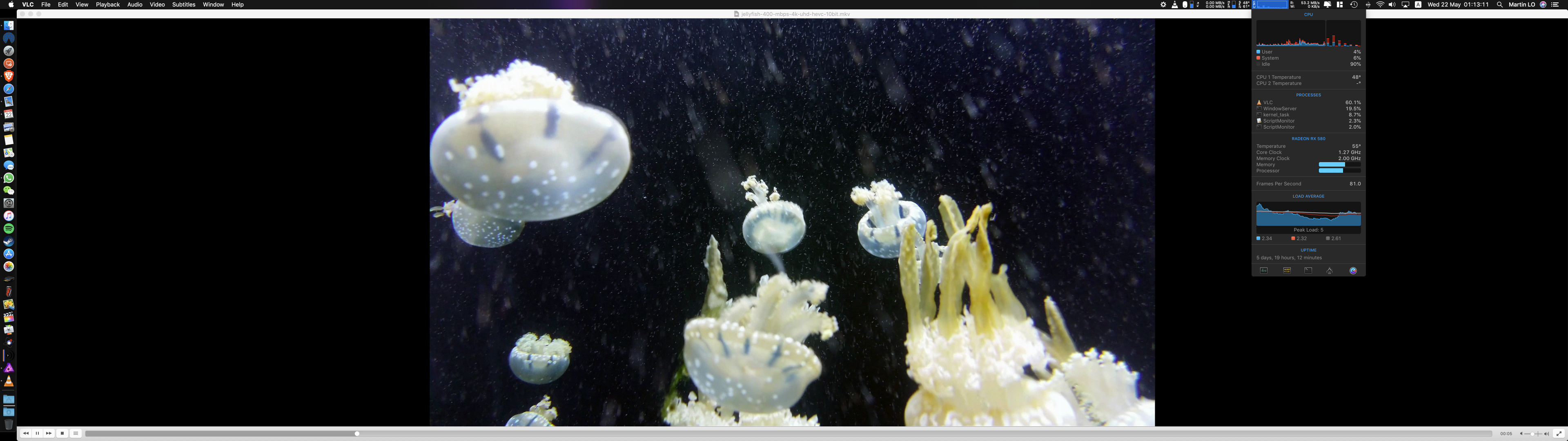

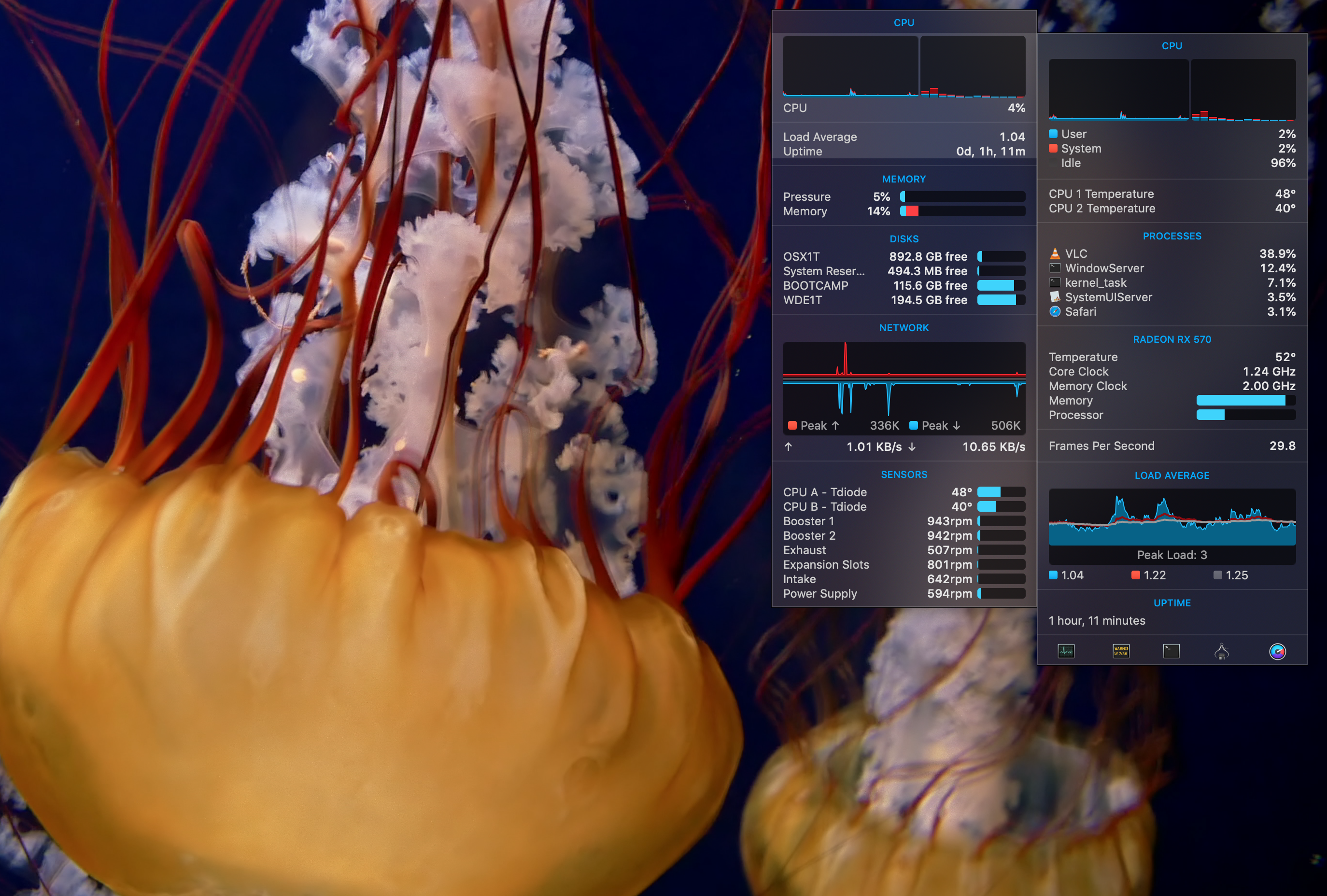

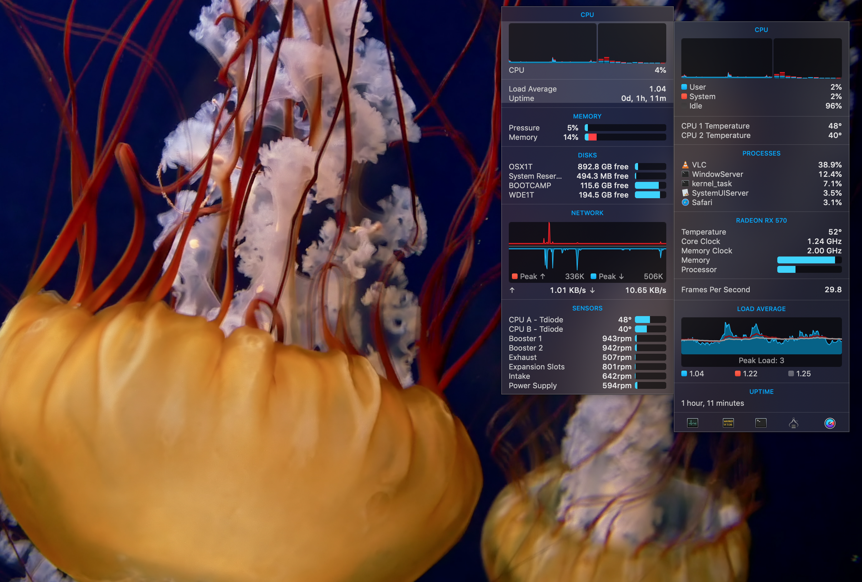

Are you running the monitor in HiDPI resolution?
[doublepost=1558459281][/doublepost]For me, the difference is very noticeable.
Small window
Larger window

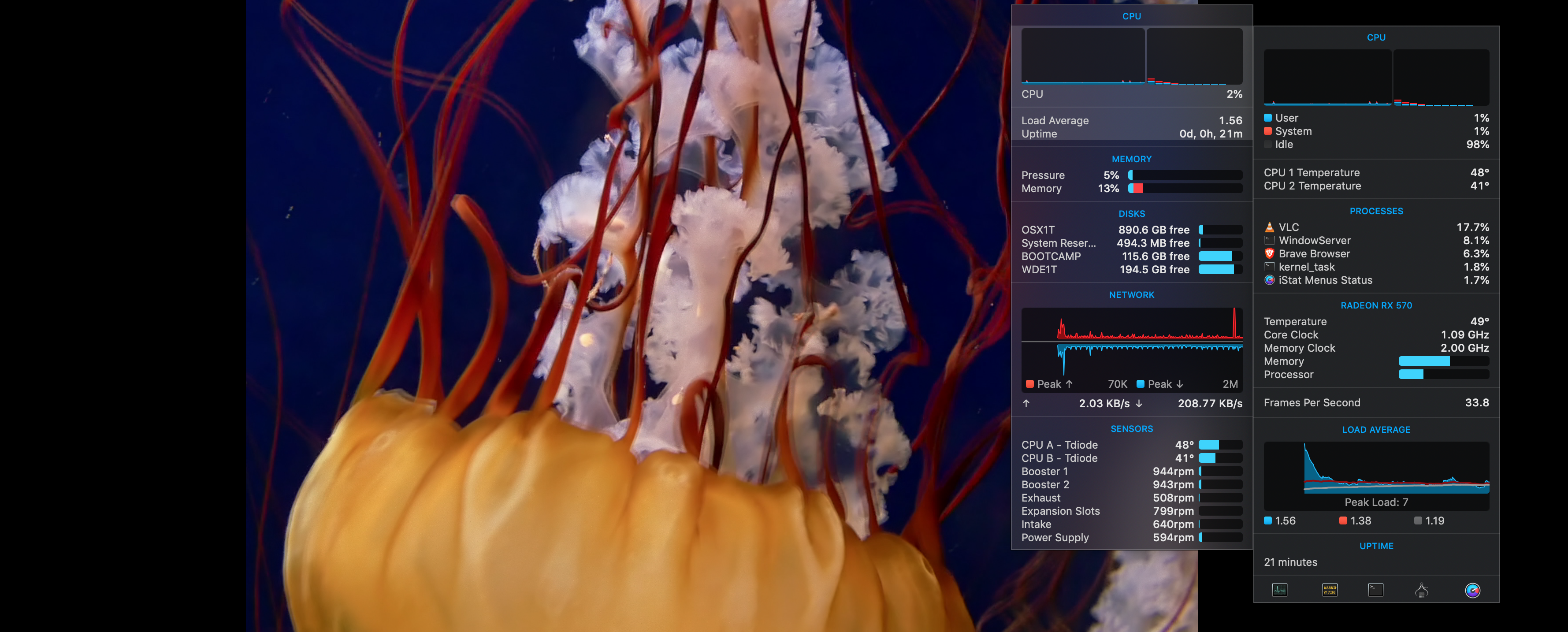

Full screen size window

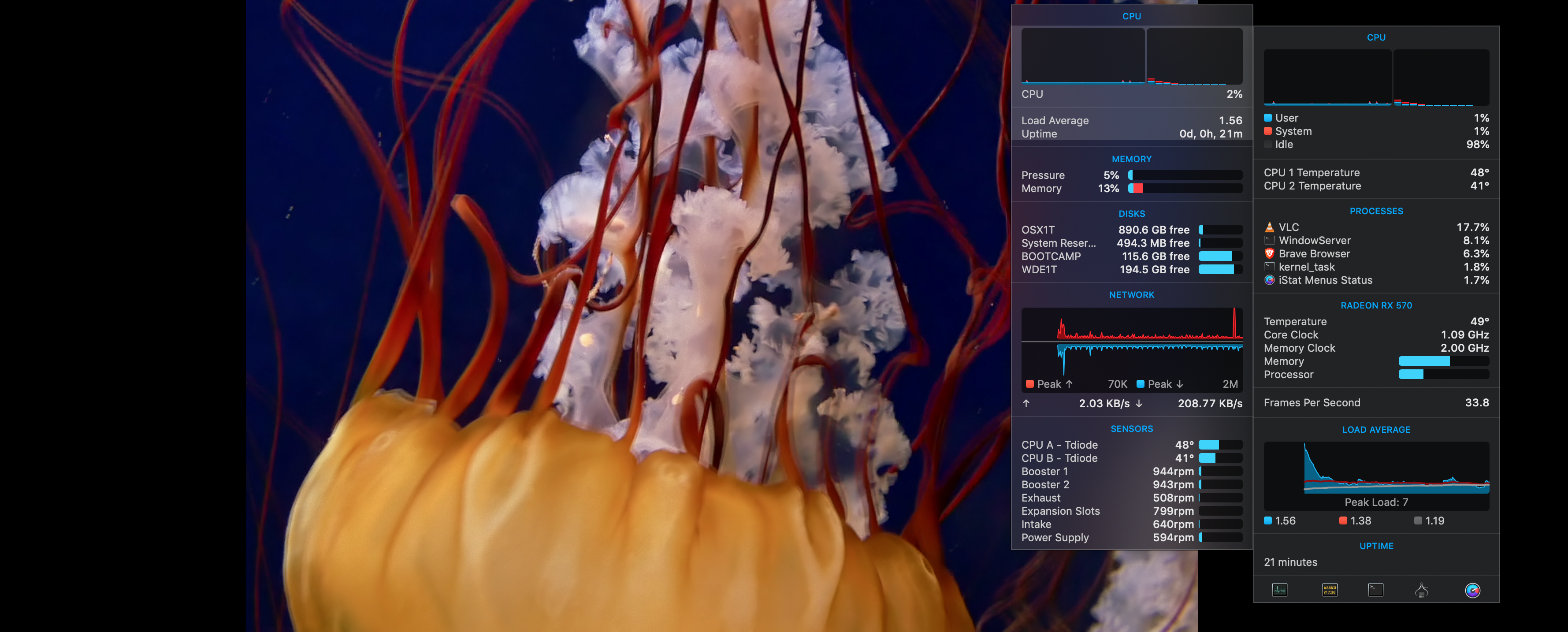

Yes, I'm running in HiDPI mode: UI like 1920x1080.
I tried native 4K, making the window smaller does reduce GPU as you mentioned.
But still even with CMD-F (full screen) my GPU usage still less than 50%.
My setting in VLC:
* Lock Aspect Ratio
* Crop, I select 1:1 to see the left & right bar as yours.
* Deinterlace (Auto)
* Post processing (disabled)
Something about the VLC plugin and / or setting might caused this discrepancy in GPU usage.

May be 3840x1080 HiDPI (my resolution) is bit stressful for the GPU. But doesn't really matter, I know how to play that video smoothly now 😀

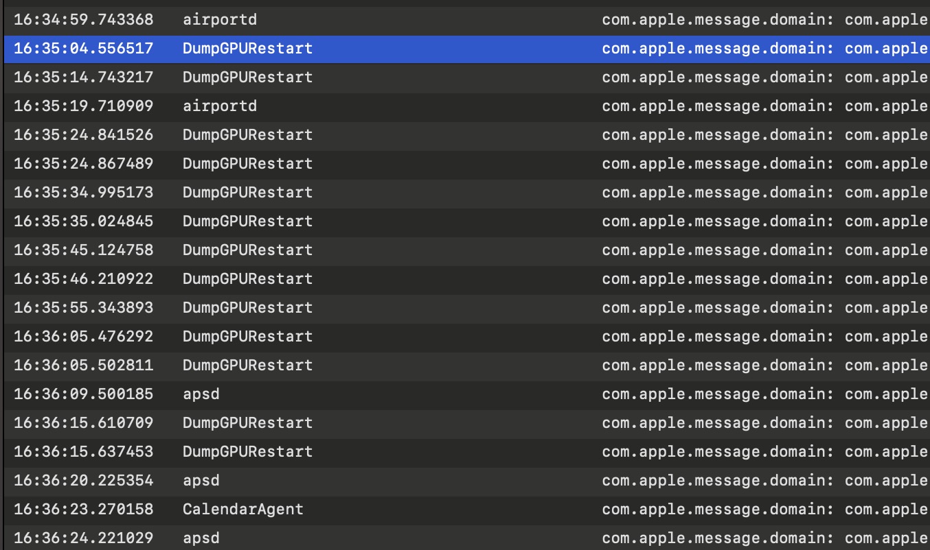

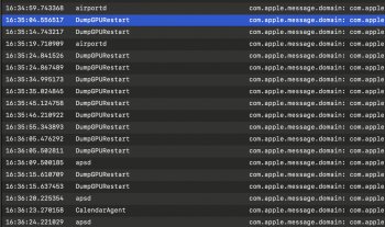

I can report two complete system freezes with this patch during 3 hours. First freeze was using FCPX, second was using Quicklook. In console there are multiply "DumpGPUrestart" messages after freeze time.
10.14.5 release, 144 bootrom
Same for me my system freezes on FCPX trying to work on a h264 canon video edit. Not very good for actual real work. Doesn’t freeze all the time but it does sometimes.

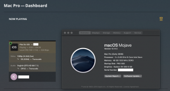

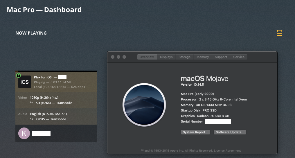

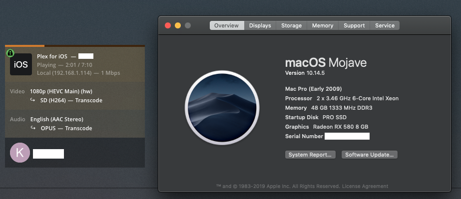

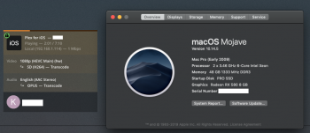

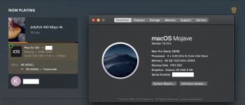

Ran Plex server on my Mac Pro just to test this. Answer appears to be yes. My usual Plex server is Win7 with hardware transcoding. MacOS is limited to one GPU hardware transcode, which is why I run Win7 for Plex. That's a ridiculous Apple software limitation of 1 hardware transcode.
It worked on a 1080p H.264 and 1080p H.265 main. The 300mbps 4K h.265 Jellyfish.mkv file from earlier in the thread did not do hw transcode.
Did some quick search on Google. It seems this problem only exist on Polaris GPU (e.g. RX580), but not Vega.
And even MacBook Pro user may suffer this from RX580 eGPU (without our hack, of course). It seems the AppleGVA isn’t that ready for RX580 (they just added this hardware encoding function to RX580 in 10.14.5).
Pure guess, Vega has better (or more mature) support in hwaccel due to iMac Pro. Polaris should getting better hwaccel support later (due to eGPU), but at this moment. The driver may crash when trying to use hwaccel.
Interestingly, so far, all reported crash cases are Apple software related (FCPX, Compressor, Quicklook…). And none of the 3rd party software is affected (PP, AE, DV, FFMpeg, VideoProc, Handbrake…).
Feels like Apple hold some secret in the drivers for their own software. Which suppose to make their softwares perform more superior. But end up causing this trouble.
