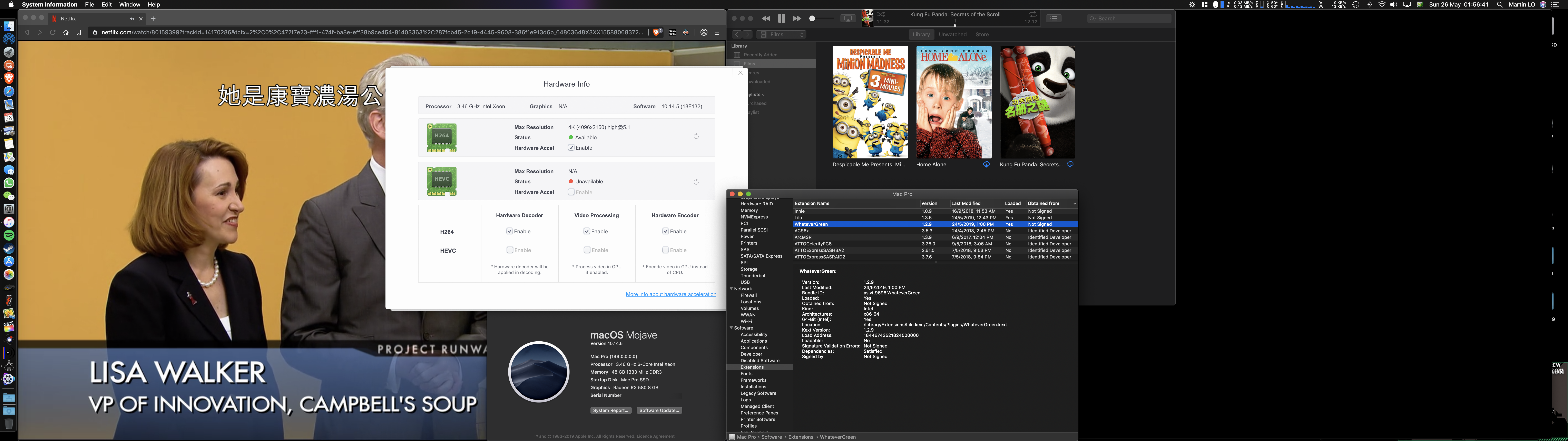

Thanks guys, I managed to enable the green check in VideoProc.

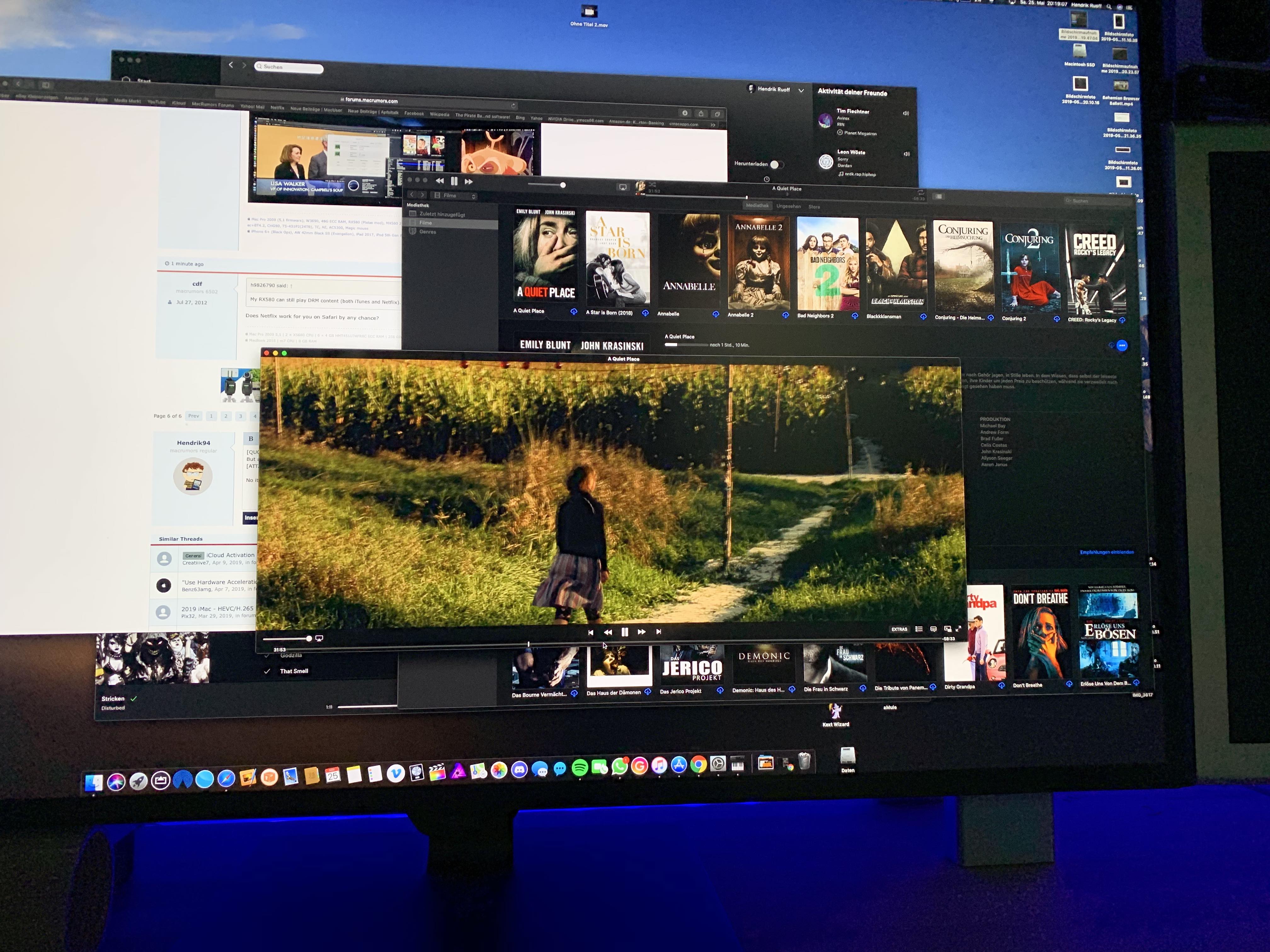

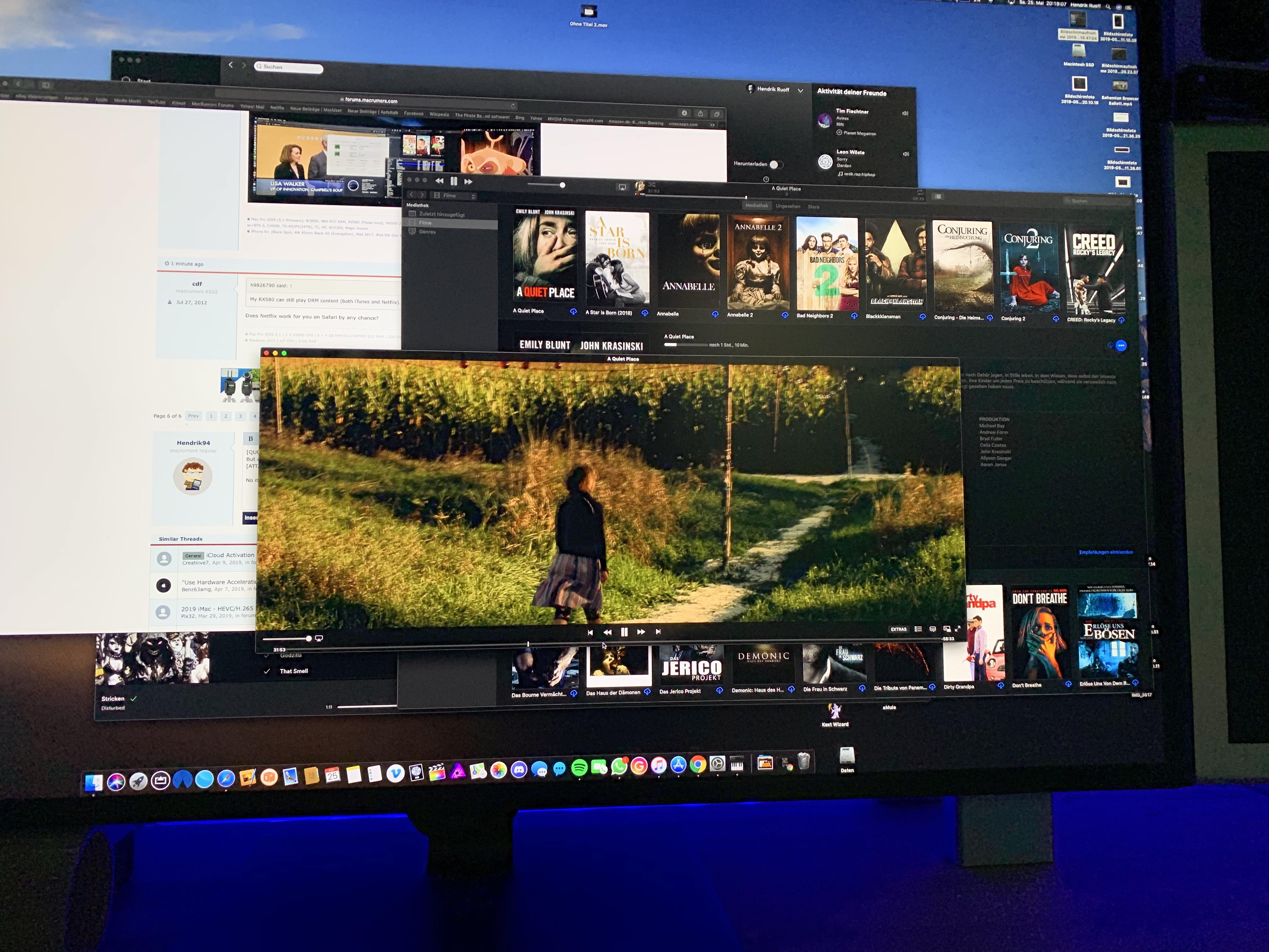

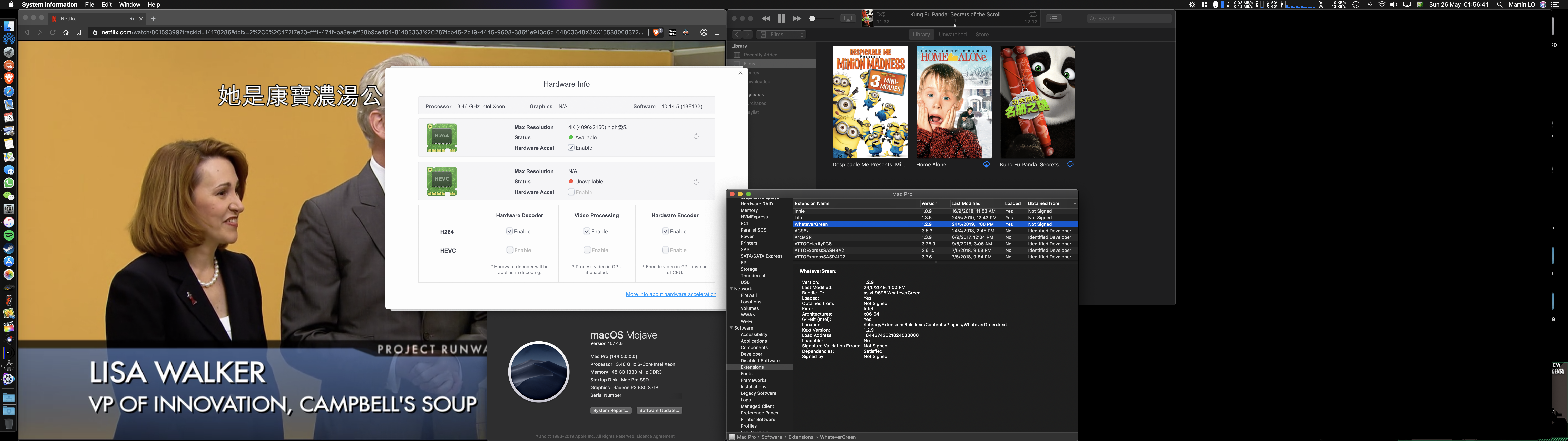

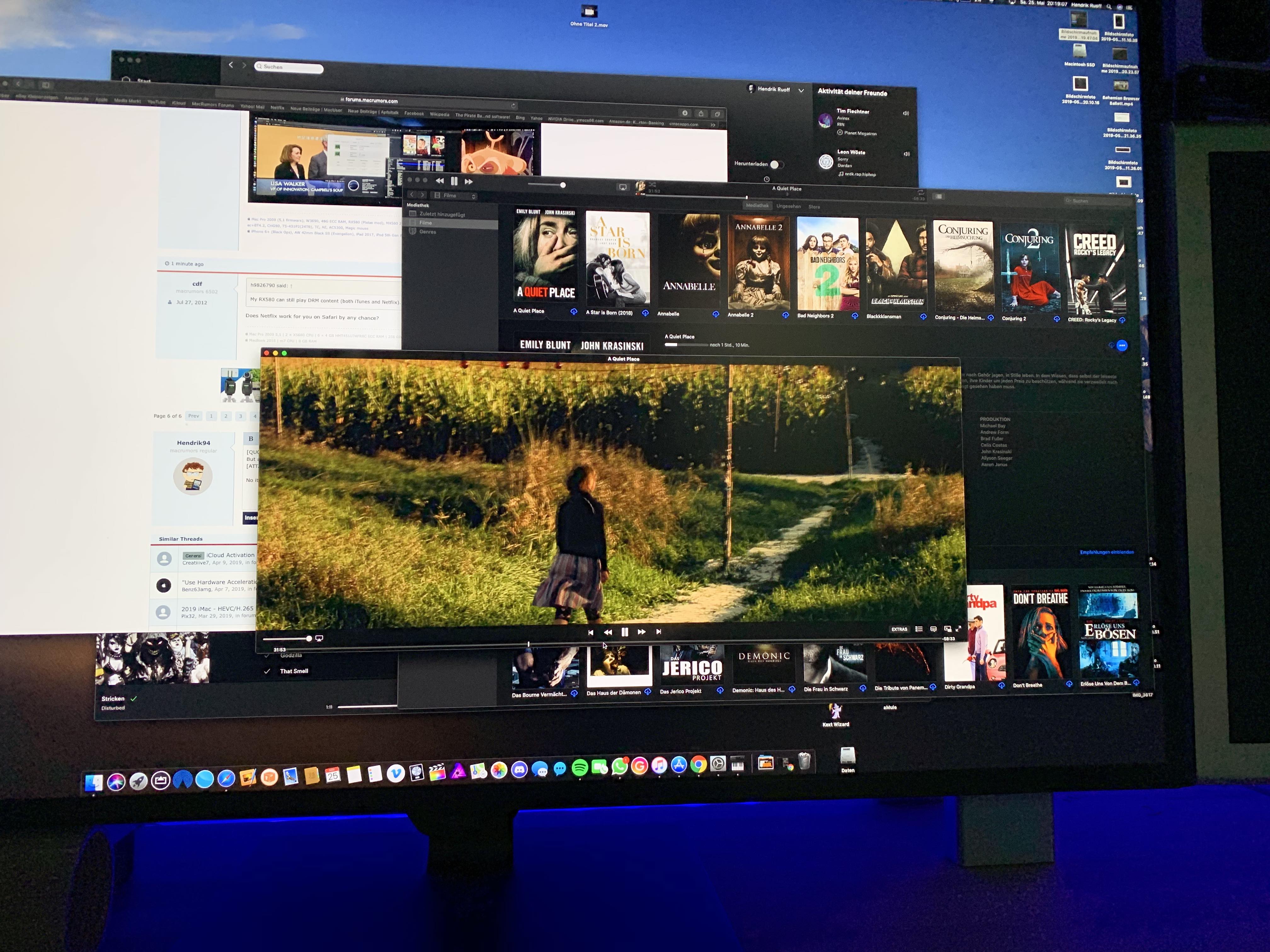

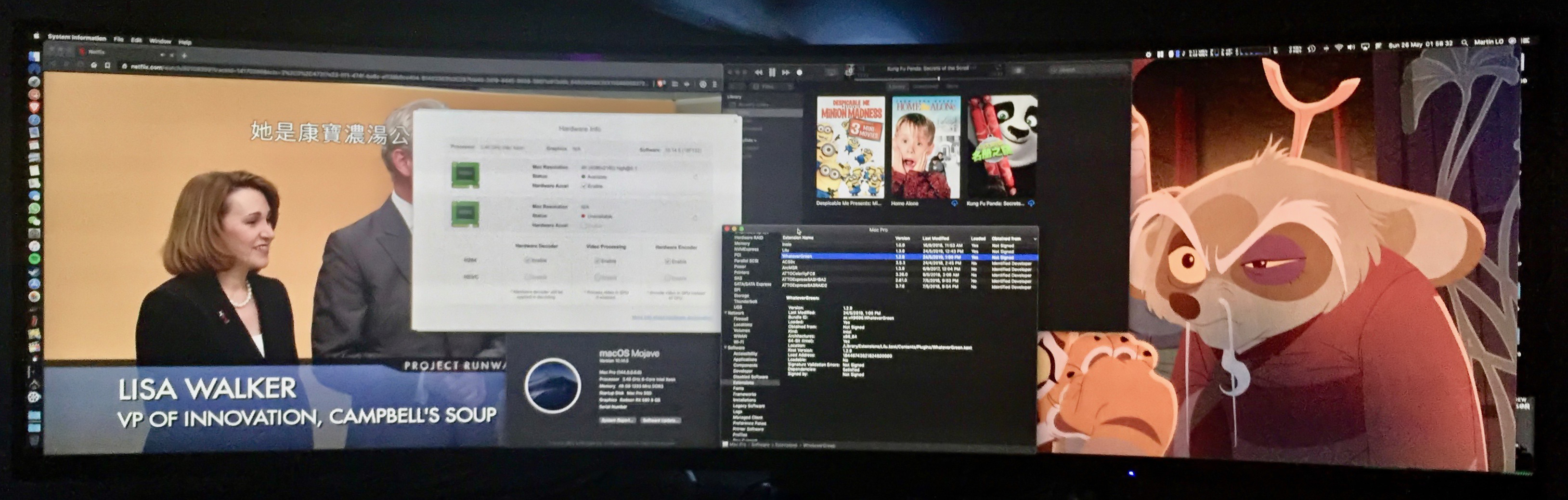

Ran Plex server on my Mac Pro just to test this. Answer appears to be yes. My usual Plex server is Win7 with hardware transcoding. MacOS is limited to one GPU hardware transcode, which is why I run Win7 for Plex. That's a ridiculous Apple software limitation of 1 hardware transcode.
It worked on a 1080p H.264 and 1080p H.265 main. The 300mbps 4K h.265 Jellyfish.mkv file from earlier in the thread did not do hw transcode.

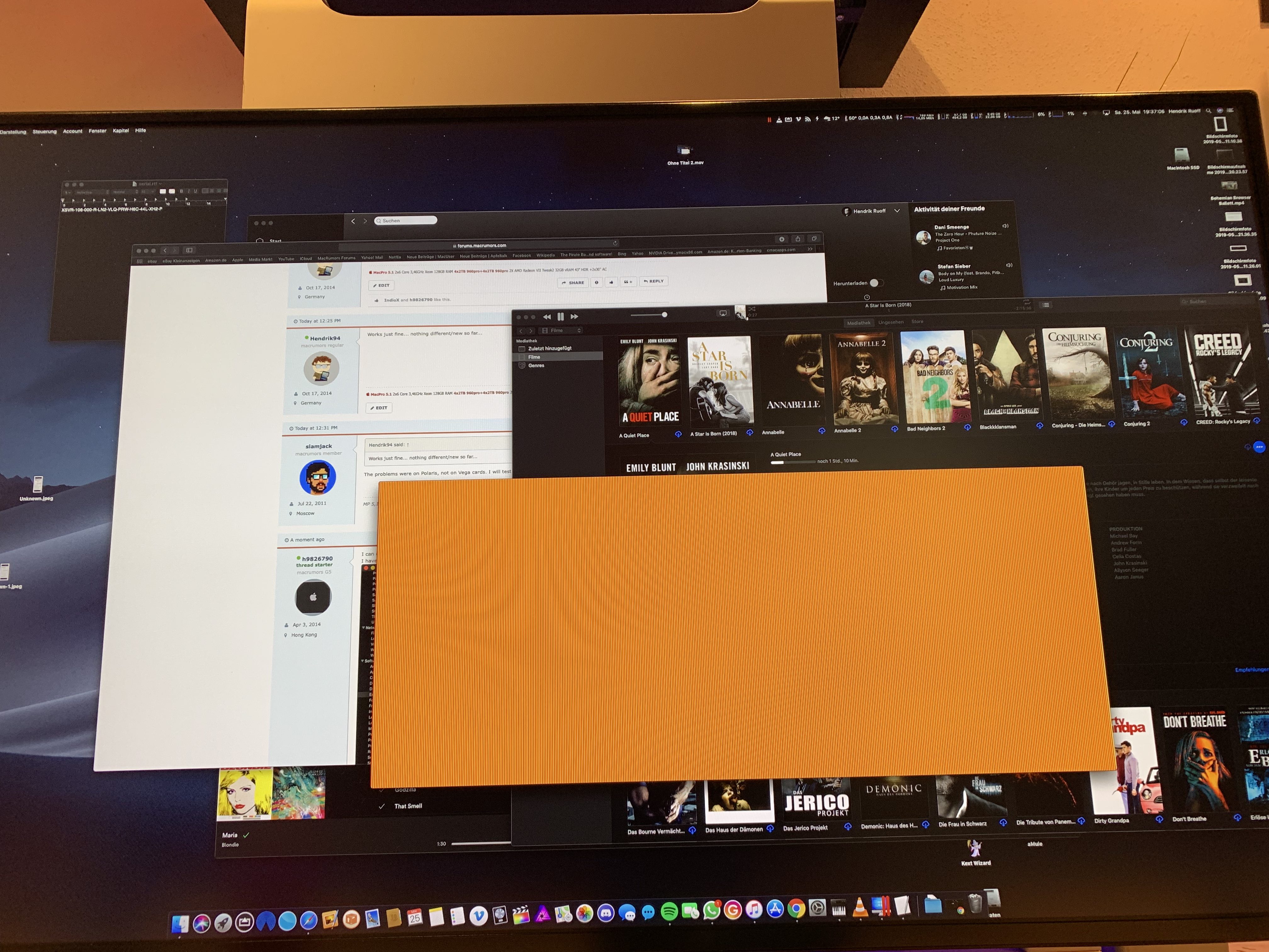

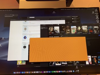

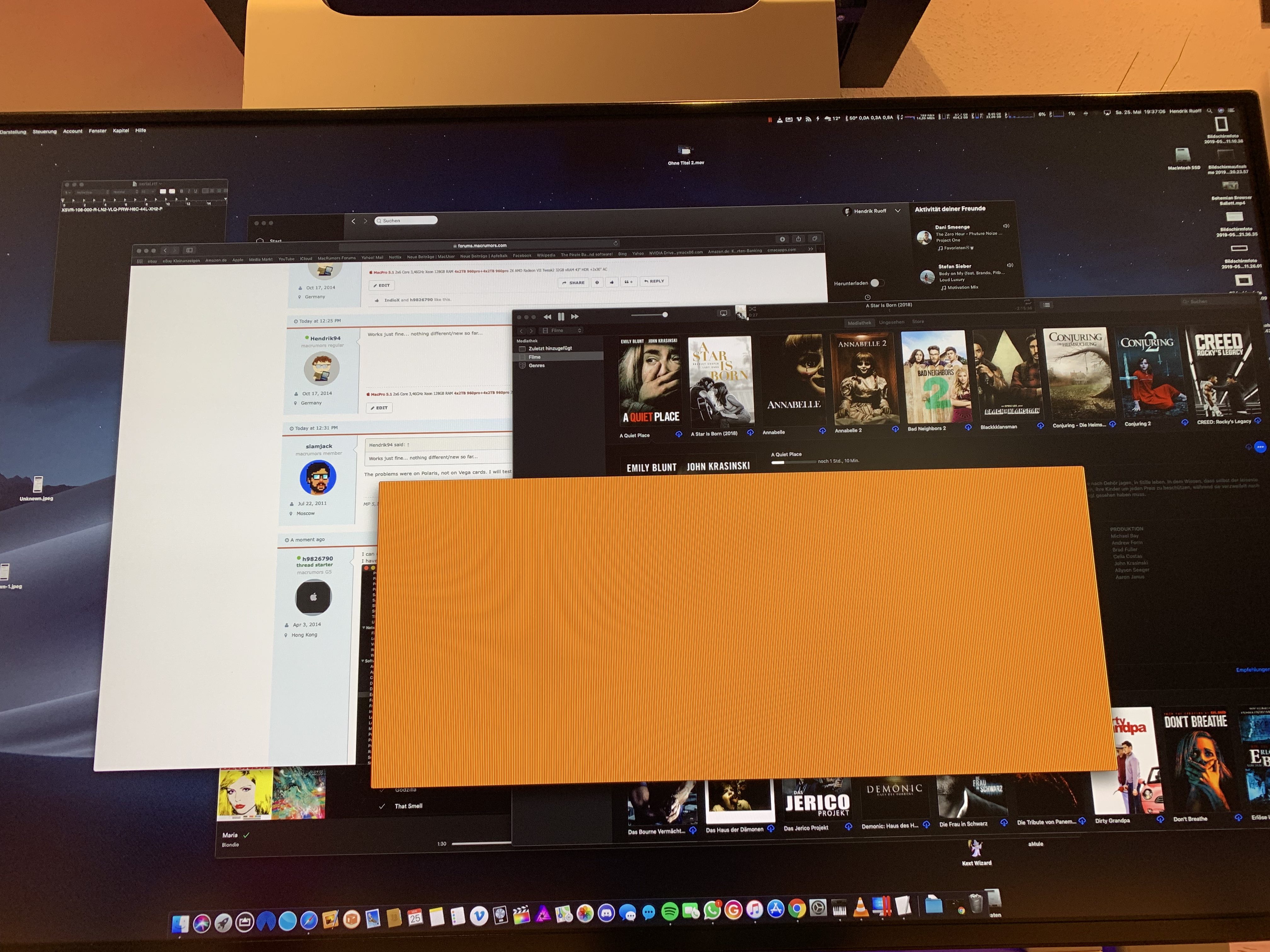

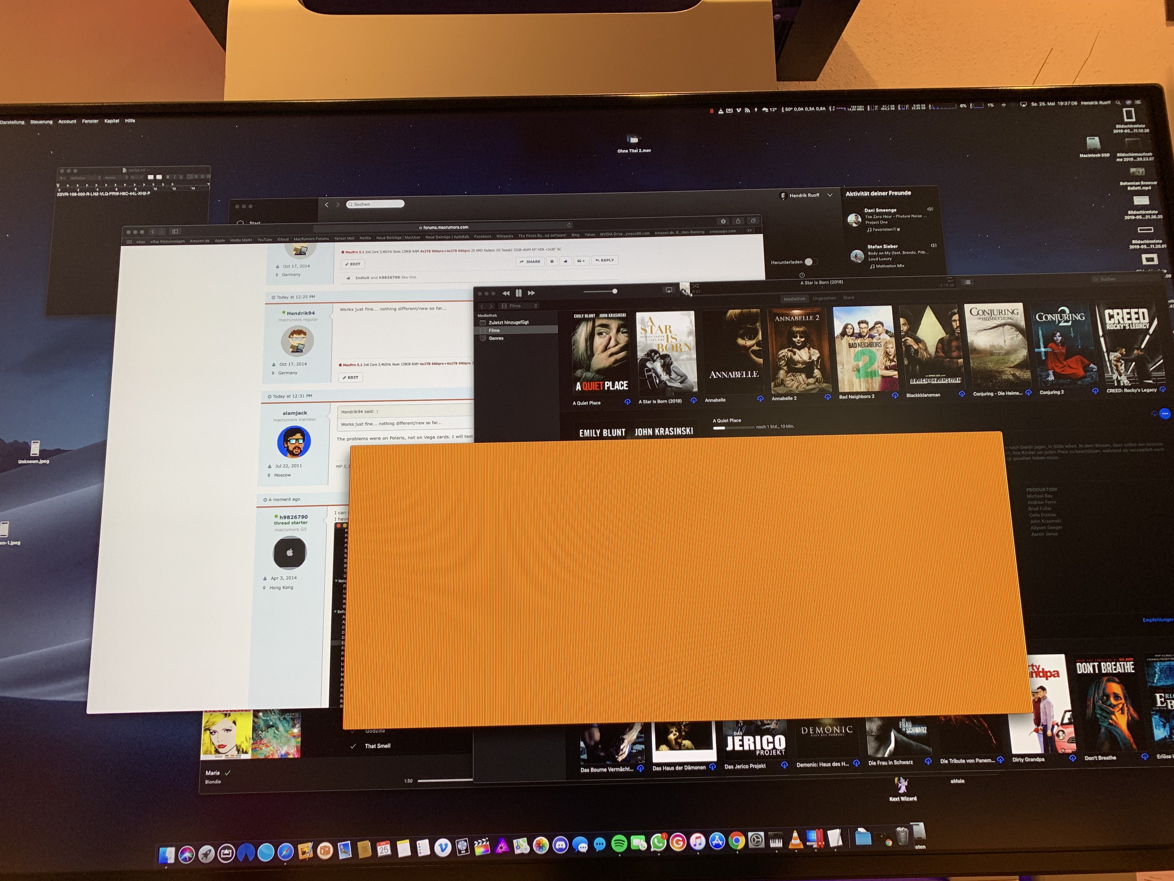

I also had a hard freeze. Did a few edits in Premiere pro than sent the sequences off to Media encoder. Exported 6 1min. clips to h.264 (1080p) using Opencl. That worked perfectly. Switched back to the desktop to look at the exported clips in the folder. Got the hard freeze. It was neat while it lasted, seeing the Jelly fish playing smoothly in VLC. But for the real world usage, its looking like a no go.
Also with RX580? And use preview to watch the video?

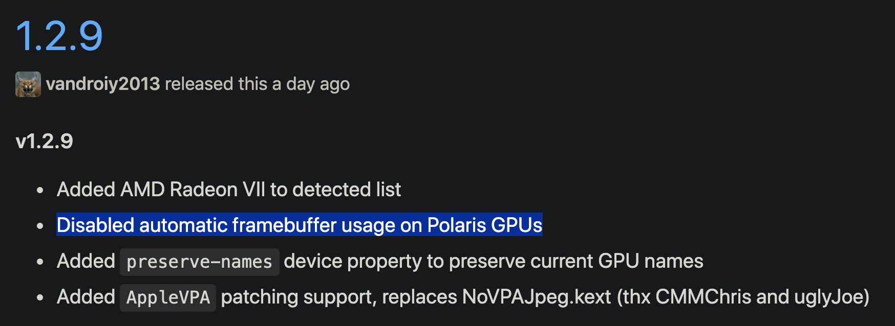

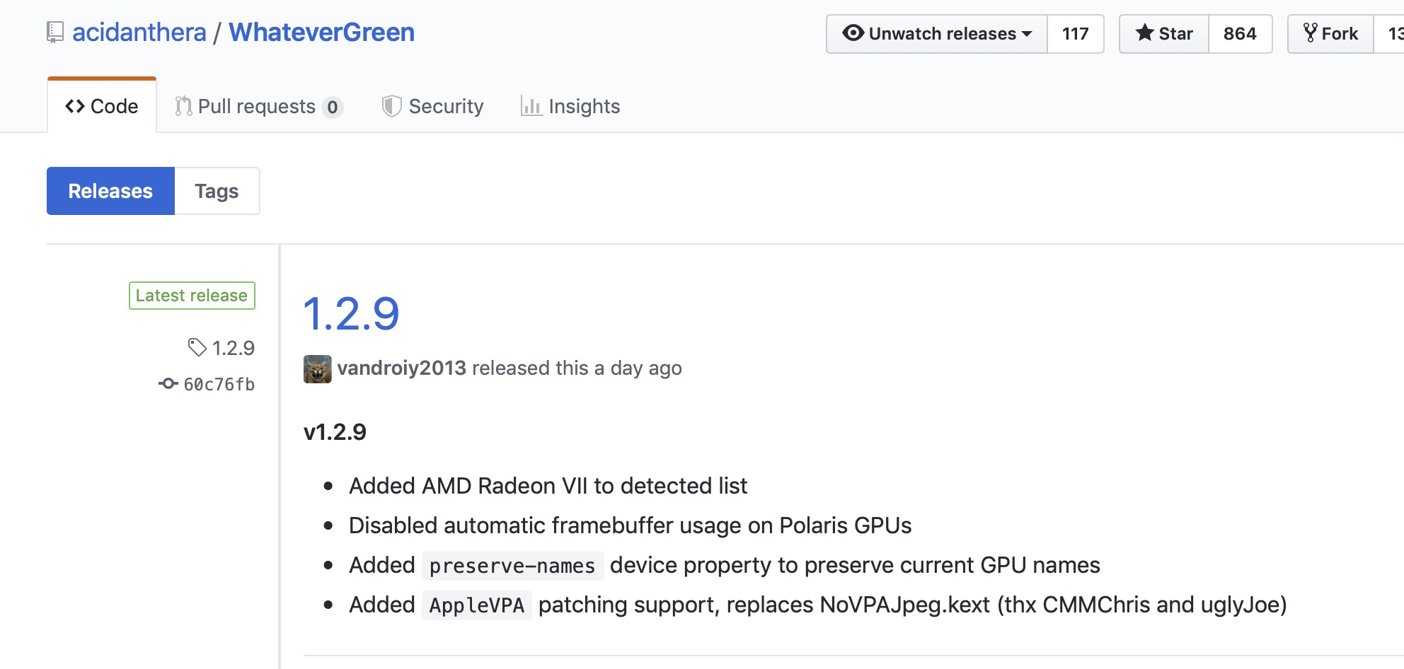

New versions of Lilu and Whatevergreen are out, worth testing i suppose.

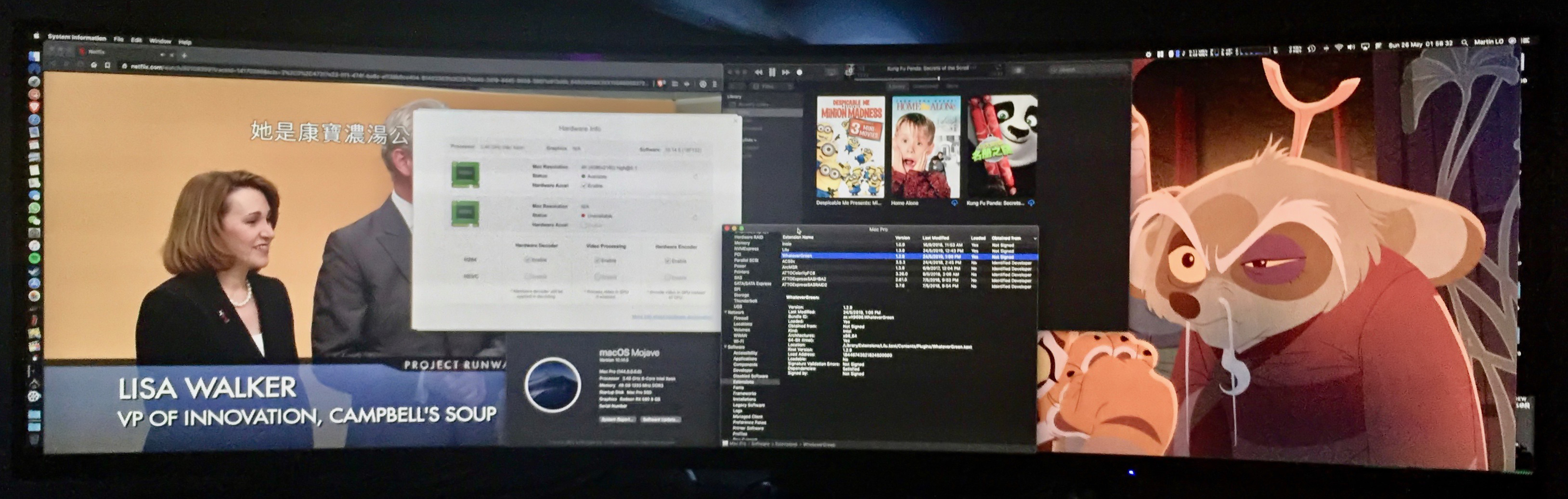

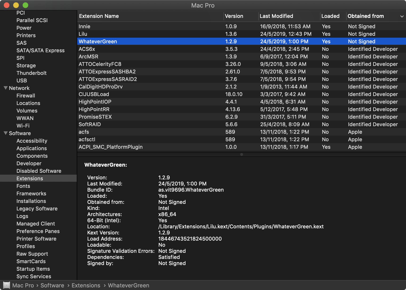

I can only say the new Lilu and WhateverGreen still works, but not sure if that make any difference on my RX580. I haven't experienced any freeze in FCPX or Preview since I found this mod.

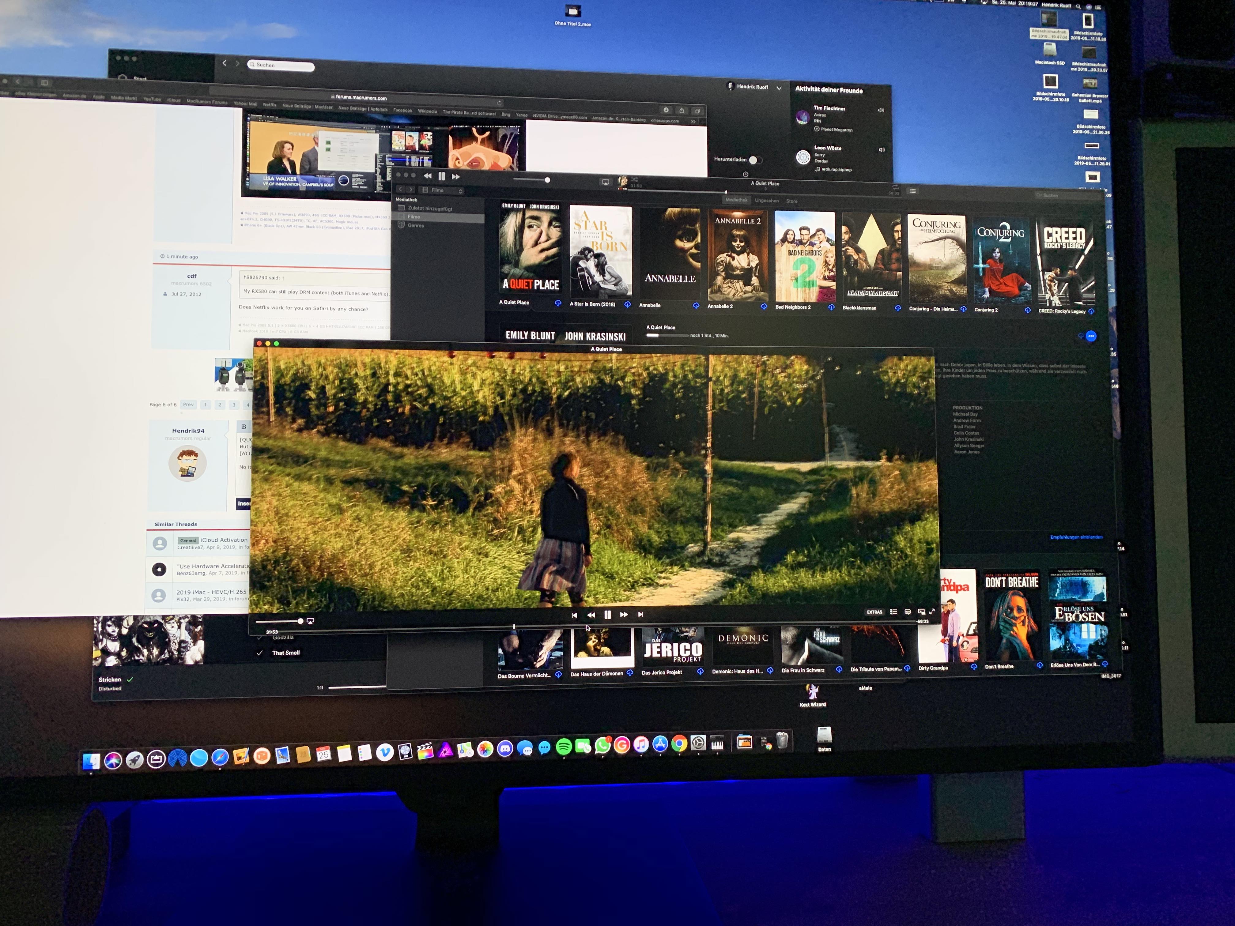

But since there is some change for the Polaris GPU. It may make some difference.
No it can't.... your movie is not DRM then... non DRM Movies work fine... also for me
How do I know if the movie is DRM? I can't play that iTune movie if I set shikigva=32. And it can't be captured. I think that's DRM. Isn't it?

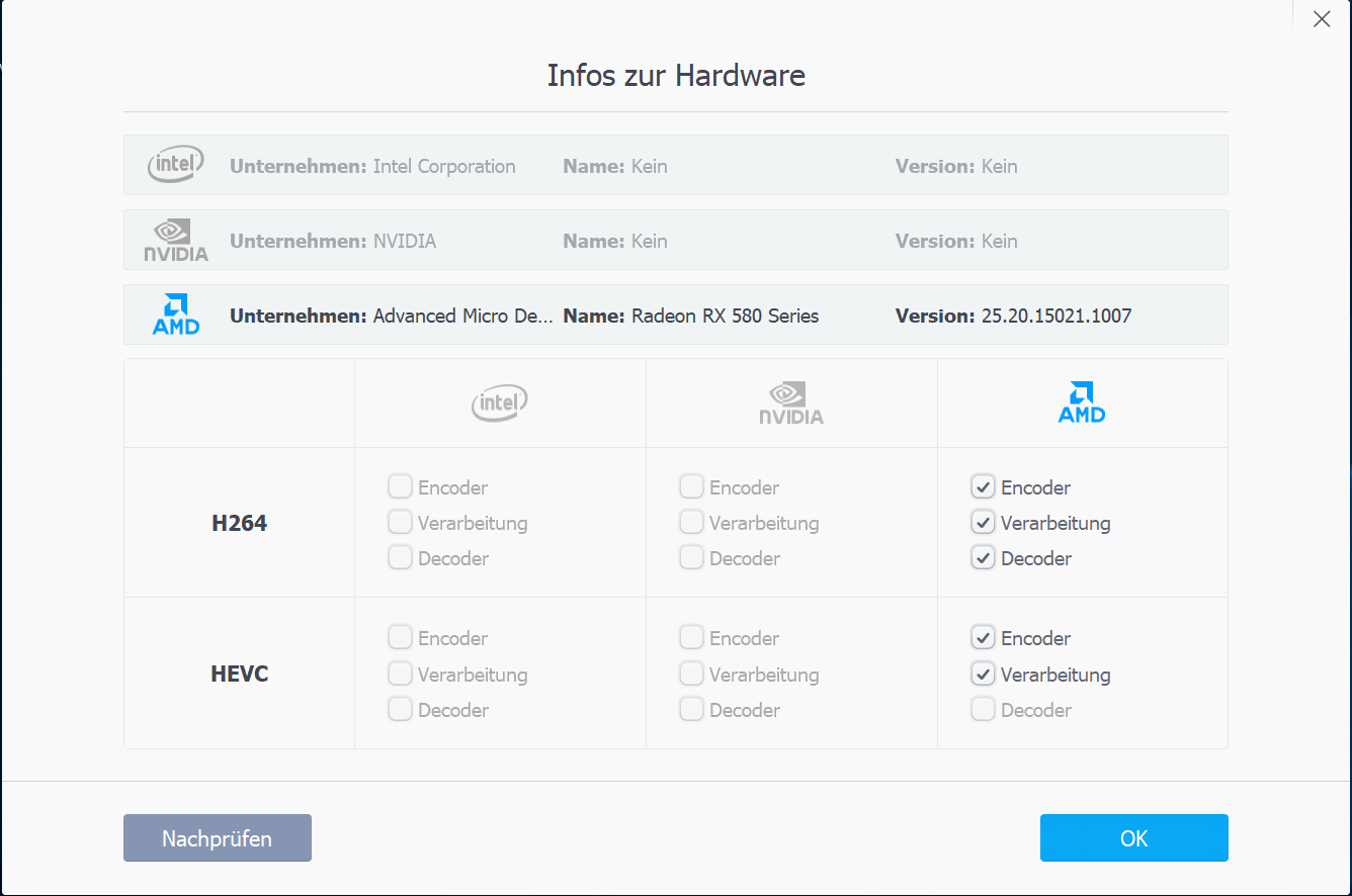

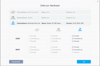

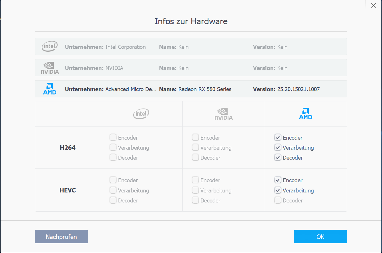

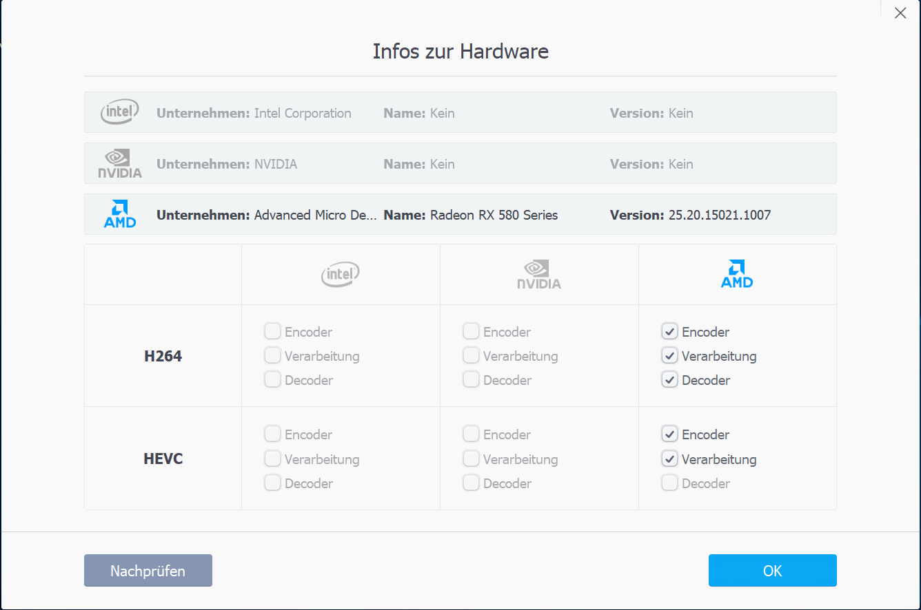

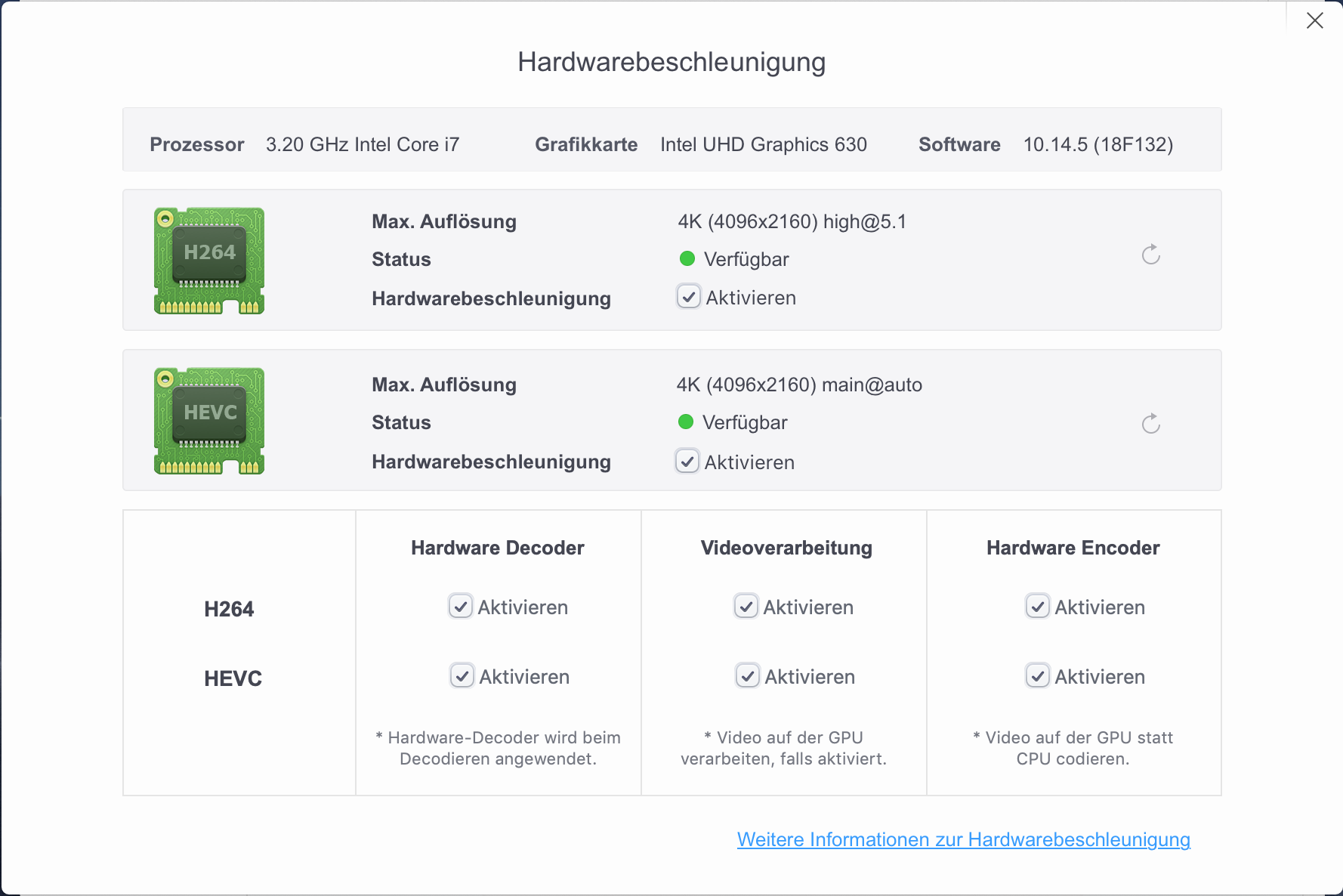

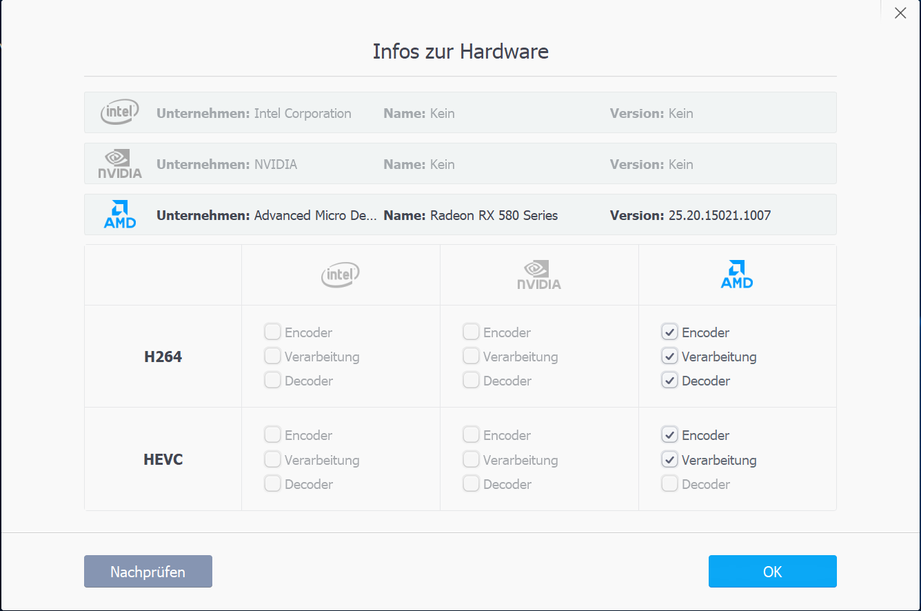

Interesting, just tested. A Mac Mini 2018 in Windows with eGPU RX 580 has no HEVC decoding (iGPU is deactivated in Boot Camp).

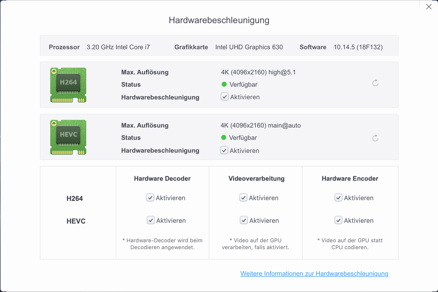

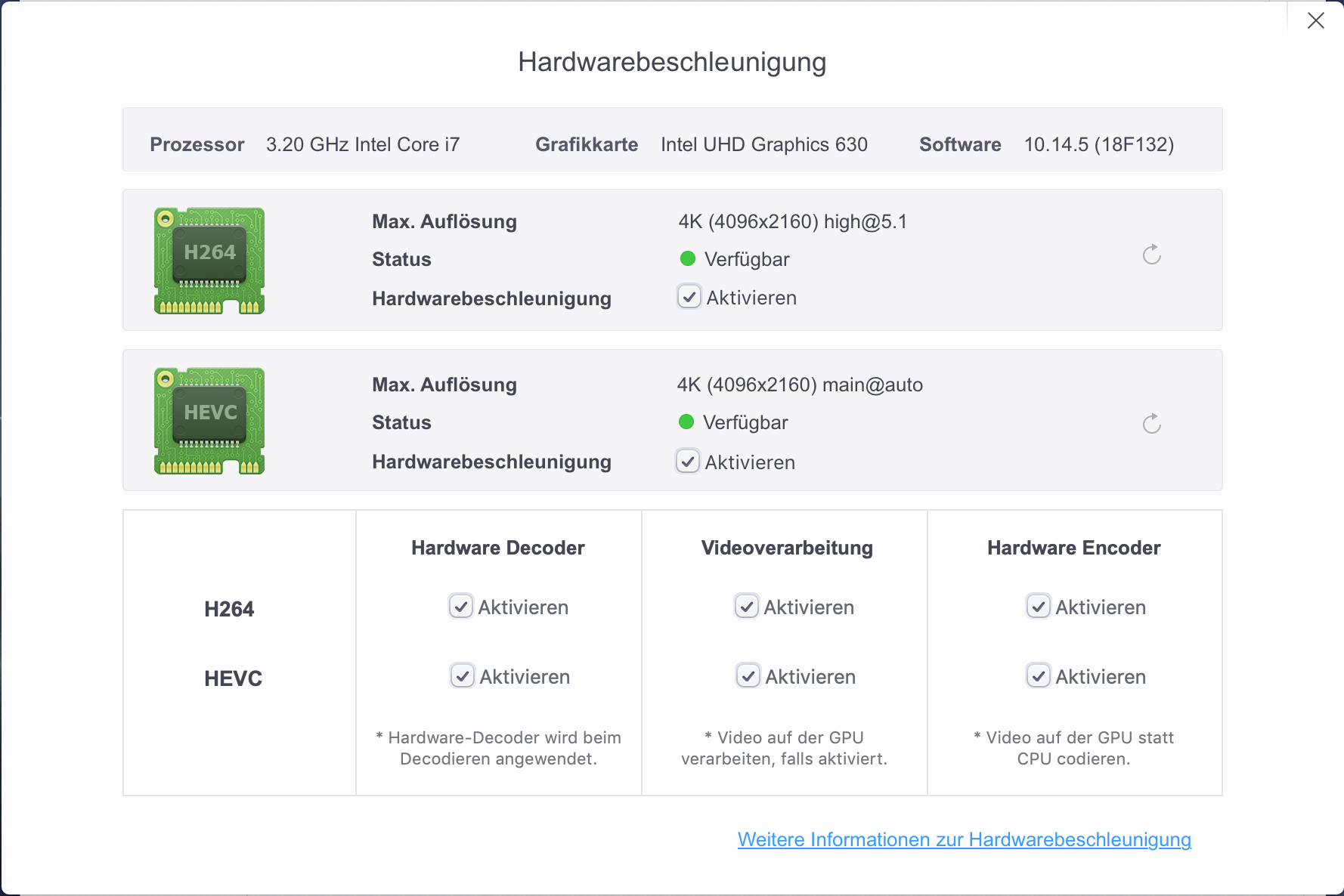

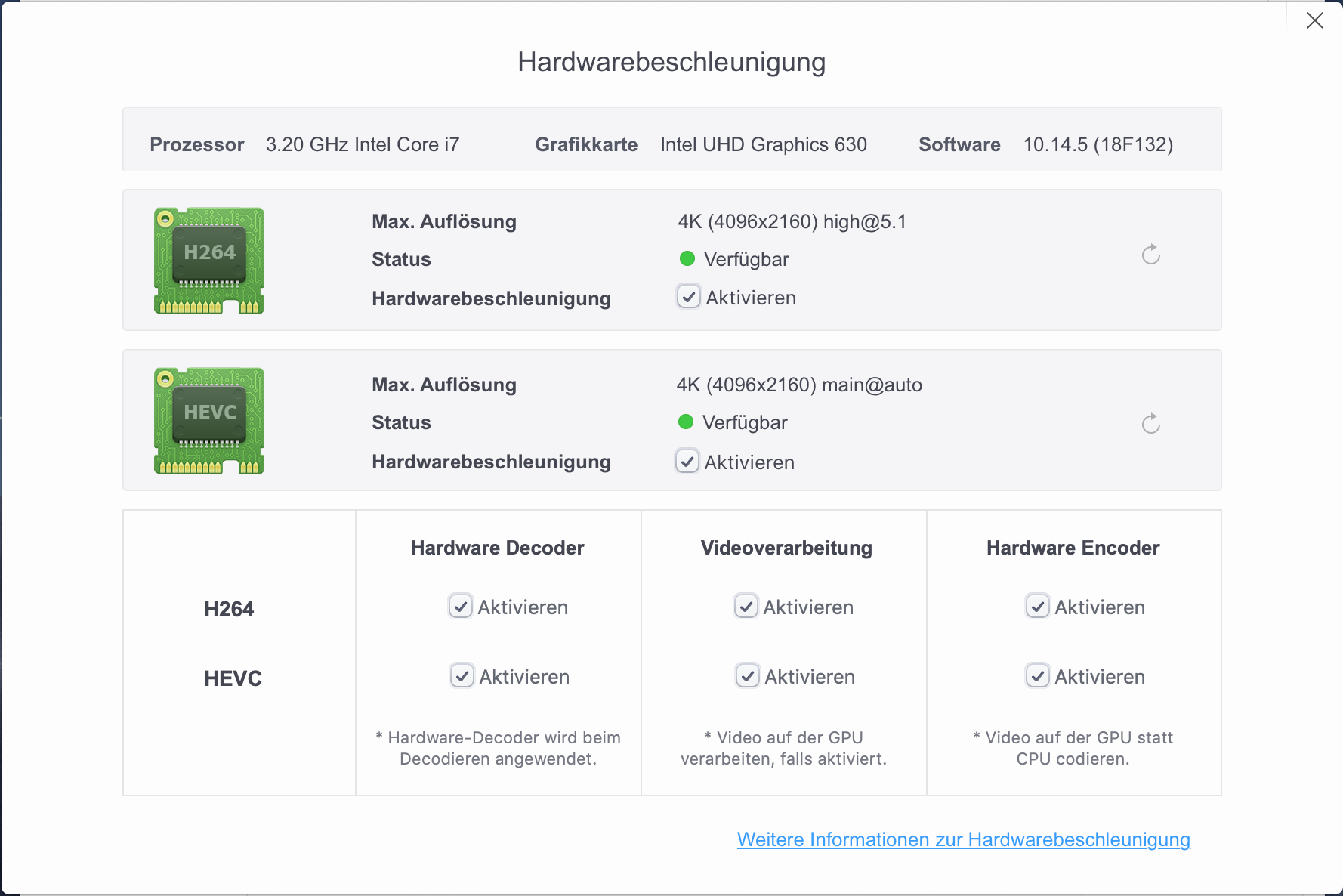

The same Mac Mini 2018 with eGPU in macOS 10.14.5 ignores the eGPU RX 580 and uses only the i7 iGPU.
