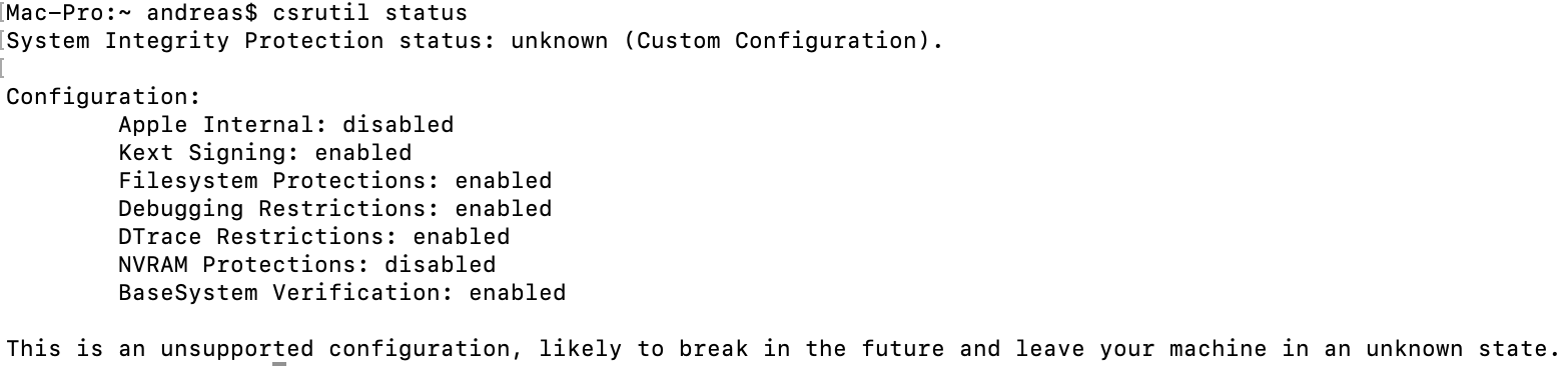

today i update my "handmade" oc install via Martin Lo's latest package (0.7.3 V2).
After everything went fine, i wanted to reenable sip. I did this and now i see the following if checking sip is enabled or not.
Any tips how to fix this?
Thanks
