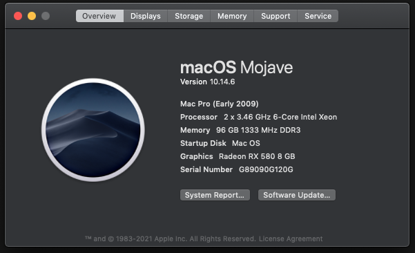

So I ended up just intsalling a fresh copy of Mojave before you responded to this message and the system is now up and running but with no boot screen or HWA. I downloaded the 0.7.3 and tried to run the Bless Opencore but got an error. I didn't reset NVRAM or anything because I wasn't sure if I needed to just go through the process as if I were updating from High Sierra all over. I didn't want to brick the system again.
I do not have another boot drive currently.
I have an RX580 install and it is not flashed.
I would like to update to Big Sur and have OpenCore and HWA running correctly if at all possible. When I try to update to Big Sur, the Mac Update tells me that OS is not available.
You have to mount the EFI partition that contain OC before you run the Bless tool, otherwise, it won't work.
Also, SIP must be still disabled. If not sure, please double check this as well.

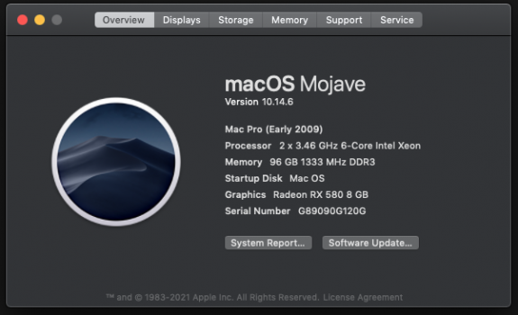

Can you still see the Big Sur update option in system preferences?
This is the problem I had. I followed the same instructions the first time with Mojave and could see the OC boot screen. Now the second copy of Mojave I have I can't see the boot screen. I followed the same procedure on Martin's YouTube video.

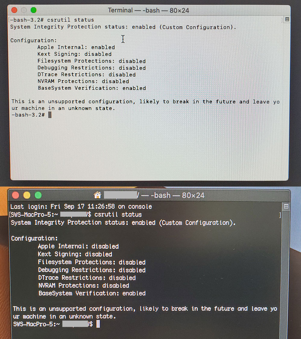

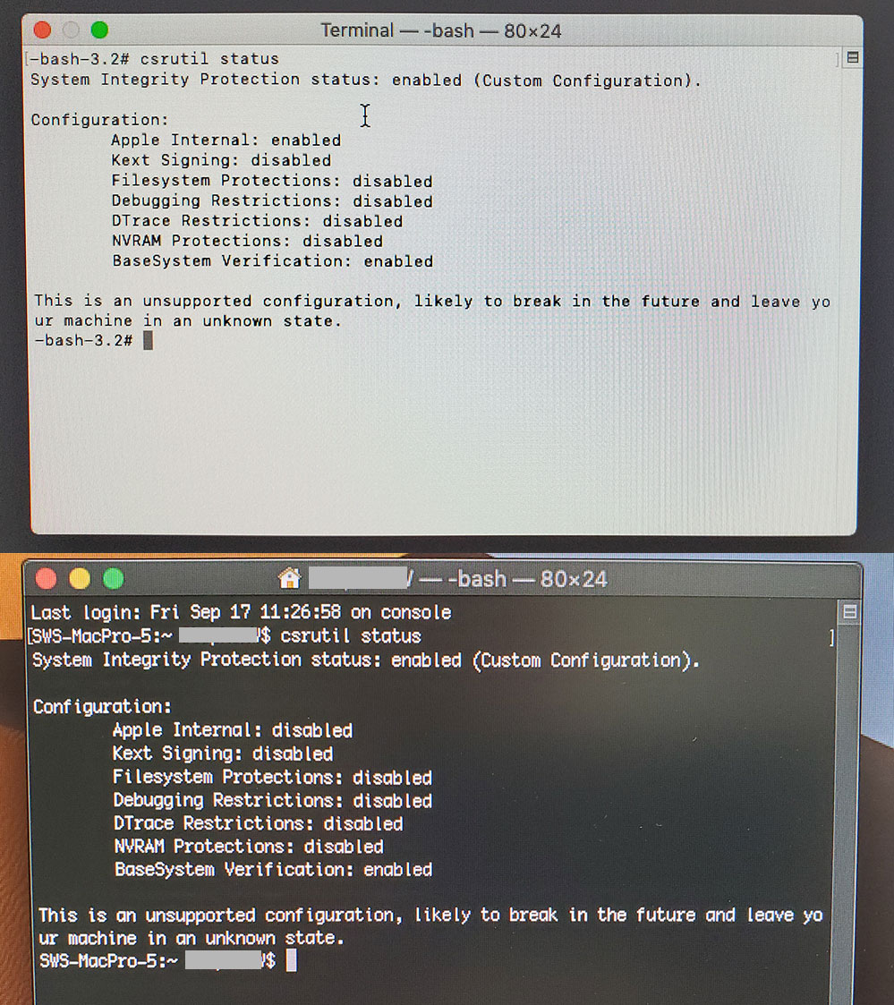

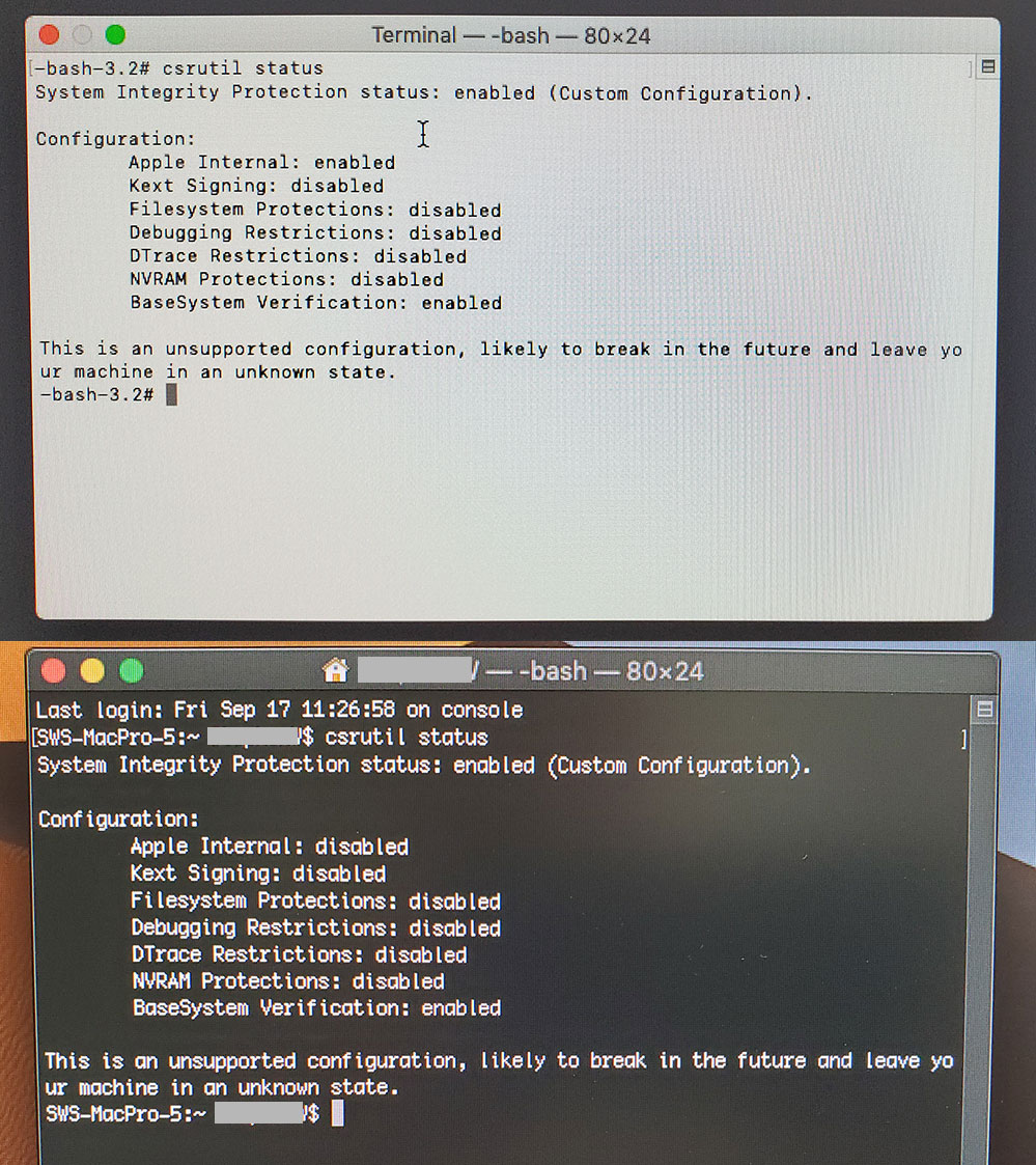

I installed OpenCore using the method in #1314, but scrolling through the thread I'm unclear about whether or not to re-enable SIP after the installation is complete. I went ahead and re-enabled it and checked the status in Recovery mode, and then in my home directory after I booted up. Does this all look good to everyone? Should I go back and disable it again in Recovery mode?
FYI: did this on my test machine cMP 4,1>5,1 in preparation for installing OpenCore on my main cMP5,1.
There is no need to re-enable SIP. It' just your choice.
And that customised SIP status is intentional.
Thank you. If I'm understanding you correctly, re-enabling SIP will NOT cause any problems, so I can leave my system with SIP enabled (as shown in my photos) 🙂

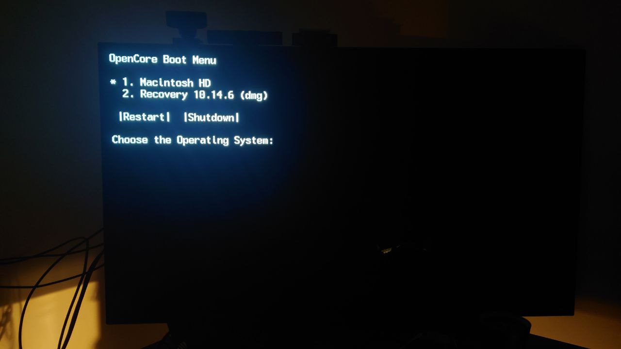

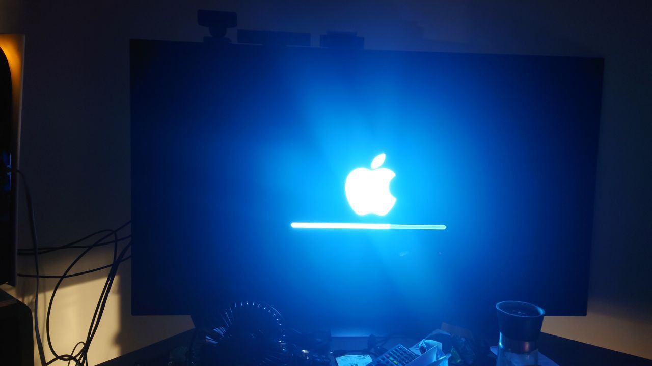

I changed the UIScale flag from AQ== to Ag== and all I got was large text as a bootpicker.
Also giant Apple logo and progress bar.
I'm outputting to LG CX 4K OLED over HDMI. GPU is RX 580. AQ== works as expected.
