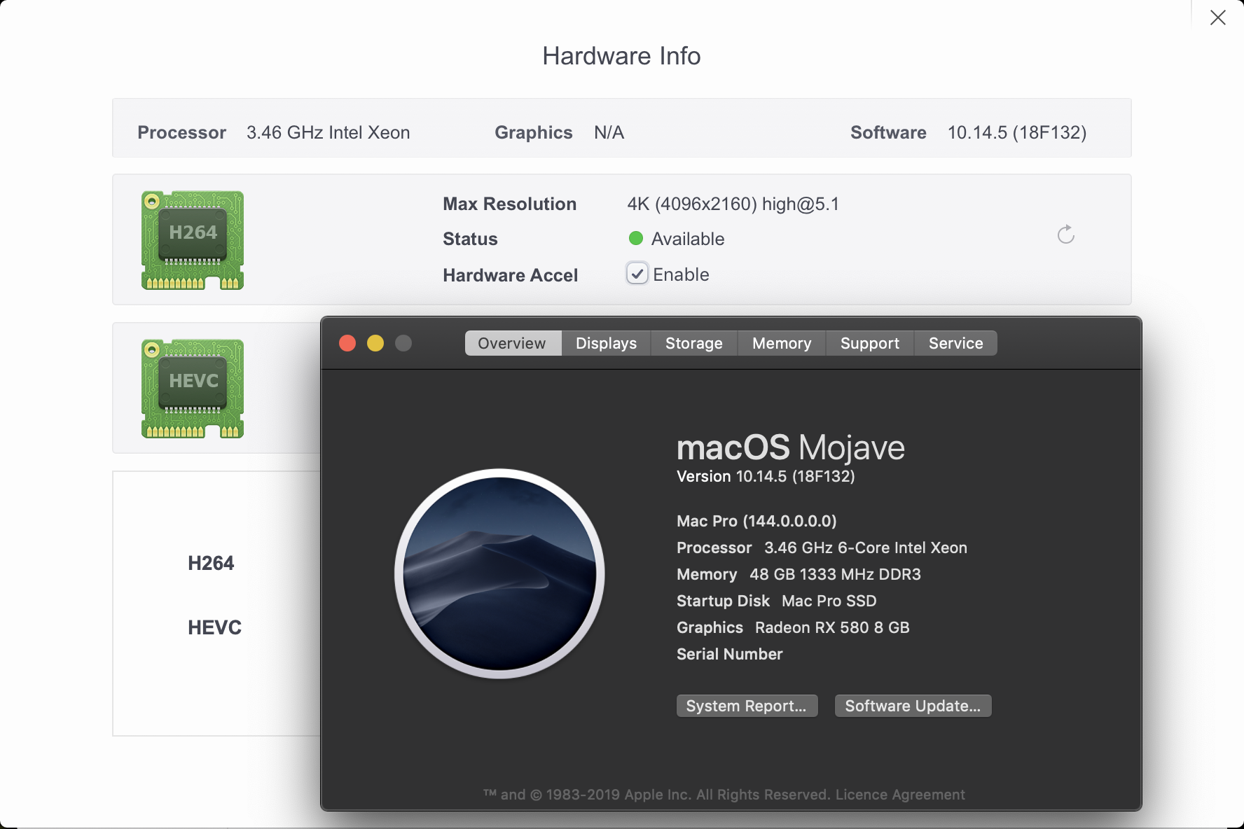

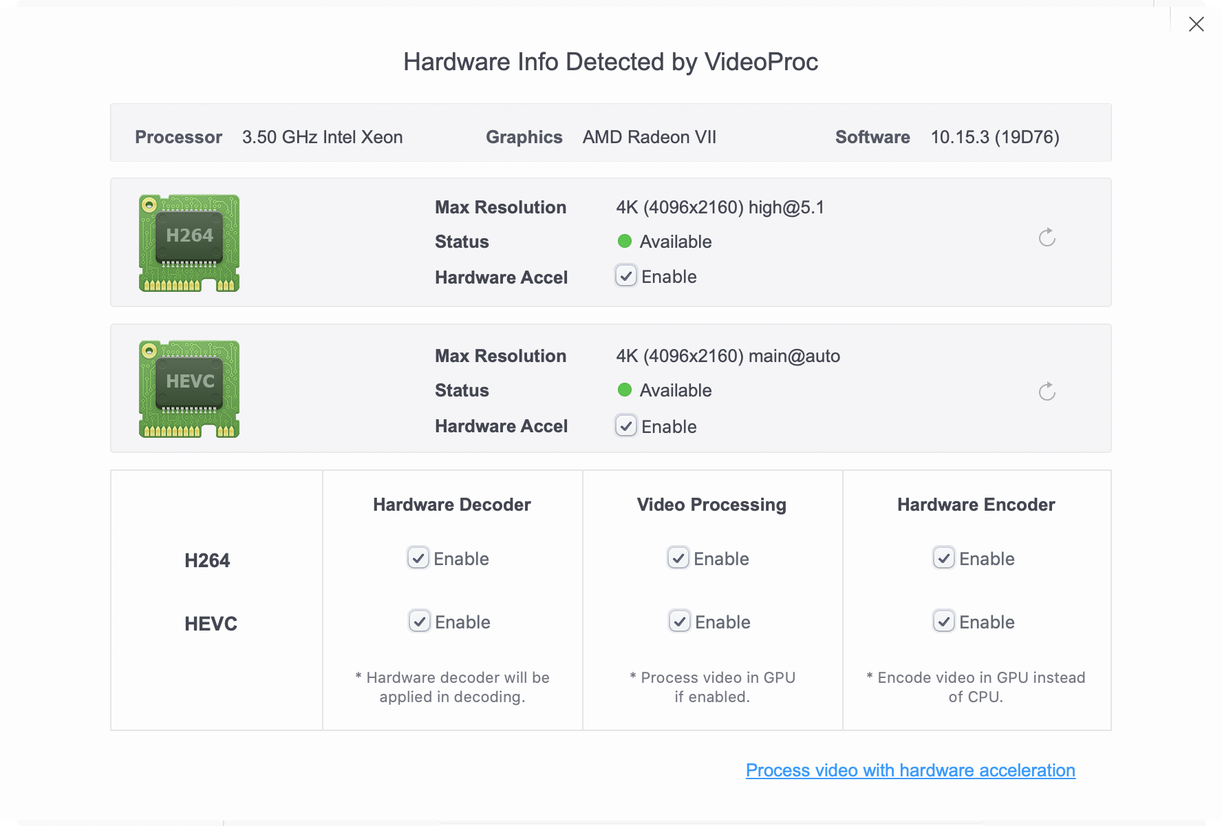

Q19: Why VideoProc shows no HEVC decode after the mod?
A: I don't know why, but this is normal in this case. My recommendation is to download demo HEVC video from the above link, and play it via QuickTime (or simply via Finder preview). As long as the CPU usage only stay around 20% (but not 800%), that means HEVC decoding is working properly.
For those who use OpenCore method, you should able to see HEVC HWAccel avail. If not there, please click the little reload icon.

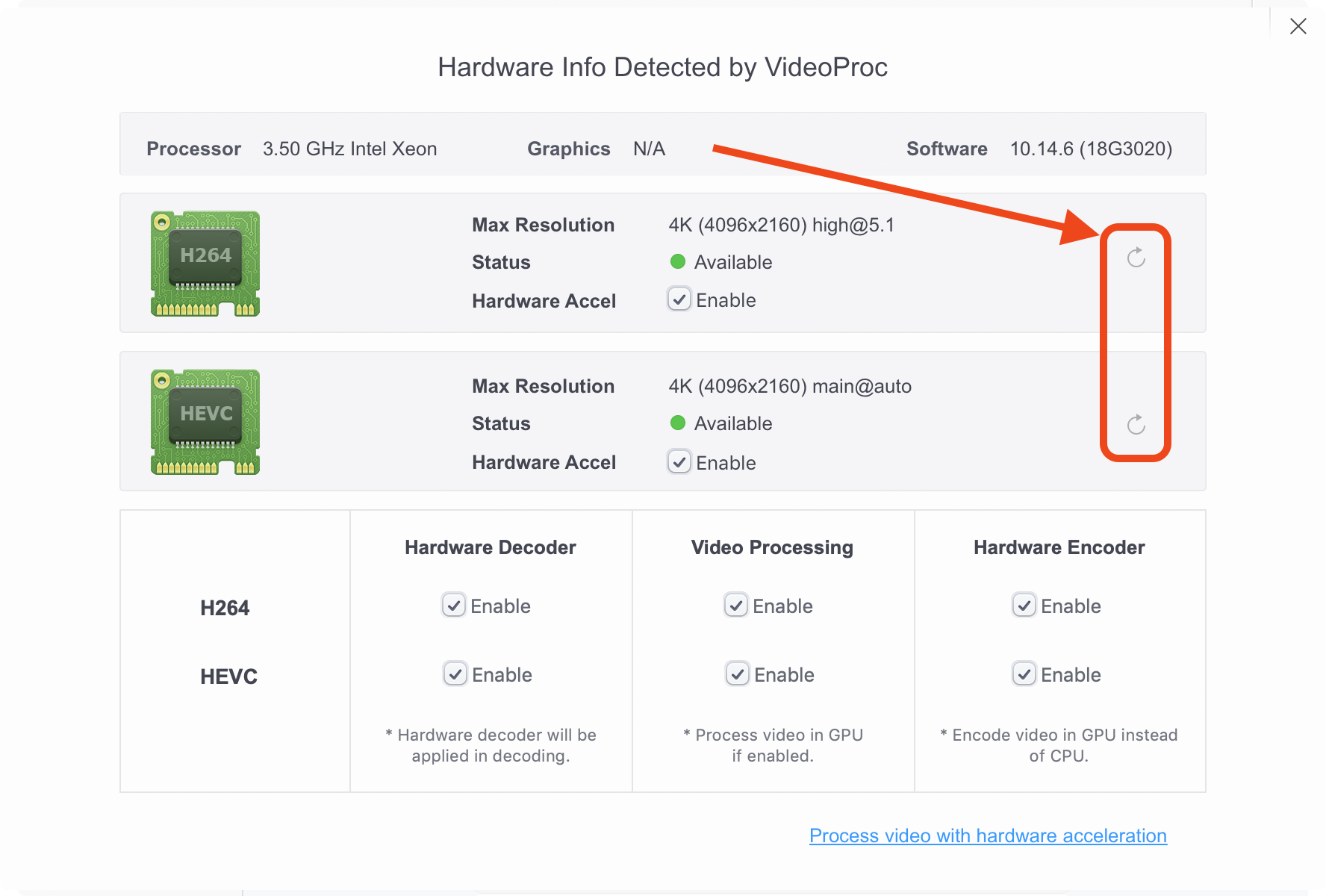

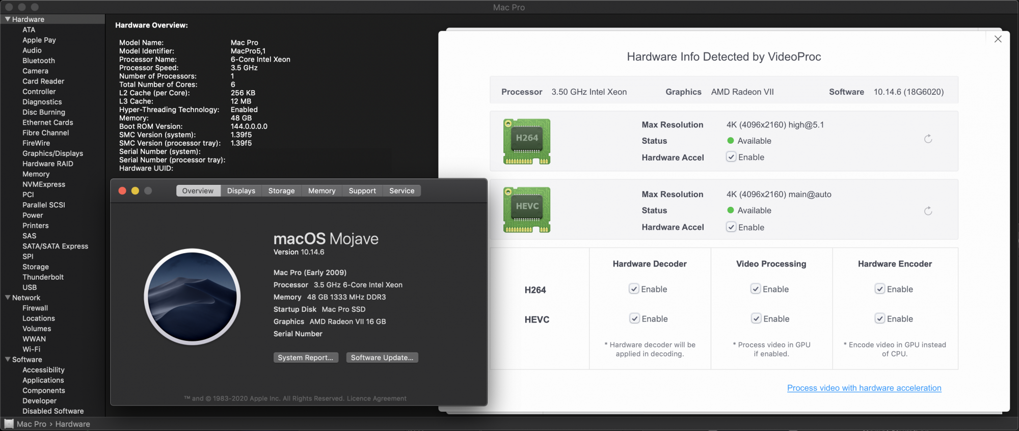

Q27: Why the "Graphics" in VideoProc HWAccel page shows N/A?
A: No idea, but it's just a cosmetic error in this case. (Update: It seems VideoProc looking for the key word "AMD". e.g. If the card ident asAMD Radeon VII
, VideoProc can show it properly. But if the card ident asRadeon VII
, then VideoProc can't show its name)
P.S. For those who want to add the prefixAMD
in front of they graphic card's name, please join the OpenCore thread. We can rename the graphic card to whatever we want in OpenCore.
Q28: Why VideoProc shows that I am use "Intel "HWAccel when converting videos?
A: Also no idea, but again, it's just a cosmetic error in this case. (Update: So far, it shows that VideoProc only knows if HWAccel is working (via VideoToolBox), but it can't tell which hardware is providing HWAccel in macOS. Therefore, it use a "one size fit all" solution. Due to most Mac out there use the iGPU Intel Quick Sync to provide HWAccel. VideoProc seems only will displayIntel
whenever HWAccel is in use, regardless if the computer is actually using AMD VCE / VCN, Intel Quick Sync, or even M1.)
Q29: Why VideoProc shows nothing activated but everything seems working as expected?
A: As long as you can see this tick, which mean HWAccel is activated. From my observation, this tick always change automatically.
For the Hardware Info Detected page, please click the little reload icon in order to let VideoProc to show you the latest status.

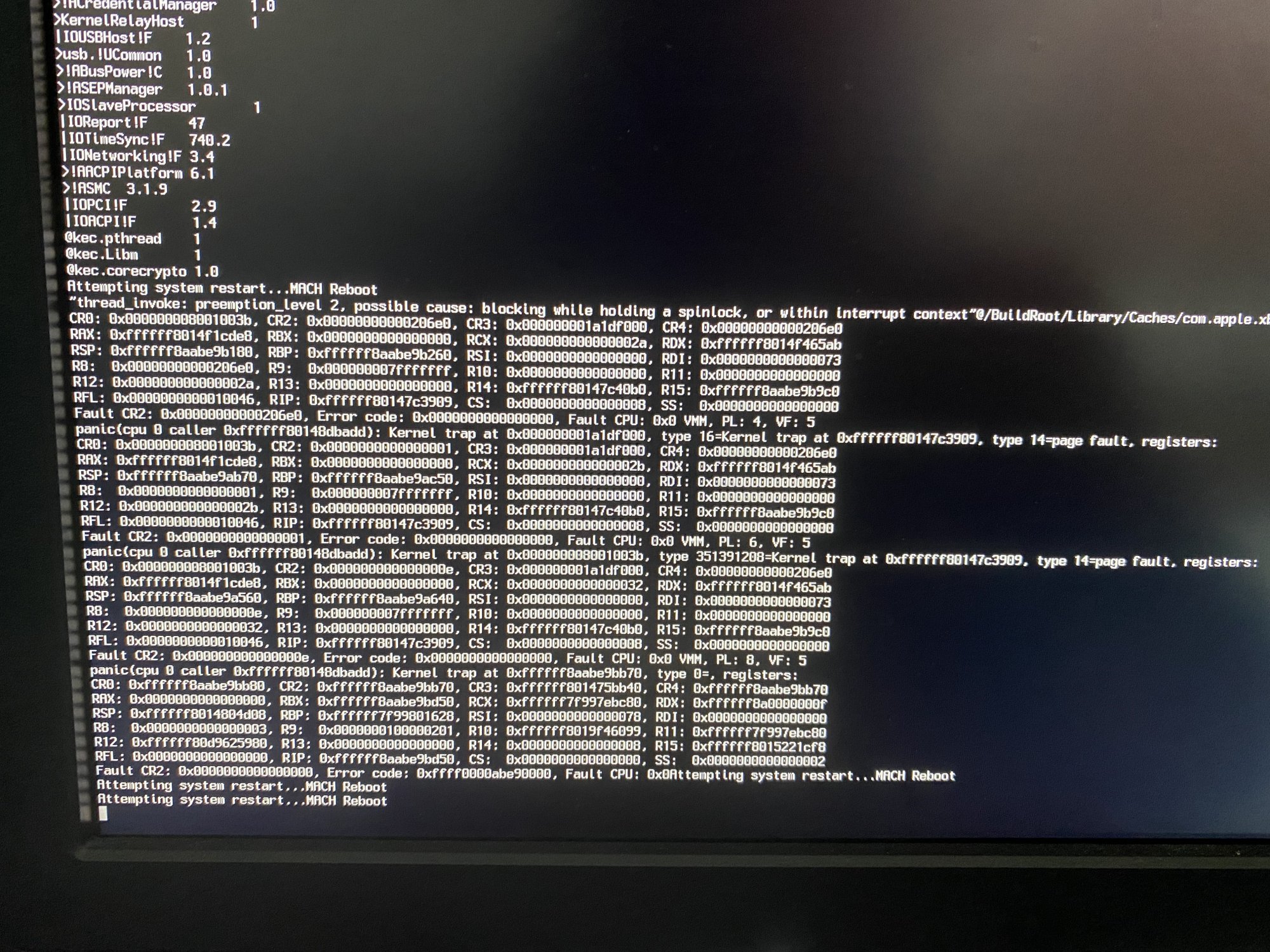

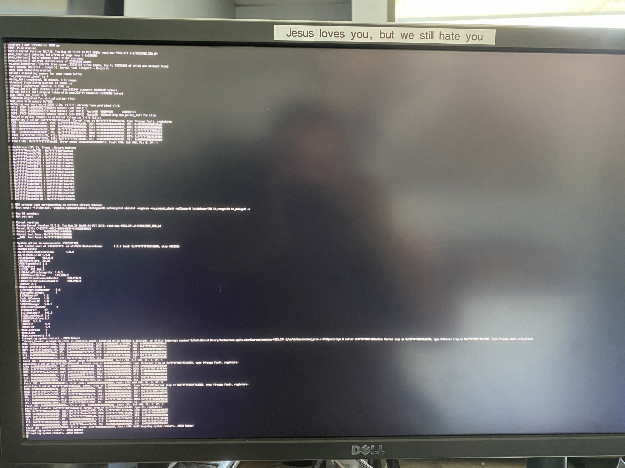

I am unable to boot after the restart. Here’s what I think I did wrong: In step 5 I think I accidentally copied the Whatever Green folder into the Lilu kext contents folder rather than the Whatever Green kext itself.
My system loads the boot selecter and then it just hangs on the Apple logo. If I try to boot in recovery, it just hangs about 50% of the way through the progress bar. So far, I’ve reset NVRAM 3 times per some of the posts I’ve read but to no avail. I am running latest Mojave on an m.2 PCIE drive. I have a 5 drive RAID5 in the SATA ports using SoftRAID that I have disconnected just in case. The system was running fine prior to this. I upgraded to Mojave using the instructions in #1314.
