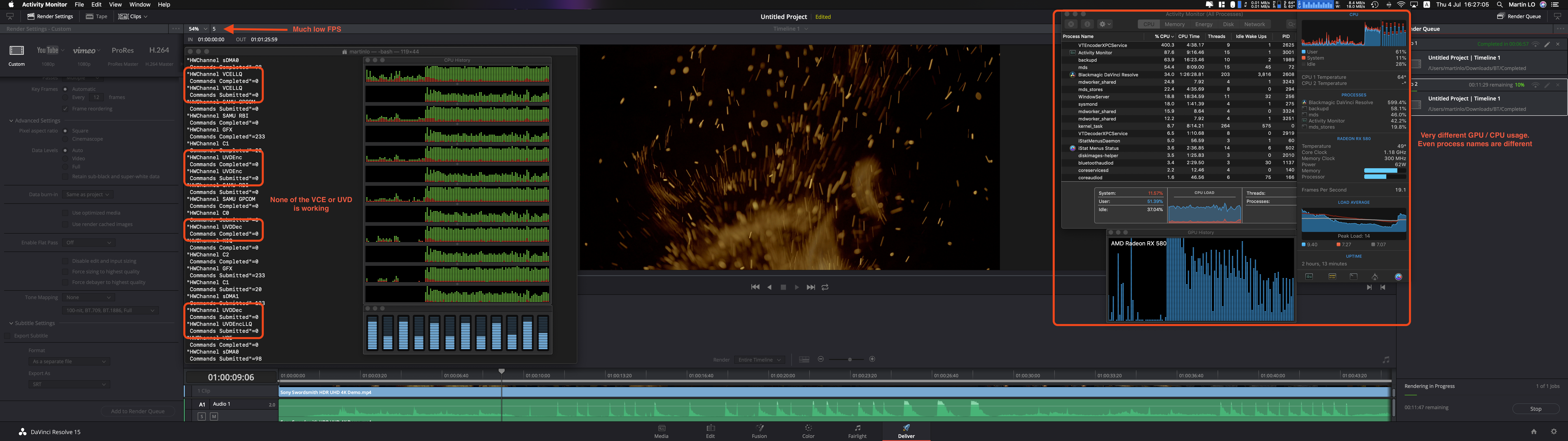

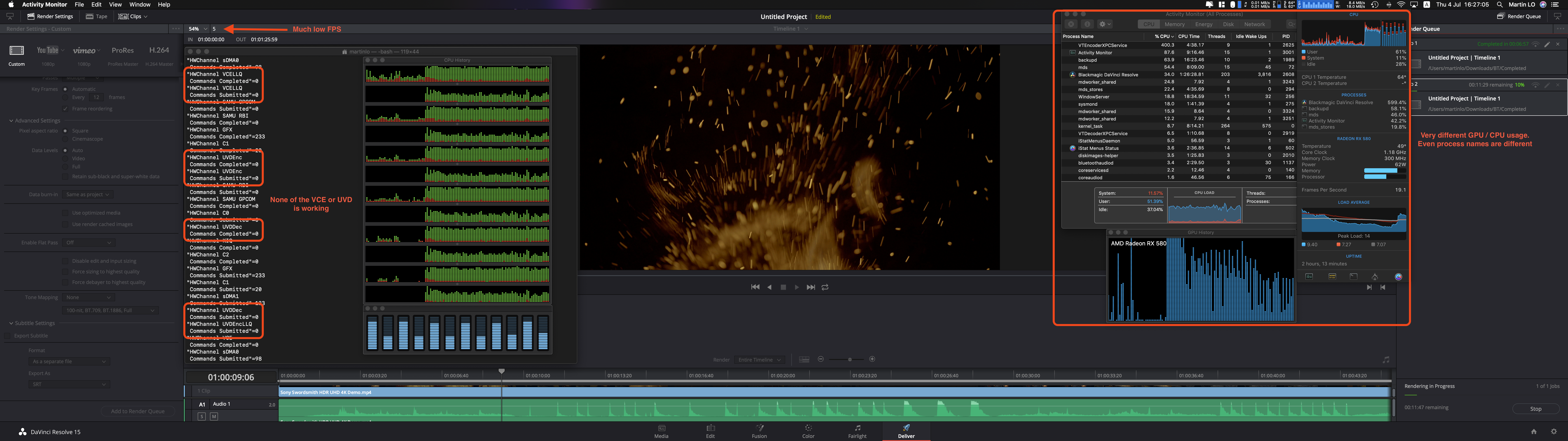

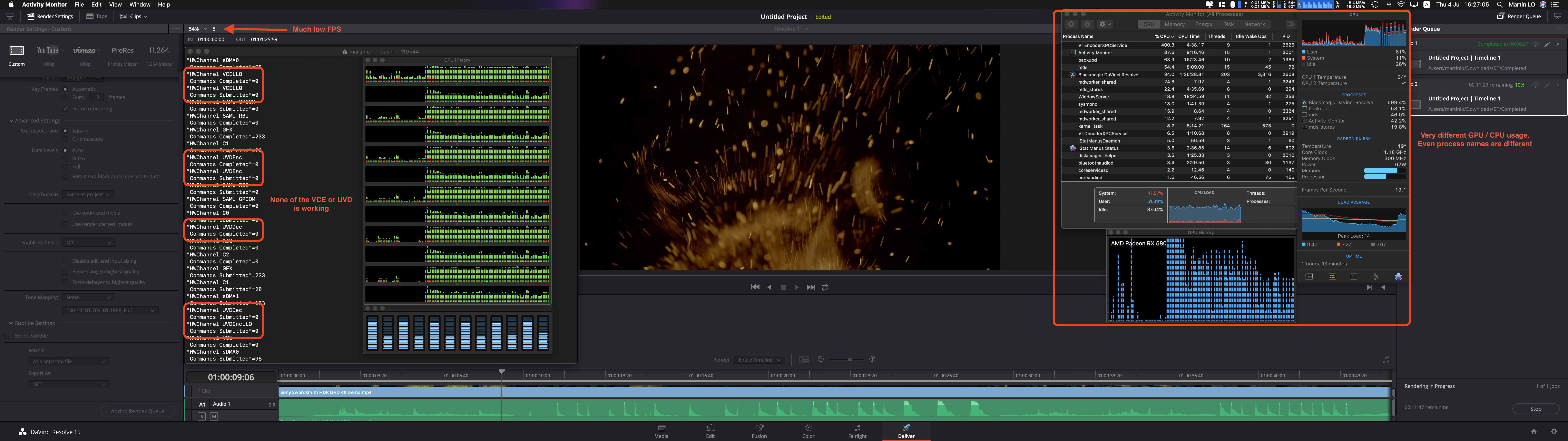

No it won't. Without hwaccel, DV can NOT utilise the GPU video engine for H264 on cMP.
I just make a quick test by importing the Sony 4K HEVC 10 bit HDR video (link in post #1), and export to H264. As I said in post #1 Q&A, "the GPU is working" is not equals to "the video engine is working". By default, DV can only use GPU to compute / rendering (drawing each frame), but not really able to use the GPU to decode any H264 video, or use the GPU to encode each frame into H264. (Of course, I am only talking about in macOS, and on cMP)
This is WITHOUT hwaccel mod. (I didn't realise that I didn't capture the export setting properly. But I didn't change anything. Identical setting as per the 2nd capture below)

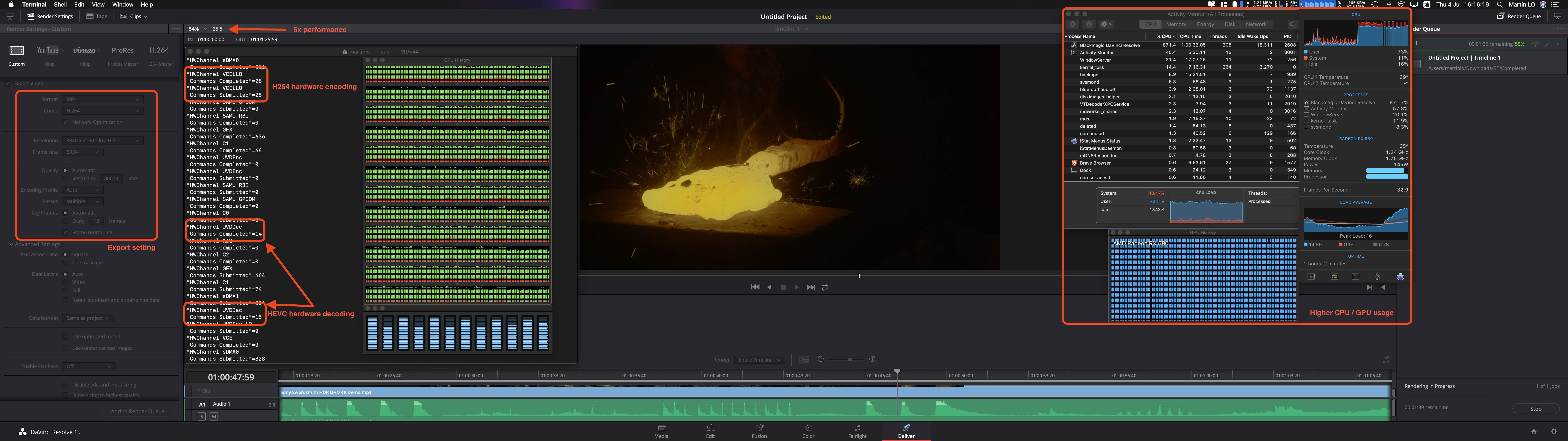

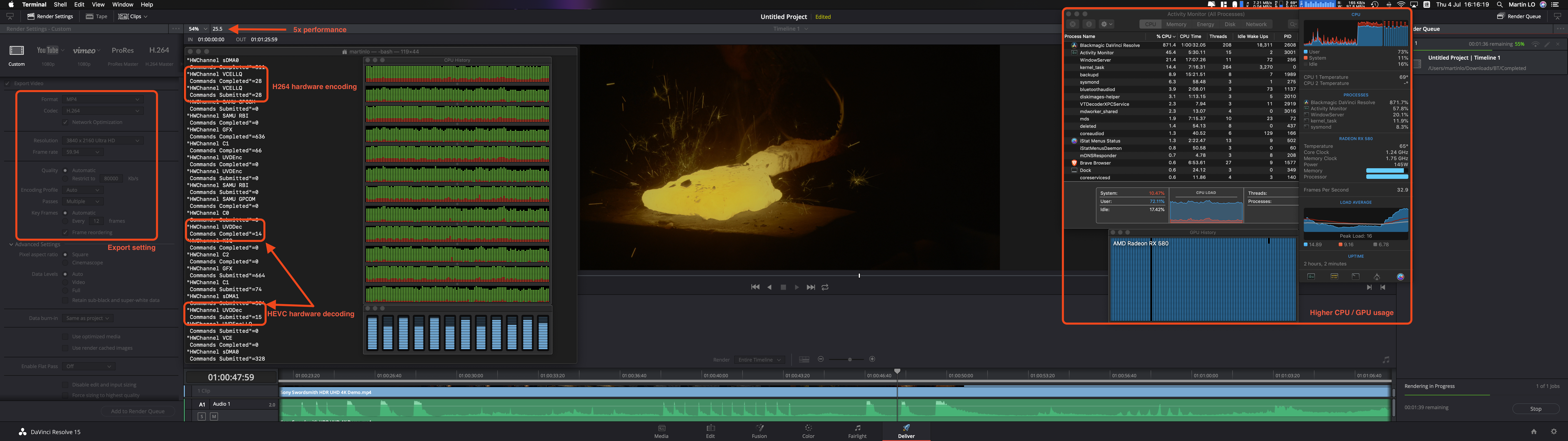

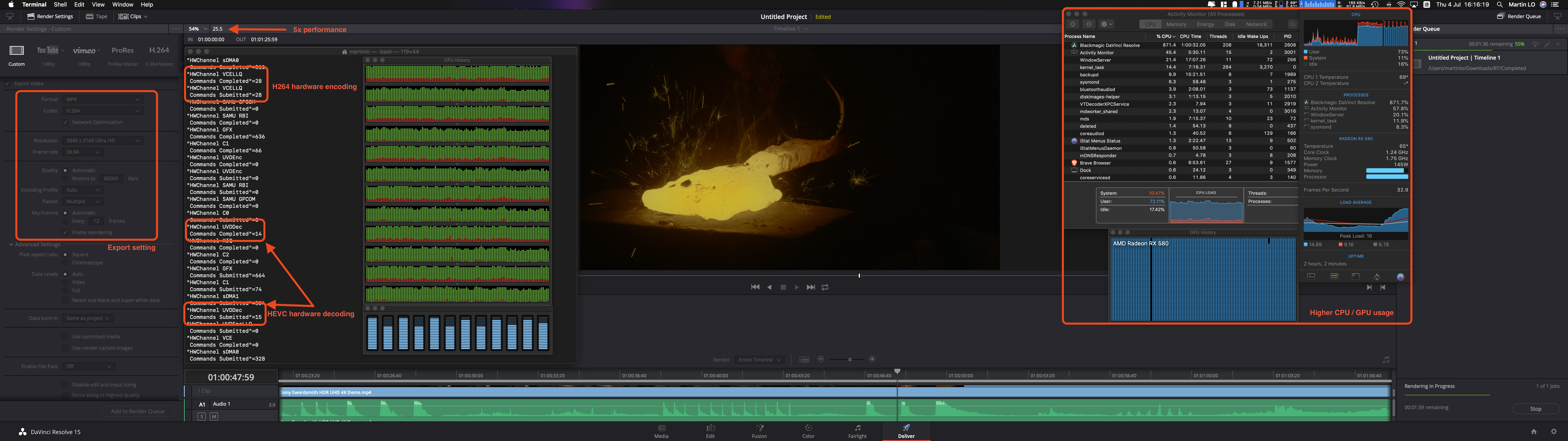

This is with hwaccel mod
