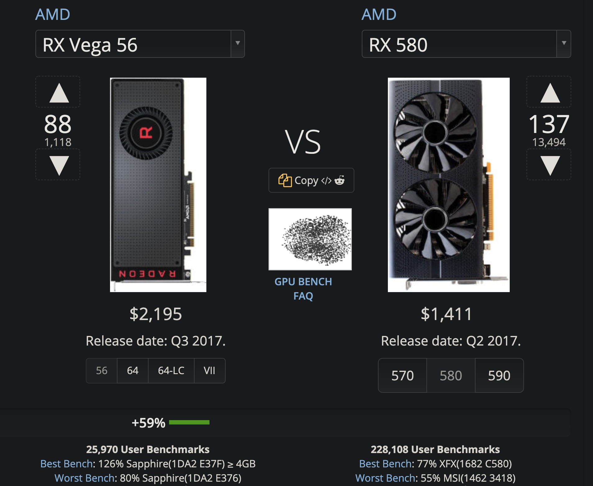

In your opinion; is Vega56 equal, faster or less than the RX-580? I maybe thinking of building an eGPU for my Macbook Air and transplant the RX580 into it and get a used Vega56 to put inside my Mac Pro if that is what it takes to get hwaccel.
Vega56 should be quite a bit faster indeed.

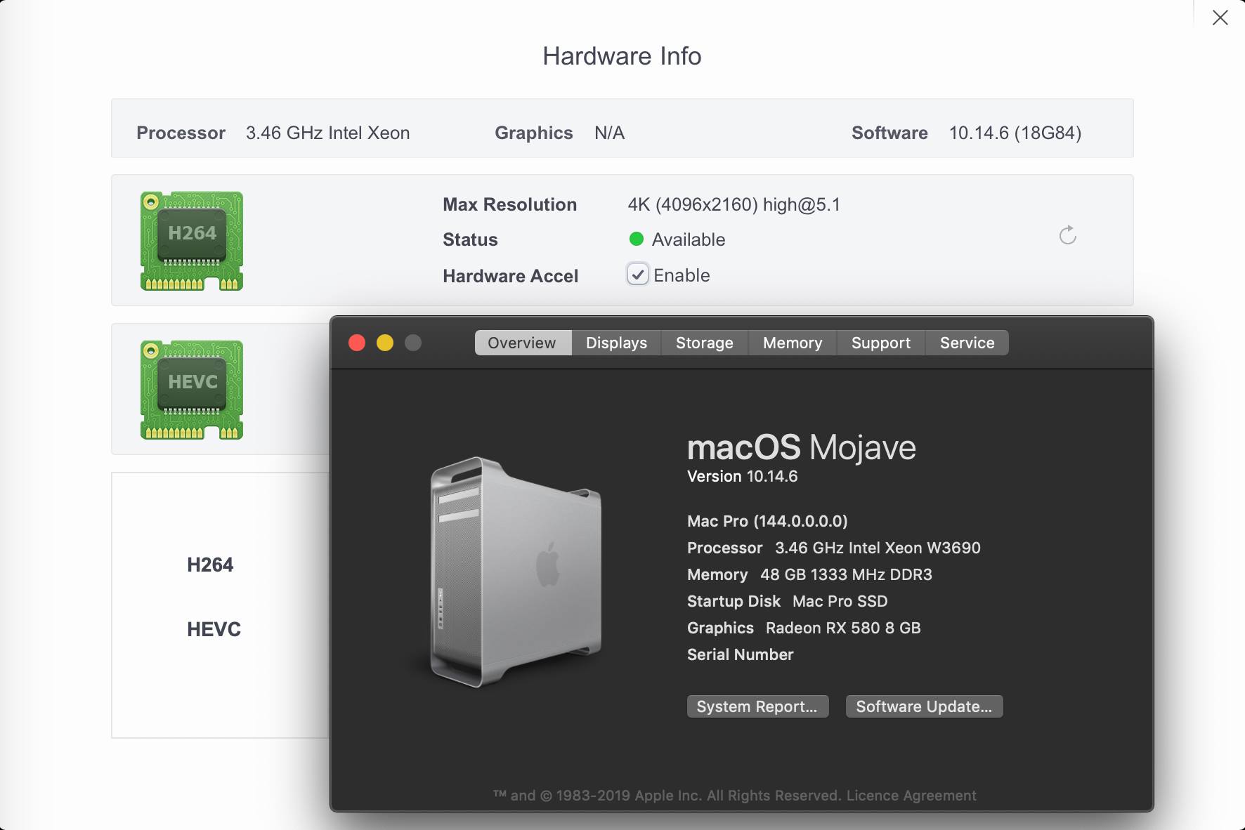

Reactions: iluvmacs99

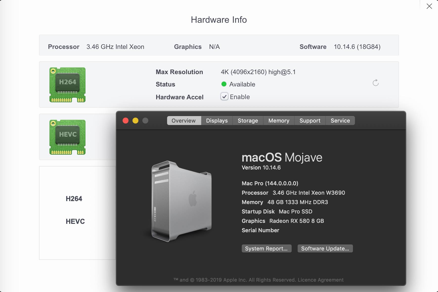

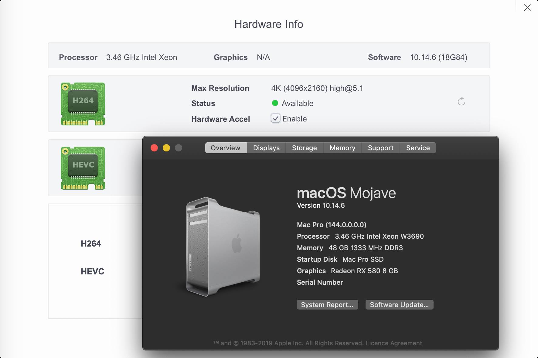

I tried again the Lilu+WhateverGreen method after installing 10.14.6 and it seems that all is good now!
Finger crossed...
Reactions: h9826790
Finger crossed...
Thanks, please use it for a few days and report back if it's stable.

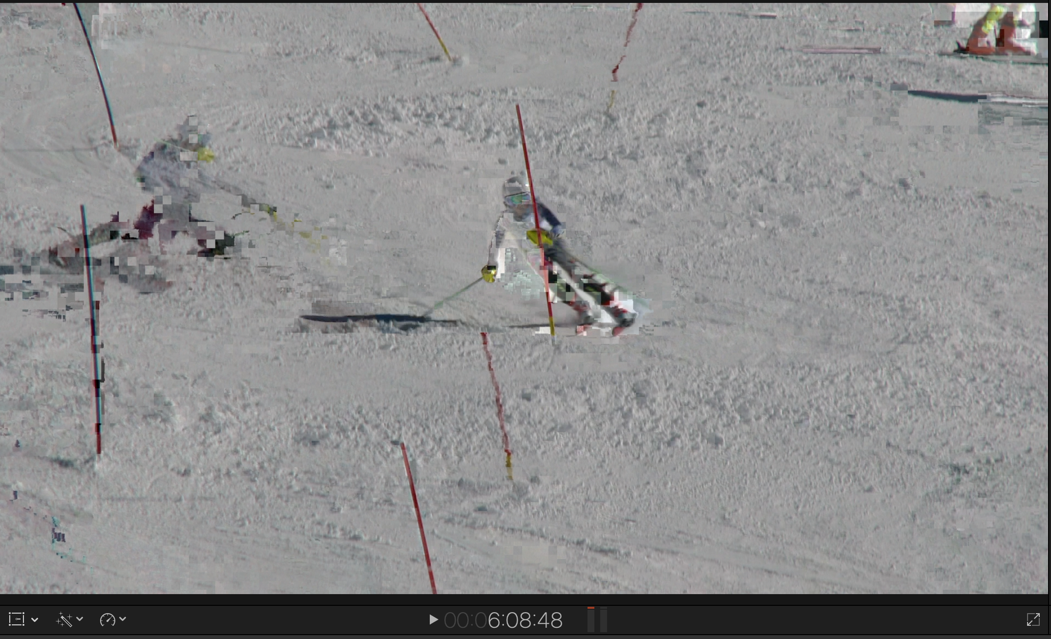

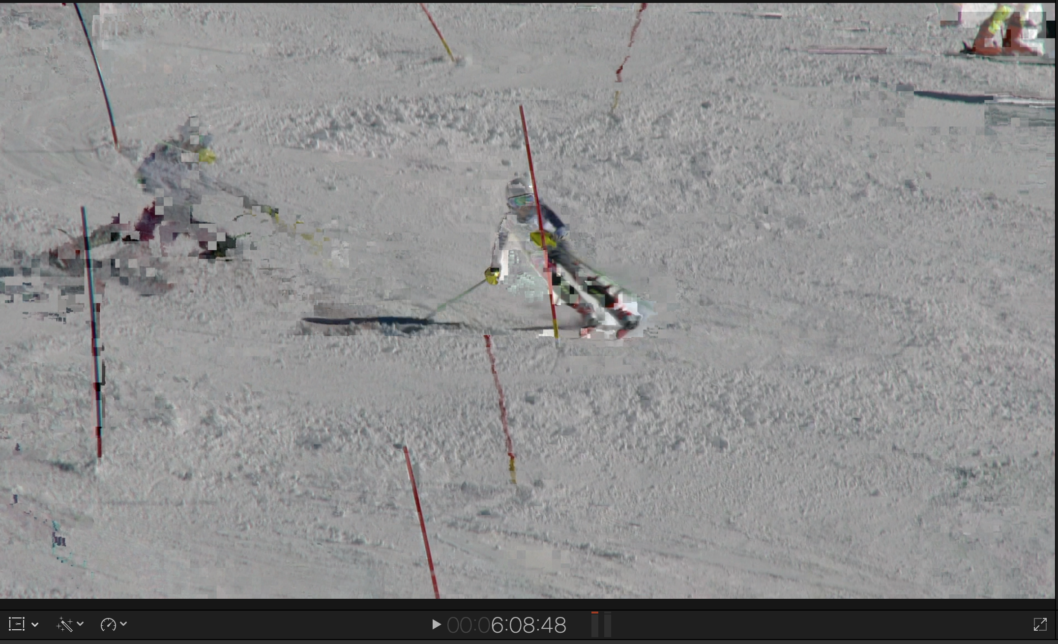

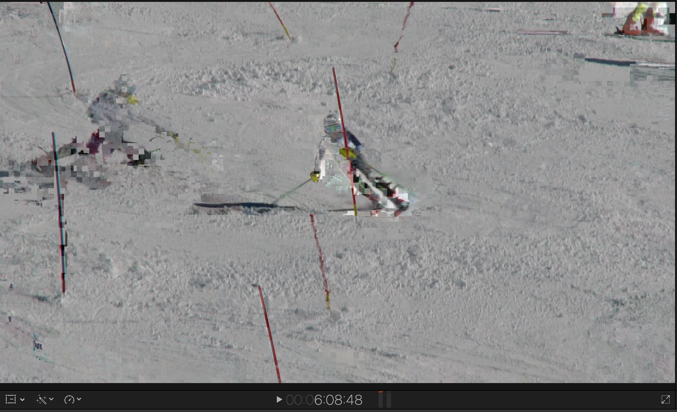

Some little problems during editing frame by frame, like this...But when I press play, I don't see these artifacts. Now i'm exporting and will see if there are same problems also in the final result
EDIT: ahi ahi ahi...also in the final result I see artifacts every 1 second!
Do you mind try the Hex edit method? I really want to know if that make any difference.
