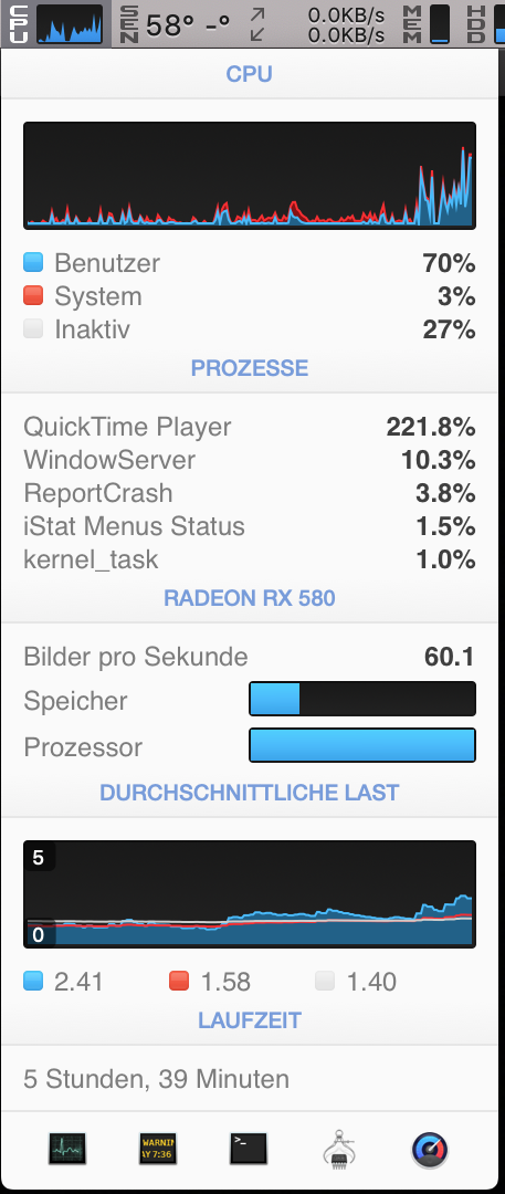

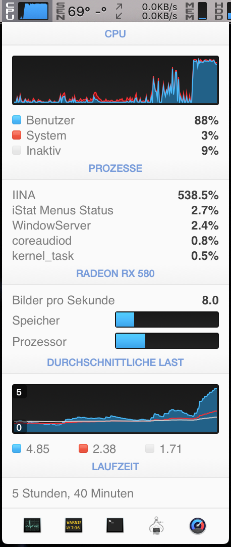

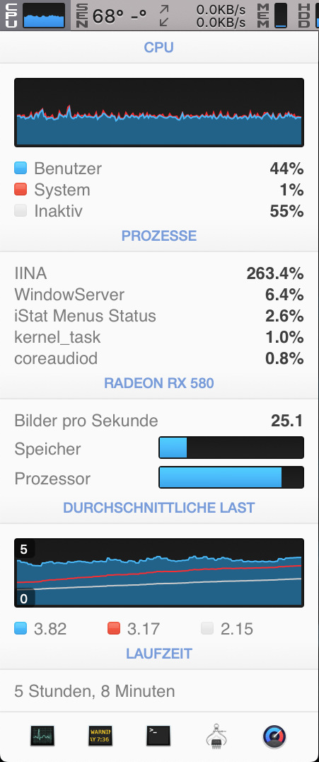

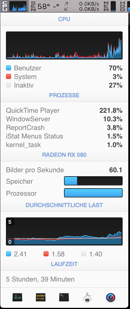

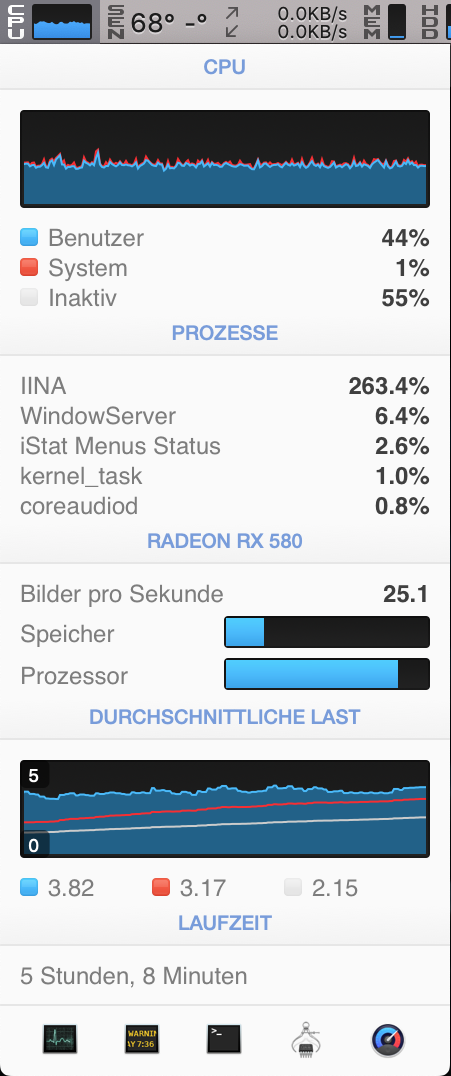

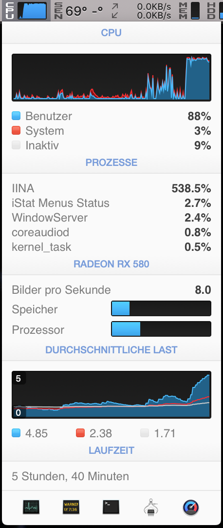

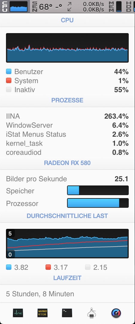

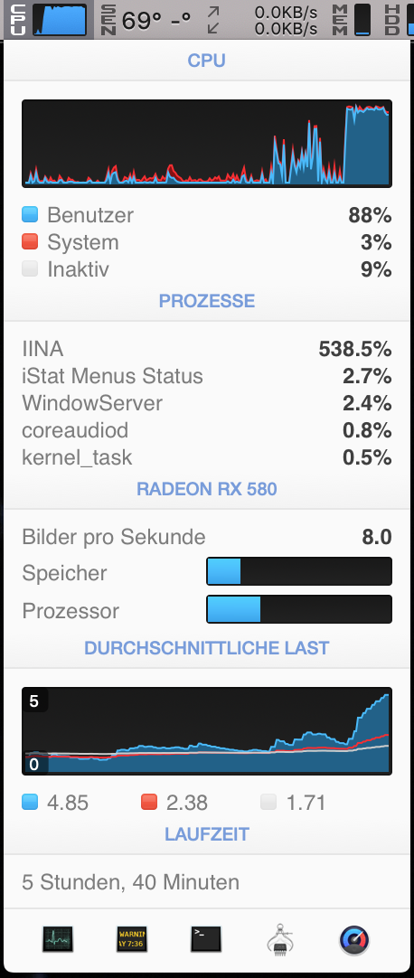

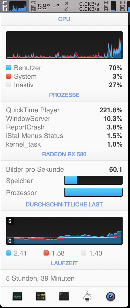

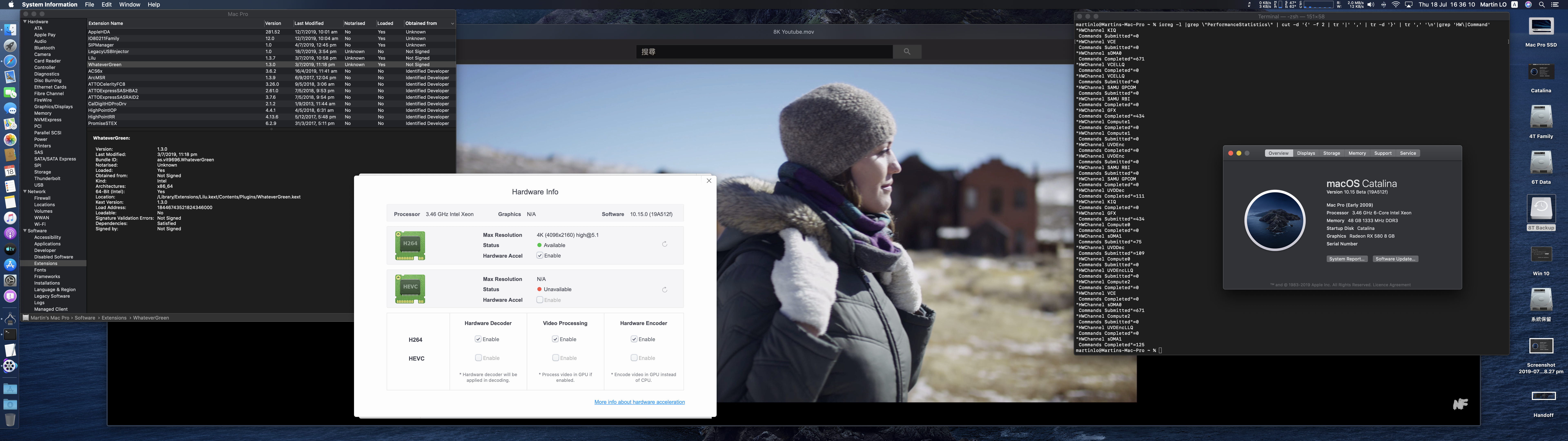

Yes, the Mac Pro with RX 580 fails to play correctly the Swordsmith video without hardware acceleration.
Interesting while QT Player stresses the GPU, Iina stresses much more the CPU, but both fail.

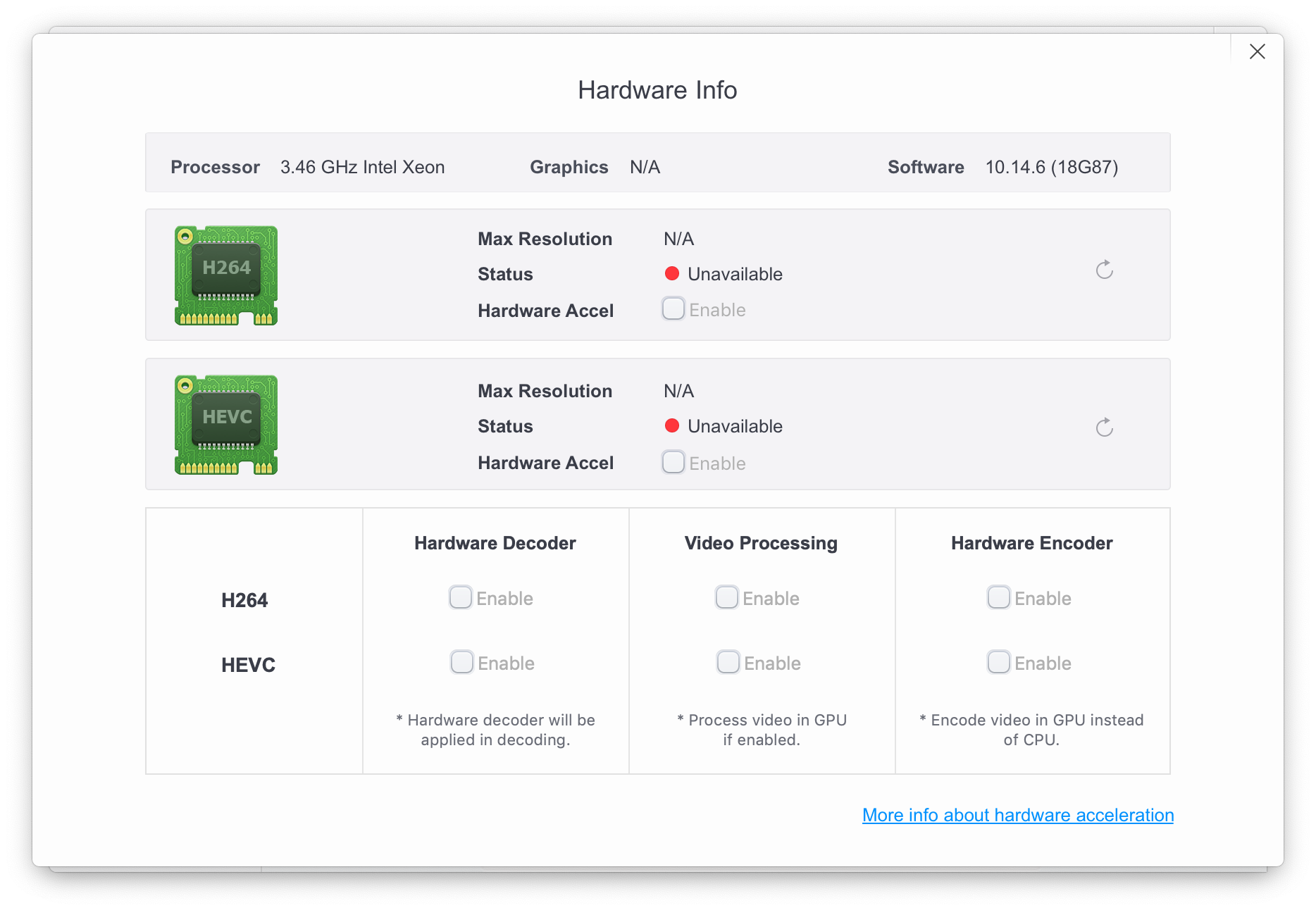

Now with a fresh installed EFI RX 580 in my Mac Pro I have a question.
My macOS 10.14.6 is (yet) totally unpatched, and VideoProc of course indicates no hardware acceleration:
But when I play h.264 footage e.g. with VLC it indicates no some CPU usage and the RX 580 does all the work:
Does that mean h.264 hardware decode acceleration is working without any patching in macOS 10.14.6 ?
