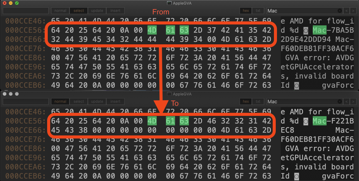

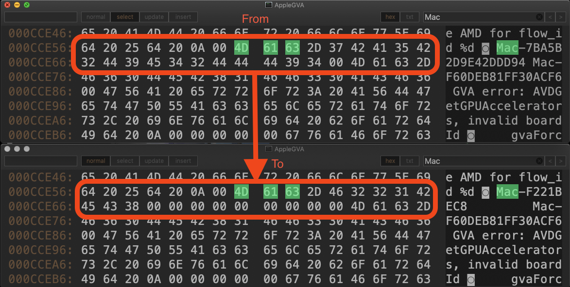

1) Open the AppleGVA file by a Hex editor.
Replace BOTH iMac Pro's board-id by the cMP's board-id

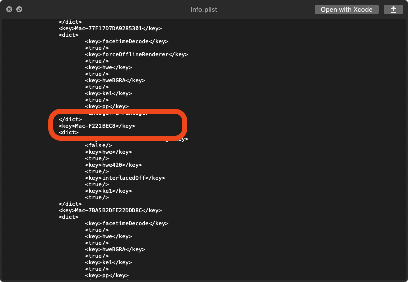

2) Open Info.plist by text editor.
Replace the iMac Pro board-id by the cMP's board-id
Reboot. (REMOVE all Lilu, WEG, and boot arguments if applicable)
Then the cMP will also able to use hwaccel without Lilu and WEG.

P.S. you may need to run the following command after editing the AppleGVA file
Code:
sudo codesign -f -s - /System/Library/PrivateFrameworks/AppleGVA.framework/Versions/A/AppleGVA

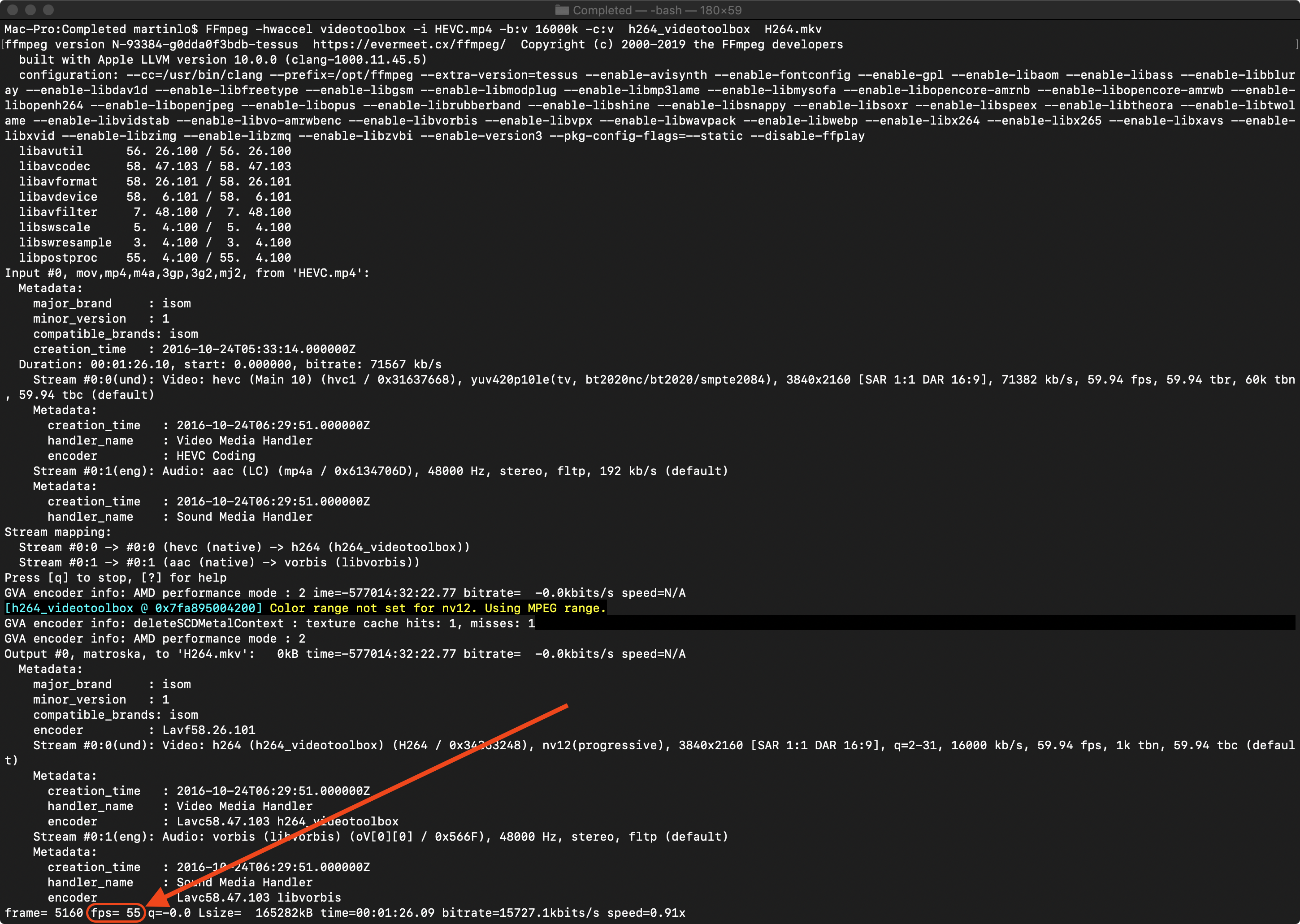

Thanks, you just remind me that I can make a performance comparison of the RX580 and Radeon VII (of course, about the HWAccel performance, but not gaming, etc).
Both done on my cMP, same CPU, same RAM, same SSD, just the GPU is upgrade, and Mojave minor update.
Both tests convert the same Sony HEVC 4K video to H264, with the same command in FFMpeg
Code:
FFmpeg -hwaccel videotoolbox -i HEVC.mp4 -b:v 16000k -c:v  h264_videotoolbox  H264.mkv
For RX580, 24FPS
For Radeon VII, 55FPS

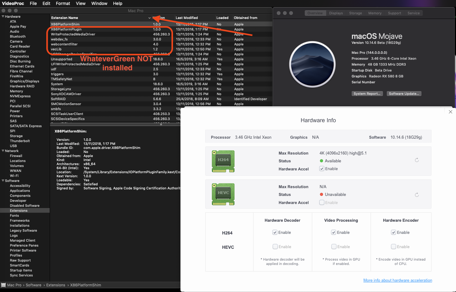

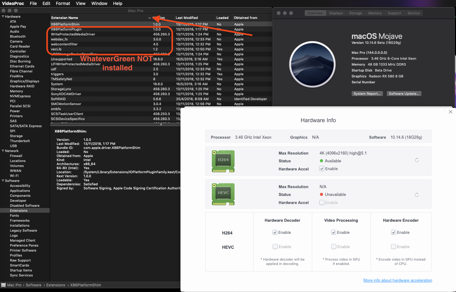

Okay, so I did the Alternate method and downloaded the trial VideoProc app. My GPU is Sapphire Radeon Pulse RX580...
VideoProc says Acceleration is enabled for h264 but unavailable for HEVC. Is that normal for my GPU?

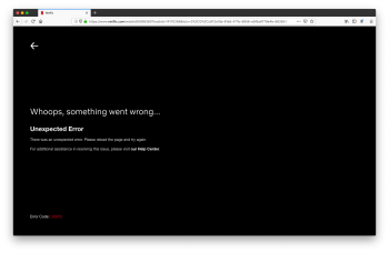

Now Safari plays Netflix again instead of previous HTML5 / Silverlight error. It starts with video, screen goes solid RED, and audio keeps playing. If you move the scrubber on the bottom, the position locater displays small video frames as you rollover. Too bad it doesn't fix that altogether... At least I know it did something.

VideoProc shows no HEVC is normal: #397 (but you should have decode acceleration)
You can test with "sword-smith" video to test HEVC decode acceleration (encode never work).
Nice to finally hear that there could be some hope for Netflix on Safari! Any ideas why the video doesn't stick?
None at all. I was very surprised.
On a related note, a long tine ago I purchased a media streaming app called Friendly Streaming. It stopped working the same time that Safari/Silverlight stopped working. After doing the Hardware Accel Mod, the app (Friendly Streaming) now works with Netflix again. This was a welcomed (even if no longer needed) surprise.
I can only guess that Apple when out of their way to break Netflix/Safari compatibility.
Reactions: foliovision

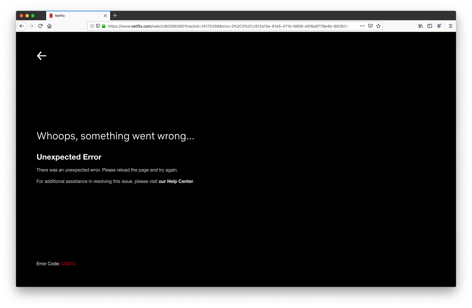

Firefox stopped working with Netflix. Googling the UI3012 error code, it seems to be a Networking problem. So rebooting, and confirming a proper network connection resolved nothing. Chrome and Friendly Streaming still working properly.
