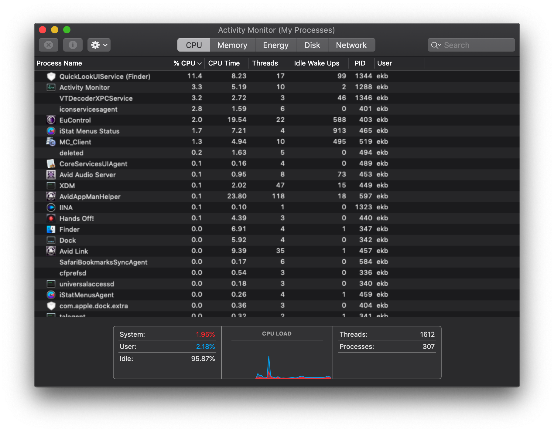

I did Lilu method
It acted strange at stage 14
After restarting my computer was laggy as hell, videoProc took 5 minutes to open and after opening :
But somehow in Sony 4k test file it shined and cpu process was just 11%
So it worked but not completely

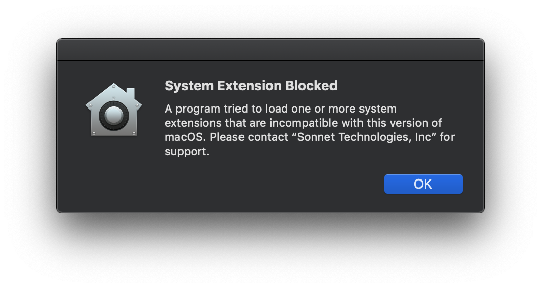

by the way I deleted Lilu.kext and I did NVRAM reset, I checked them if they performed or not
after reseting NVRAM macOS gave me notification like this :
means SIP enabled again
and thanks again for telling me that" booting into recovery doesn't need macOS EFI GPU"
I used that to disable/enable SIP with my RX580 as well as Clean installing Mojave without boot screen
I never thought it is possible

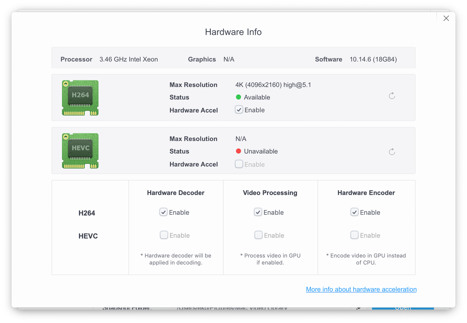

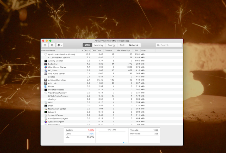

MapleGreen
macrumors member
Jun 25, 2019
90
8

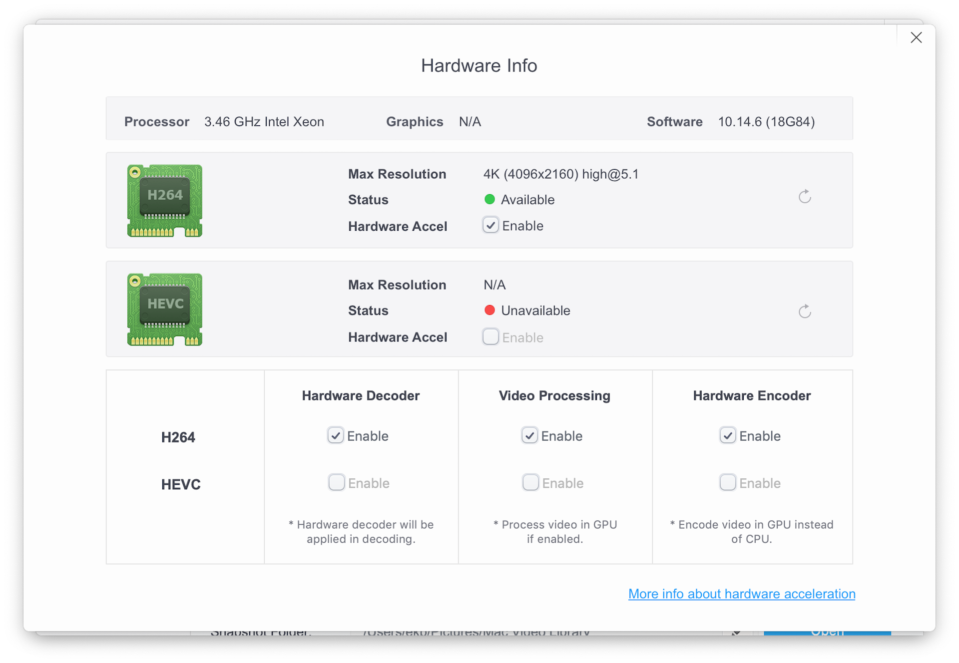

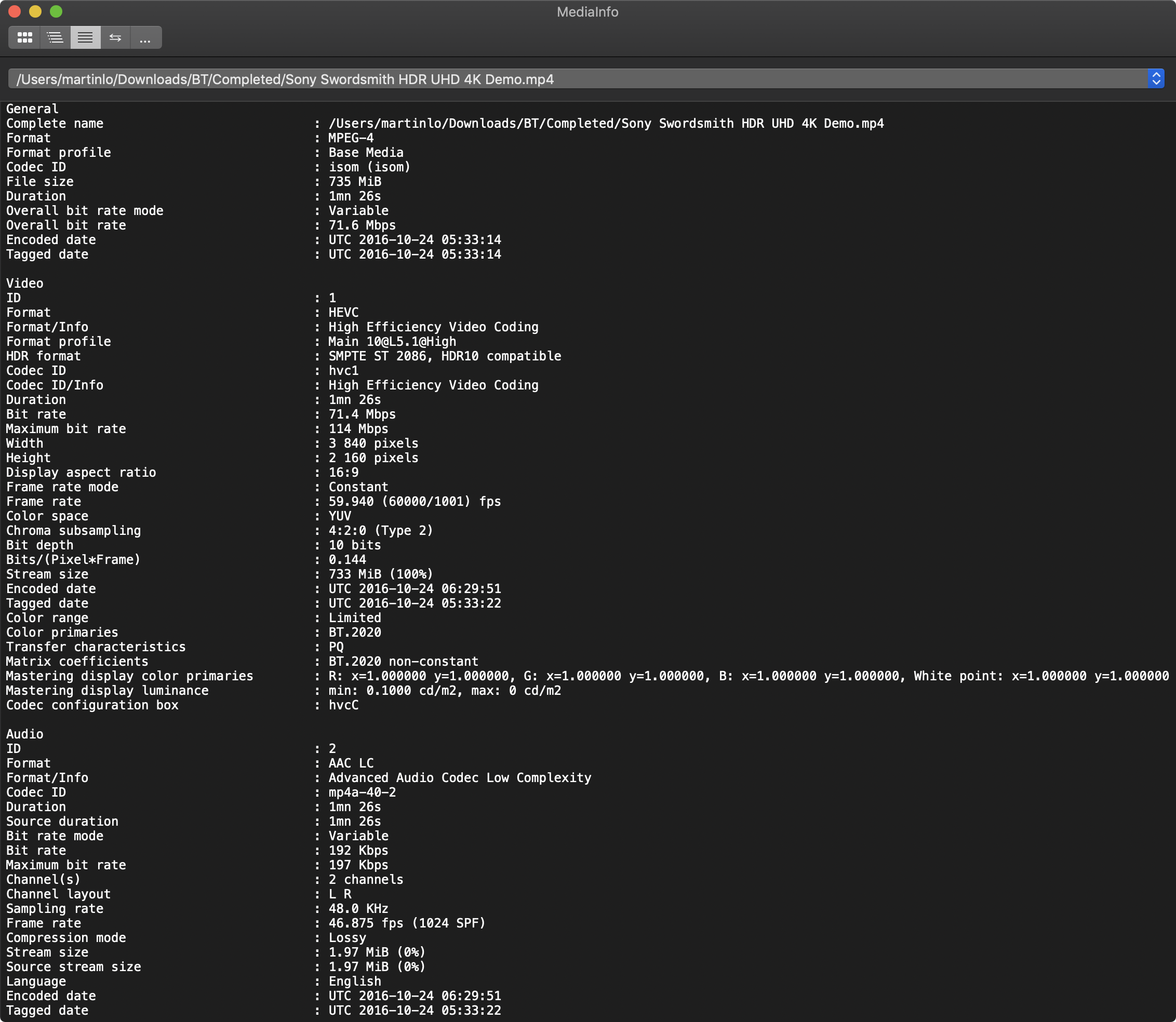

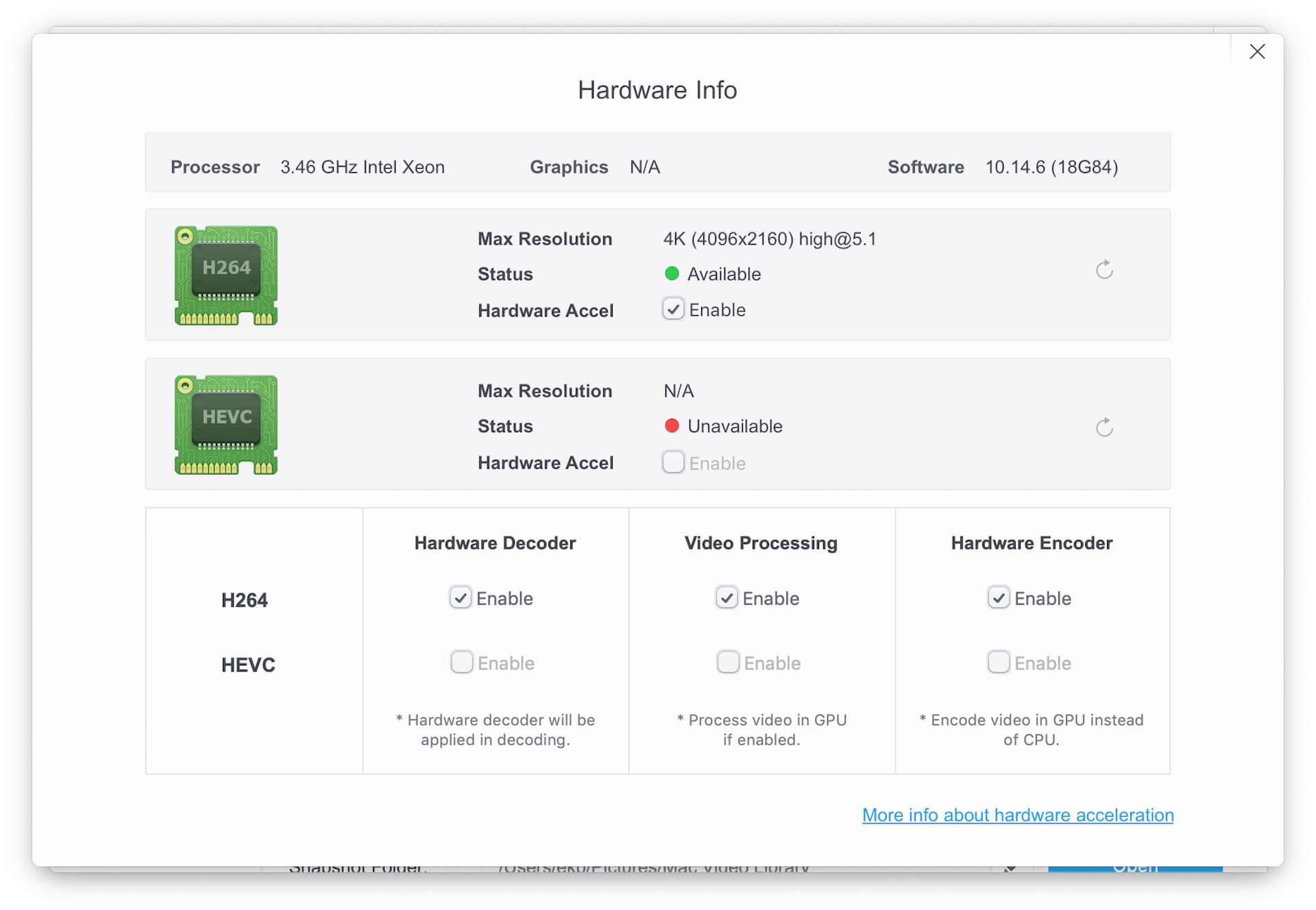

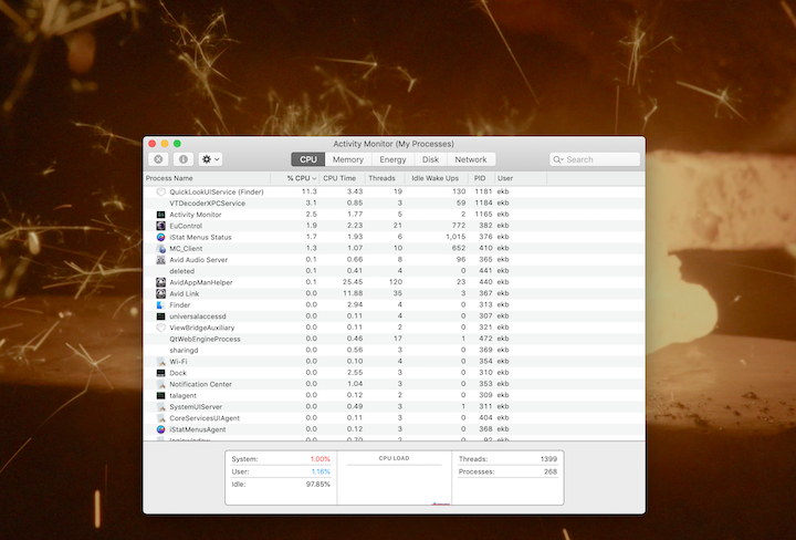

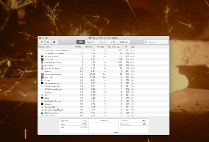

update :
I just managed to do the Alternate Method
H264 is activated
and in Sony Swordsmith HDR UHD 4K Demo CPU process dropped to 11%
until now everything works OK
so what about HEVC Codec? (I have RX580)
