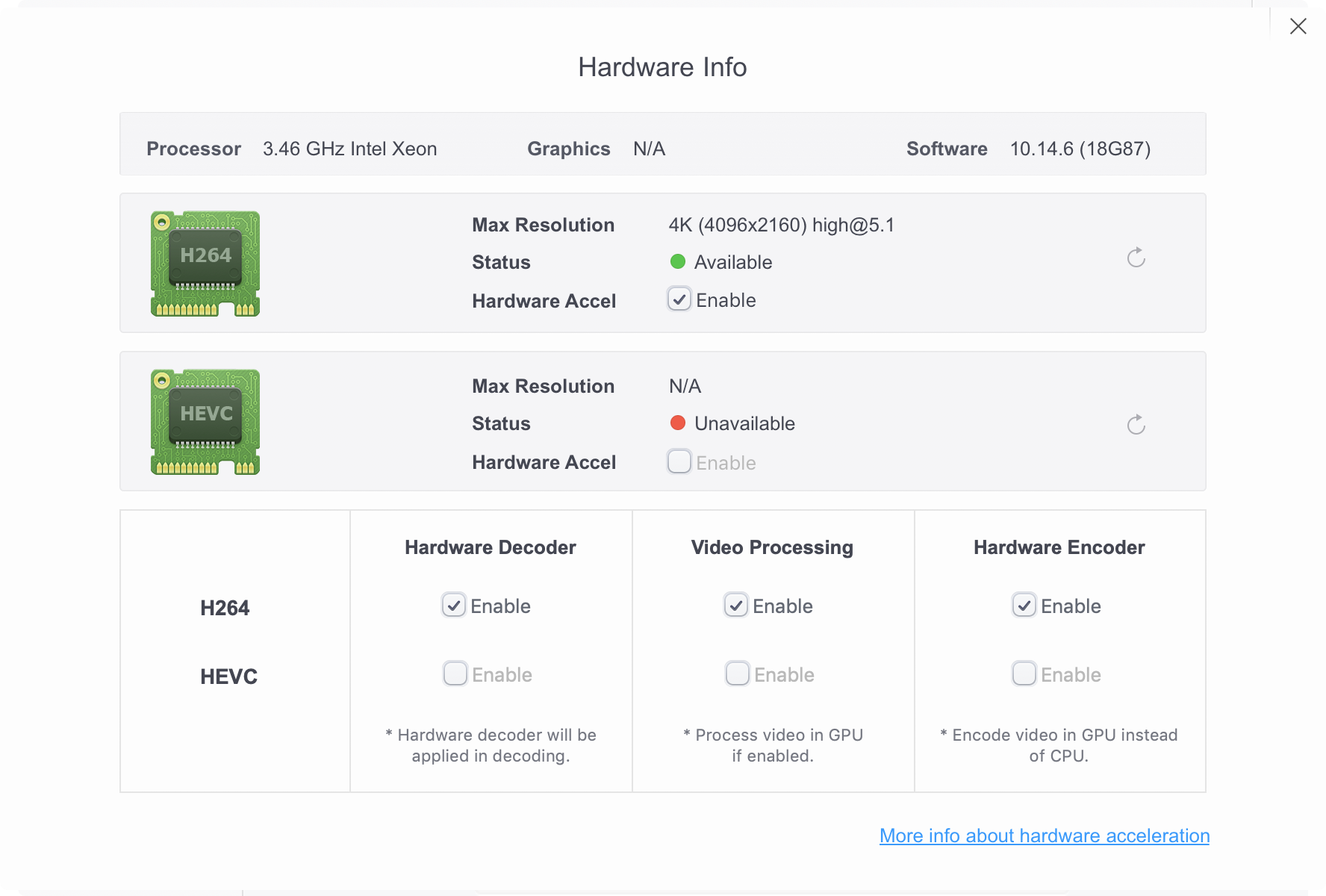

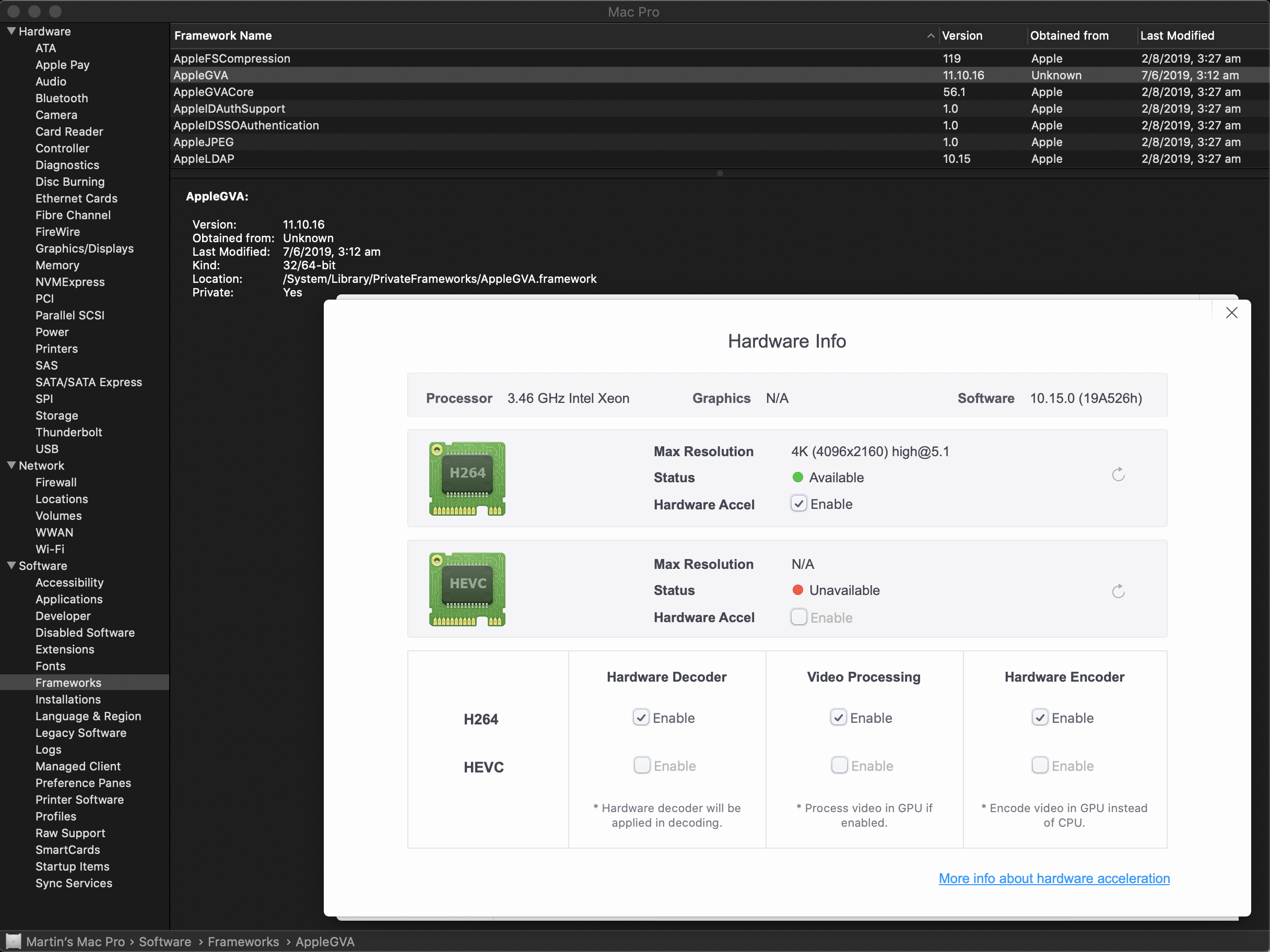

Just did a little test in Catalina DP5. The board-id injection method still works. But again, only H264 hwaccel work flawlessly, HEVC hwaccel is still completely disabled.
But the funny thing is. If I replace the AppleGVA.framework by the 10.14.6 version, I can achieve exactly the same result (with NO board-id injection). I know it's not a good way to do it. And I have no idea if this has any adverse effect yet (especially this is the only framework that has 32bit code). I just did this few minutes ago. No stability test yet. But at least good to know if Lilu method fail, we still can have some kind of backup method to make it work.

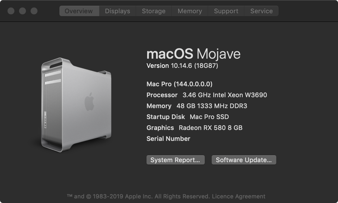

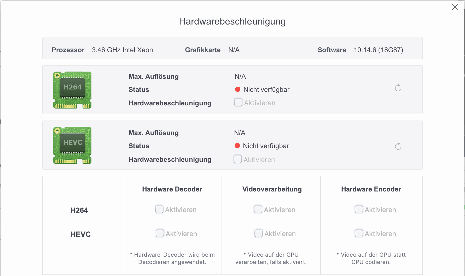

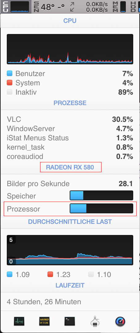

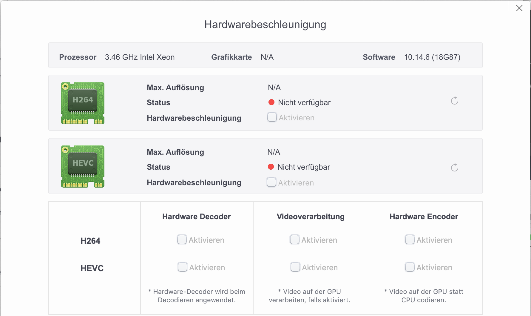

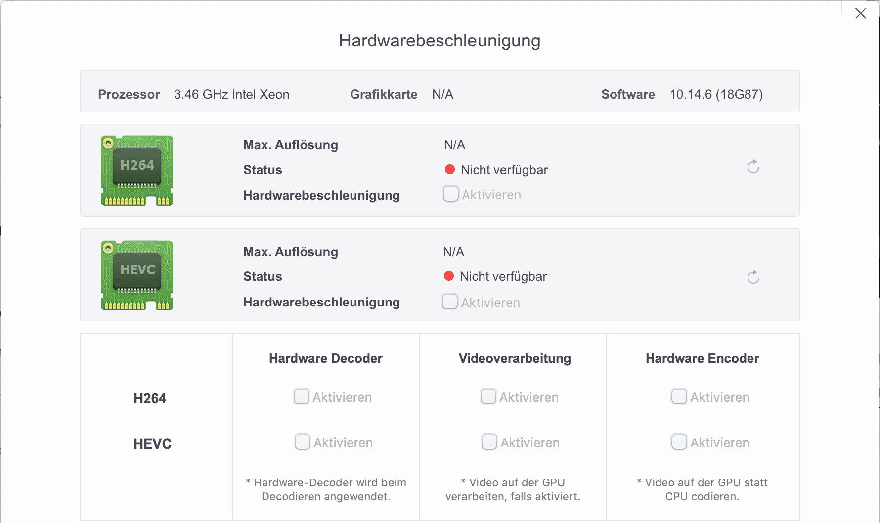

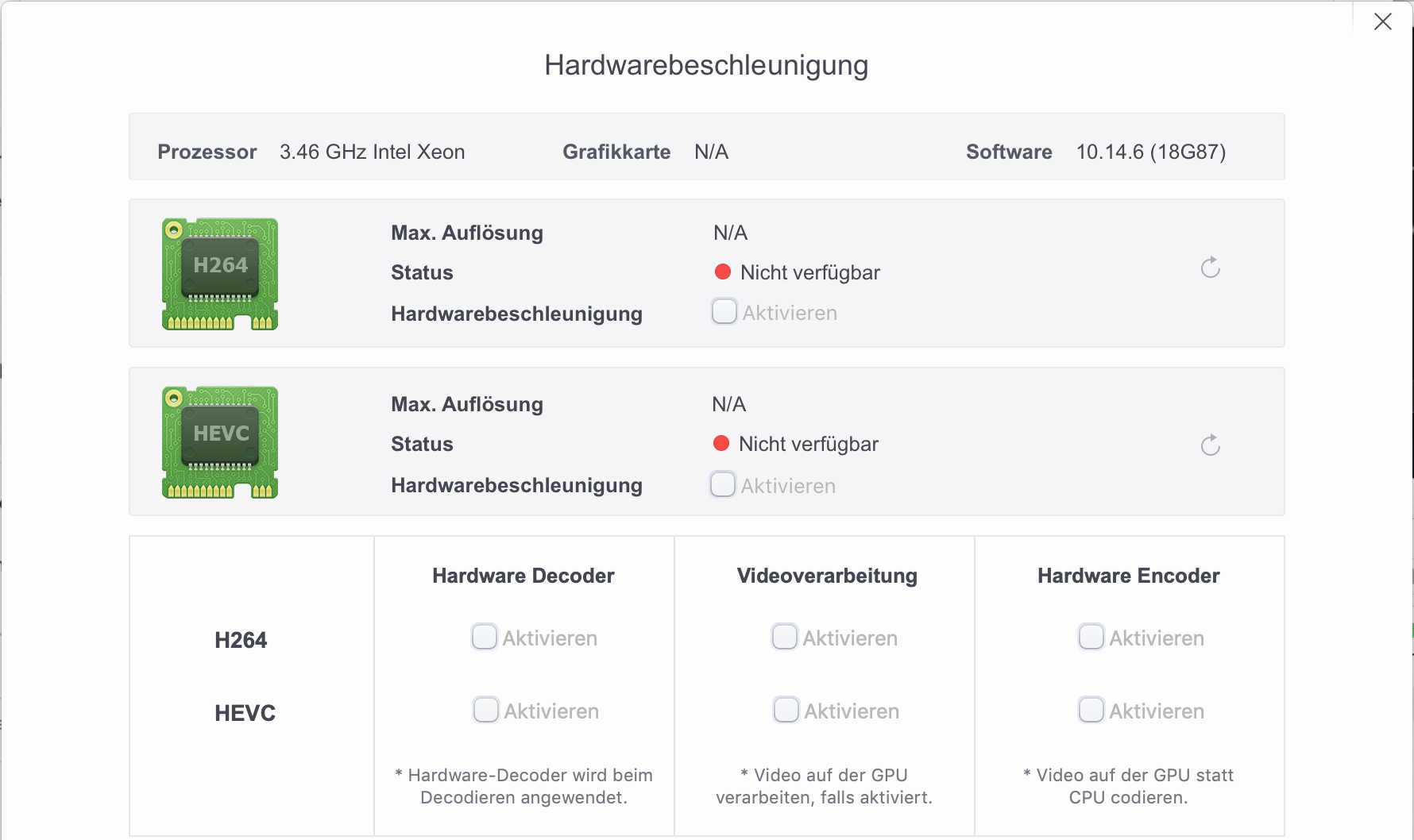

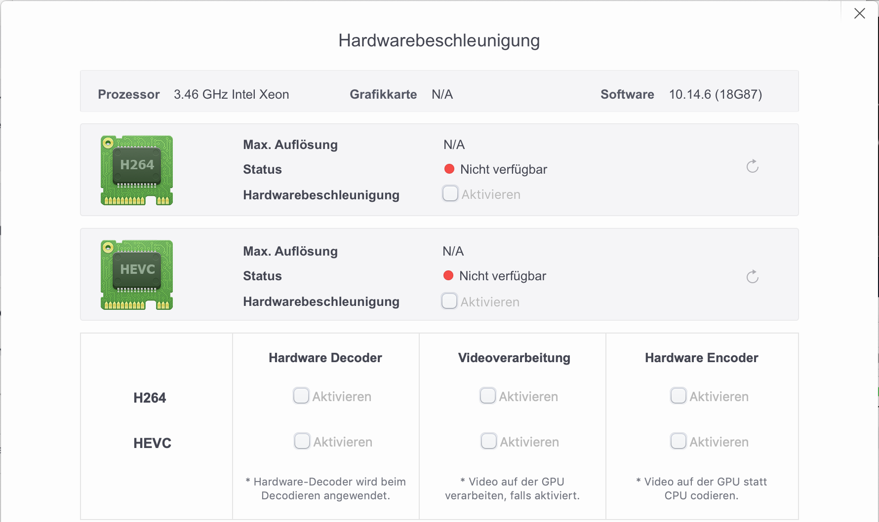

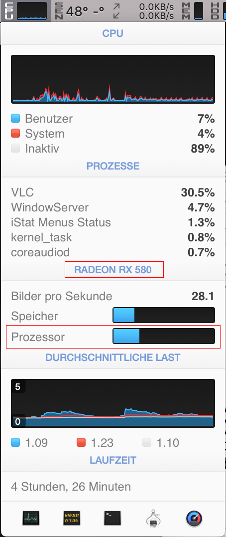

Now with a fresh installed EFI RX 580 in my Mac Pro I have a question.
My macOS 10.14.6 is (yet) totally unpatched, and VideoProc of course indicates no hardware acceleration:

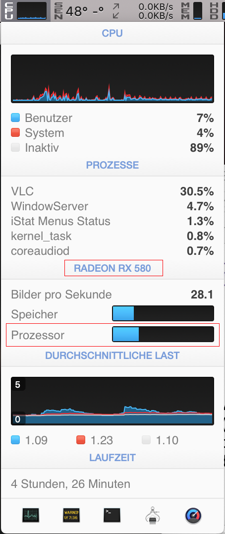

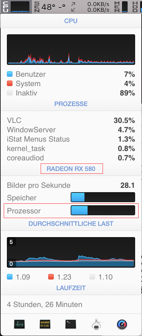

But when I play h.264 footage e.g. with VLC it indicates no some CPU usage and the RX 580 does all the work:
Does that mean h.264 hardware decode acceleration is working without any patching in macOS 10.14.6 ?
But when I play h.264 footage e.g. with VLC it indicates no CPU usage and the RX 580 does all the work:
no clearly vlc sits at 7% cpu usage. Your GPU is working to display things but it's not actively decoding.
decoding 1080p isn't very taxing even for old cpus. Try playing a 4K x264 clip.

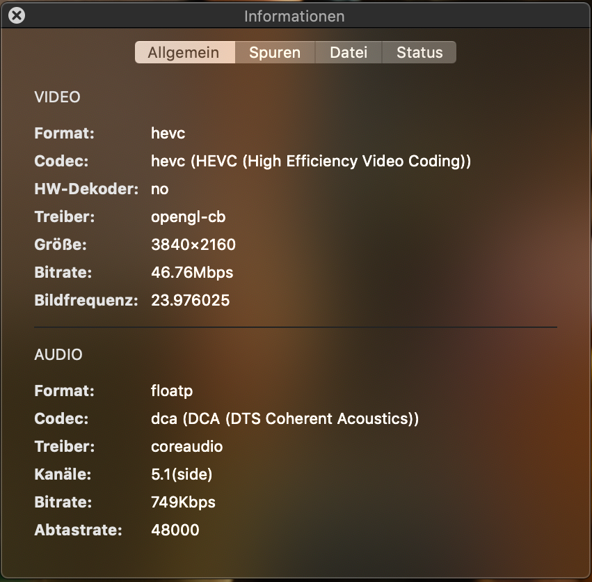

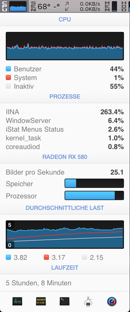

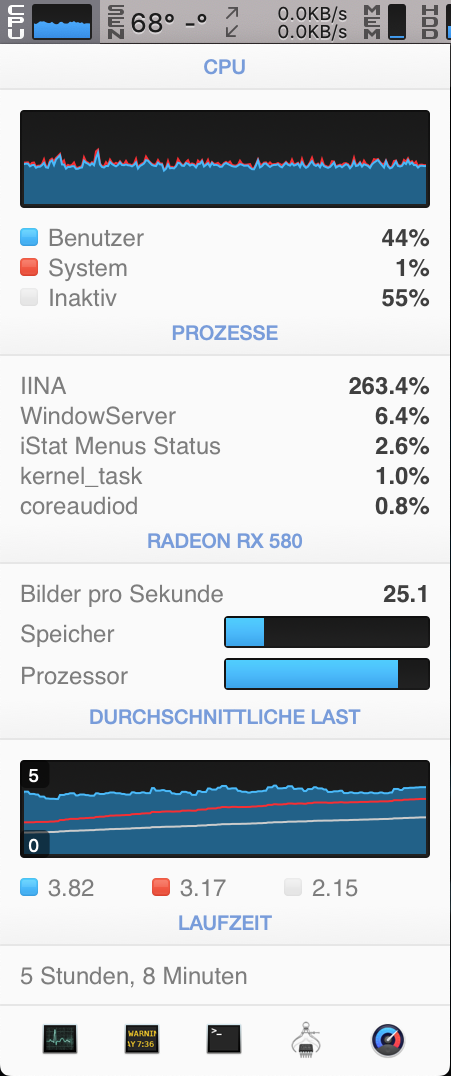

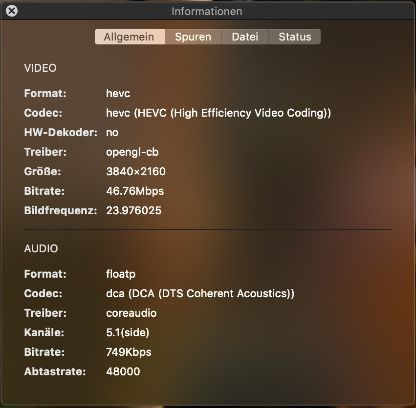

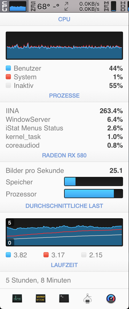

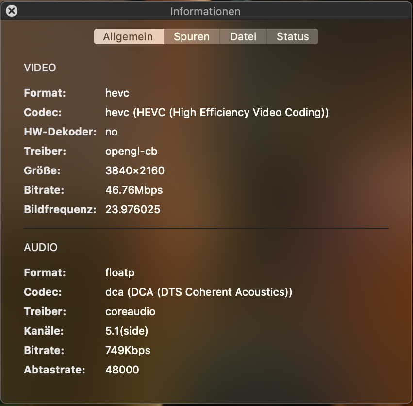

I don't have 4K h264 footage, but 4K HEVC/h265:
Clearly no hardware acceleration (but working fine).
