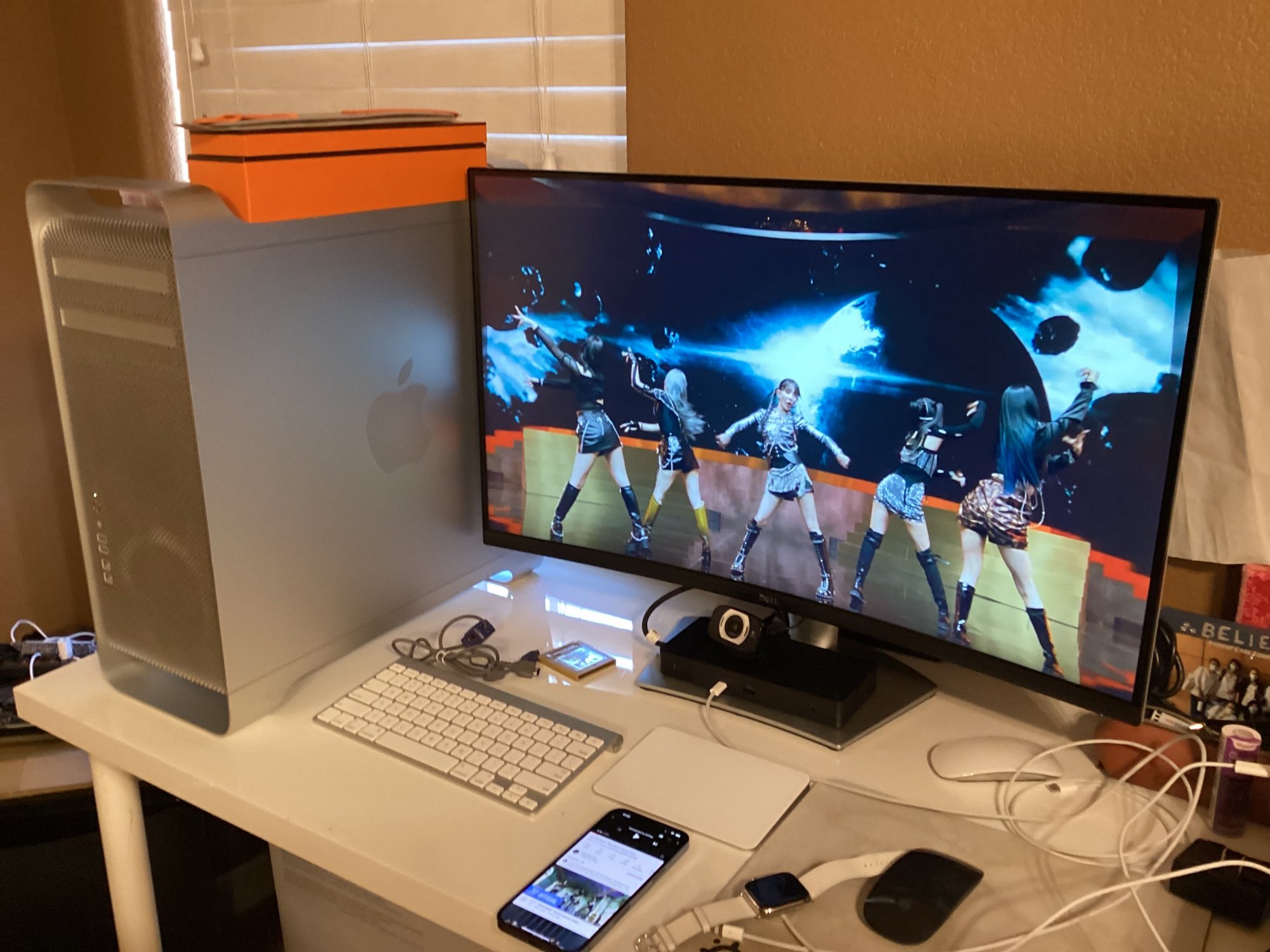

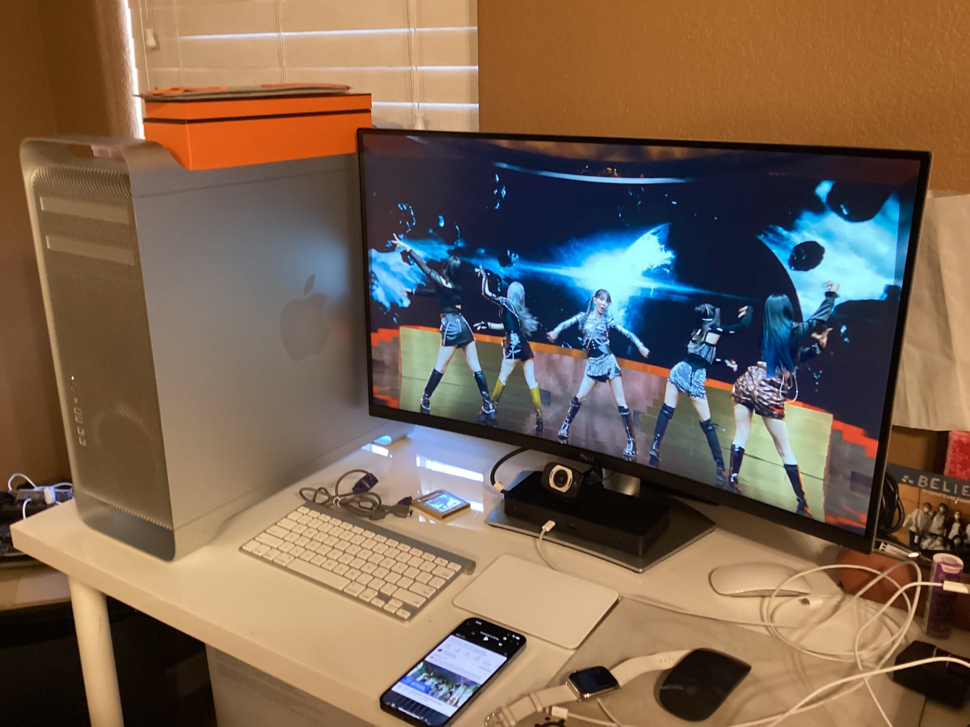

Huh? Airplay receiver doesn't work?? I've been using it fine since I installed Monterey. Video and Audio work. I'll attach some proof. Sorry for the bad shots, had to use an iPad to record since iPhone was AirPlay to Mac Pro.
Alright so it looks like if I use Chrome I can "cast" to my TV. However if I use Airplay itself, only the audio plays on my Airplay device.
Video / audio isn't a problem. There is no transcoding / encoding required. The cMP just streaming the original media file to the Airplay device direcly. As long as the device itself can decode the media file, then it can be played flawlessly.
What doesn't work is Airplay desktop. Initially, we believe that require HEVC hardware encoding. However, so far, AFAIK, no cMP (and iGPUless Hackintosh) user can stream out the desktop via Airplay properly.
