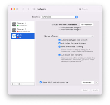

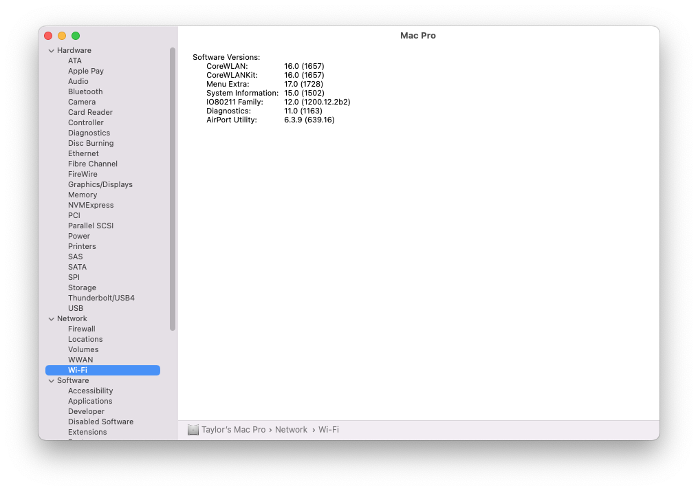

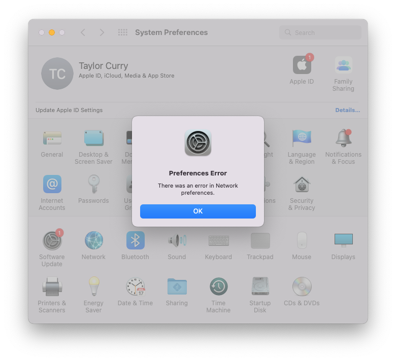

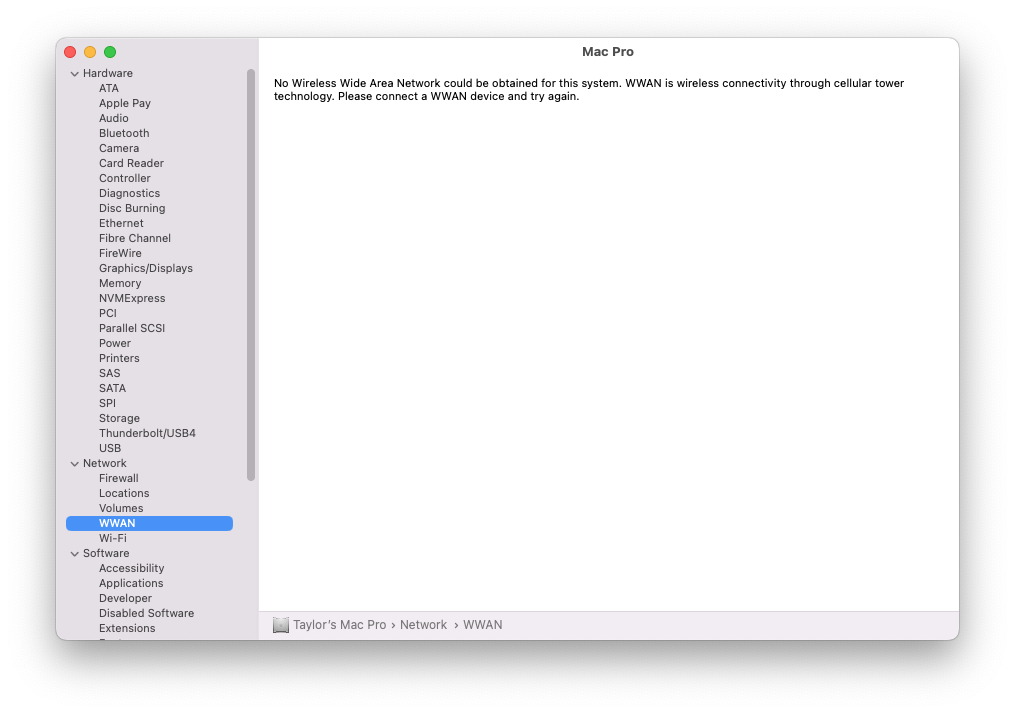

Anyone having issues with legacy wifi on the new Monterey? My legacy wifi opencore patcher is installed but this is what my wifi settings look like.
I installed with Opencore 0.8.0 with the config plist for macOS 12.4 - 12.X (only good for my 0.8.0 package).zip
Thank you!

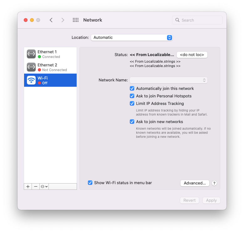

Thank you!
Yep, lost that in the update before last… now with the latest update lost my ethernet drivers as well. 🙁
Trying to figure out the easiest way to restore them. Can we use time machine? reinstall monterey?

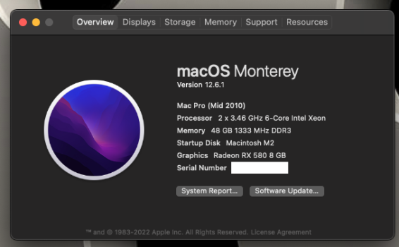

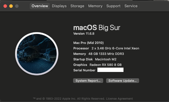

I'm looking for more info on the Turbo Boost. First search result with you. Any ideas I can look at next? I had it on my Mojave OS but just updated with OC to Monterey 12.6 and its shows 3.46 instead of 3.5 GHz

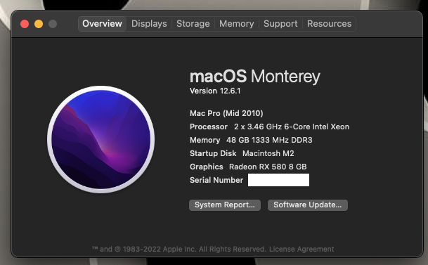

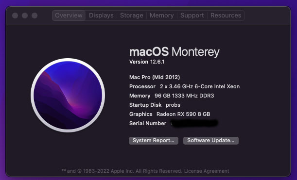

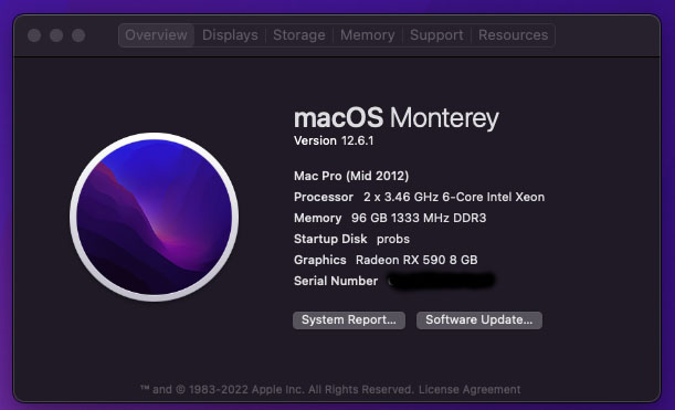

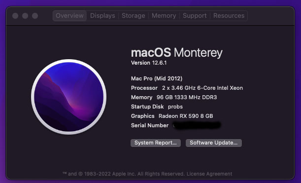

I upgraded Monterey from 12.1 to 12.6.1 on OC 0.7.7. Seemed to work, but then wouldn't boot.
Then I updated OC to 0.8.0 (Martin's) and still no boot.
I had to re-bless the drive in recovery mode.
All good!

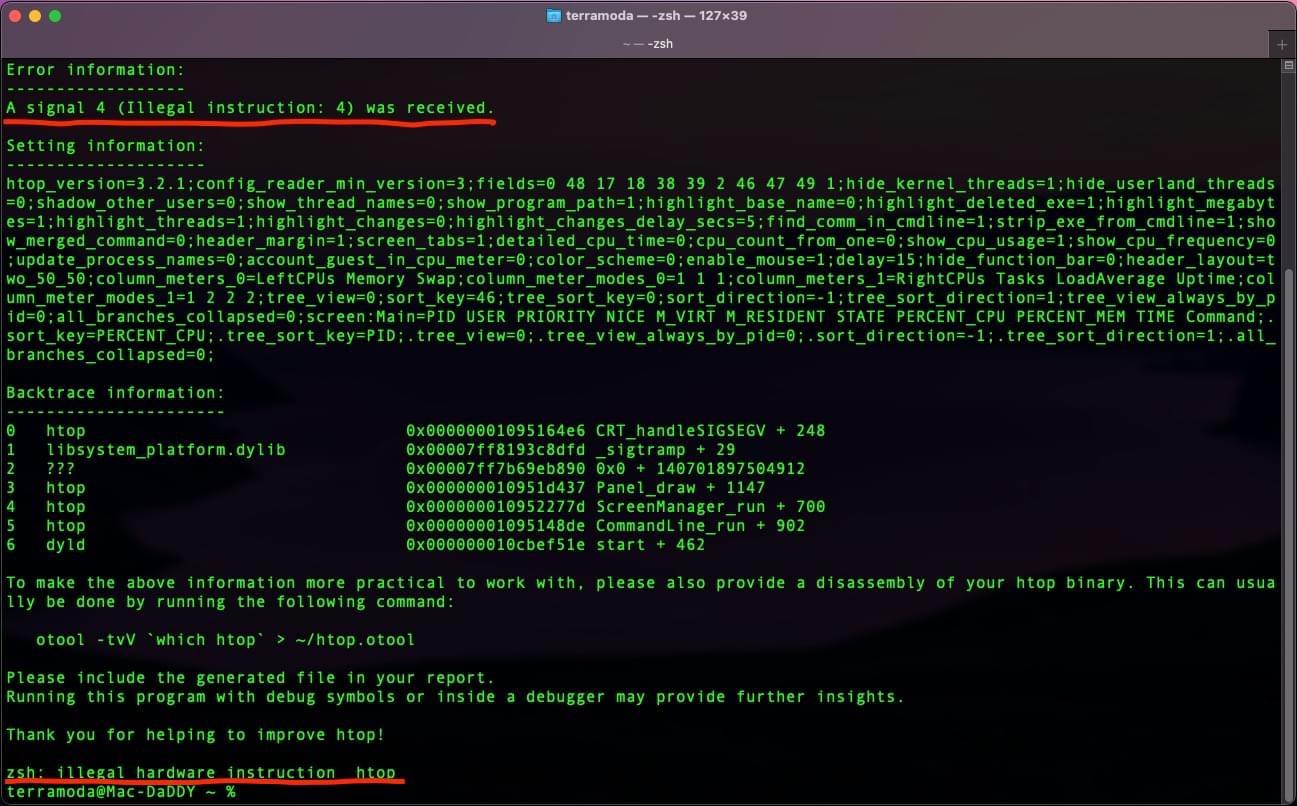

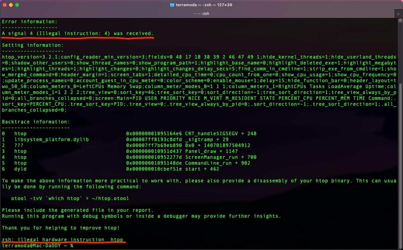

Greetings! Any idea why 0.8.0 is giving me this error when launching certain cli apps? I am getting "Illegal Hardware Instructions" error only in Monterey on my 3,1. It does not happen in Mojave or with 0.7.9 and the manually added AVXPel soft patches, nor with OCLP. I also added the OCLP config to the 0.8.0 ML version here and got same error leading me to believe it is an issue with opencore.efi build. Only a few apps give this error like htop, xboard and futurerestore-gui. (unsigned iOS downgrader) I suspect some AVX instructions are slipping through on the 3,1. This is with latest config and 0.8.0. Again, no issue with latest OCLP. But it boots so slow compared to ML OC package! What is the trick to get Monterey to boot so fast?

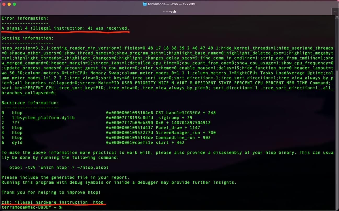

Greetings! Any idea why 0.8.0 is giving me this error when launching certain cli apps? I am getting "Illegal Hardware Instructions" error only in Monterey on my 3,1. It does not happen in Mojave or with 0.7.9 and the manually added AVXPel soft patches, nor with OCLP. I also added the OCLP config to the 0.8.0 ML version here and got same error leading me to believe it is an issue with opencore.efi build. Only a few apps give this error like htop, xboard and futurerestore-gui. (unsigned iOS downgrader) I suspect some AVX instructions are slipping through on the 3,1. This is with latest config and 0.8.0. Again, no issue with latest OCLP. But it boots so slow compared to ML OC package! What is the trick to get Monterey to boot so fast?View attachment 2103698
I think it's fixed by adding AVXPel patches instead of nozLib.kext. Works fine now.
