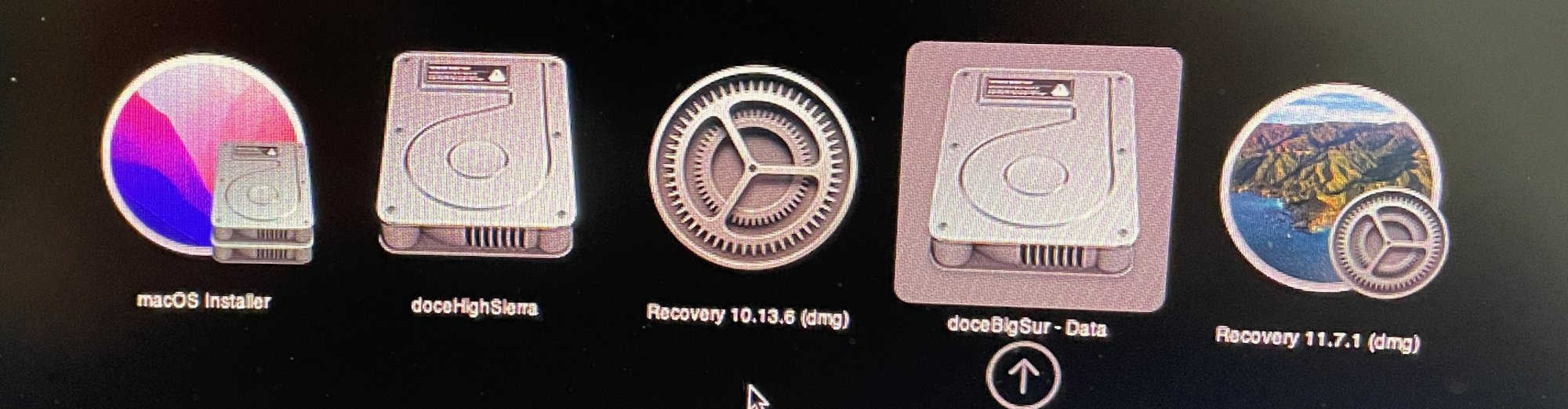

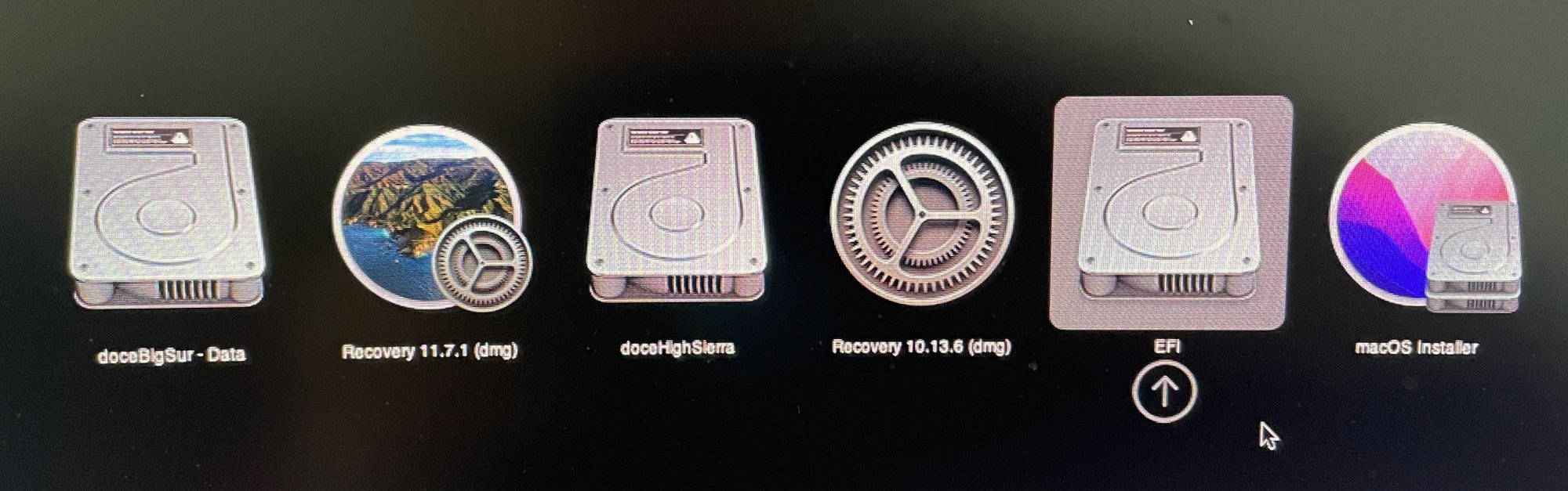

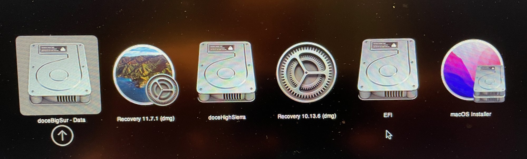

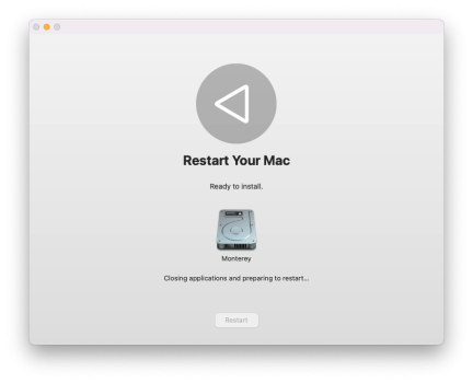

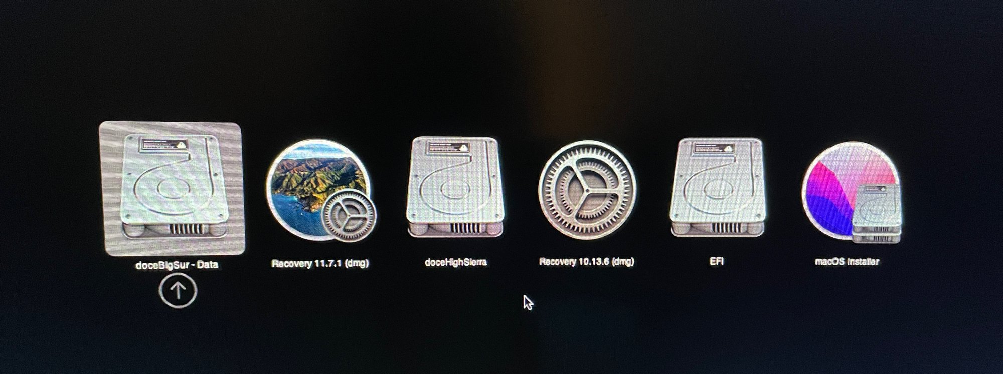

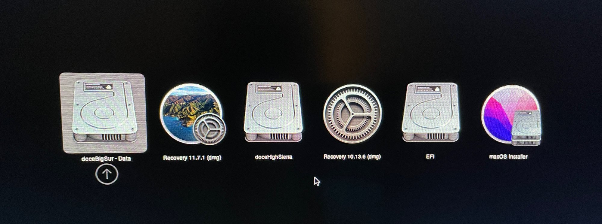

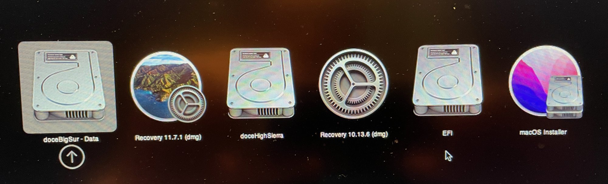

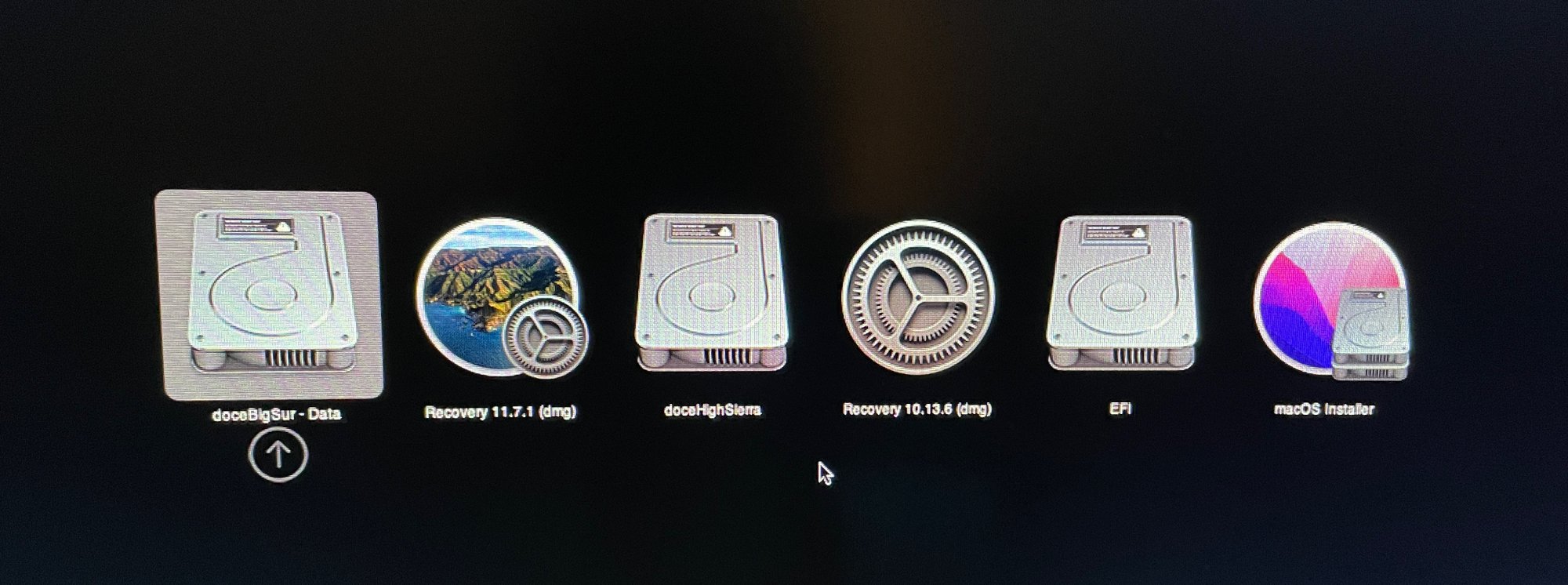

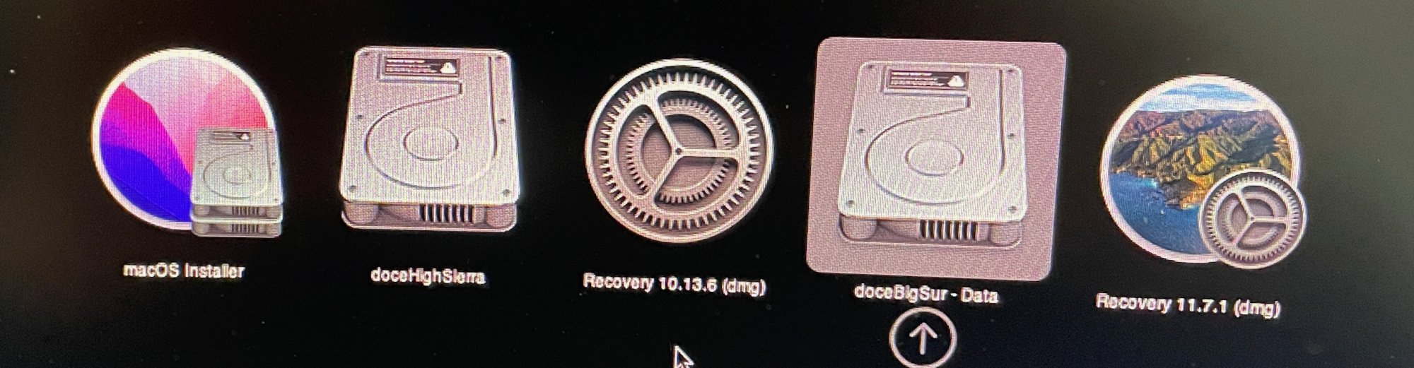

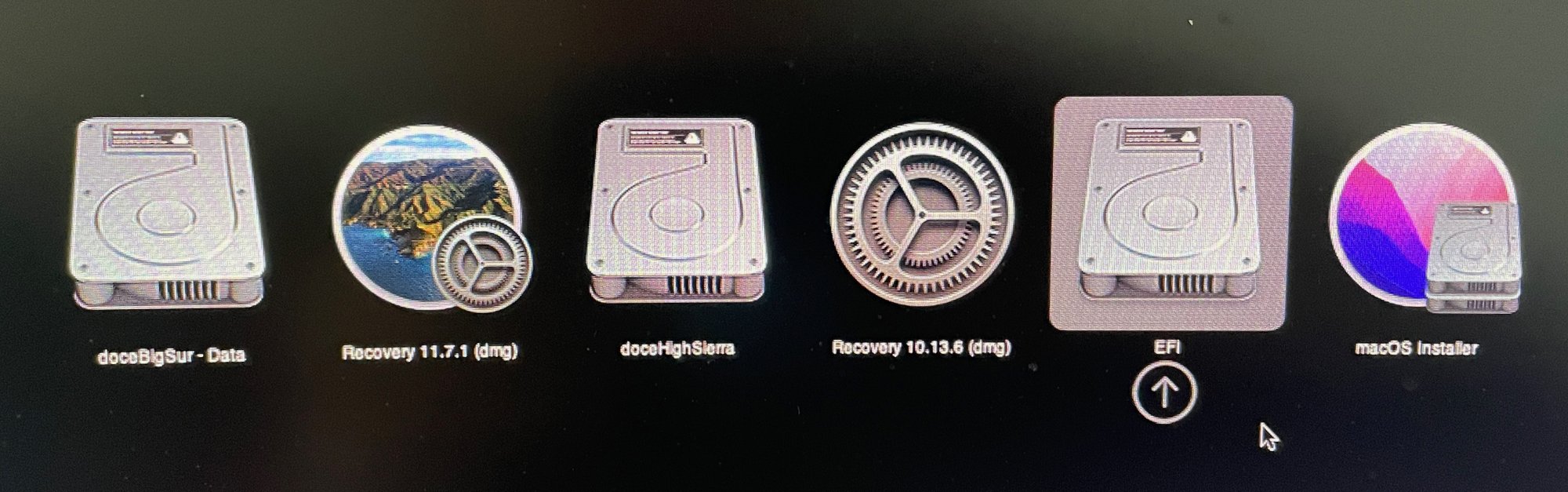

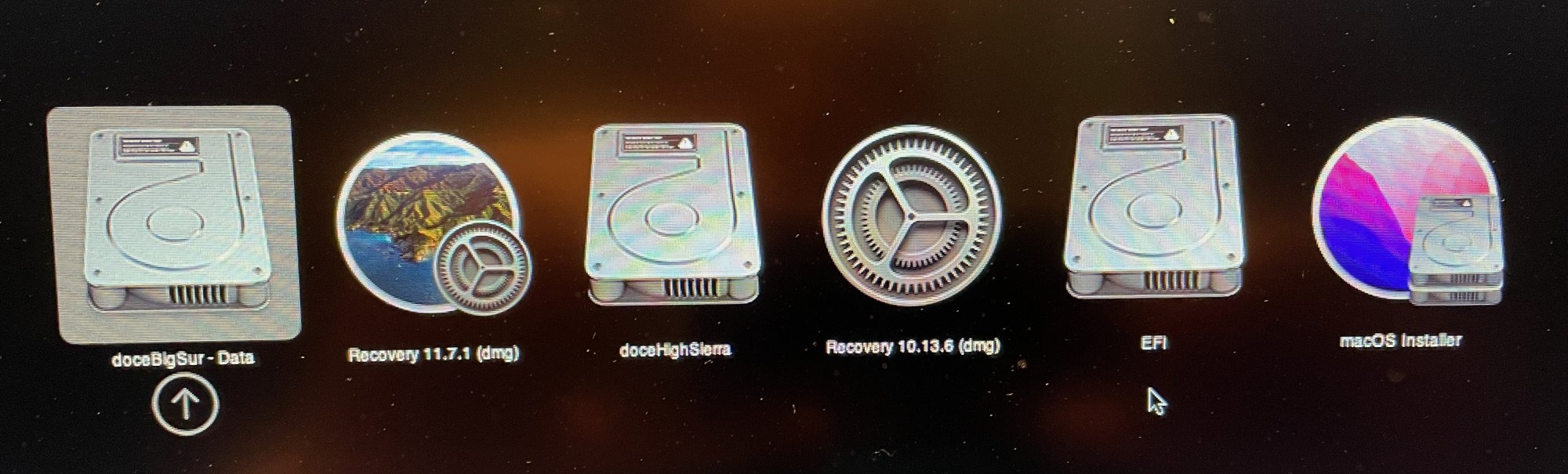

MacPro5,1 (early 2009 flashed 4,1) 2x3.46 6core Xenon 32 GB, have been running BigSur for a little over 10 months without a hitch. Originally, with 0.7.3, upgraded OC once to 0.7.9. However, after recently upgrading GPU to Sapphire Pulse RX 580, following instructions in #1,314 is not allowing me to upgrade to Monterey. Installer appears to build the install volume but then stuck in a loop after restart. I've tried both upgrading the existing OC/BigSur volume and a clean install of OC/Monterey. Neither has worked. It's not a SIP issue. While I don't believe it was relevant to my situation, I have also done the "Cpuid1Mask" and "UpdateSMBIOS" edits. No difference.
Some screen shots follow of the OC bootpicker after the upgrade attempt and the clean install attempt. Please note the "EFI" volume after the clean install attempt. Is this and indication something went wrong with the bless step?
Any thoughts or recommendations? I have read the post #1 of the "OpenCore on the MacPro" thread several times. Is the recommendation in post #3,790 above an indication that the instructions in #1,314 within this thread may no longer be valid?

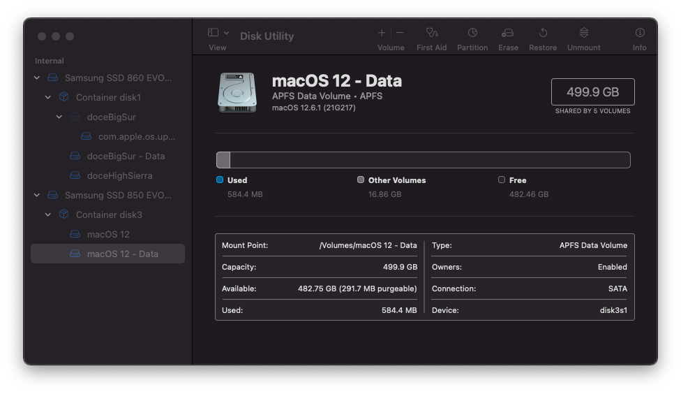

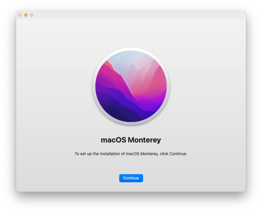

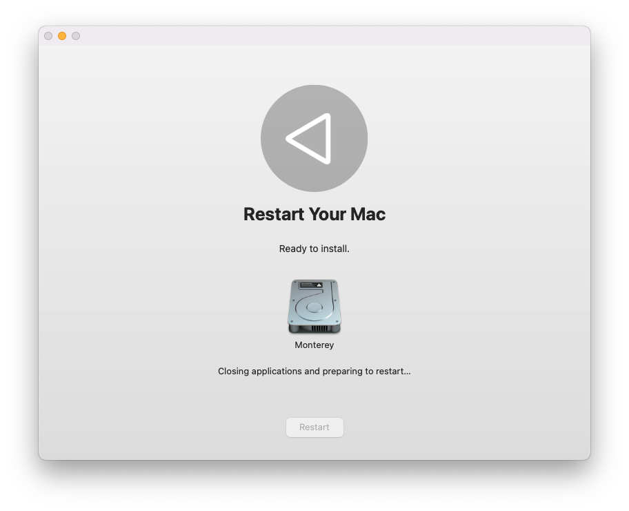

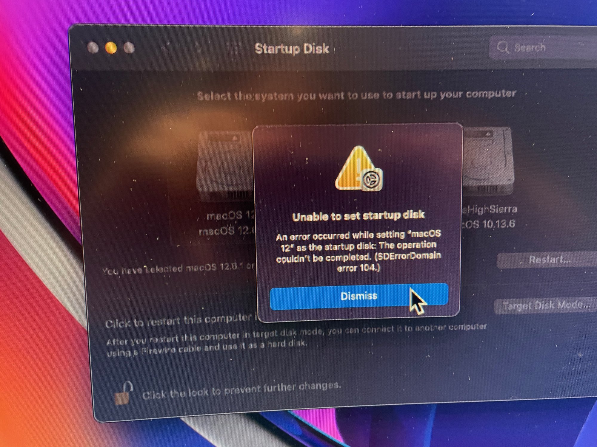

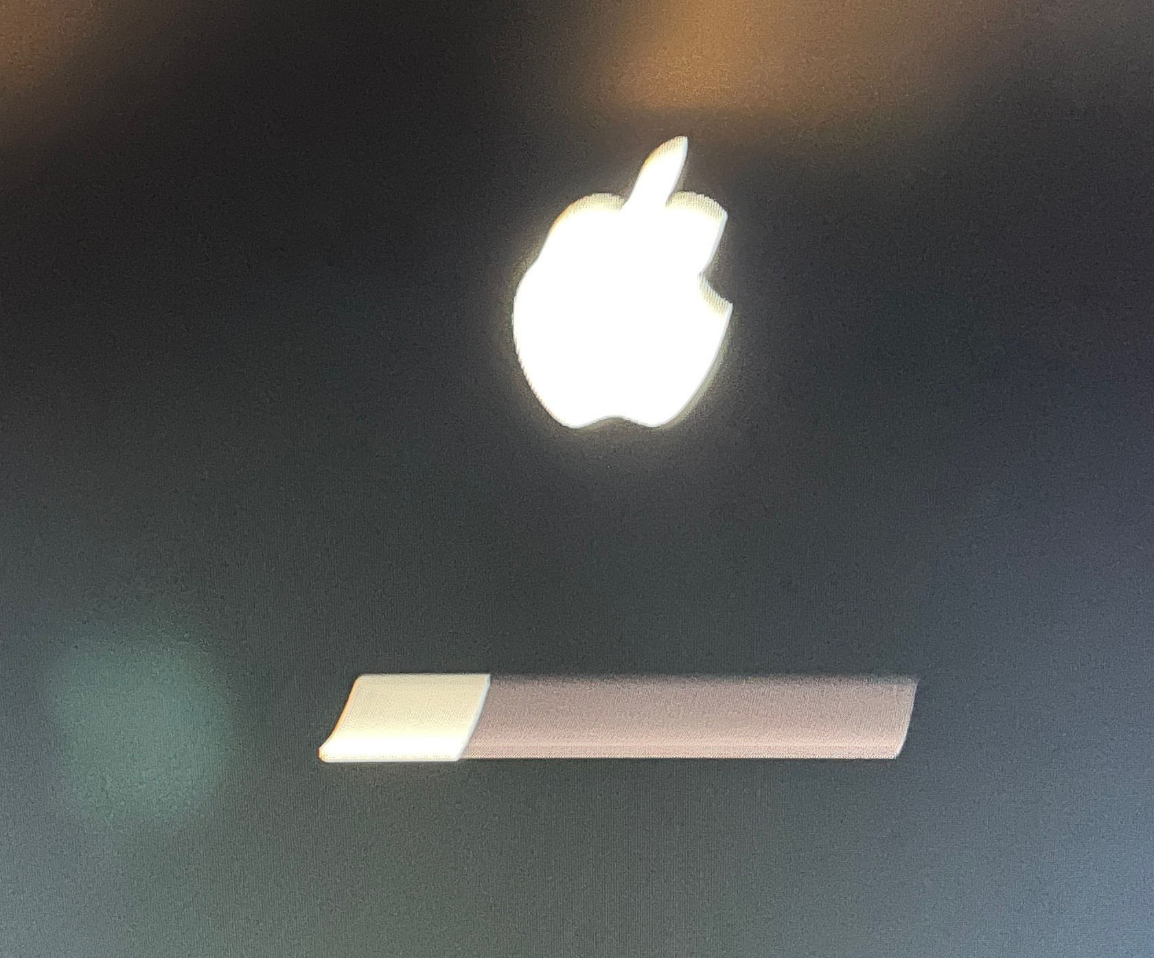

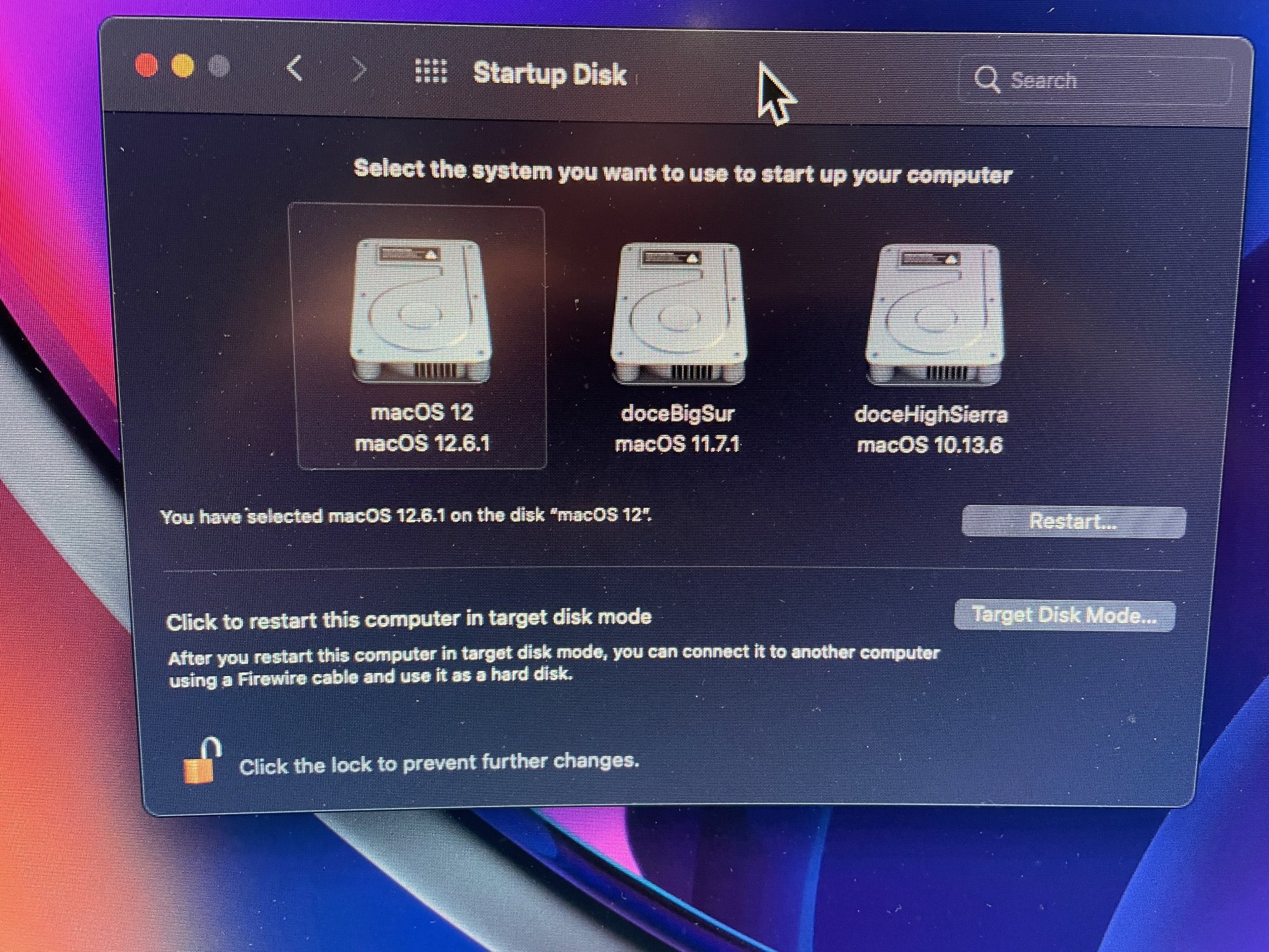

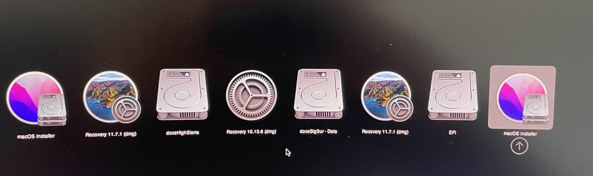

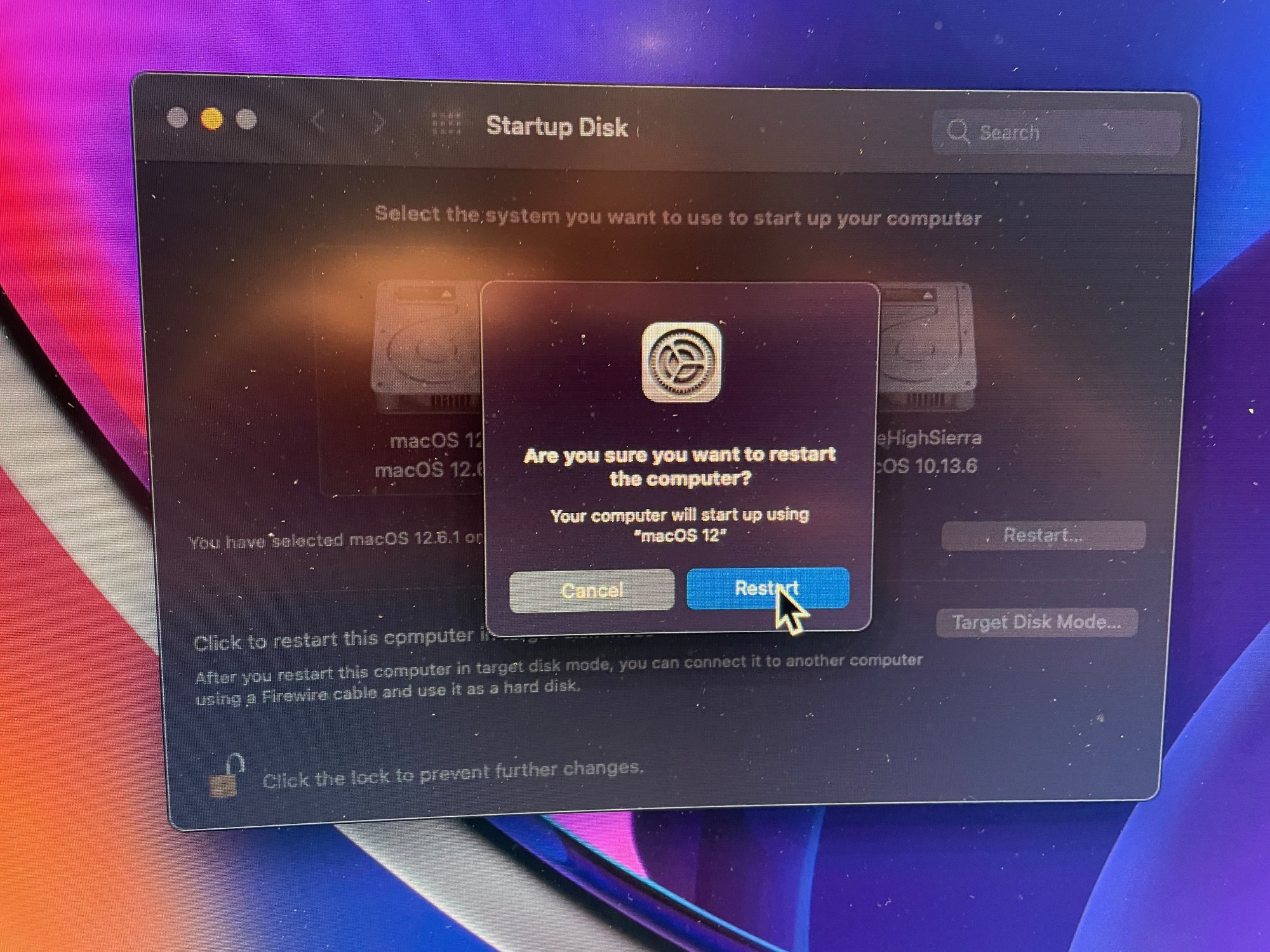

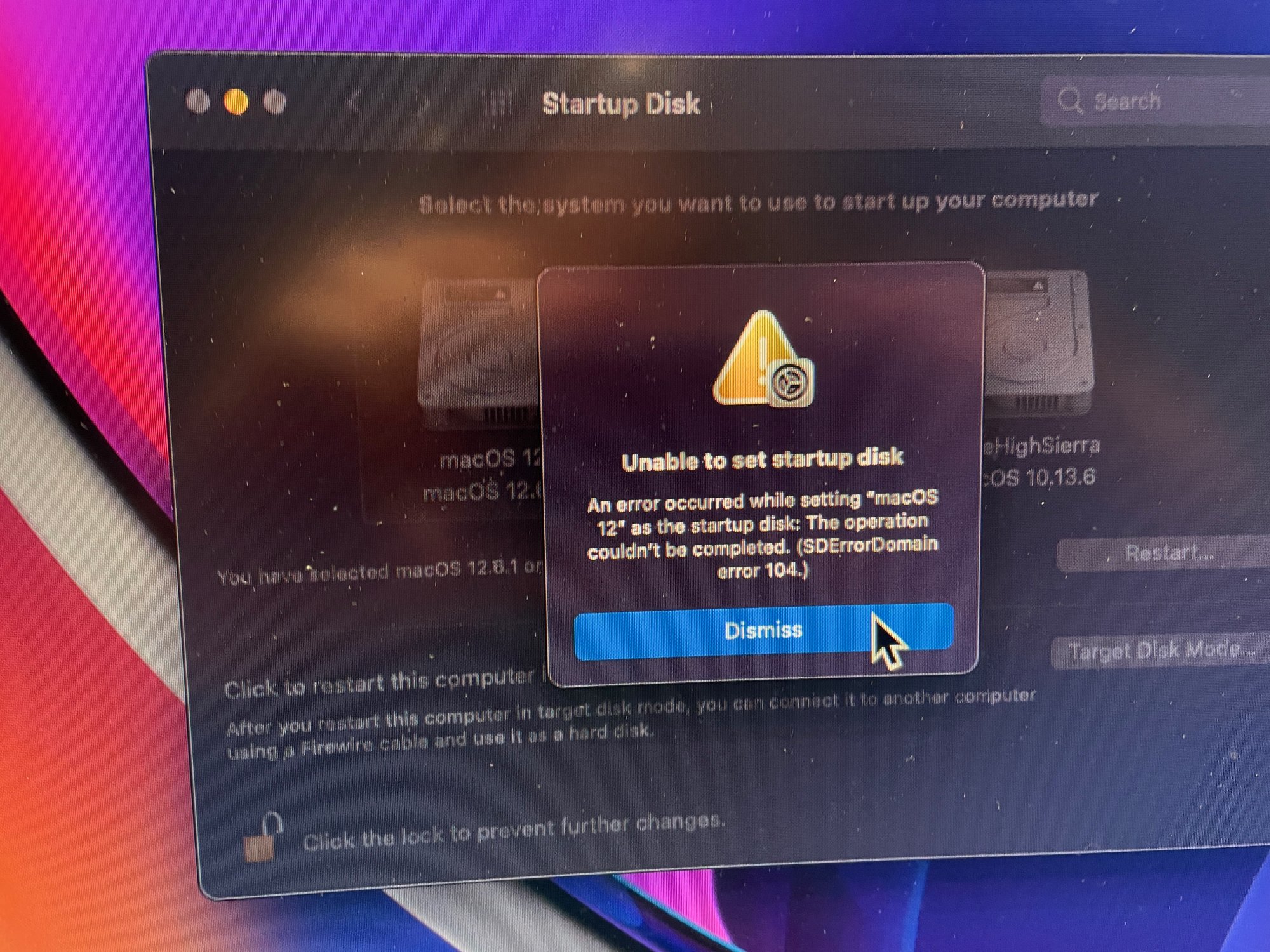

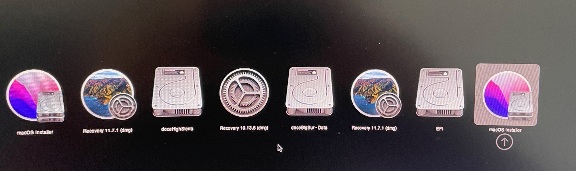

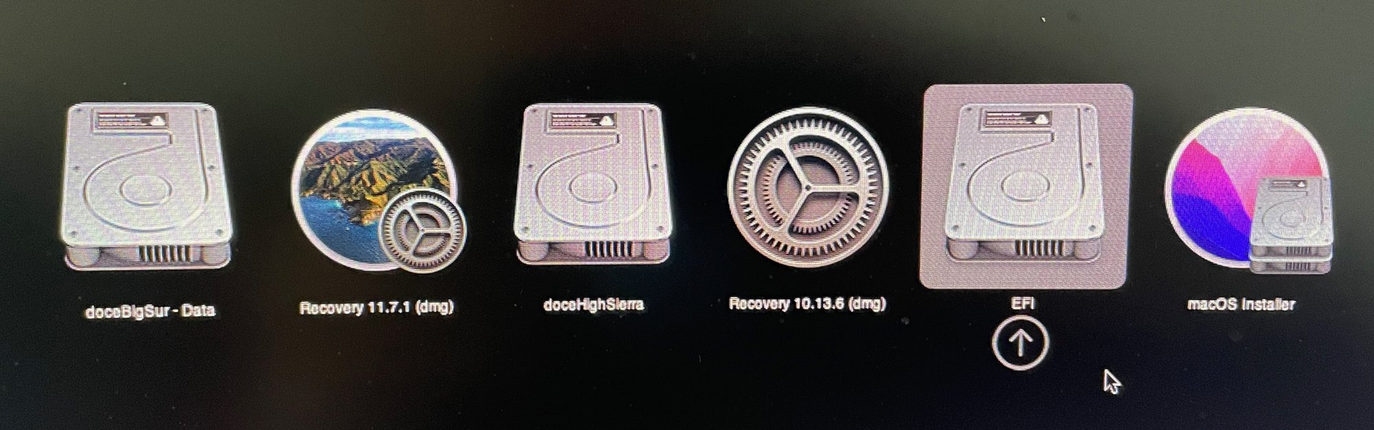

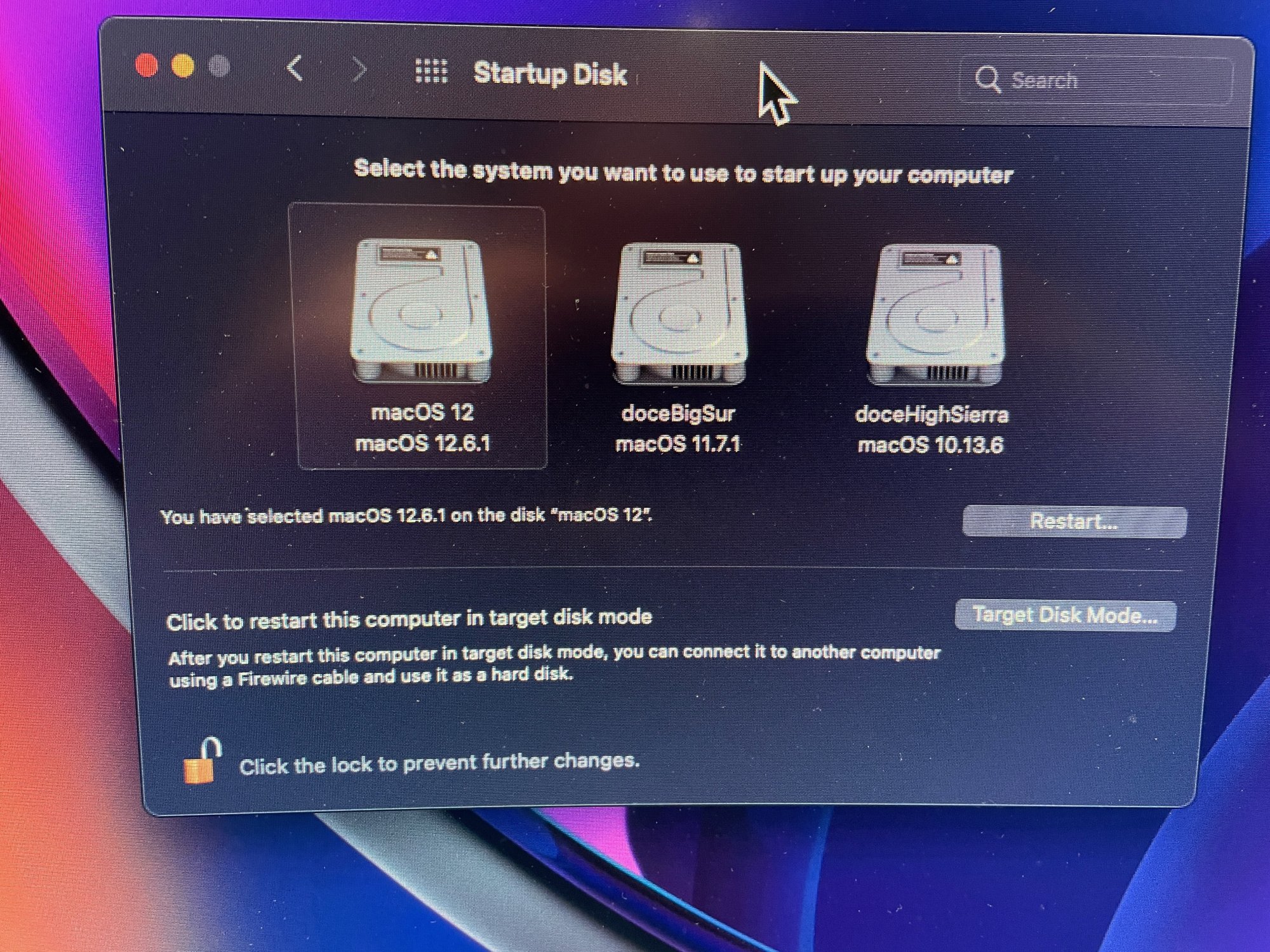

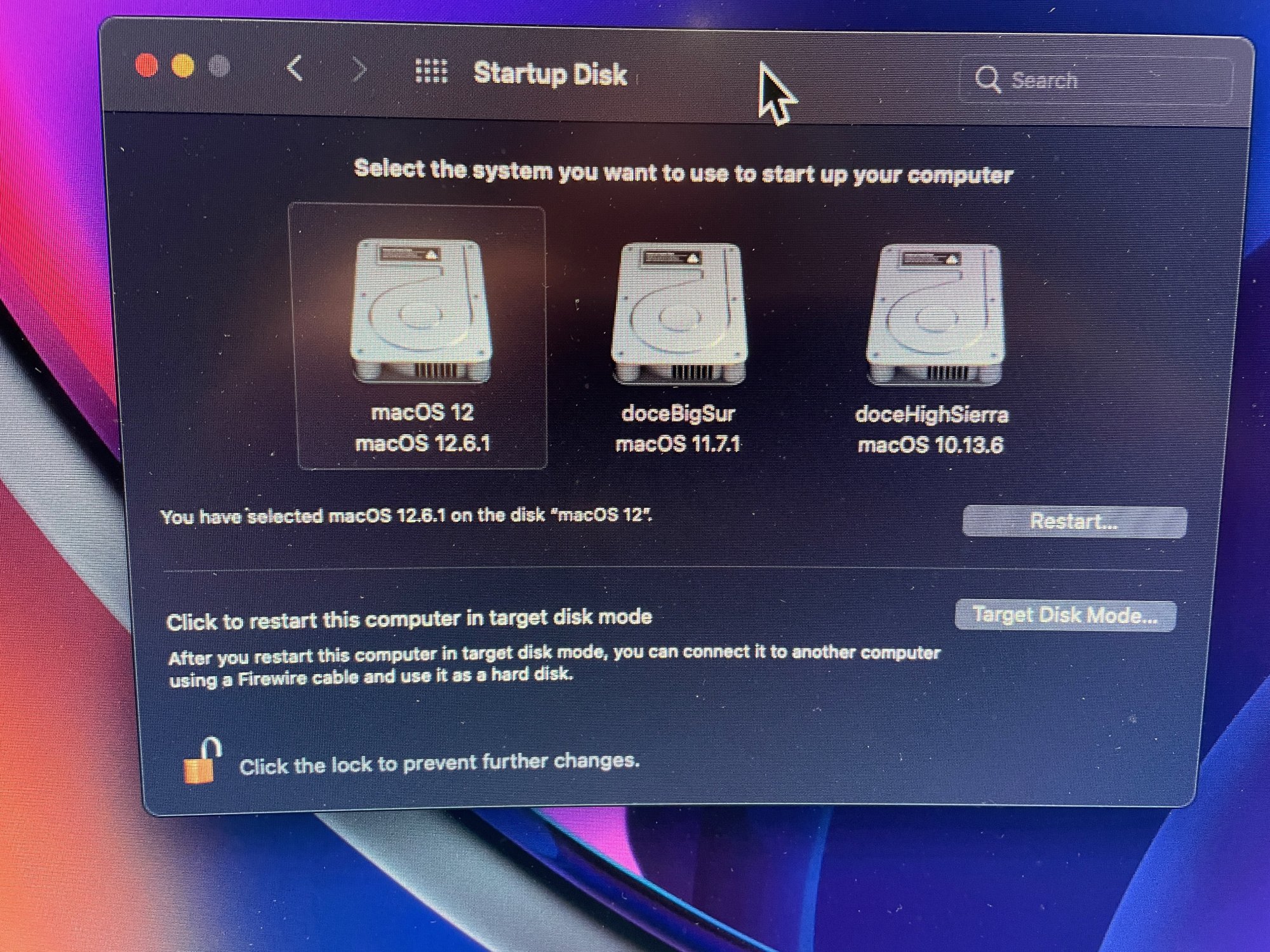

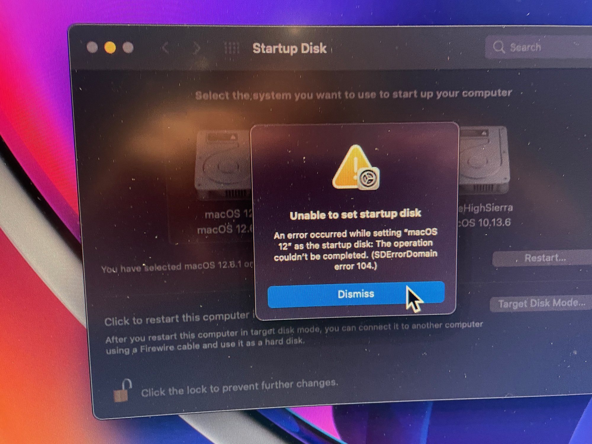

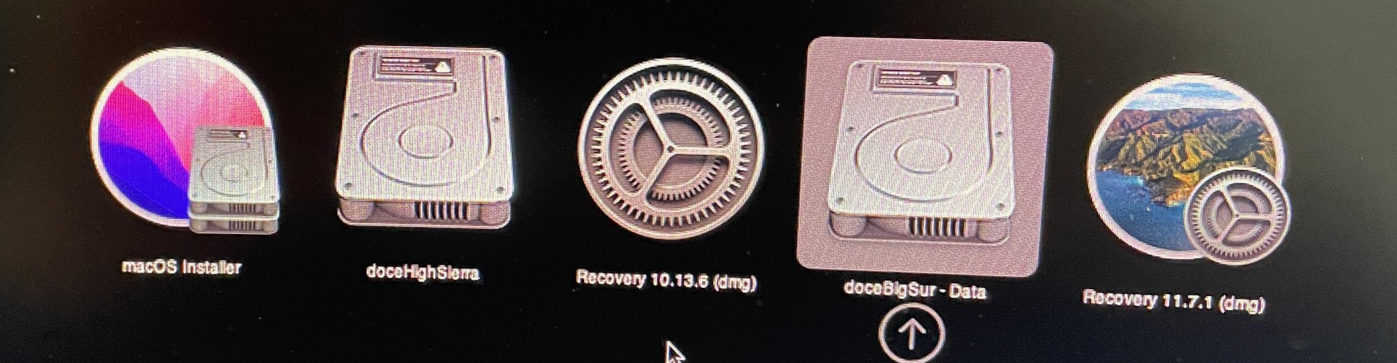

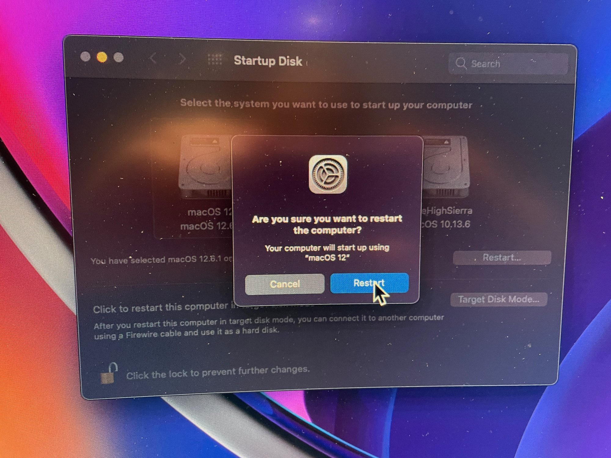

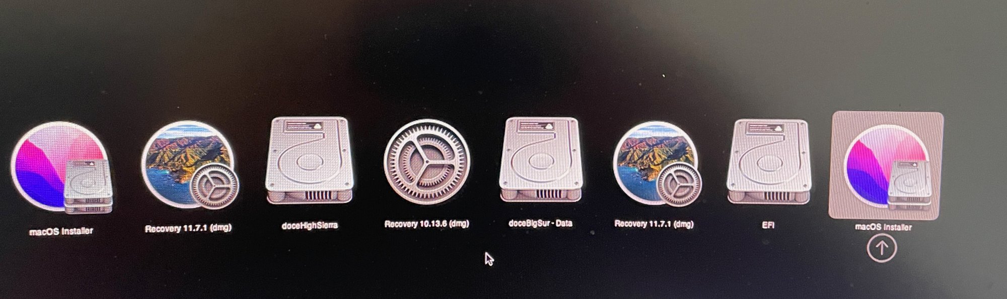

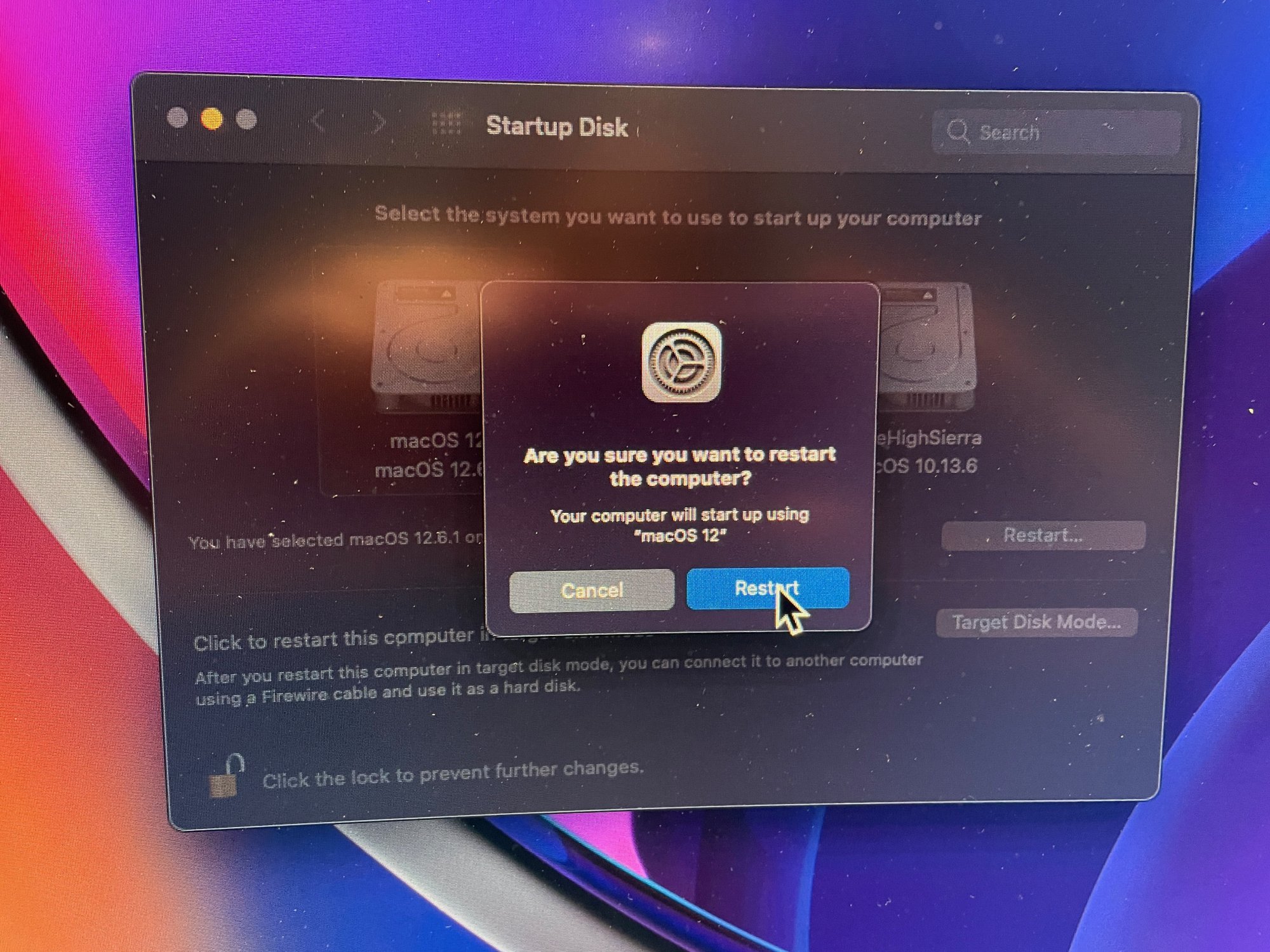

Have tried the beta package and progressed a couple of screens further in the Monterey install process before it presented a new error "SDErrorDomain error 104". After that if I reboot, I am in a loop where I see the OC boot picker. I am still puzzled about the EFI volume, I don't recall everseeing that with the two other times I installed OC with BigSur. Here are images of the sequence. The Monterey volume disappears. Subsequently, I've tried picking both macOS installer and EFI. In both cases I wind up back at the OC boot picker. In these cases, I am trying to install on a erased Samsung 2.5" SATA SSD in drive bay1. The OC bootable BigSur and HighSierra volumes are on a SATA SSD mounted in a Sonnet PCIe card in slot 3.
An added note, I just tried the "0.8.0 + 0.8.02" method. Still no luck. Although, in the process of rebooting I realized that as per last image Disk Utility believes the Volume is a 12.6.1 volume. However, Open Core is calling it EFI or macOS installer????
I would suggest you clean your NVRAM - boot holding Command-Option-P-R until you hear the 5th chime. While it is kind of like "take 2 aspirin and call me in the morning" it frequently will work.
Reactions: h9826790
I also believe that's NVRAM related, please clear the NVRAM, if possilbe, flash a cleaned BootROM.

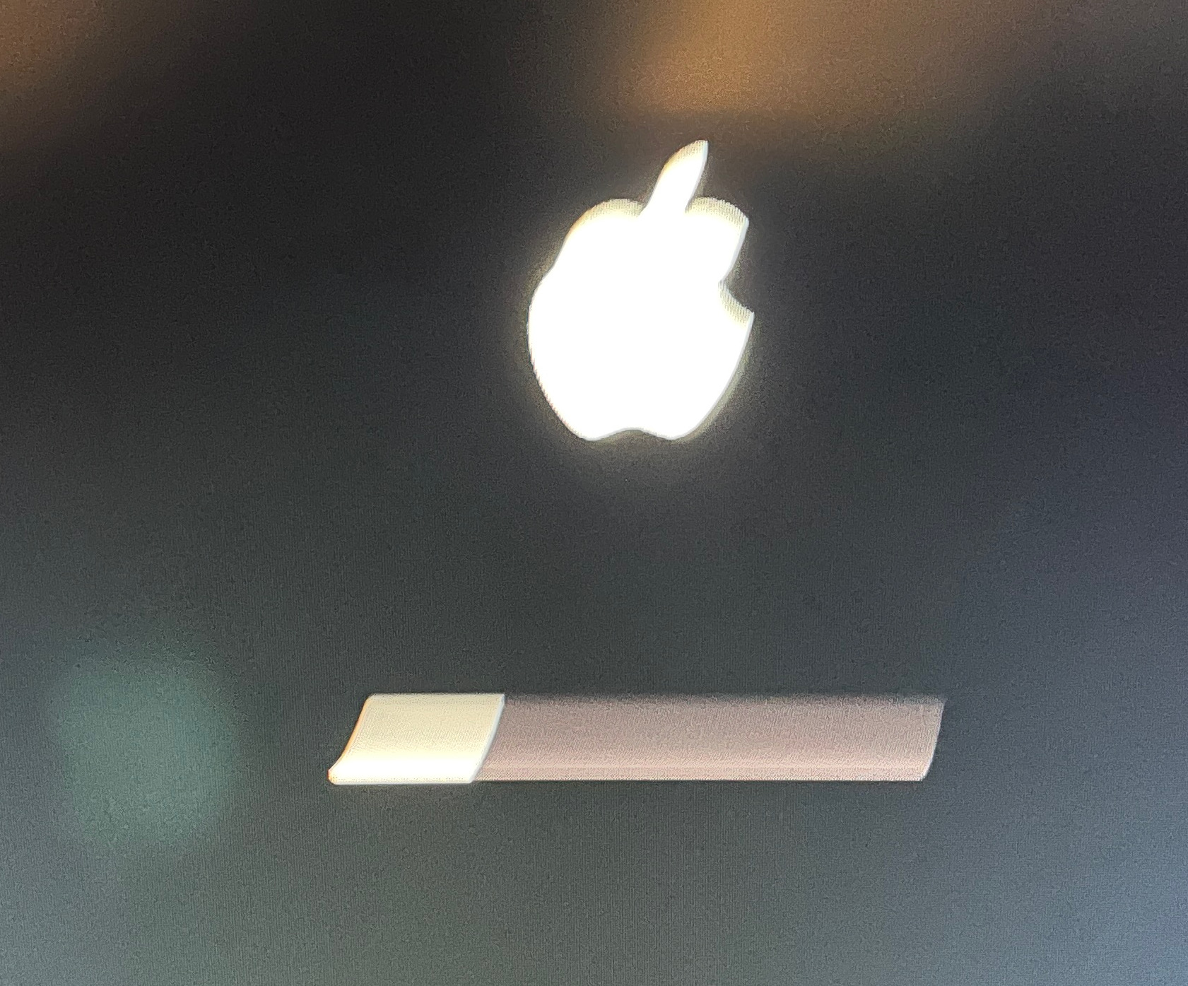

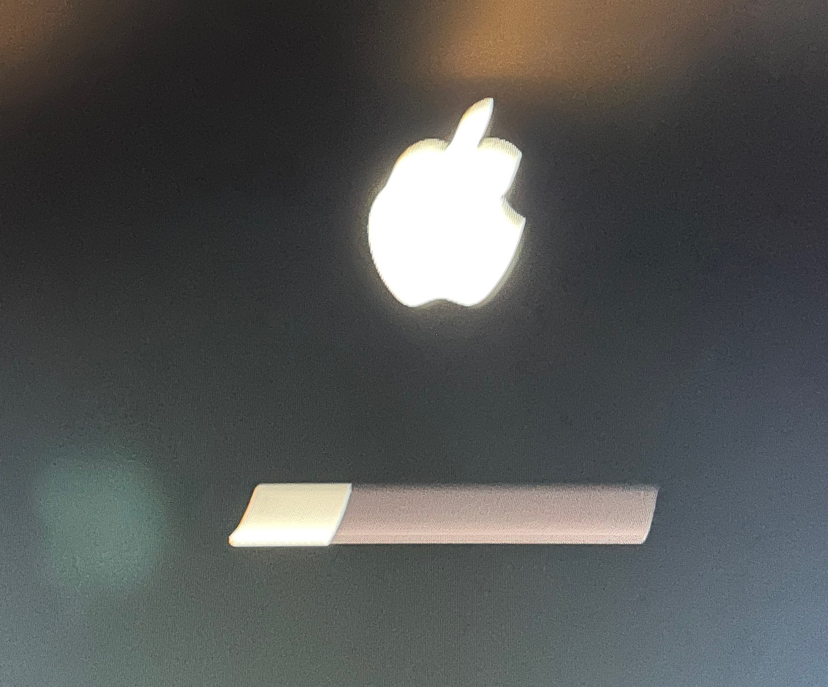

I have the 0.8.0 packages of OpenCore and have turned on VMM and turned off SMBIOS Spoofing. Can't find the Monterey 12.6.1 update in System Preferences (from Monterey 12.6) which used to work and running the ”Install macOS Monterey.app” and restarting into the macOS Installer partition makes it show the Apple logo and progress bar for a minute or so, then it restarts back into my macOS 12.6 partition – the update doesn't follow through.
Maybe try 0.8.6.
I have no idea what is wrong.
Edit:
Using 0.8.6 worked!
