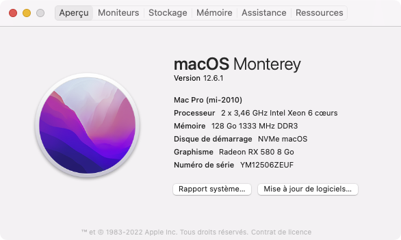

I have to say that M. Lo package 0.7.9 makes my MP 5,1 mid-2010 frequently reboot under Monterey 12.6.1, whereas the OpenCore built with OLCP 0.5.1 works perfectly.
I'm not good enough in computer science to display and detect what induced the Kernel Panic and the reboot.

If you use my package, for Monterey 12.6.1, you have to update the package to 0.8.0.2. That's the only version contain AVXpel to avoid that "sudden reboot".

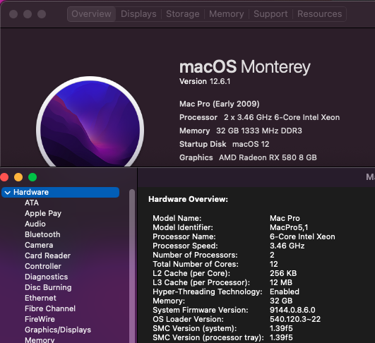

SUCCESS!! with OC 0.8.6 beta, thank you @h9826790. I did a five chime NVRAM reset but I'm not sure if that was the secret. A mistake before booting is how I discovered it. I'm now wondering if perhaps I had been making an error when I was following the instructions in #1,314. Just in case others run into a similar problem, I will document what I did and the "mistake" which finally got it working. Apologies for the length.

Just want to say I jumped on to the 0.8.6 beta 2 and the Monterey 12.6.1 update installed fine after that. 👍

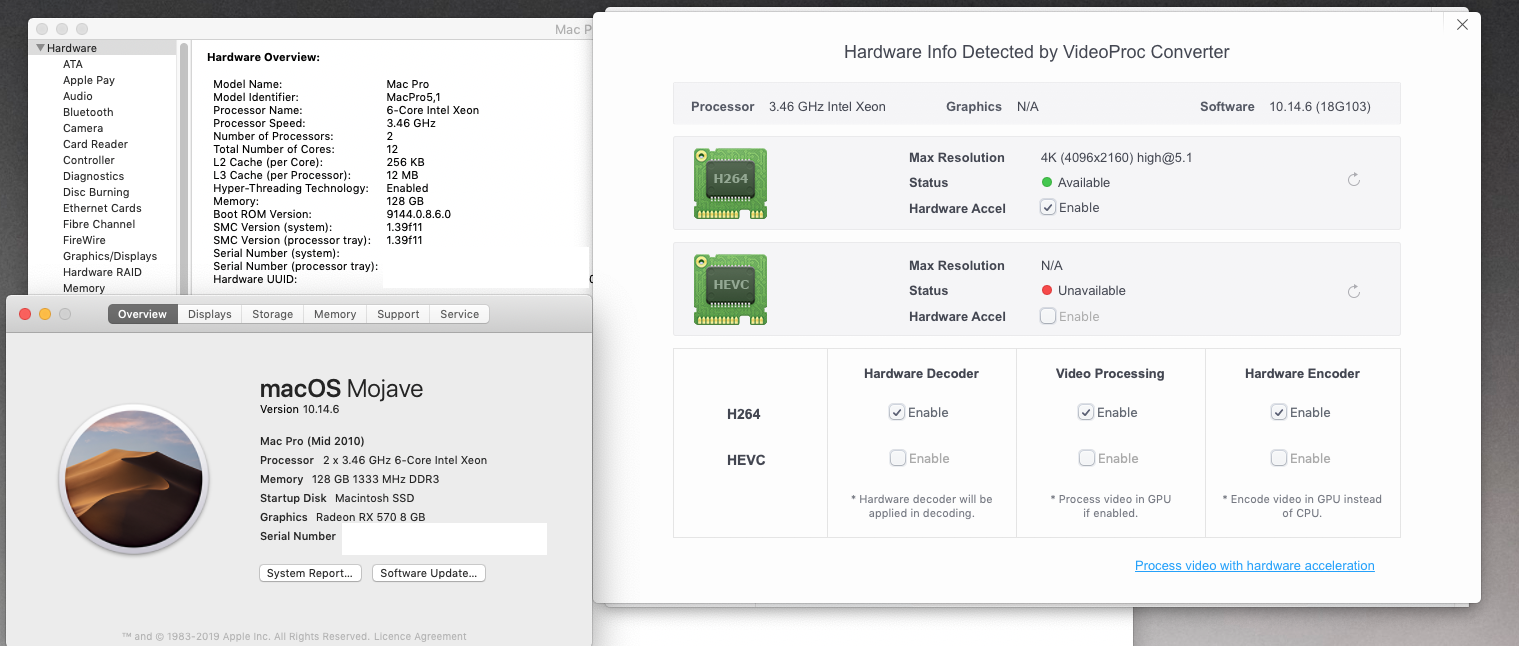

Just wanted to say a huge thanks for this package!
I installed it to a USB drive to test it all out. Worked first time, amazing. Great to see my boot screens again!
The only issue I seem to be having is that I'm not getting hardware acceleration in videoproc.
I'm not sure if that's becasue videoproc is wrong, or I haven't set it up properly, but it doesn't detect my GPU.
I just downloaded the latest package today.
I have a Sapphire Pulse RX570 8gb.
I'm booting from a PCIe NVMe OS drive.
OpenCore is on a usb drive plugged directly in.
I get the book screen and my OS drive is no longer an external drive.
So some things definitely ARE working.
How can I fix GPU acceleration or how can I test that its working?
Thank you so much.
