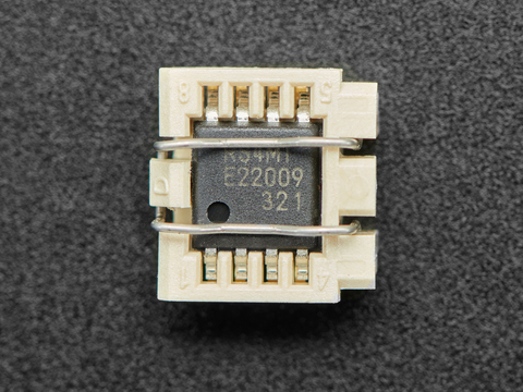

So, I ordered a bunch of the MXIC MX25L3206E from Digikey, and was thinking about using this on the MB instead of soldering a new chip on:
You did an off-topic here, no? This is a topic for the BootROM thread, not here.
You can use the socket, but if you are not a developer, don't do it. It's a constant source of bad contacts.

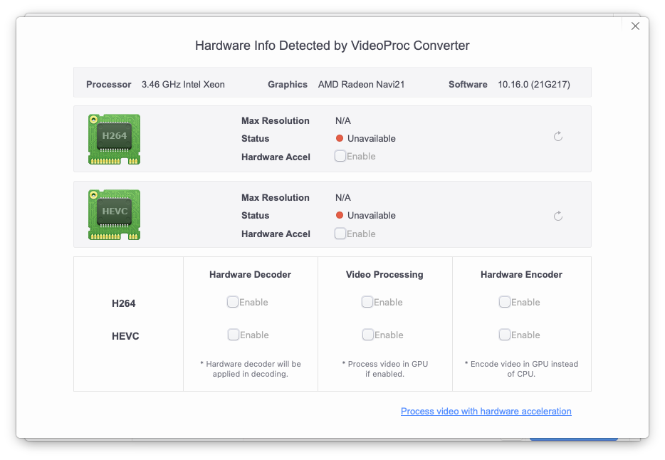

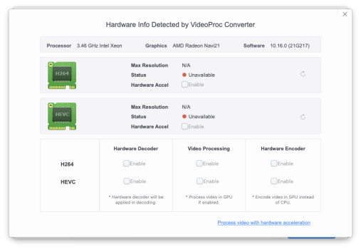

I have a 4,1->5,1 with Cape Verde. Tried the Whatevergreen/Lilu method, no surprise it didn't work because it clearly states "Polaris and up." In the off chance that AMD7000Controller.Kext does have the necessary hooks I was thinking maybe try the hex method. I know HEVC is out of the question (GCN1 doesn't support it), but maybe H.264 could be made working.
I'm on Monterey, and there are a couple of changes it appears. I figured I'd run ideas by here so I'm not completely needlessly reinstalling after failed attempts.
(1) If CSR remains turned off what are any code signing requirements? The howto in #205 mentions using codesign, I imagine with a self generated cert. Does this still work in OS 12?
(2) Monterey seems to make it very hard to remount "/" RW (even with csr off) because, you know, I just own the computer why should I expect to actually be able to do what I want with it or something. Anyway, my guess is that I'll have to boot into recovery, remount read-write and copy AppleGVA back to /System/Library/PrivateFrameworks from within recovery, right? Other option if it still works could be the csr "authenticated root" option. Does the system volume need to be re-signed somehow? Is there a better way?
Or is H.264 acceleration just not present in AMD7000 at all on Mac?

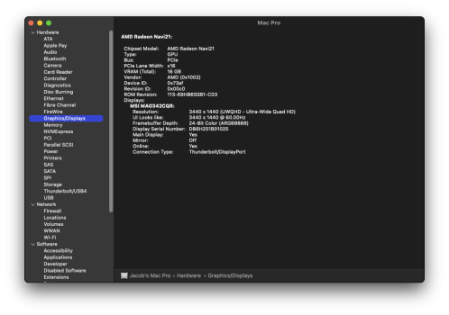

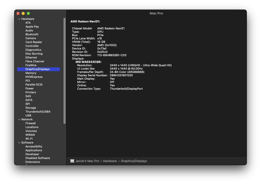

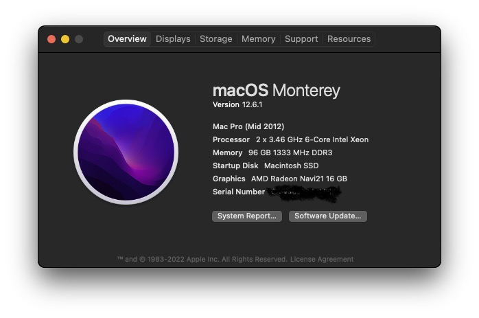

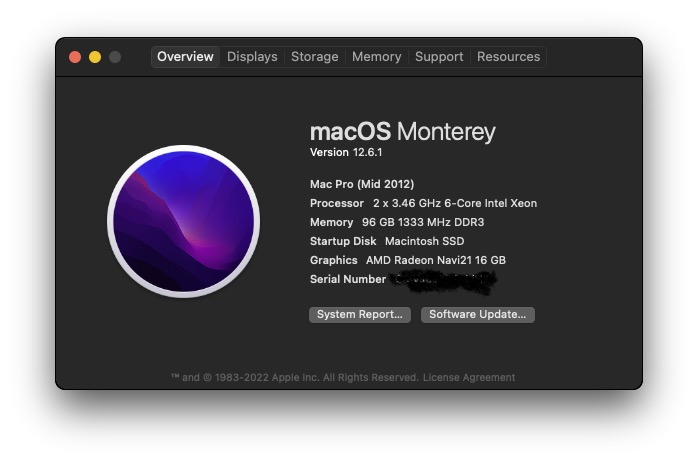

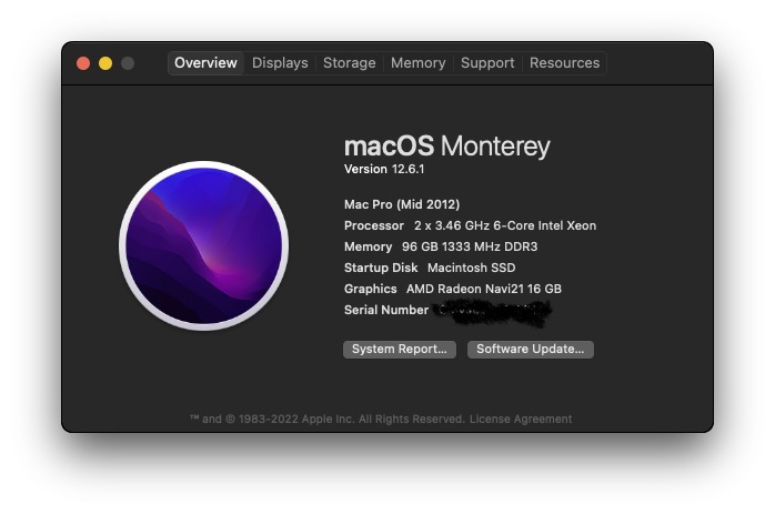

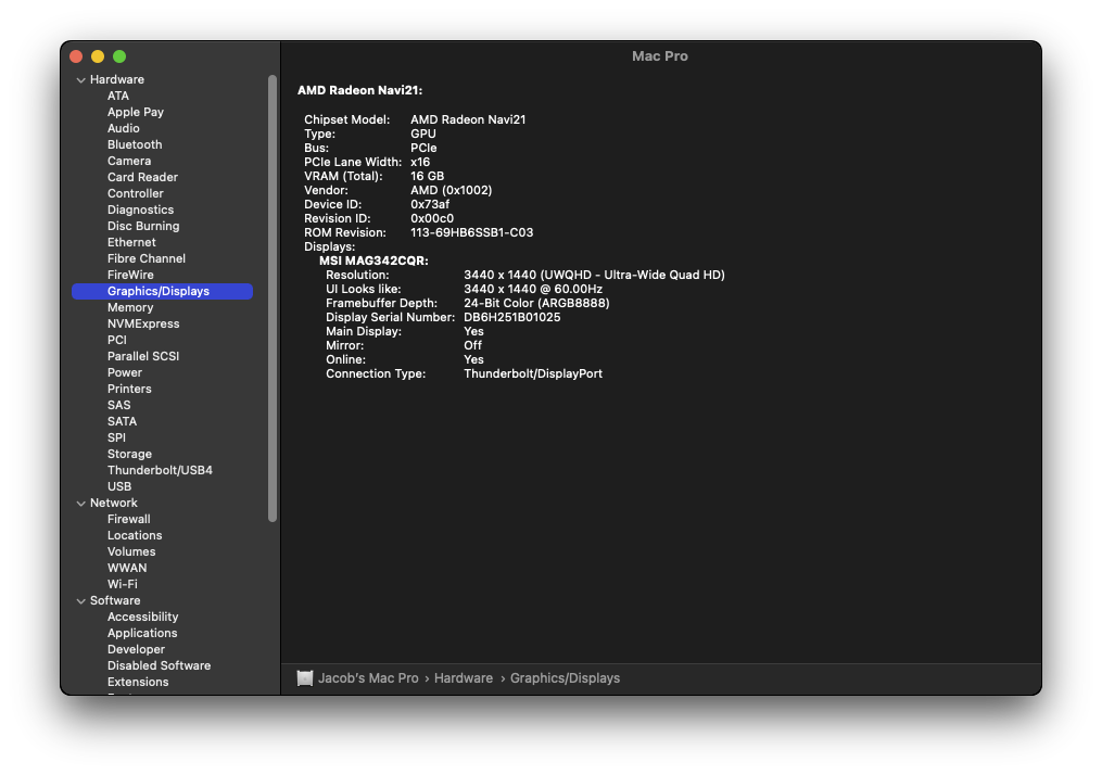

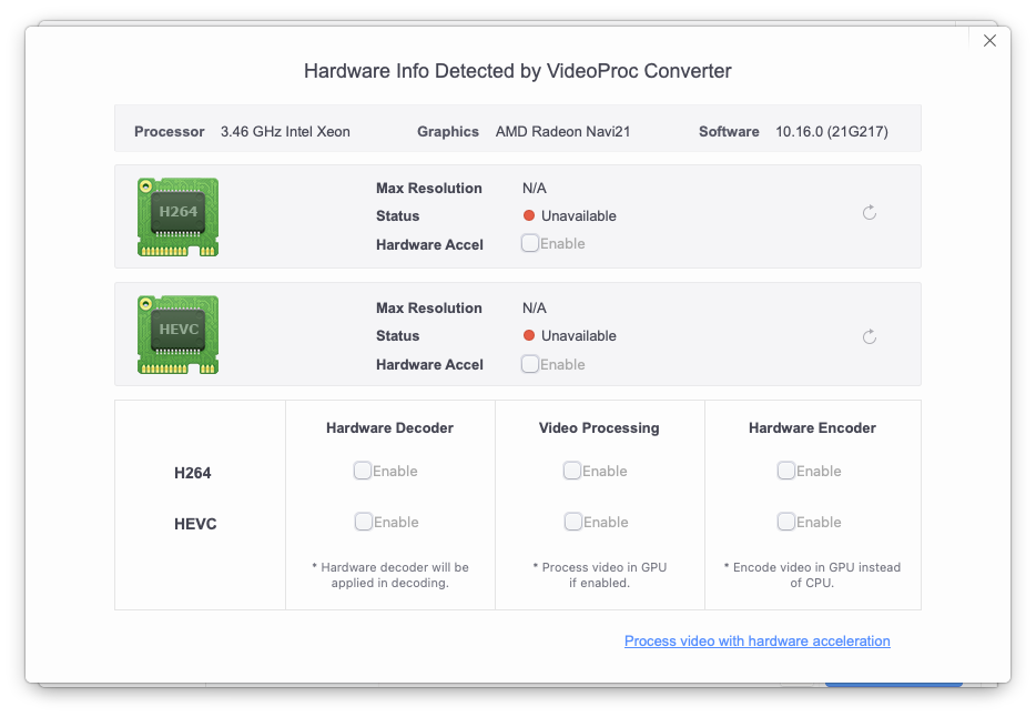

Hey all, I'm using OCLP 0.5.2 and just got a 6900XT which I flashed using Syncretic's patcher. Am able to boot to Mac and Windows but I noticed on Monterey 12.6.1, I'm not getting graphics acceleration like I used to with my 5700XT. My card is being seen as "Radeon Navi 21 16 GB" rather than Radeon RX 6900 XT. Does anyone know how I can get this fixed?

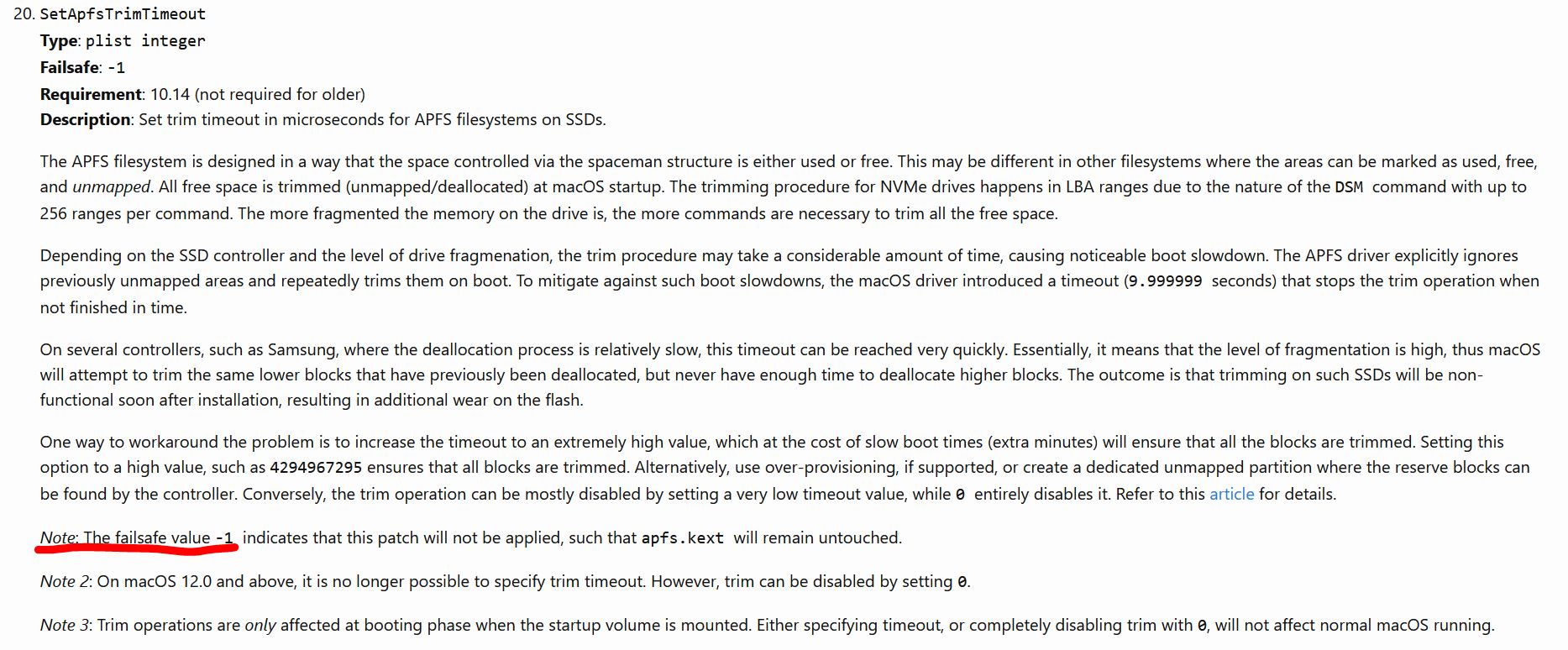

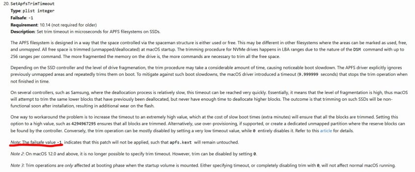

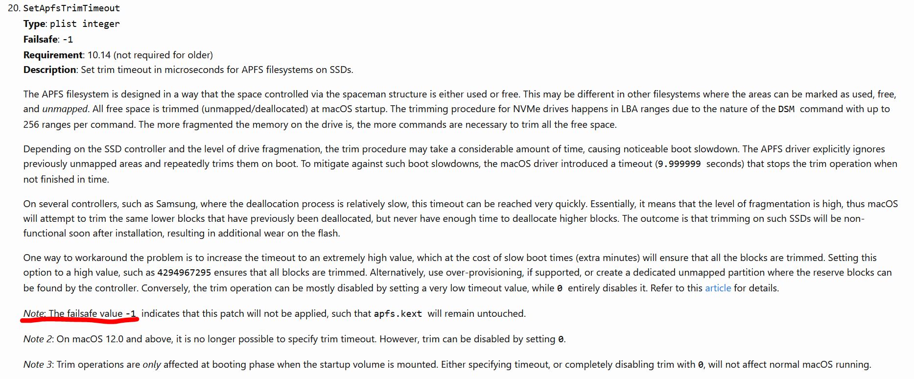

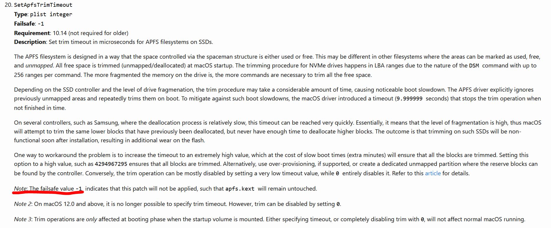

Is it OK to set the SetApfsTrimTimeout value to -1 with your package? From what I understand, this will do a standard length TRIM during boot.
Can, but I believe either set 4294967295‬ or 0 is better. That standard timeout will cause the TRIM stopped at the middle of nowhere. If your SSD is one of those drive which need way more than 10s to finish this APFS startup TRIM thing. Then 10s highly like will still at the scanning phase, which means, end up just spend 10 more seconds on boot, but achieved nothing.
If SetApfsTrimTimeout is an unsigned 32 bit value, then -1 = 4294967295‬
-1 works as a flag that switches the item off for this particular setting.
It does indeed wrap around to the max value everywhere else it can be set in the OC Config.
I had been looking at this page, which suggests -1 = 10sec, and 4294967295 = unlimited. OTOH, the same page suggests 999 = off, so perhaps it's different in our case? Link: https://github.com/dortania/bugtracker/issues/192
If 4294967295 and -1 are interchangeable, I'll use -1 as it's neater, and simpler if I ever need to switch it on and off.
With a 960 Evo I got long boot delays with 'boot trim' turned on, but having changed to a 970 Pro, no issues at all with timeout set to 4294967295. Boots right up.
They are not interchangeable and -1 is an OFF a DO NOTHING flag for SetApfsTrimTimeout.
For other options were it can be set, -1 does wrap around to the max value but this is not the case here.
You might want to always refer back to the OC Manual for info on config settings.
Edit: "-1" is not for OFF but DO NOTHING and OFF/DISABLE is "0" ... A subtle difference
Sorry, misread what you posted previously. I had skimmed and thought you'd said the value wrapped; I understand now this is one exception. Thanks for the clarification.
Edit: The manual says: "Note 2: On macOS 12.0 and above, it is no longer possible to specify trim timeout. However, trim can be disabled by setting 0."
So does this mean that specifying 4294967295 when booting Monterey does something or not?
Is 4294967295 a 'special case', or just a big number (the biggest can be specified)? Certainly, with the 960 Evo, the difference between using that number and 0, was a minute or two to boot vs. a few seconds.
