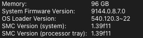

you forgot to change the version ;- )
Thanks for the report. That's fixed few hours ago, you may re-download the latest one. Or just chage that number inside the config.

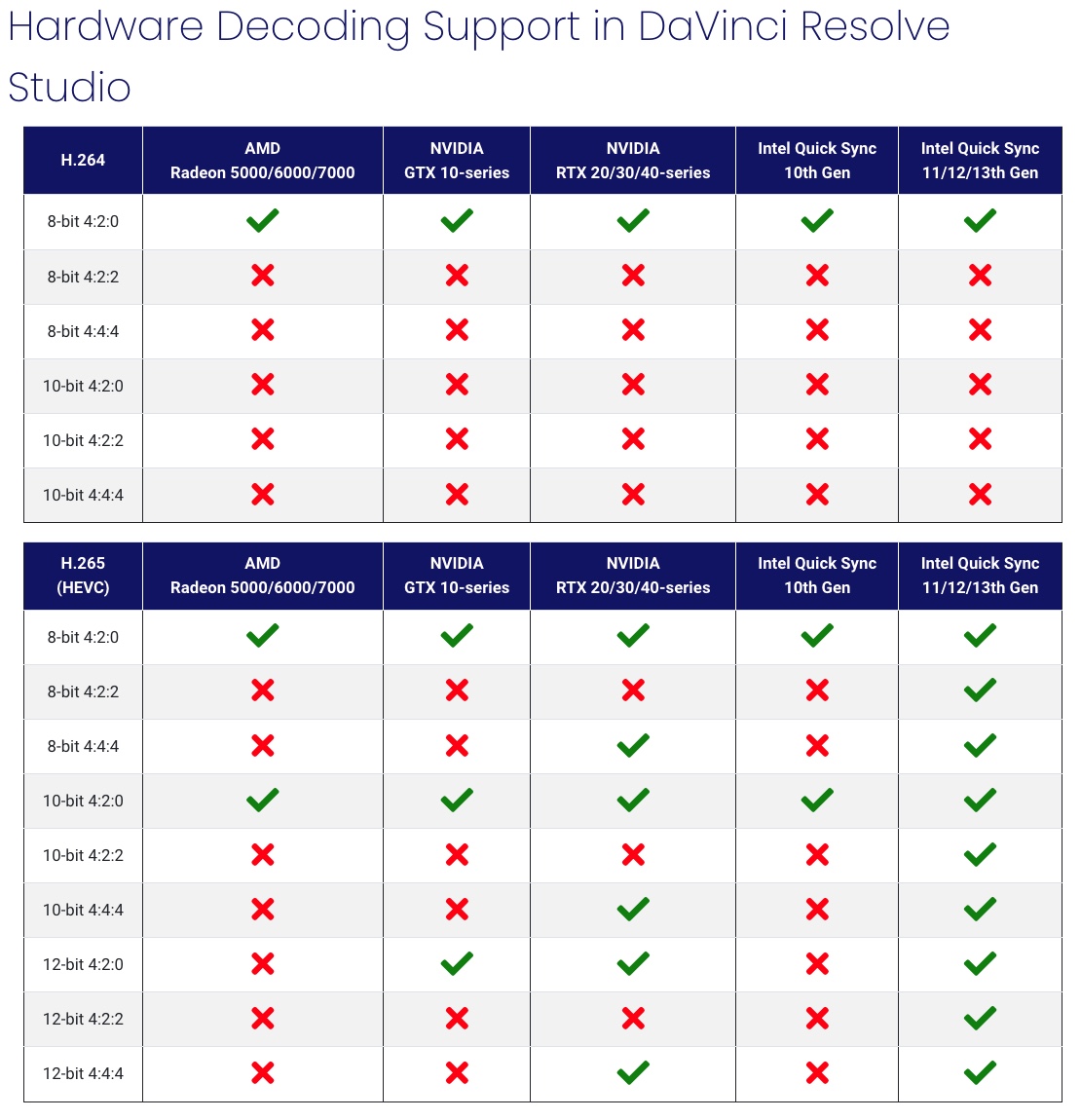

I have HW GPU Decoding on my RX 6600 8GB on latest Ventura 13.1, but I have a problem. I am not able to HW Decode video higher than 4k. For example I tried 5.3K 60Fps HEVC from GoPro and it uses the CPU to decode the video. I think this is because there is a limitation imposed by the OS (Max Resolution or Max Level). The GPU is able to decode 5.3K 60, so it is just a limitation imposed. Is there a way to force HW Decode for every video?
Moreover, I am not able to encode video at 10bit HEVC using Hardware Encode, but it uses CPU Encoding, even if NAVI has 10bit HW Encoding.

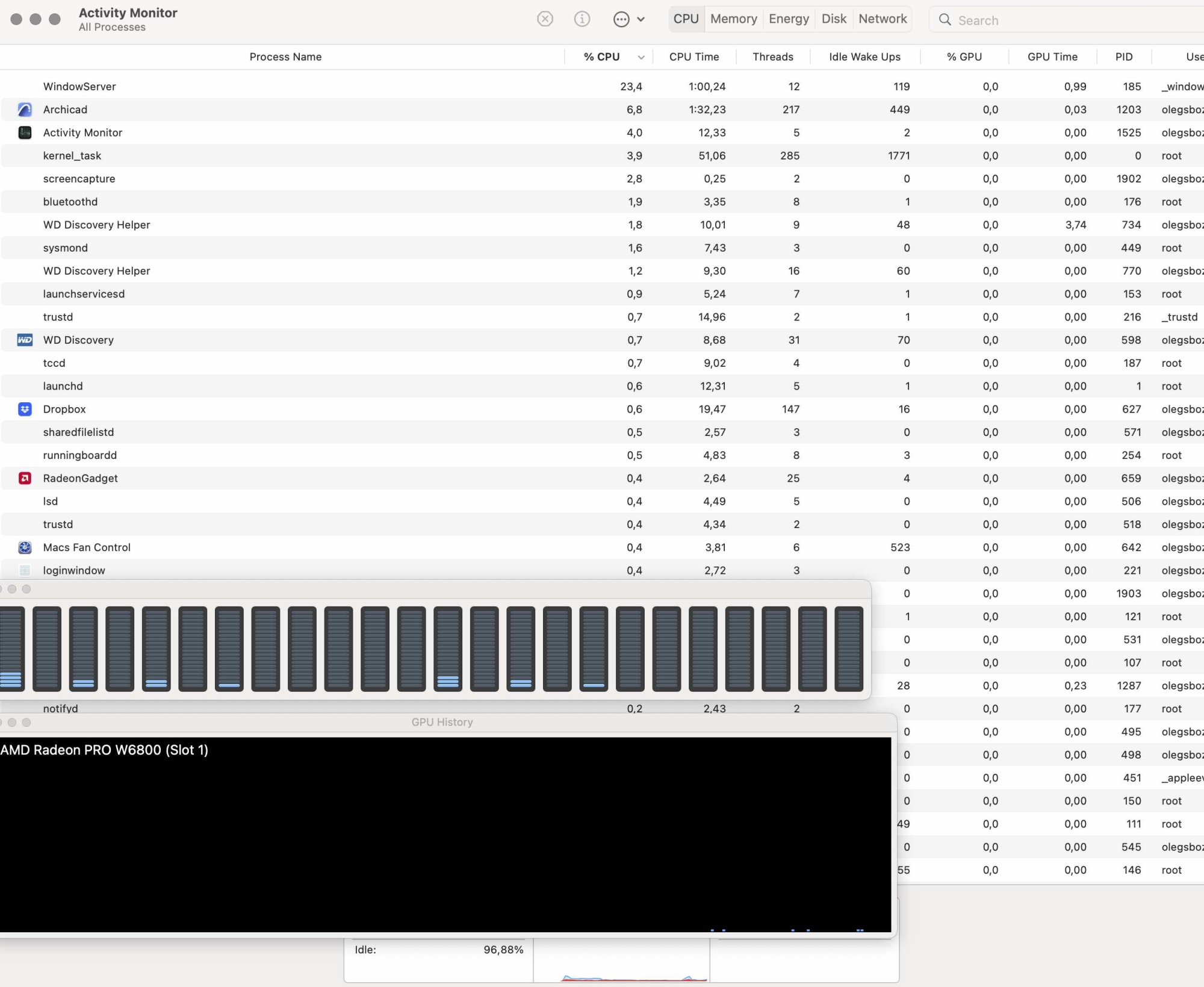

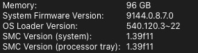

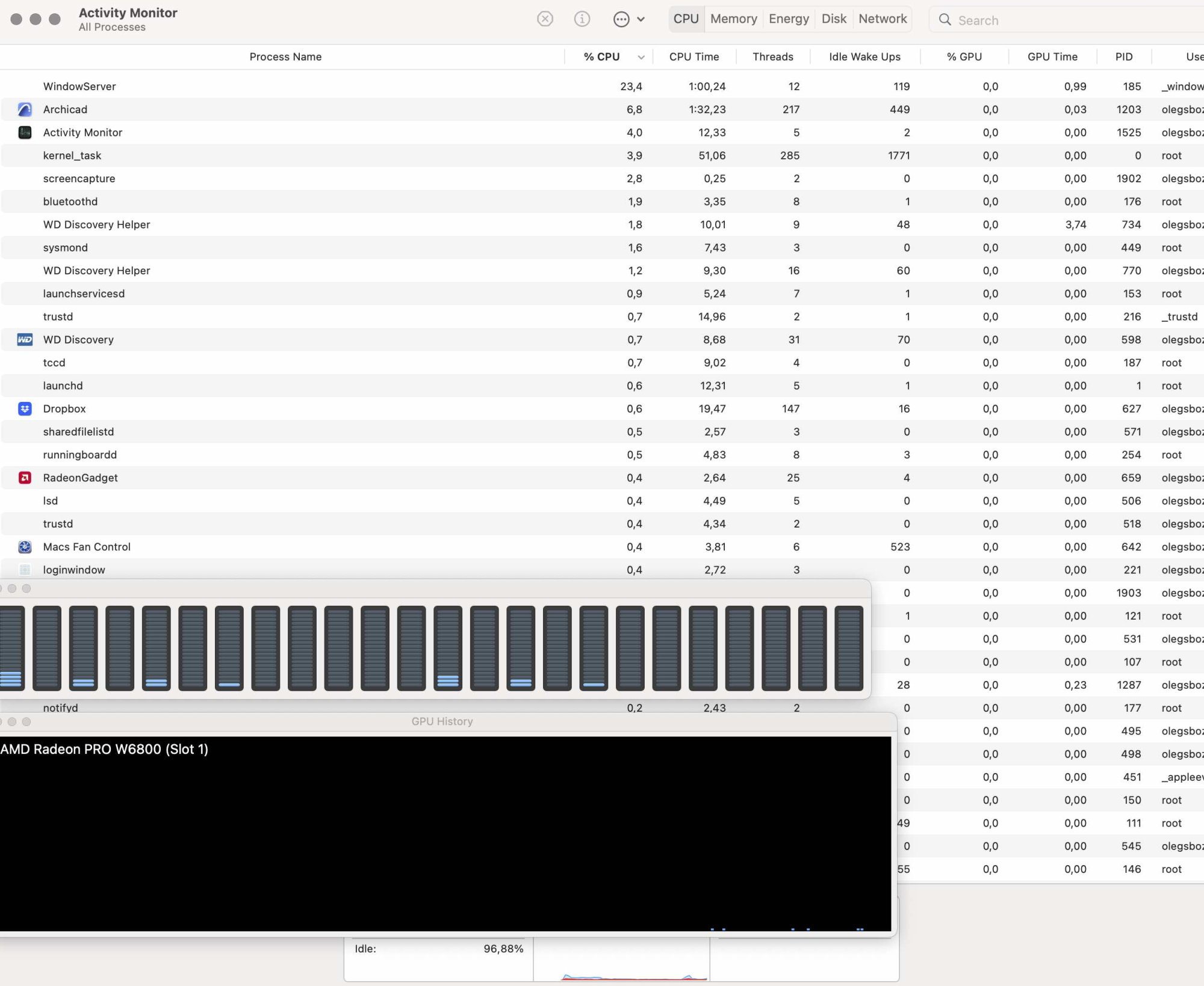

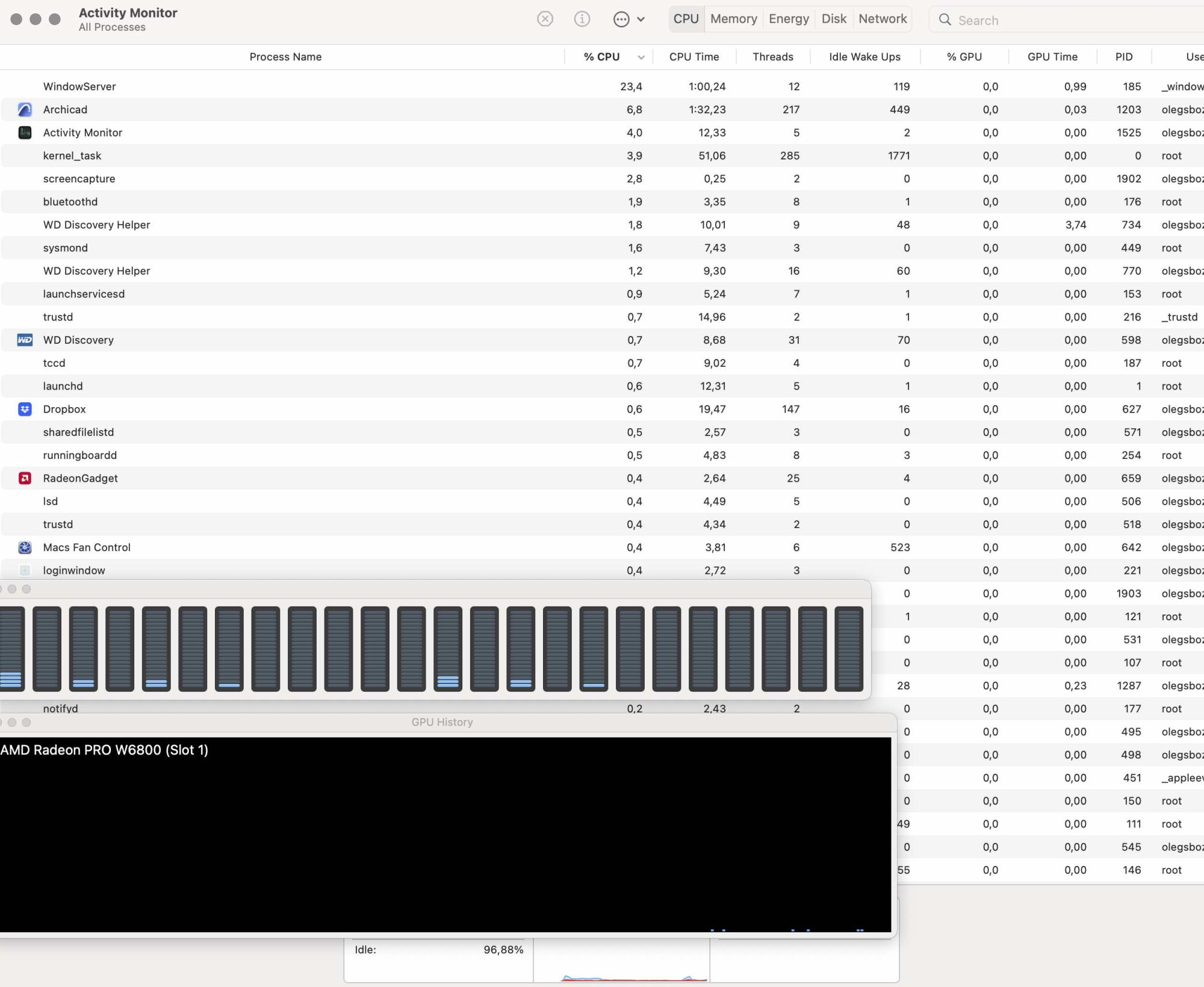

with the latest config 0.8.8, I have a kernel task process at 56% - this process uses a lot of processor resources and reduces performance. at the same time, if I use my individual config made with cdf instuctions - everything is fine.
As far as I can guess, if something does not work correctly with addresses or something is wrong in the smbios version or somewhere else there is a conflict or contradiction, a non-stop cyclic task is launched. I’m attaching a screenshot of my normal work (I didn’t take a screenshot of working with Martin’s config, but there it’s just that the kernel task is 50 or even 65%)
All previous tested versions of Martin's config worked well
I am attaching my working config for Martin’s understanding, but I don’t attach Martin’s config, since Martin has it
I am attaching my working config for Martin’s understanding, but I don’t attach Martin’s config, since Martin has itView attachment 2141936
Thanks for the report. So, no matter how long you wait, Kernel task still stay at ~50%?
My package aim for providing some sort of one stop solution, may be some kext / function is not required in your setup, which cause that extra CPU usage. I only have time to test if the package can boot and function as expected. No time to monitor such issue on my own cMP. It's good to know that you can create your own config which fit your own cMP.
Anyway, may I know if the whole EFI folder is the same (especially the same kexts are used), but you just re-do the config by yourself?

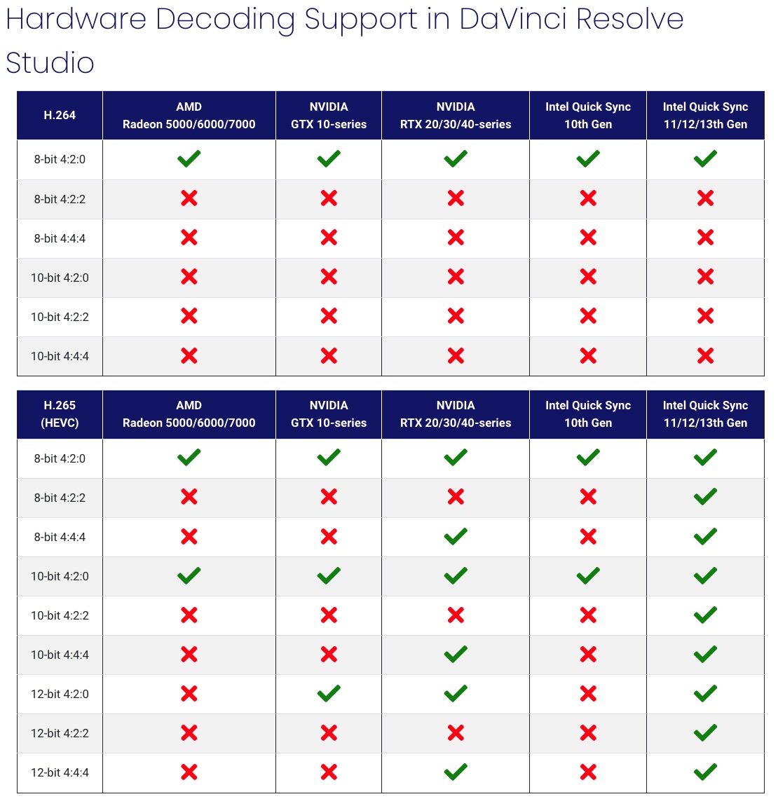

No, the problem is not Davinci Resolve. Decoding 8bit 5.3k 60 is not working in every app (such as QuickTime, IINA)
that's why professionals every resolution (12K, 8K or 6K) always processed in a 4K timeline (if the hardware allows it), but mostly in HD, and only switched back to the desired resolution for export.
No, the problem is not encoding, the problem is decoding, so even using a lower res timeline doesn’t solve the problem. Is there a way to force hw amd decoding for video more than 4K?
