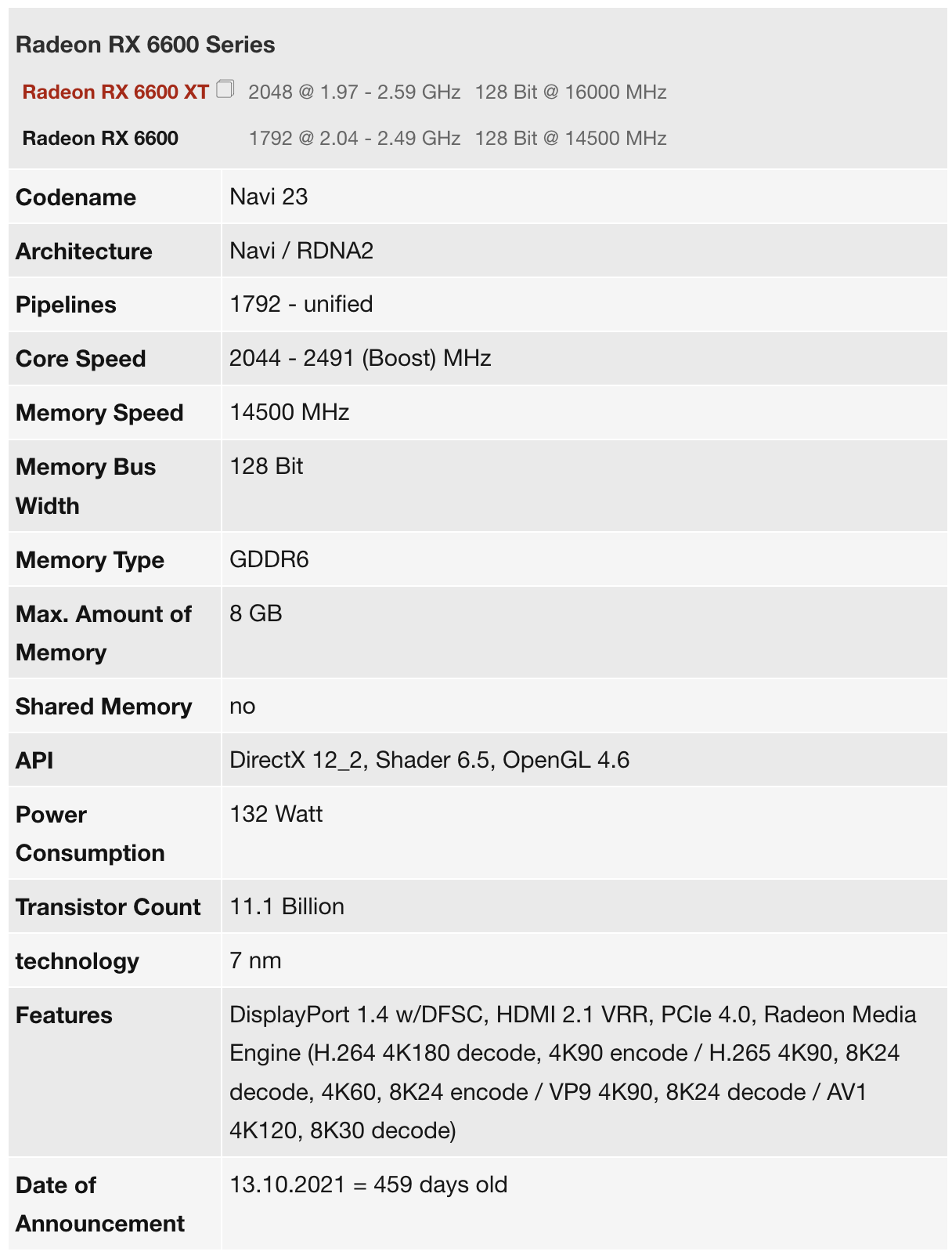

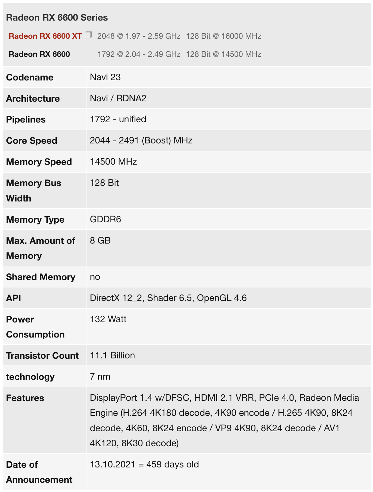

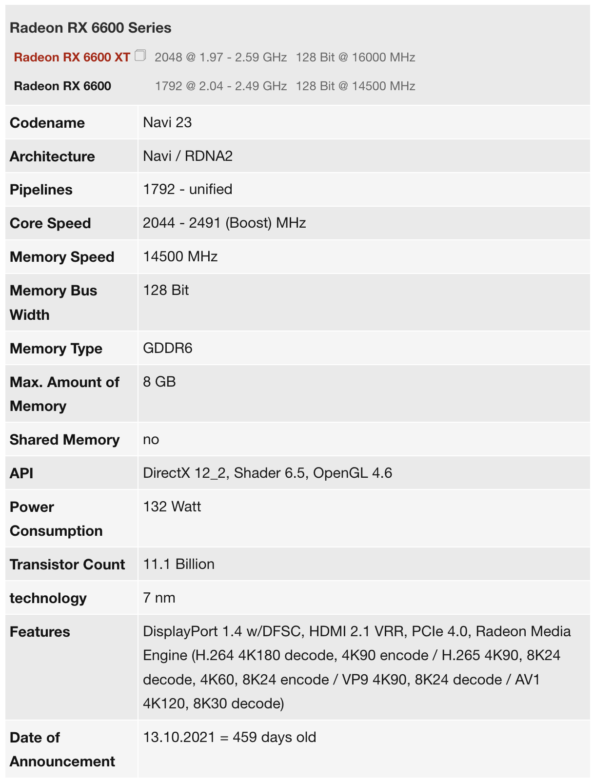

AMD GPU can decode / encode HEVC for quite a few years already. But of course, has resolution / colour depth limit.
But at this moment, still not enough info to know if his videos are outside the hardware limit. Or Apple has extra software limit.
A quick search shows that 6600 has HEVC hardware decode support up to 8K, but just up to 8K24, not 8K60. So, anything above 4K may be limited to 24FPS.
In windows is able to decode fine 5.3K 60 (same video I tested in MacOS) and 8K 30 Hevc

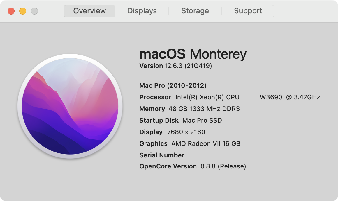

Question: After updating to 8.8 can you update to the new Mac OS without doing anything else or same as before swap the config file first then install the upgrade, then after upgrading put the original 8.8 config file back into folder as before?
*Currently running 12.6.1, Mac Pro 5.1 Mid 2012 2X 3.46GHz w/128 GB Ram, Running RX 580.
Question: I keep reading about spoofing serial numbers, is this something I would need to do before upgrading to Ventura? If so, is there a master list of instructions that is posted that I am just not seeing in this thread? If yes, is it located on page one under the open core section?
Basically, I am just concerned that I am doing everything right and not missing a step.

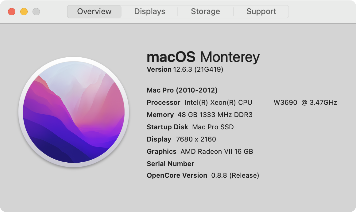

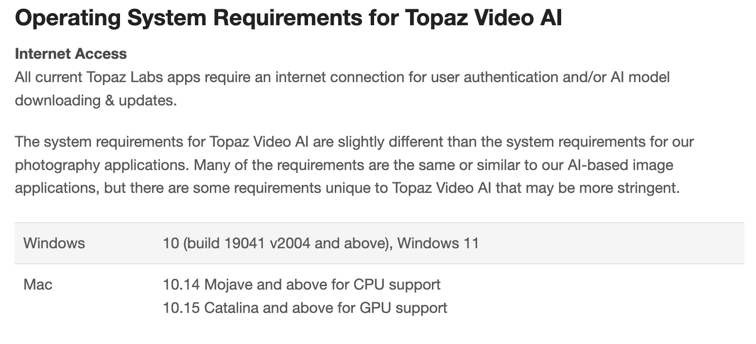

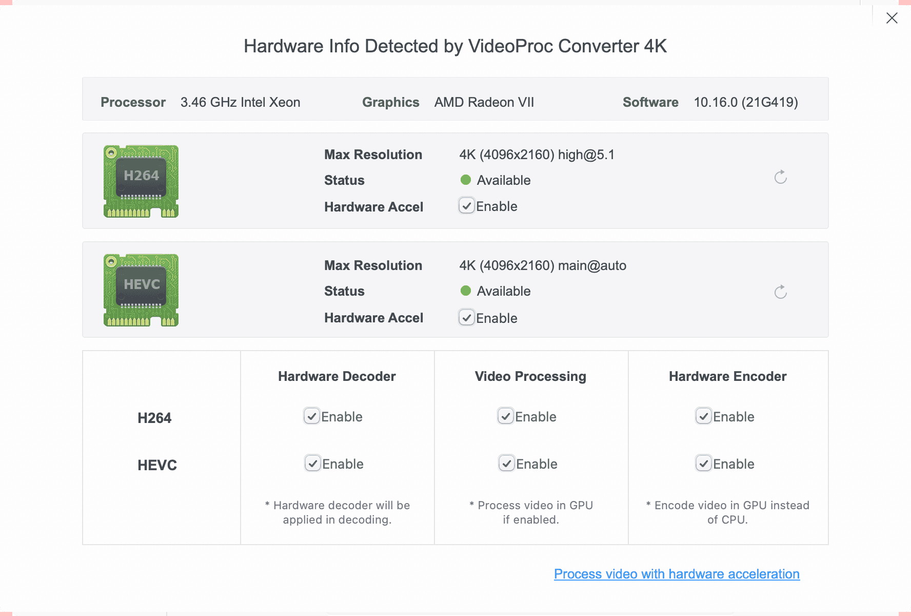

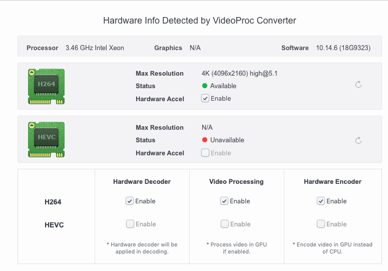

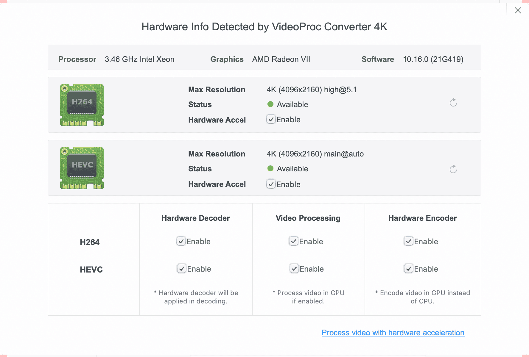

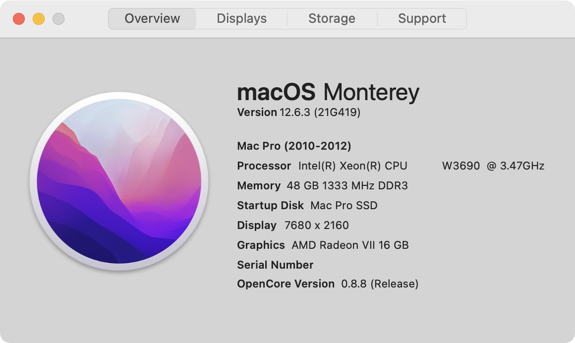

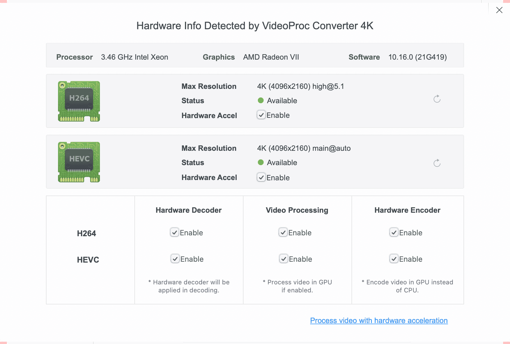

Hi all, first time post/question. Thanks to everyone who has made hardware acceleration possible amongst all the other great things OpenCore provides. This has probably been asked to death so apologies in advance if the solution is simple and I missed it throughout reading all the posts here, but I'm really struggling to identify why HEVC is not showing up as enabled in VideoProc. Thus I'm not sure if HEVC is in fact working as a result. Is there something I need to do beyond just installing OC to get it to run and display? I'm running OpenCore on my Mac Pro 5,1 with Mojave 10.14.6 with a RX580.
As an aside, I curious if anyone can confirm whether Topaz Video Enhance AI 2.6.4 or version 3 can run on a Mac Pro 5,1, either with or without OC/hardware acceleration. I have the X5690 chip on my machine, but I'm assuming its too outdated to run a demanding application.
Thanks for any info anyone can share!
Assuming you never patch any macOS files, please see post #1 Q29.

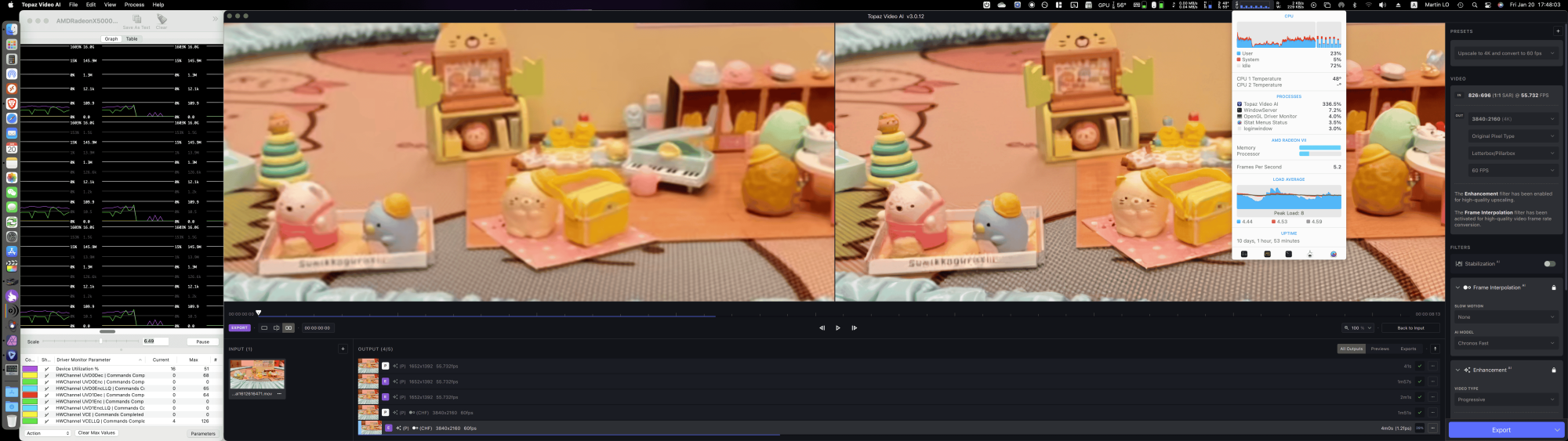

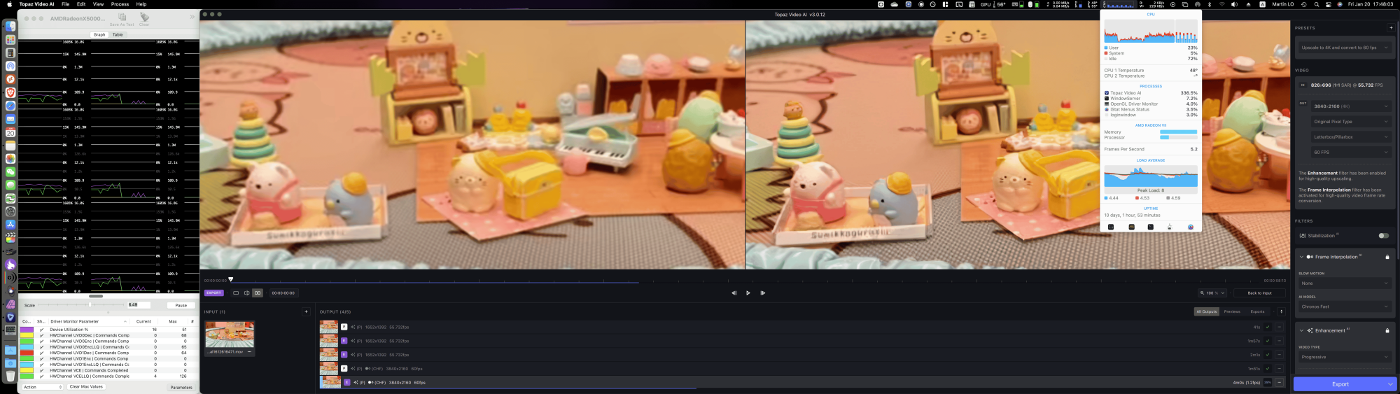

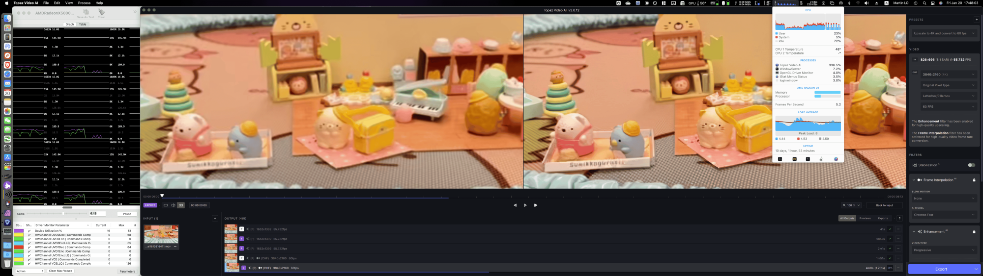

I tested V3.0.12. Both GPU decoding and encoding can work.
As you can see from the above screen capture.
The bottom left shows both UVD and VCE have been used. In fact, the UVD (AMD hardware decoder) has been used during I ran the preview. And the above capture was done during export, at the moment of VCE (AMD hardware encoder) has been called.
But for this kinds of video processing, the main bottleneck usually is the "processing" itself, not decoding or encoding. So, you may feel little to no difference regardless the software is using the GPU to decode / encode or not.
As per the capture above, I selected the "upscale to 4K and convert to 60FPS" profile. Which only performed at 1.2FPS. Even my W3690 can encode 4K HEVC video faster than that. Therefore, hardware encoding isn't that critical for this particular process.
Besides, the CPU loading isn't high at all, your X5690 should be more than enough. Of course, the single thread performance may be still the limiting factor. As you can see, the GPU loading also isn't that high. So, it shouldn't be GPU processing power limiting in my test.

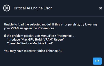

Thank you for your reply. regarding your reference to post #1 Q29, I did see that VideoProc doesn't display HEVC though it is apparently working. I've also refreshed the two options via VideoProc but it still does not display HEVC as enabled. I used your latest OC package and have not done any patching - can you advise if patching is required to get it to display and function properly? I'd be happy to read any instructions if you can point me to the right one.
Thanks for confirming Topaz VEAI would work on the Mac Pro 5,1 with my specs. Strangely, none of the models on either version 2.6.4 and the latest load and I always get error messages when I try to export anything out. I've tried to do what the instructions in the attached from the program specified but nothing has worked, thus I believed Topaz VEAI would not work on this machine. Now I have no idea what is going on. The first more detailed error is from version 2.6.4 and the second is from the latest version.
I don't have 2.6.4. Did you follow the suggestion to lower the Max VRAM, and reduce machine load?
On the other hand, there is no need to patch the OS, in fact, better not to (that's why we use OpenCore to achieve what we want).
Anyway, I just check Topaz's official website. Mojave only has CPU support. If you want to utilise your GPU, you have to upgrade your macOS.

Just tested Monterey 12.6.3 can be installed by enabling VMM and disabling SMBIOS spoofing without any issue.
HWAccel still working.
Yup! Very smooth install. A pretty quick one as well, much quicker than other Monterey installations. Then again, we're just getting security updates at this point and no new features. Will ride this Mac Pro for as long as I can!
