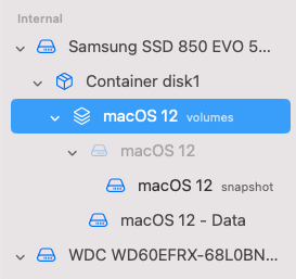

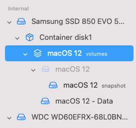

@cdf, as data for your hypothesis I only have a single APFS volume on the SSD Volume in question.

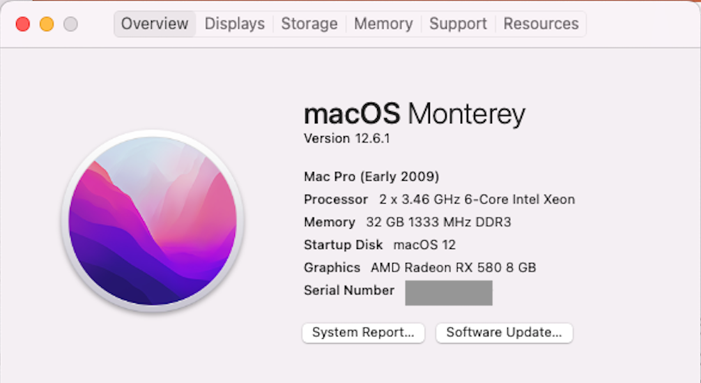

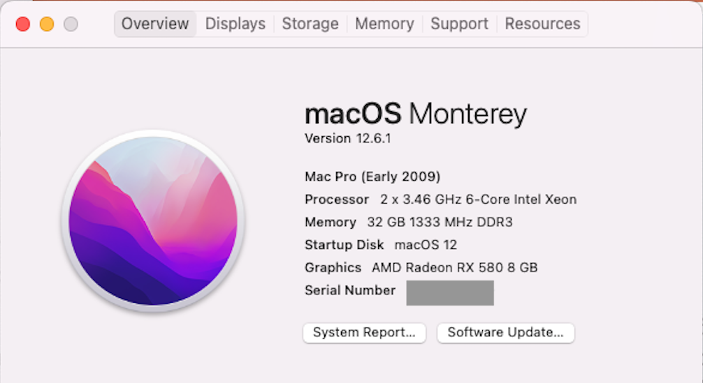

Will probably try a clean install of 12.6.3, which is my second question, 12.6.1 is when I joined this thread, I hadn't realized that I had missed the 12.6.2 update. Nor do I see a 12.6.3 update. Should I automatically be seeing those updates?

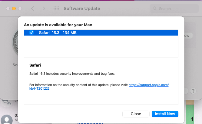

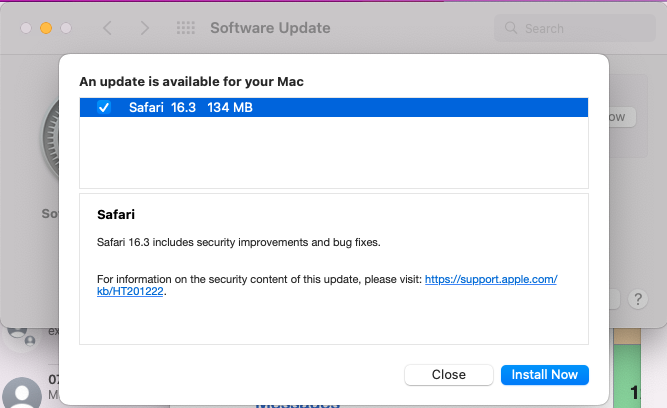

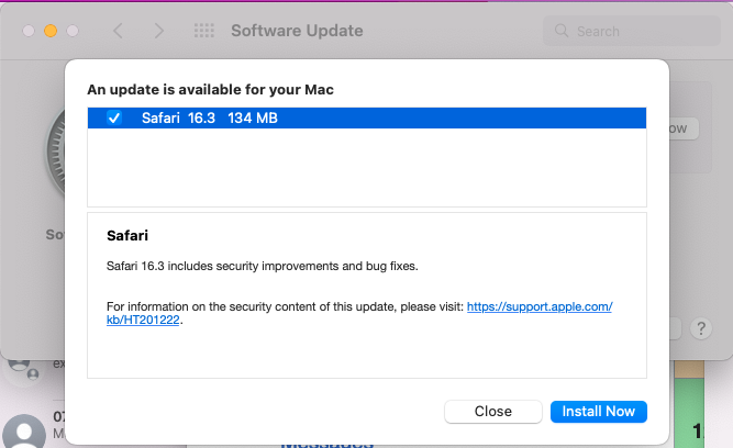

Currently using MartinLo's 8.6.0, firmware 9144.0.8.6.0 and I don't seem to be receiving macOS updates. Here's what Software Update is reporting.
View attachment 2147252View attachment 2147253
You neet to enable the VMM flag and check the UpdateSMBIOS settings in your OC config.plist to update your OS safely. See this video (turn on cc)
Make sure to reverse those edits after updating since they are not meant to be permanent and can affect power management
Thanks for the info. Do you have any other disks that use APFS?

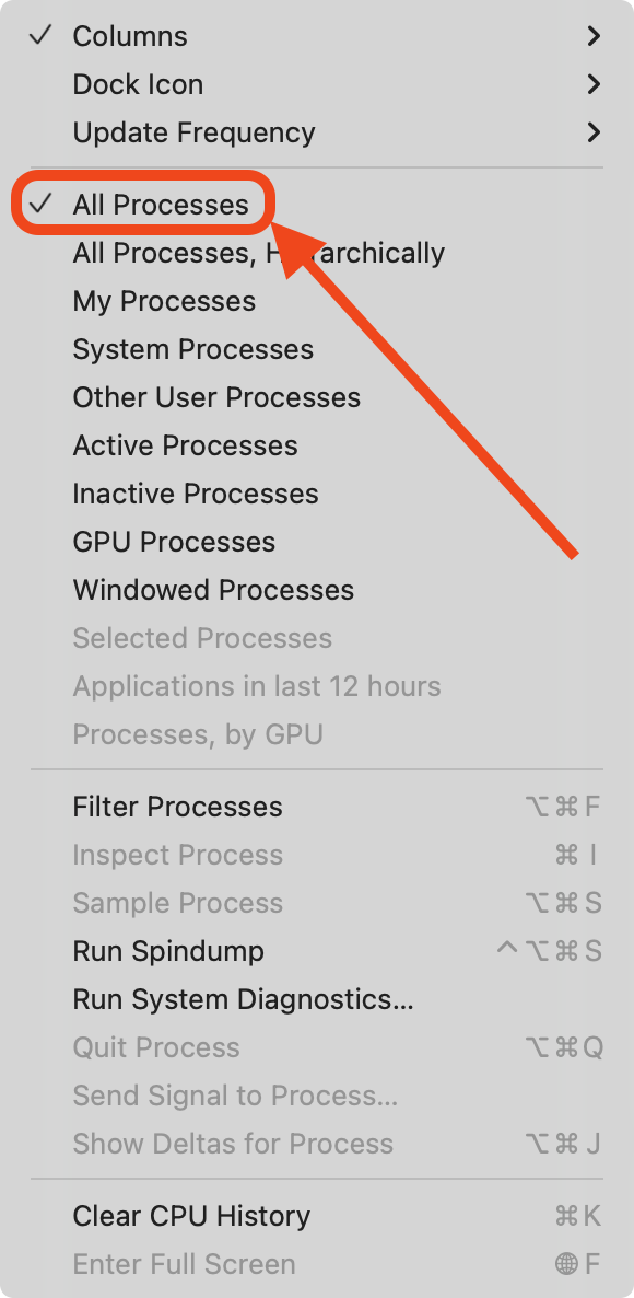

This may be a long shot but I'm curious as to if anyone else is experiencing this. For the last two MacOS versions (12.6.2 and 12.6.3) and using the 0.8.7 and 0.8.8 package, I've noticed that around every two or so hours something within macOS just decides to basically read my NVME SSD to death. The system gets slowed down to a crawl. The reads in/sec go up to about 3-4000, and the writes go all the way down to 0 leaving the system to be unusable unless I restart or wait about 30 minutes. The amount of Data read/sec is about 50MB and is pretty much static the whole time. I've checked so many processes, and none of them have either excessive Bytes Read or high CPU utilization. Yea, I've done a malware scan and nobody is remotely connecting to my computer. For the life of me I cannot figure out what is causing macOS to read my SSD to the point of a crawl. But what bothers me most is that the processes within Activity monitor dont show any one process thats showing a high amount of "Bytes Read". The total amount of "Data Read" by activity monitor can show 500GB, meanwhile the process with the highest amount of "bytes read" only has 20GB, and totaling up the rest of them lead nowhere to 500GB.
Anyone ever experience anything like this before?

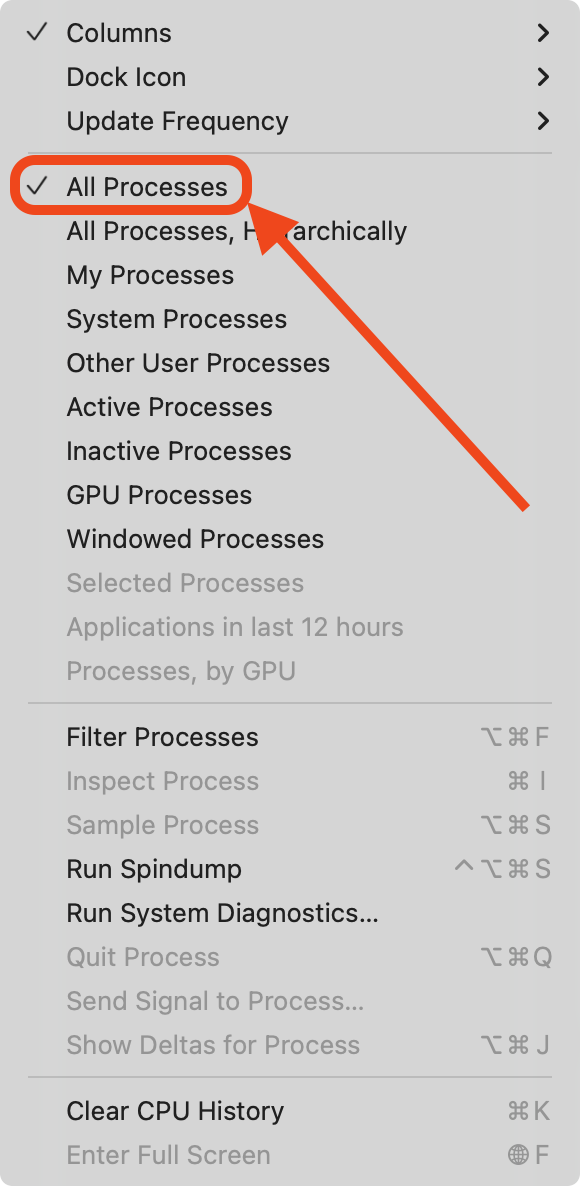

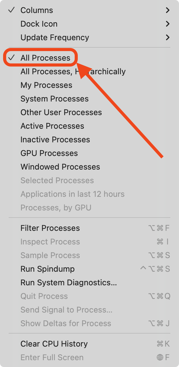

Have you select "All Processes"?
Yup, all processes are selected. I've even tried to search Console for any sort of errors, but I don't exactly have any hints as to what to be searching for with something as strange as this. The only thing I'm really seeing in the console repeatedly is AMPDeviceDiscoveryAgent[593]: Entered:_AMMuxedDeviceDisconnected, mux-device:521, which im pretty sure is unrelated as it corresponds with iOS devices trying to wirelessly sync. One time the computer actually logged itself out automatically and had me re-log in to re-launch everything. Never seen anything like it.
