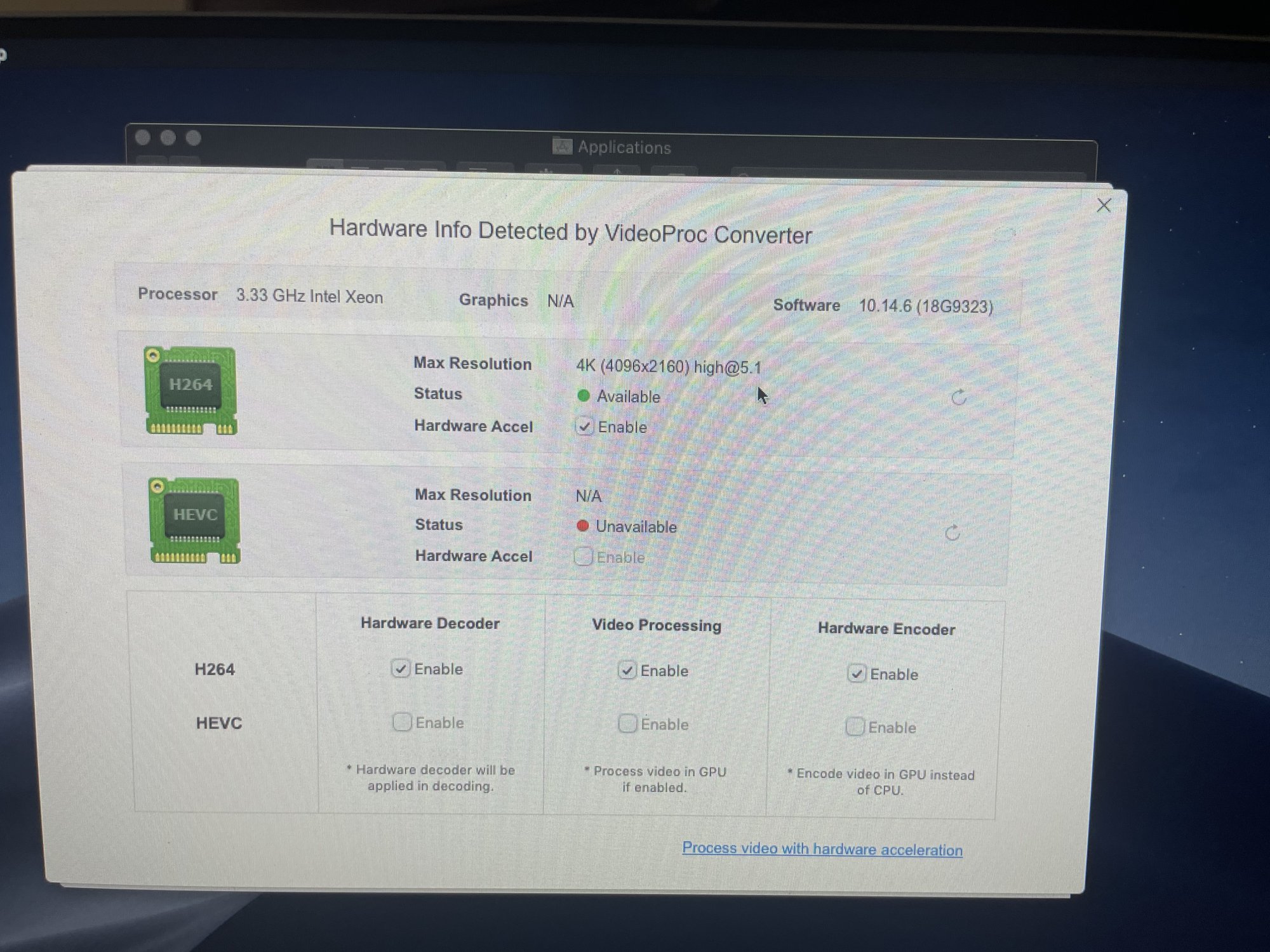

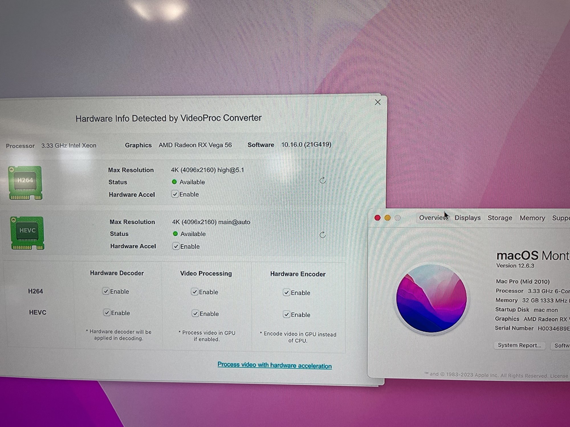

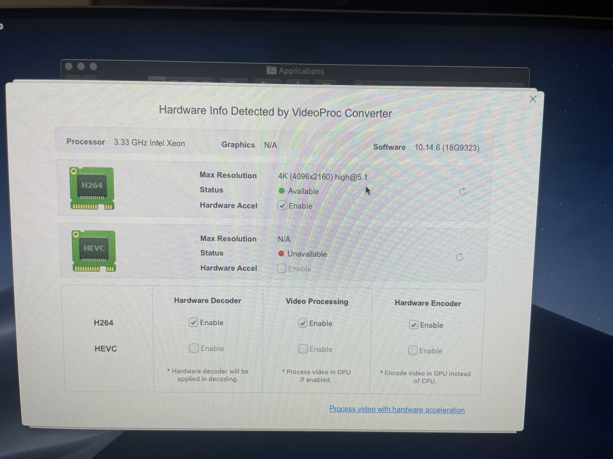

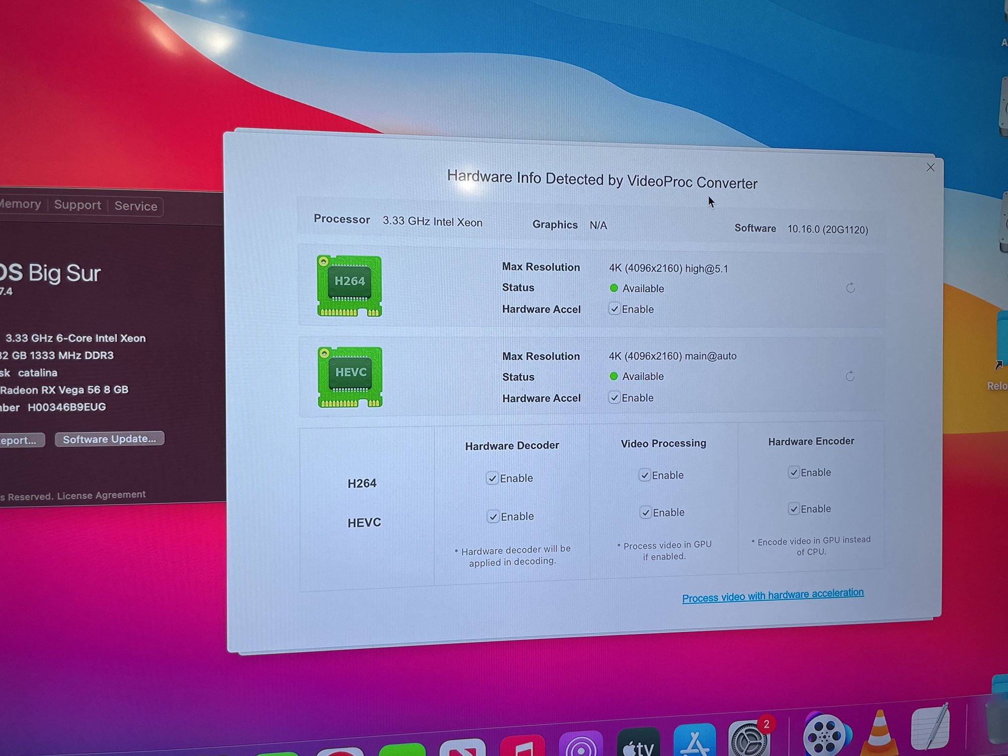

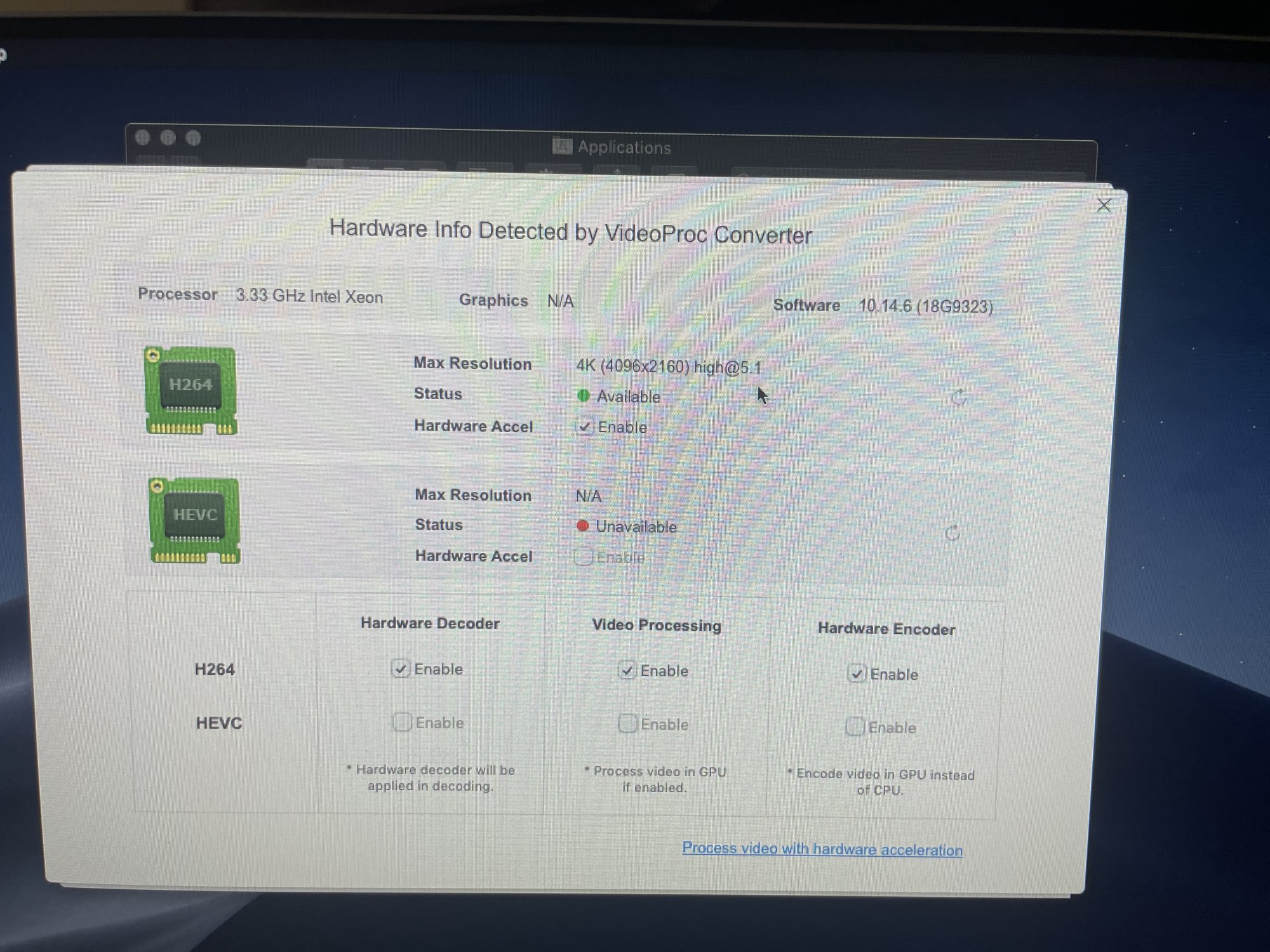

Hi everybody
I’m new to opencore
I use 0.92 for Mac Pro 5.1
Vega 56
But I don’t have hevc working
Any help
Thank

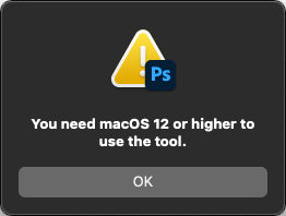

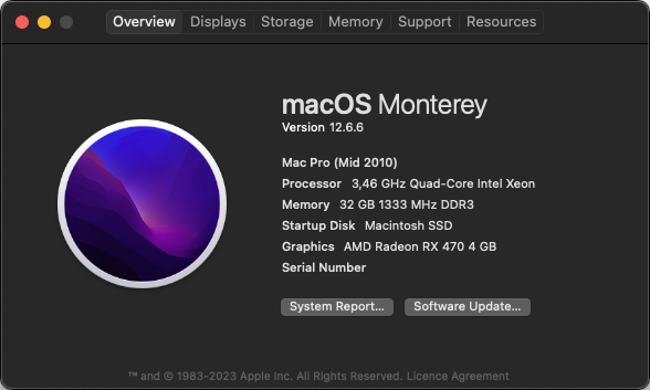

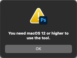

In the current version of Photoshop 24.5, a new functionality requiring macOS Monterey was added, so I finally decided to update from BigSur (using Martin's Package). It was successful, a few notes:
- I downloaded the Monterey 12.6.6 installer from
(installer extracted to /Applications)
- I edited the OC config.plist according to Martin's instructions (and restarted)
- after starting the installation, both my displays were black, no signal, for about 20 minutes (my system is on a SATA SSD), you have to be patient and not interrupt the process (even if it may seem dead)
- after the first reboot, you have to continue the installation from the macOS installer (for me, it launched itself from the system disk back to BigSur, so I repeated the installation and supervised the launch from the installer). The second restart during installation already goes correctly from the system disk.
- the further progress of the installation (approx. 20 minutes) could already be watched on the display
- I reverted the original config.plist from Martin's data 0.9.2 and rebooted
- Monterey works great, seems snappier than BigSur (after about half a day work), also the new Remove tool in Photoshop.
Question: can I update Monterey in the future from System Preferences as with BigSur (now always with those modifications in OC config.plist)? It already offers me the Safari 16.5 update, and in the future I assume that there will be updates to 12.6.7... Or is it better not to touch it anymore? Automatic system updates are turned off.

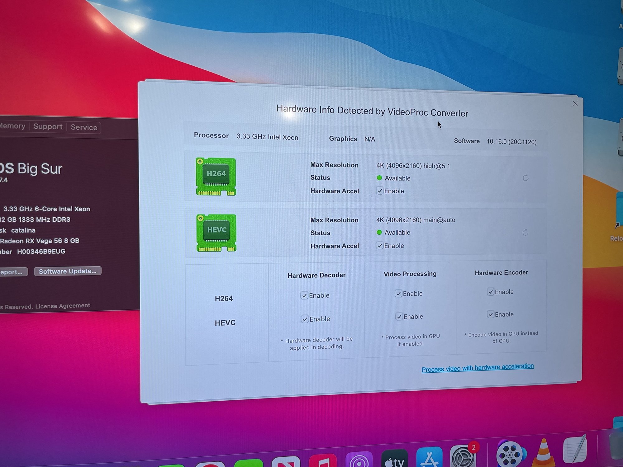

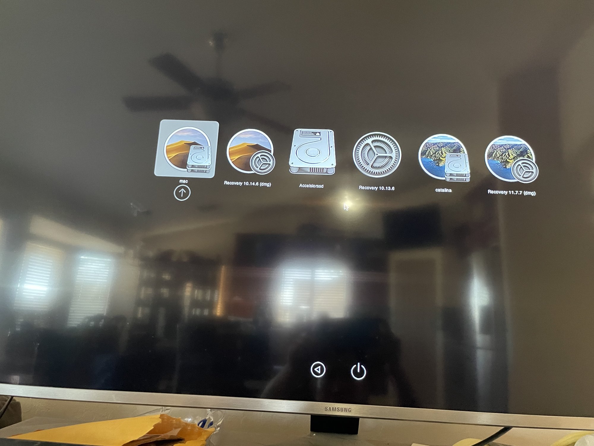

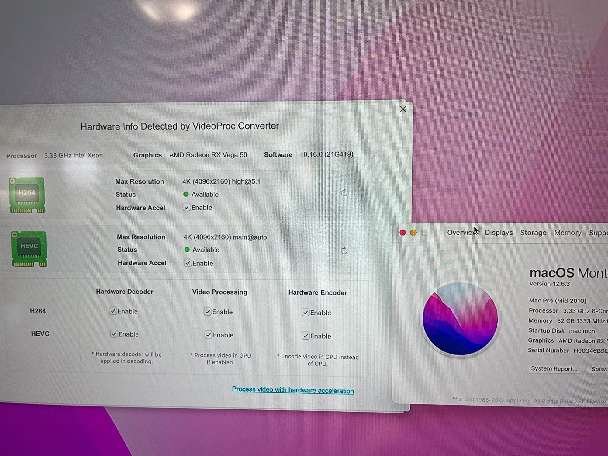

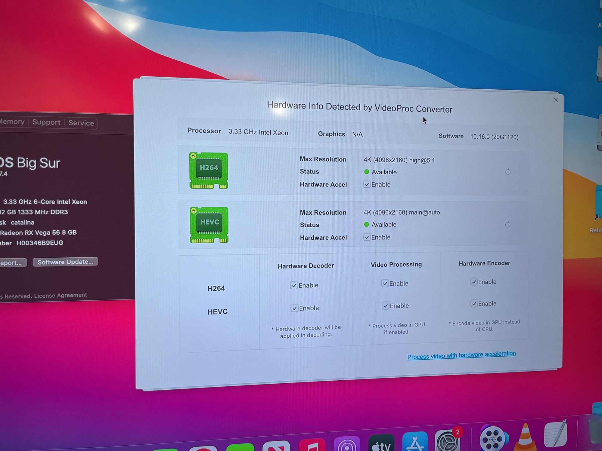

I install bigsur the problem gone
When go back to Mojave the problem still there
But now I’m happy with Big Sur
By the way anything I can do to bring back WiFi and Bluetooth without upgrade the new one
Thanks Martin Lo and the team for 0.92 packages

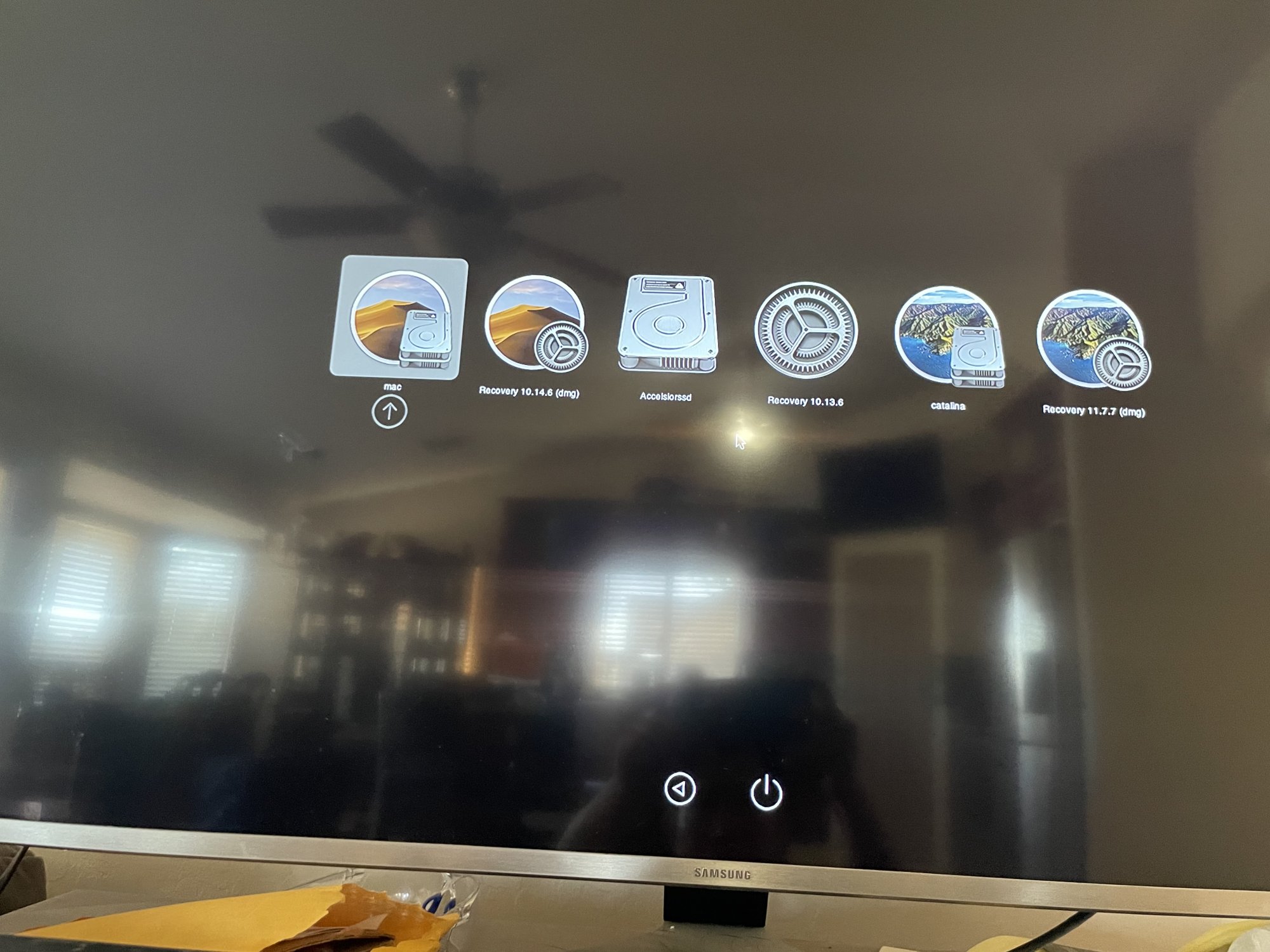

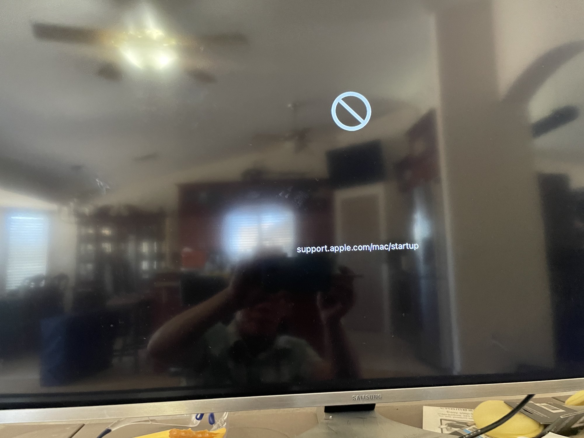

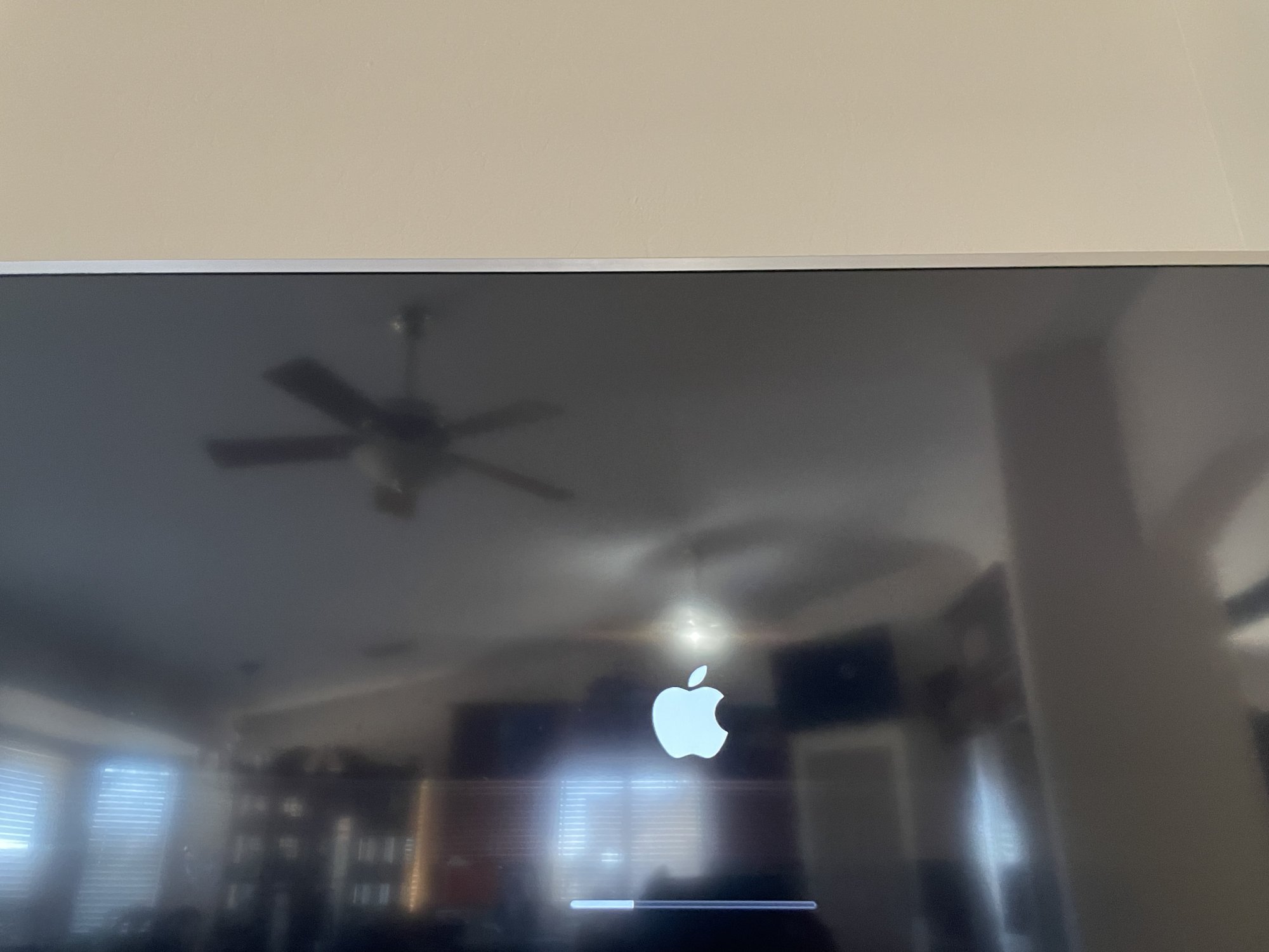

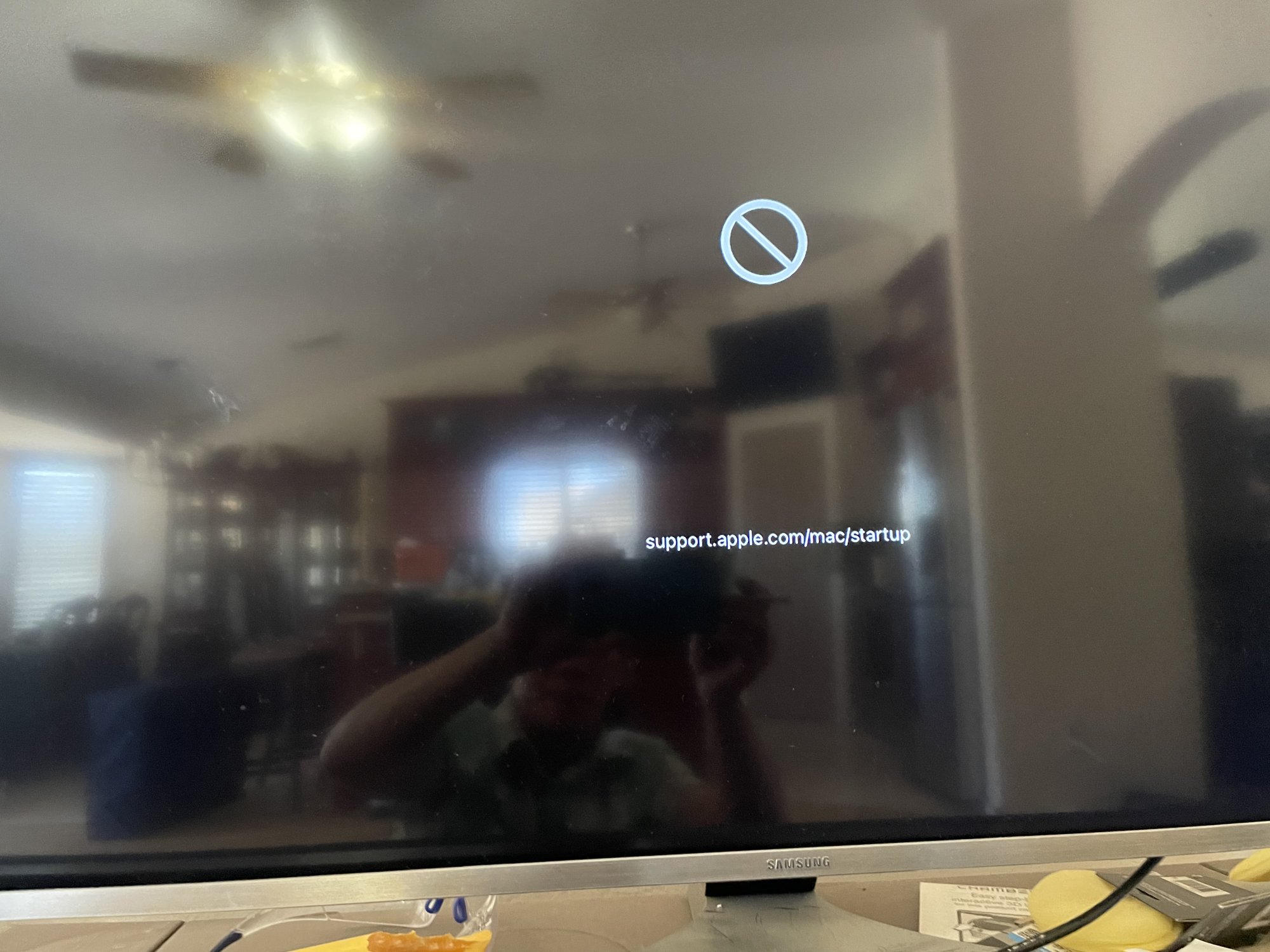

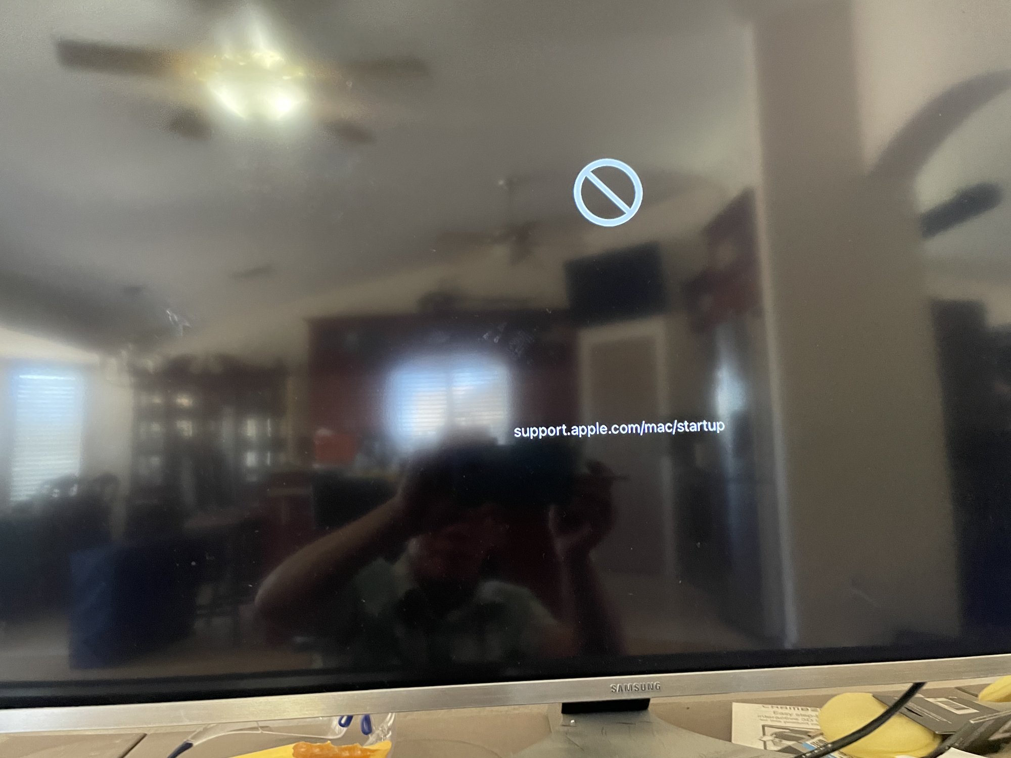

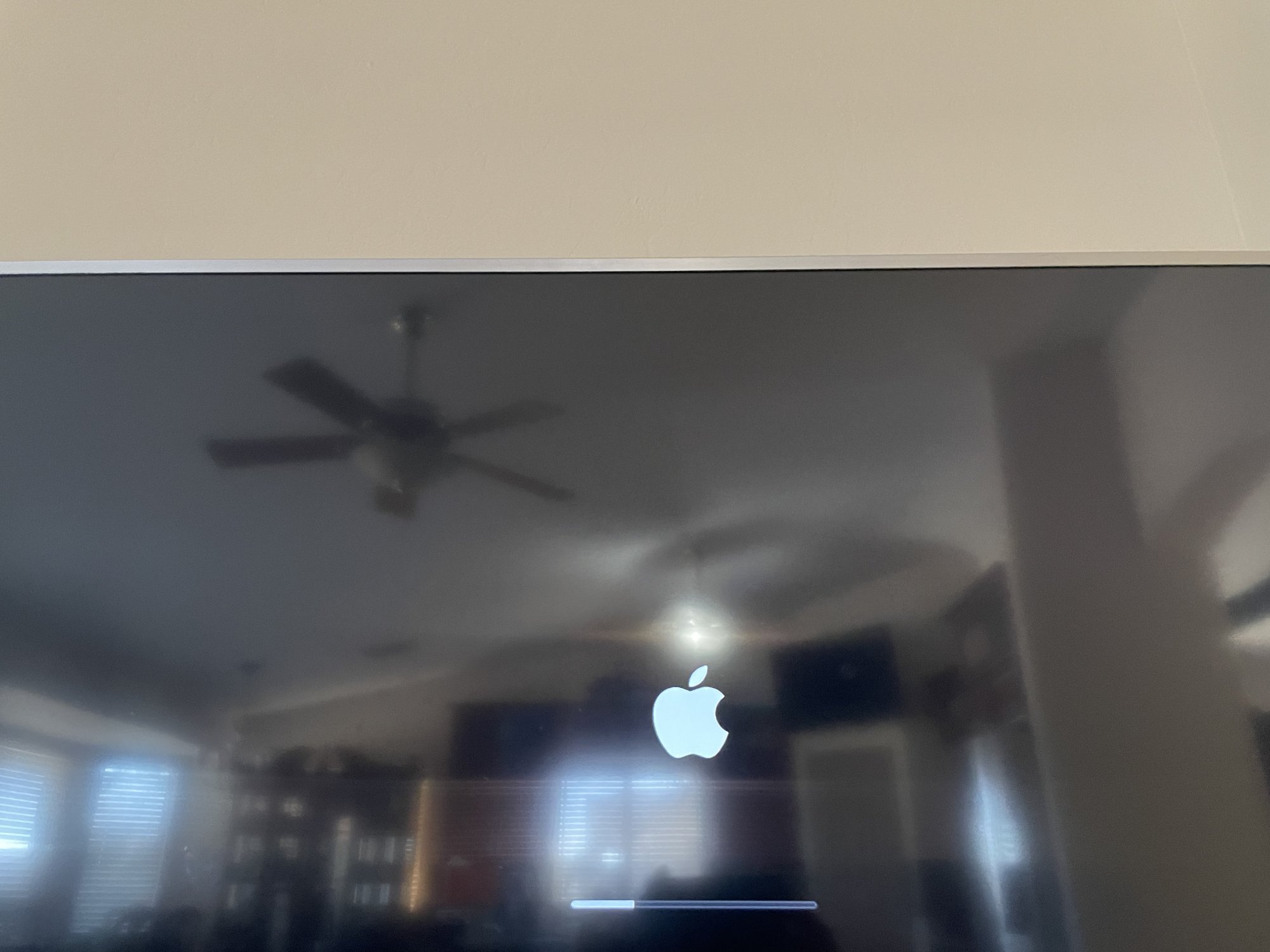

Today I just install Monterey although the installation is successful I still get trouble
I get Apple.com/startup help 3 times . I turn off pc and turn on it back pc continue installing
When I boot to Monterey I still get Apple.com/startup
Turn off and on it boot to Monterey . Do I made any mistake?
Monterey run so smoothly

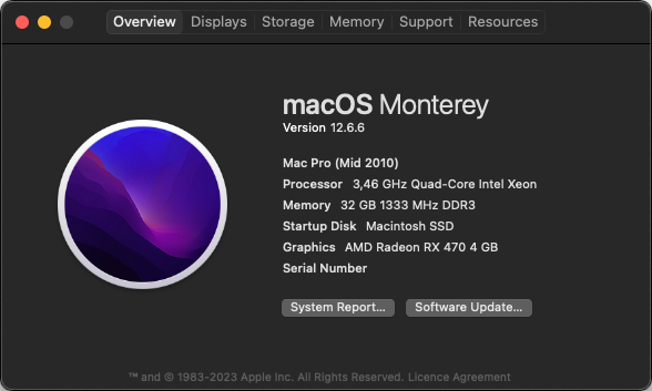

May be you have multiple monitors setup. For single monitor setup, you should able to see the installation progress, but not just black screen.
Anyway, as you said, just don't touch it, then the cMP will sort out itself.
Unfortunately, for Monterey, my package required users to turn on VMM and disable SMBIOS spoofing for every macOS update. However, that's for "Monterey update" only. e.g. from 12.6.6 to 12.6.7. If just something like Safari update, RAW support update, or other misc update. You can simply accept the update without changing the VMM flag.
If you want to make it as seamless as Big Sur, then you can study the cdf's OpenCore post #1. I've put the required FirmwareFeatureMask in the config already (credit to cdf). I have't enable that mainly because once we turn on SecureBootModel, most likely you won't able to boot your existing Mojave (if any) via OC. And I personally recommend people has a Mojave drive for emergency use. Therefore, I am a bit reluctant to let cMP has seamless Monterey support, but can't boot Mojave (when via my OC package).
But TBH, the situation is changing now. When most of the users have their cMP flashed with EnableGop, then I think we can safely turn on SecureBootModel. On the day that really need to boot existing Mojave, the user can simply hold Option key to boot. But that will be at least a few months away.
It was exactly the same way I do install Big Sur with the same drives in pc. The different is I take out bigsur Ssd and put new ssd into it
Now the pc boot into Monterey without any issues
I think the problem still there
Your setup looks OK to me.
But may be you can move OpenCore to the Monterey drive's EFI partition (and bless it).
Both Mojave and High Sierra can boot natively anyway. Put OpenCore onto the Monterey drive make more sense in general.
Ok thank for your advice
Do I need remove the opencore in Mojave before I bless the the new one in efi of Monterey
Up to you.
But if you want to remove it, better install and bless the new one, and after testing to make sure it works, then remove the old one.

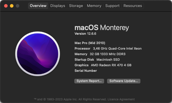

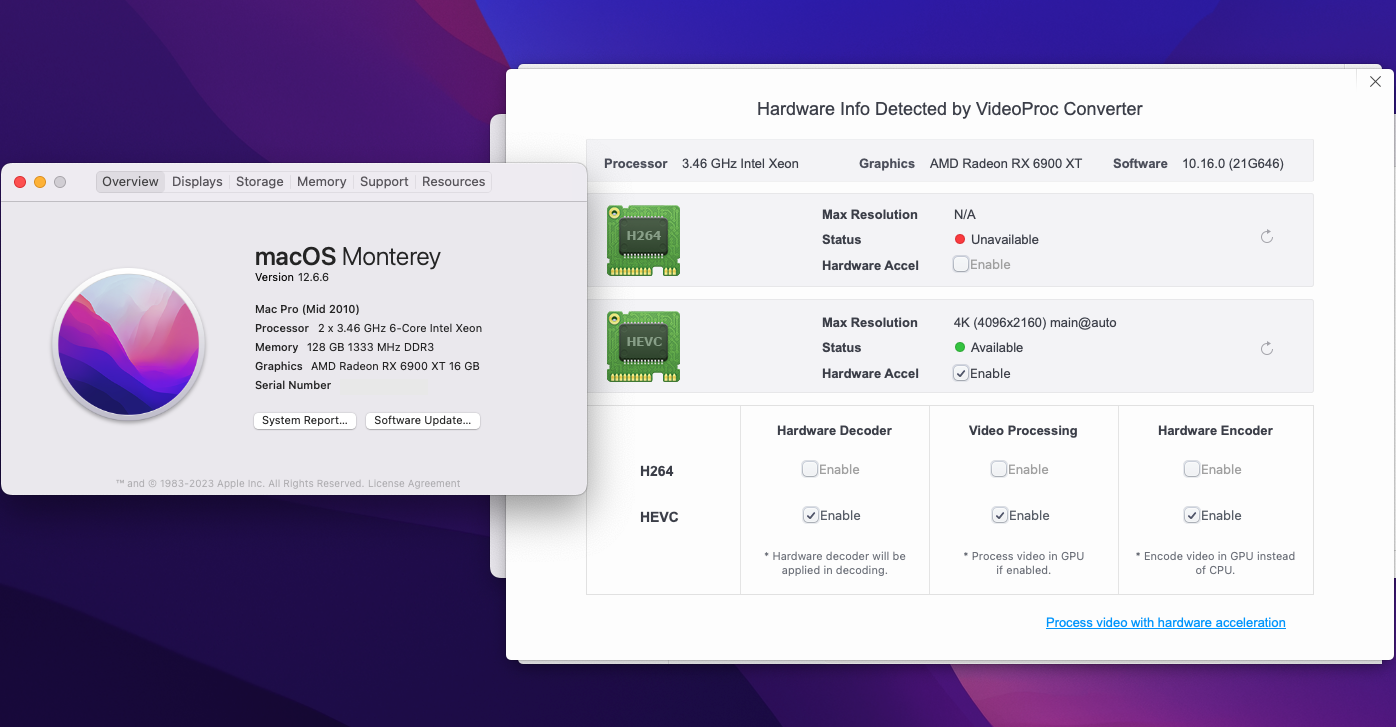

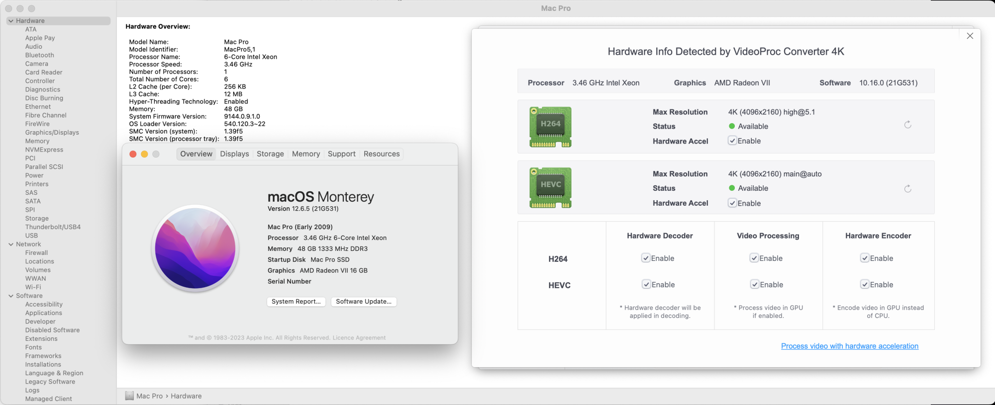

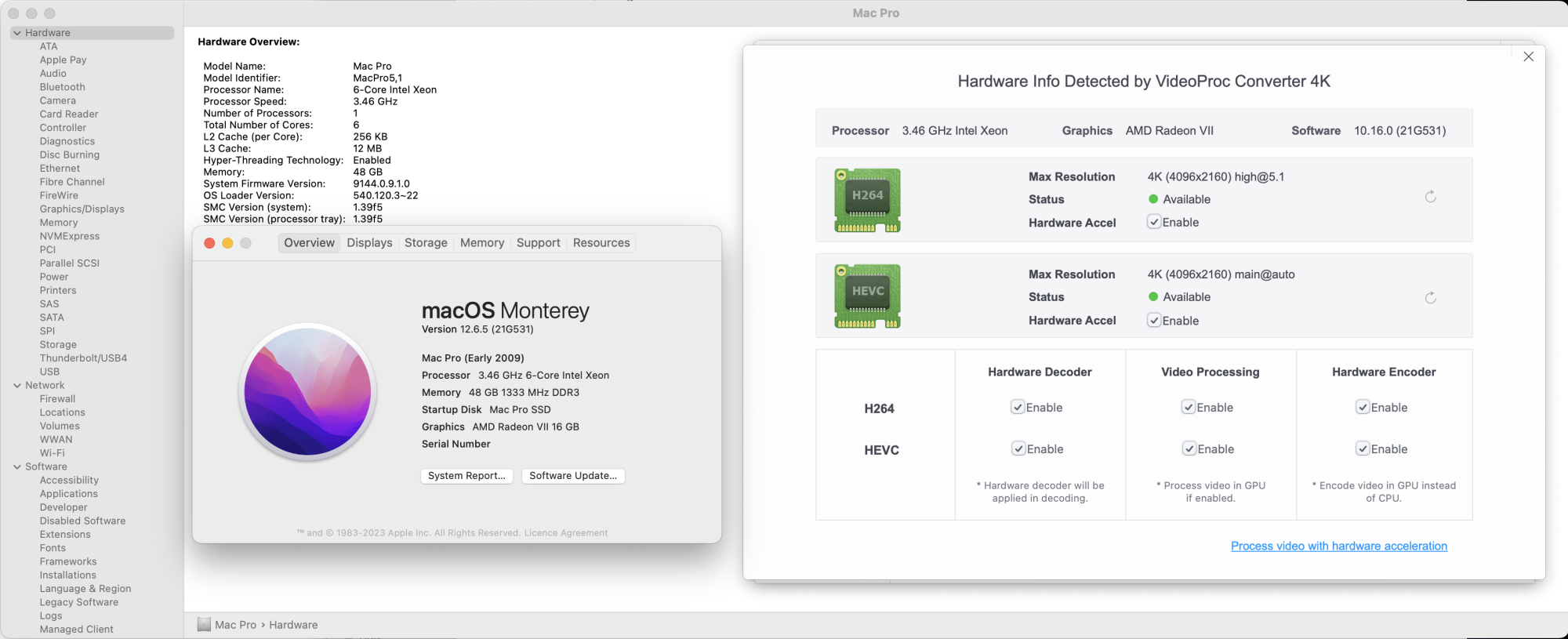

Monterey 12.6.5 update successfully (as usual, with VMM on, SMBIOS spoofing off). HWAccel still works as expected. It seems a very normal security update this time. Safe to apply.

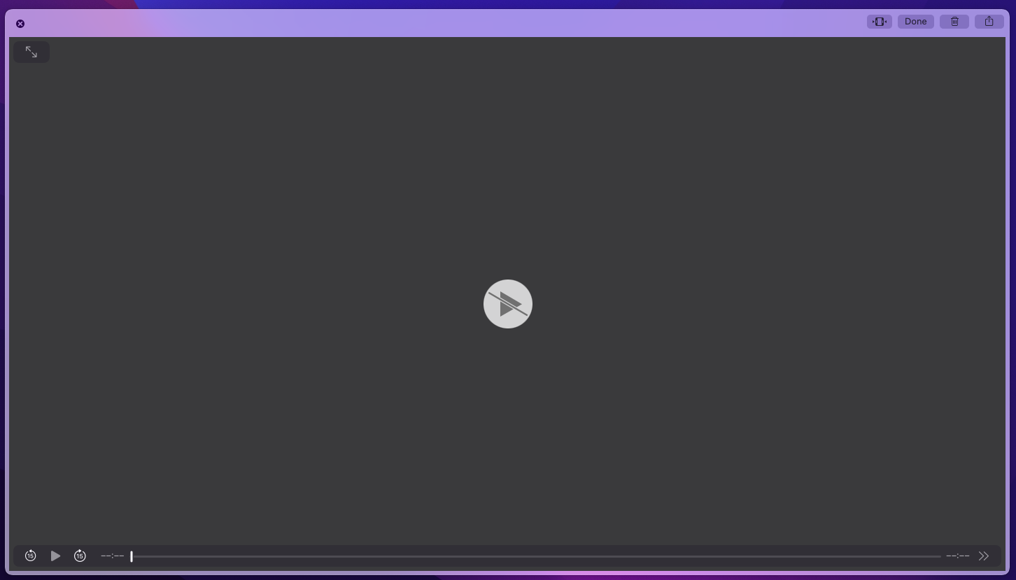

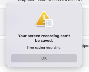

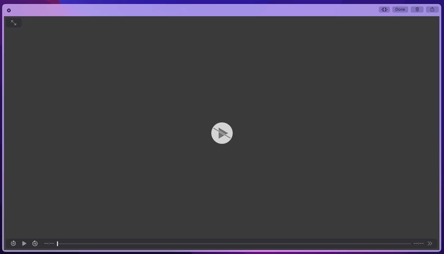

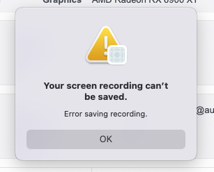

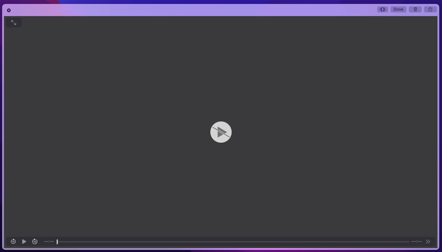

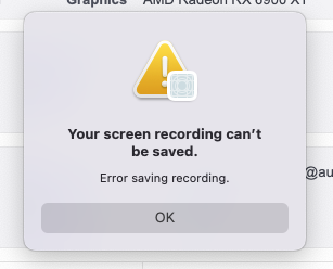

Greetings h9826790, I've burned myself out trying to resolve this, but it looks like you have success with the HW Acceleration on your macOS 12.6.5 install. I have a fully upgraded 4,1 to 5,1, 2010 cMP with dual processors (upgraded) max Ram and a AMD 6900XT (Pixlas mod) but cannot get HW Acceleration for H264 with his AMD card, but I do have it for HEVC. I've followed Syncretics patcher (much praise) and the 6900XT works, but of course, no boot picker, and much to my surprise, no H264 HWA. I'm okay with no boot picker for now, but would love to solve this H264 HWA problem. Doing basic video tasks like video screen records are impossible, or exports from Davinci Resolve can only be done via software rendering and not hardware rendering. My guess is that the problem is that my installation of 12.6.6 is born from the OCLP and not via your MLOC to install my macOS 12.6.6, and the two just can't cross pollinate. I've tried to use the HW Acceleration tools from #594 and from #1314, but no luck. To be frank, using the OCLP has been great, but even from earlier versions, I've never had the use of DRM, but did have H246 and HEVC HWA. I thought a new card would solve all of this. For workflow and a stronger workhorse, I was anxious to leave my old Nvidia Quadros behind, so yes, new card is great, but the one thing I need, I don't have, H264 HWA. Any history behind this problem or am I just doing this all wrong? I appreciate your guidance on this one, please. I'm at a loss and may have to reluctantly go back to the Quadros, just to get work done. Much thanks for the wisdom share! I'm a slow learner but I've learned a lot. Best ~ EMJAYWLZ
If your OS is patched, I suggest you unpatch it first.
Or you can simply enable VMM and disable SMBIOS spoofing (assume you are using my package now). Boot to recovery partition (via OpenCore, not natively. Your card should able to show GOP boot screen. If not, something is wrong), and re-install Monterey from there (just cover on top of the existing one, no need to format or delete anything). This will essentially unpatch Monterey.
If you really can't boot to recovery via OpenCore due to lack of boot screen. Simply boot to your existing Monterey desktop and run the 12.6.6 full installer also work.
Assuming the Monterey is unpatched, no extra unnecessary kext installed, and you are using my package. Then both H264 and HEVC HWAccel should work.
