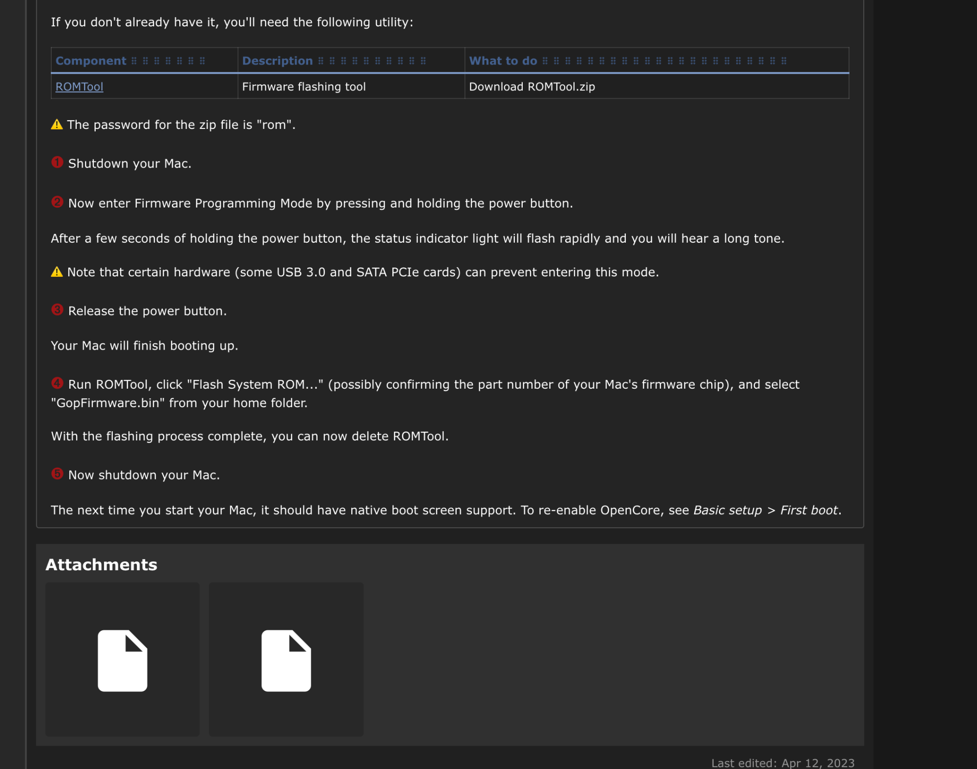

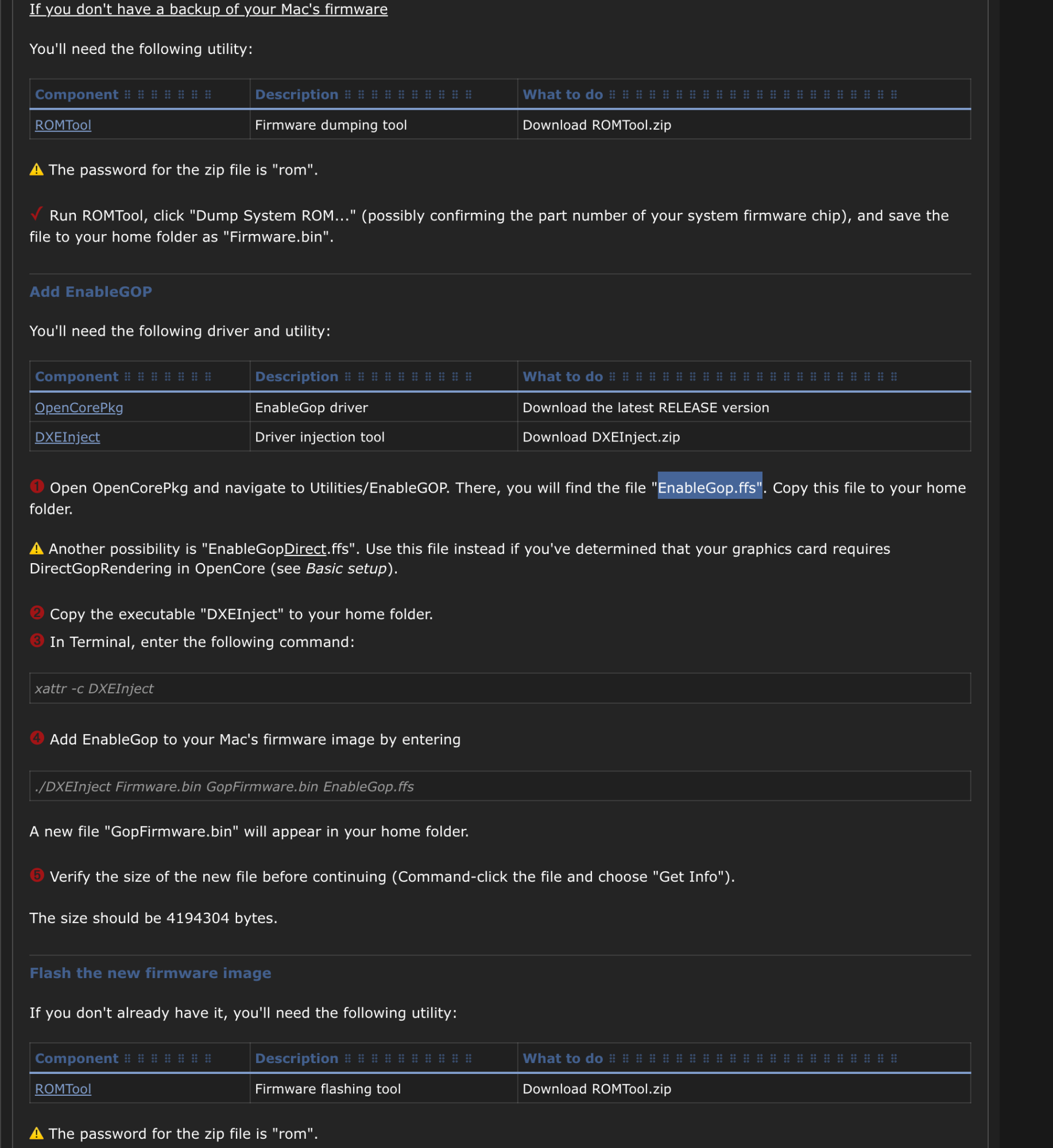

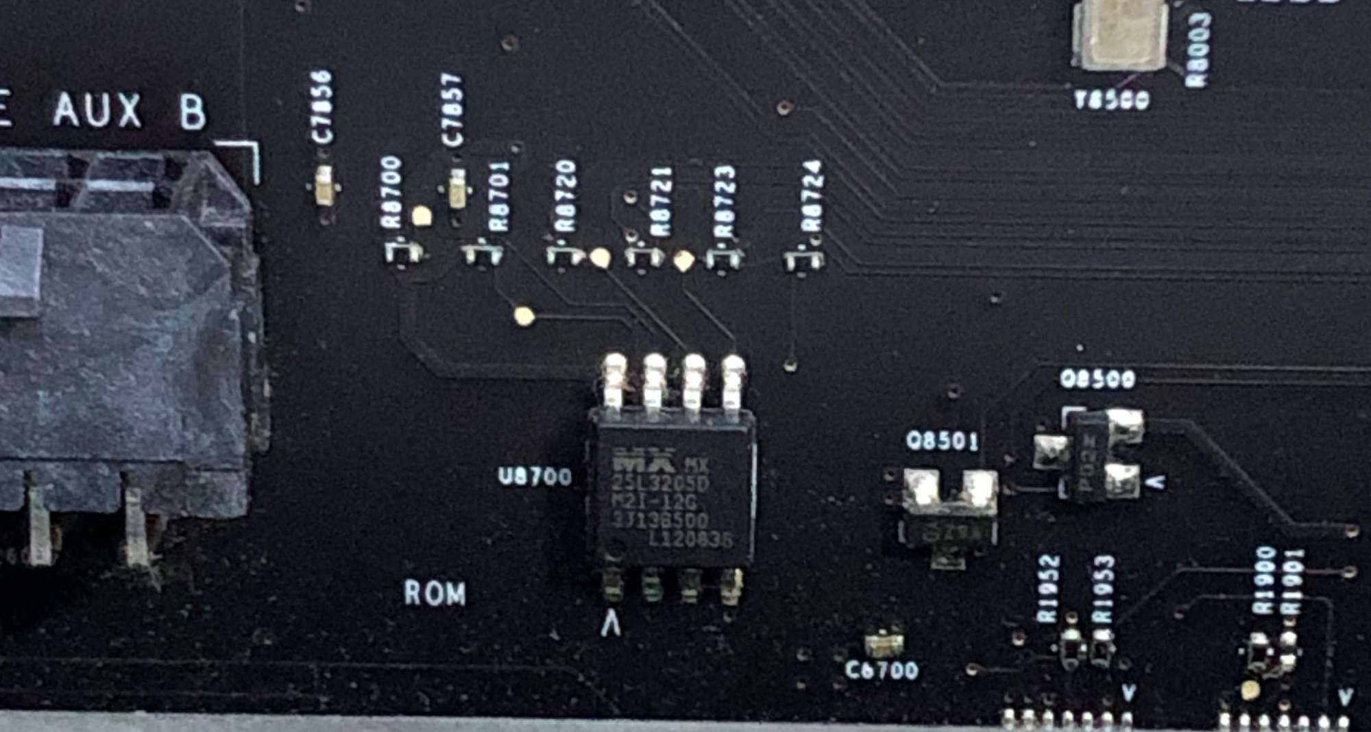

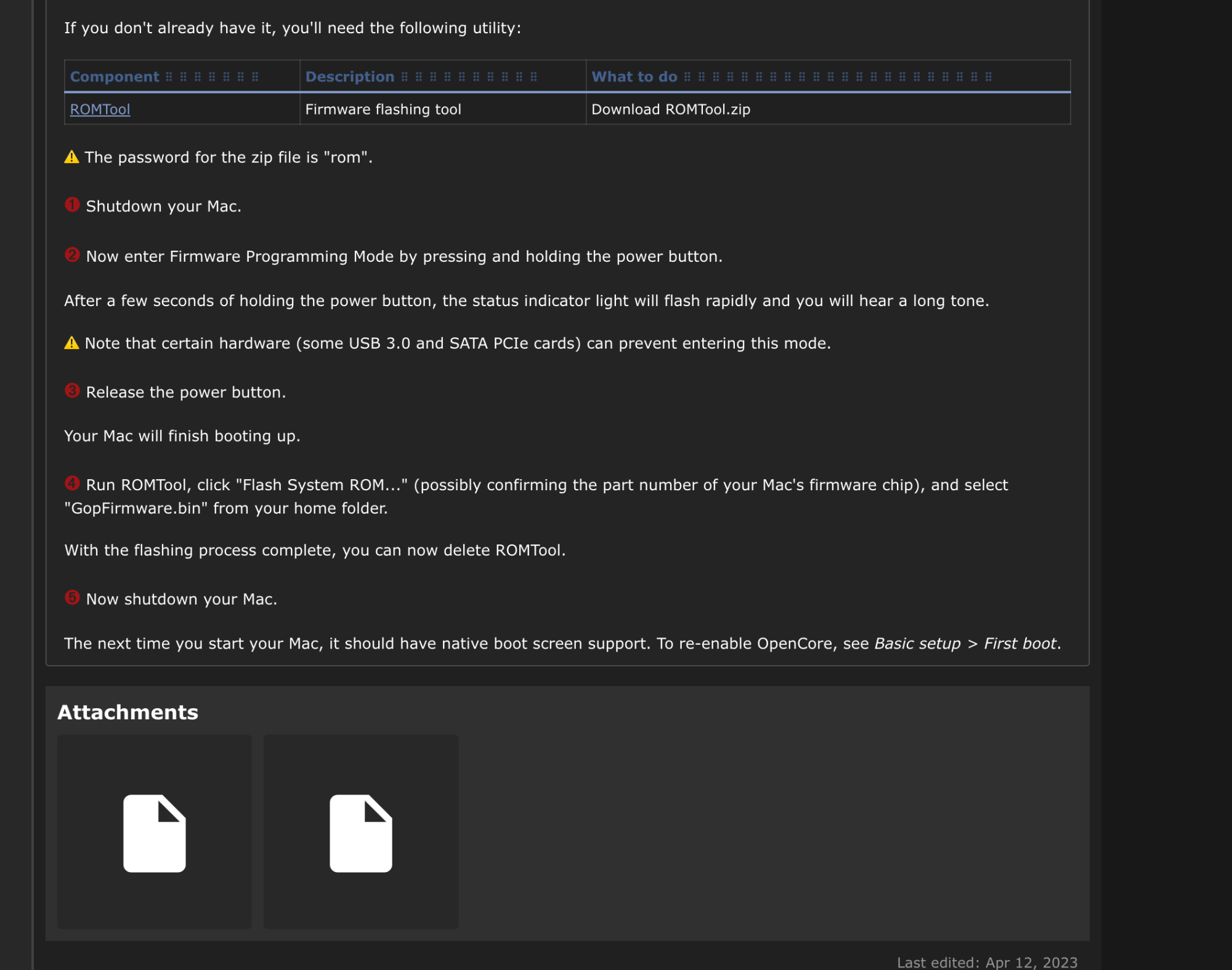

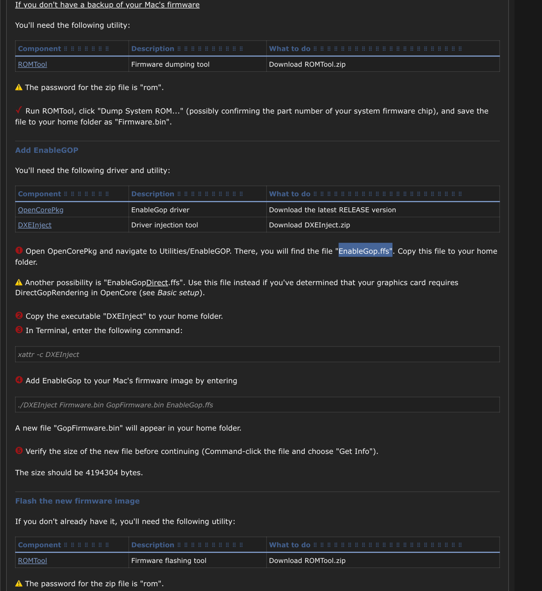

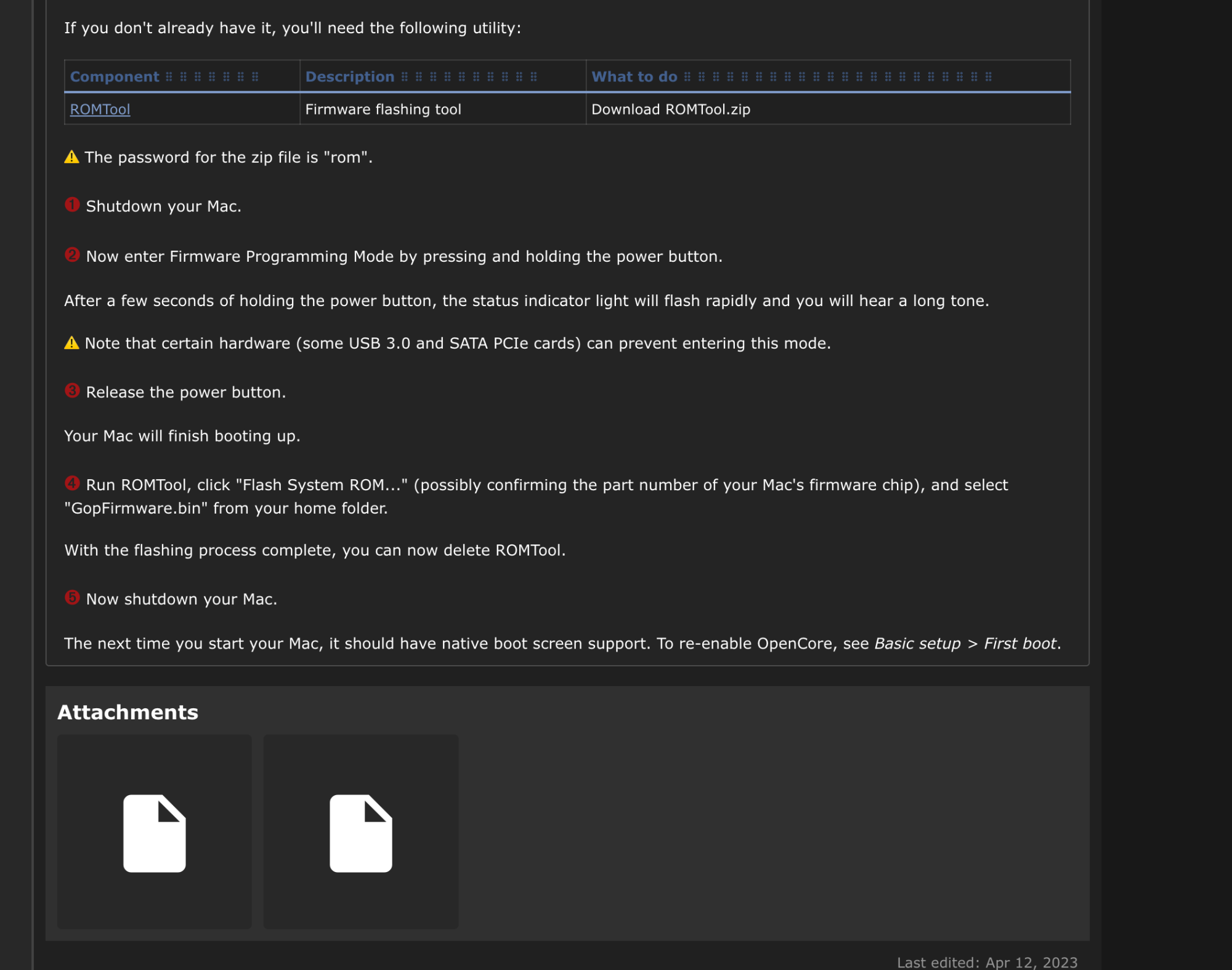

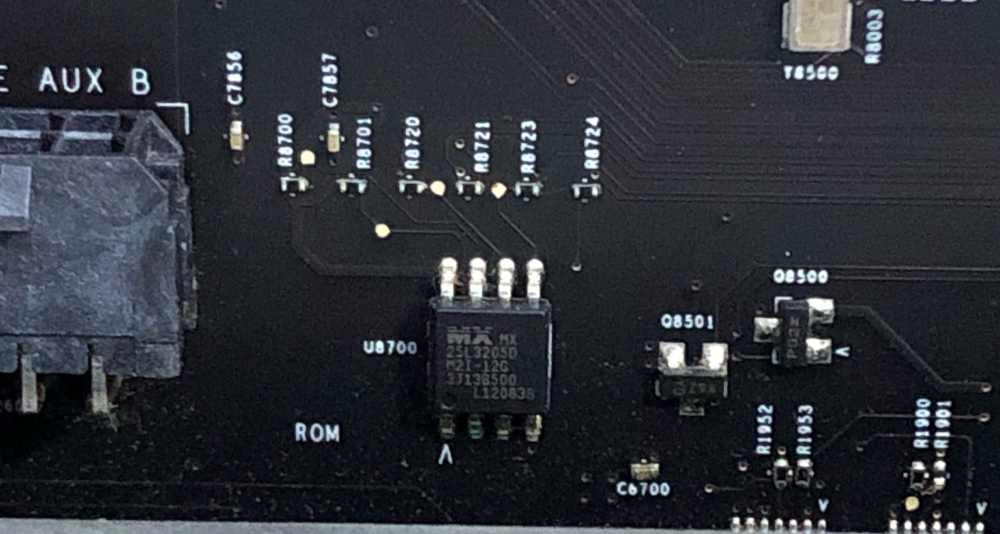

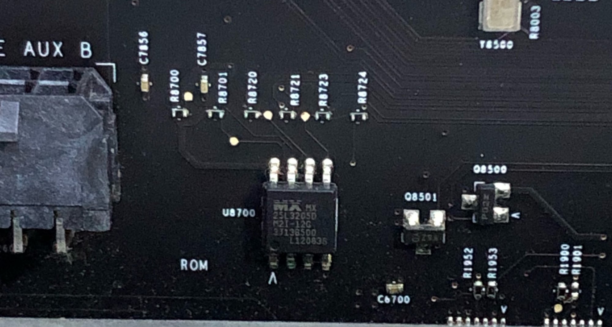

After getting the Rom Chips Number
I opened up the ROMTOOL and followed instructions via ( OpenCore on the Mac Pro | MacRumors Forums ) to ENABLEGOP. I followed these directions and booted in Flashmode and everything went ok.
This gave me the ability to boot from EFI for diagnostics and to open opencore from different drives.
oh did i miss something? The computer boots fine and now can boot from EFI partition thanks to your instructions for BOOTROM. Once i did that i was really able to see what was causing the Black screen, fans full blast when trying to perform Compute Geekbench test. Now i know even after fresh install on two different NVMe drives updated even with the new opencore that came out the other day or Marin Lo's EFI folders that the computer just freaks out when using NVMe drive. It runs well until a GPU intensive activity is performed.
Also when booting from USB EFI then to NVMe drive, same result. I hope i am making sense.
After getting the Rom Chips NumberView attachment 2197975

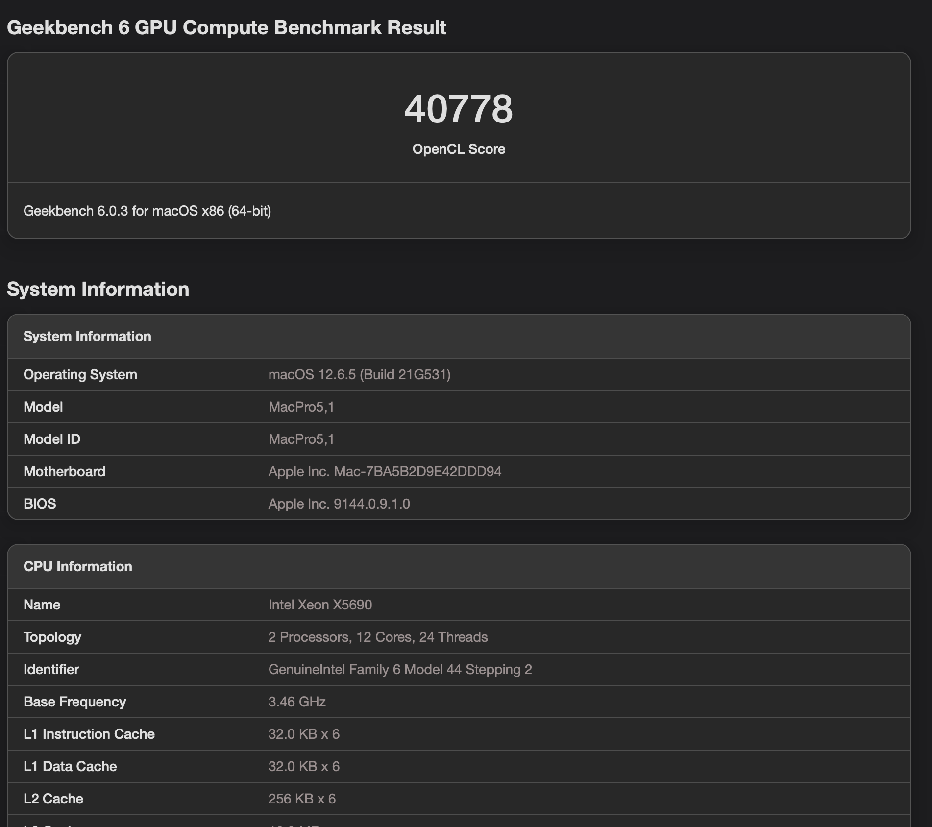

Hello everyone! Can somebody help me?
Why when I’m using windows my radeon VII is so much more in use and giving more fps (playing games) than when in Mac OS?
I also think the same is happening doing some other tasks as editing videos. Seems to me that Mac OS isn’t using all Radeon VII capabilities.
Obs: I noticed that at first minutes of gaming in macOS 12.6.5 I can rear the fans of my Radeon VII speeding (getting more performance), but soon after seems to return to idle. And when video editing in FCPX never noticed the fans speeding and I’m little disappointed with the performance in FCPX.
Actually im booting via Martin Lo's Package (the last update) but I also used the OCLP and experienced the same results
Here is my specs:
MAC PRO 5.1
MacOS 12.6.5
2x 3.46Ghz CPU
96GB RAM
1x Radeon VII
SSD Nvme 1Tb Wd Green
There is any changes I can make to optimize my GPU usage in MacOS?
Is macOS 12.6.5 capable of use the full potencial of my Radeon VII?
Should I install an earlier version of Monterey?
I also have installed Mac OS Mojave in other SATA drive.
When I run the geekbench 5 got 93k in GPU score (60k in Monterey 12.6.5).
And running Engine Heaven Benchmark I have similar output results in Mojave and Monterey (FPS~85, SCORE~2150), BUT visually in Mojave is very much smooth while in Monterey 12.6.5 I can see lots of frame dropping (as if it was giving me less than 24fps).
I wouldn’t have any problems to use Mojave if I was capable of install the last version of FCPX, Apple Compressor, my plugins and the Adobe CC apps. But unfortunately seems not possible.
There are any configuration that could solve this problems?

You mixed a few different things in a single post, even all of them a GPU related.
1) For gaming, it use the 3D engine. For video editing, it mainly use the compute engine. When export when HWAccel, it use the media engine.
Even all these are on the same graphic card, but they are different parts, and doing different tasks.
2) For gaming, apart from the hardware, the API play a very important role as well. In Windows, DirectX is has much higher efficiency. Therefore, the same GPU can perform better in Windows gaming. There is nothing we can do in MacOS. Metal improves the situation a bit, but still not yet at the level of DirectX.
So for gaming, whenever there is a Windows version, and you can boot to Windows. My recommendation is to play in Windows.
3) In FCP, it shouldn’t constantly stress the GPU to max. Of course, that depends on your workflow. But in general, when you adding effect to the timeline etc. the GPU only need to work intermittently. When you playing the timeline, not every single frame is so demanding. So, the GPU’s fan most likely no need to stay at high RPM.
4) My package has RadeonBoost to allow Mojave use full bandwidth of the HBM2. That’s why you see a much higher GB5 score in Mojave. In fact, we can do the same thing in Monterey by injecting the required parameters in the OpenCore config.
However, I doubt if this will significantly improve your FCP performance. This mod should mainly (if not only) remove the artificial VRAM bandwidth lock from Apple.

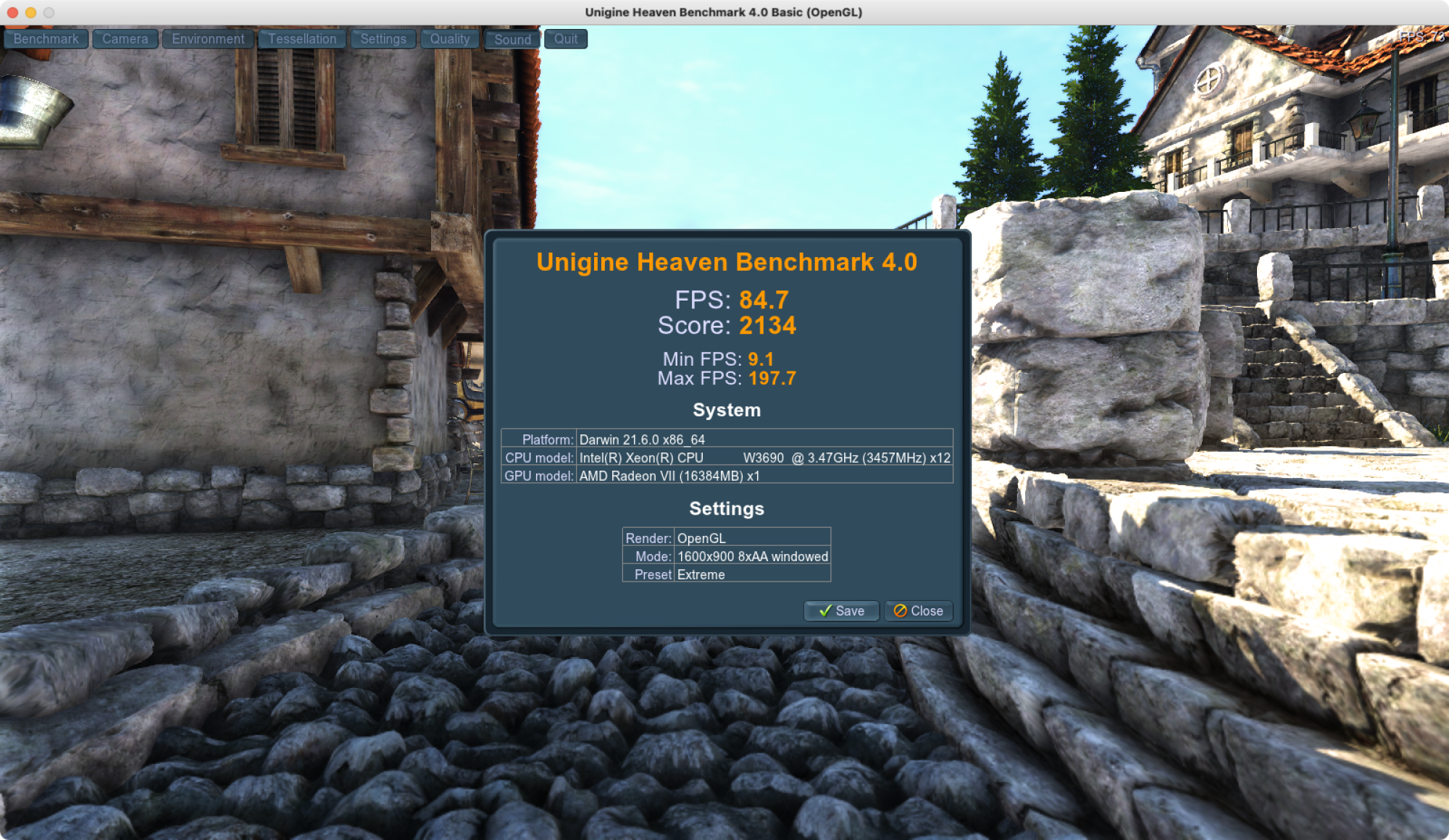

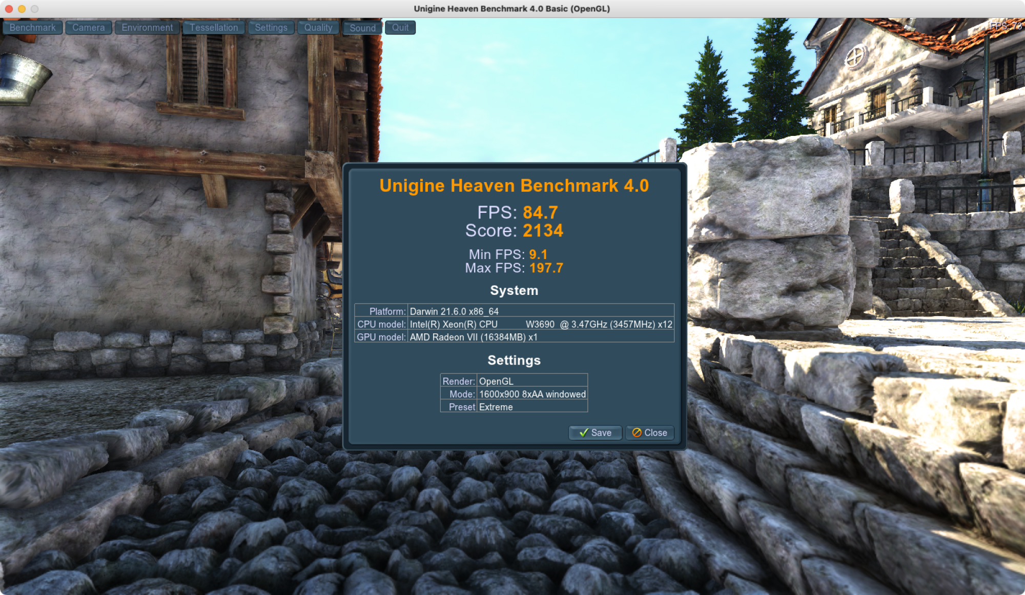

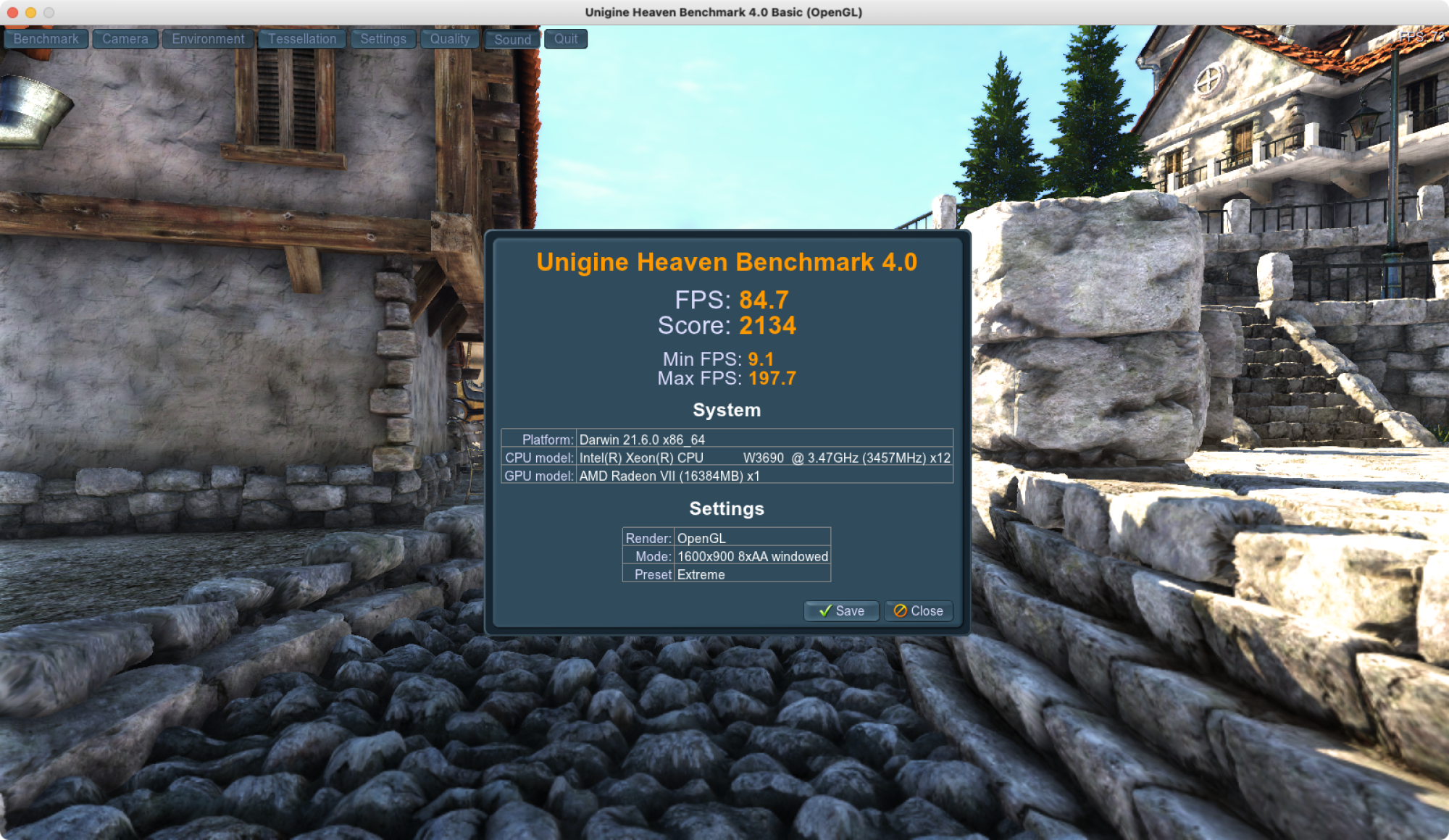

5) I just make a test run of Heaven Benchmark in 12.6.5 with my Radeon VII. I think I know what you mean, at scene 15, I can clearly see the motion like 24FPS dispite it was above 60FPS. I suspect that's because the depreciated OpenGL support in Monterey. Anyway, here is the result from my Radeon VII (downvolted to 1645MHz @901mV) in 12.6.5
I think as long as you has simular figures, then nothing to worry about.
Side topic a bit, this downvolt thing allow my Radeon VII to perform more or less the same as the factory settings, but draw 20% less power. This helps the card to stay quiet and cool.
