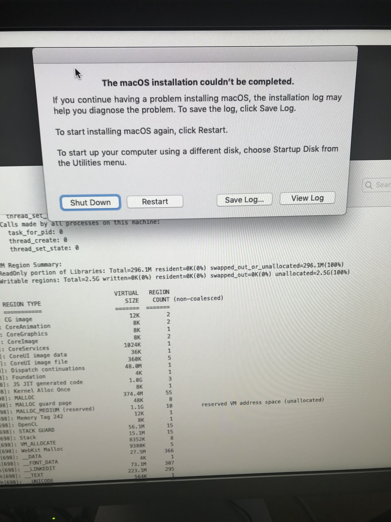

I tried to install Mojave from high sierra , after selecting Mojave SSD for installation then restart, opencore boot selector came , I selected macOS installer from it. After that was apple logo and progress bar for 10 seconds then black screen for 30 minutes , I tried to restart and do the same process even load mojave installer from bootable flash drive that I’ve created before , but no difference, black screen after apple logo with progress bar,
I didn’t have this problem when I Installed catalina from High sierra.
Is it possible that opencore doesn’t allow installation of os older than Catalina?
I waited even 45 minutes then Installation log error came
I clicked restart to start installing macOS again but same happened.

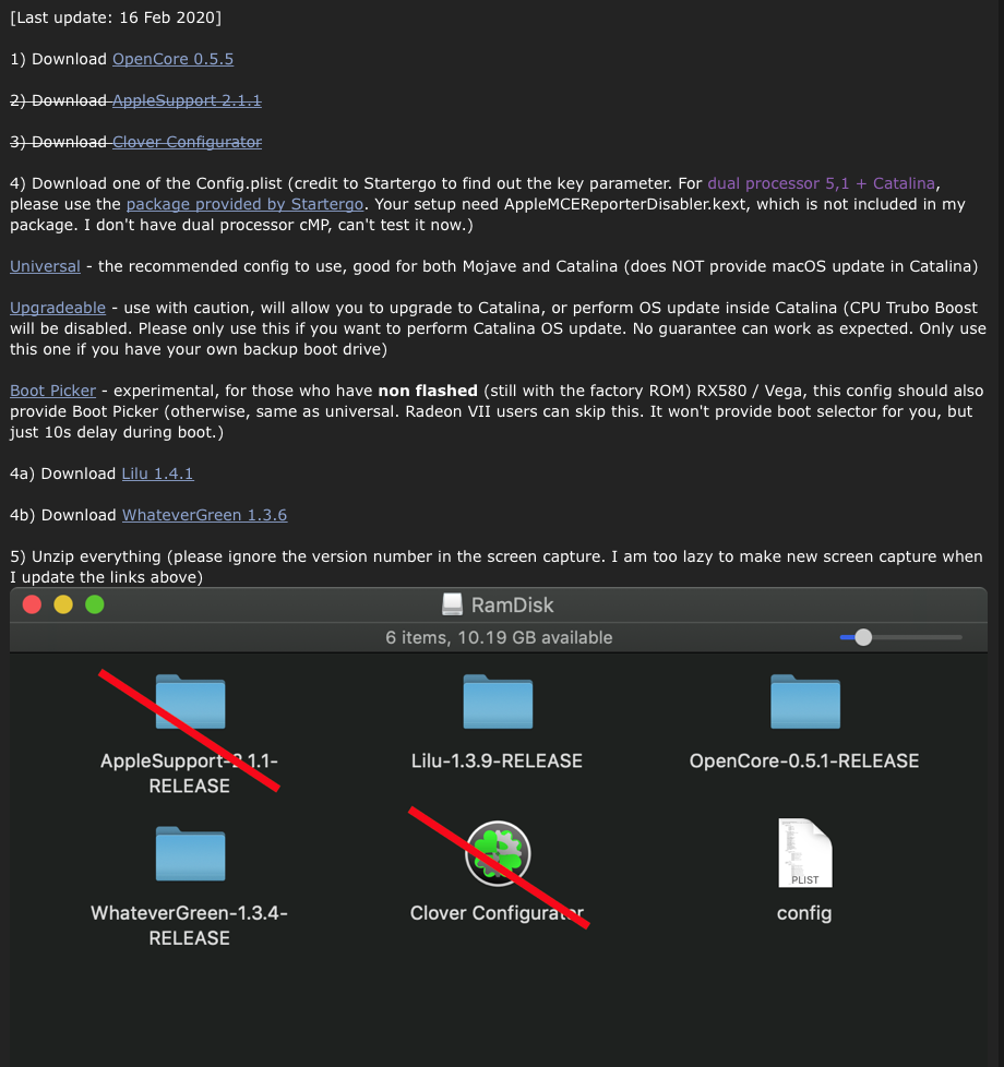

My OC package should allow Mojave installation. But if encounter error, you may remove OC first. You don’t need it to boot High Sierra, and Mojave anyway.
Then re-install OC after Mojave installation completed.
Or you may try some older package. e.g. 0.7 etc and see if that make any difference.

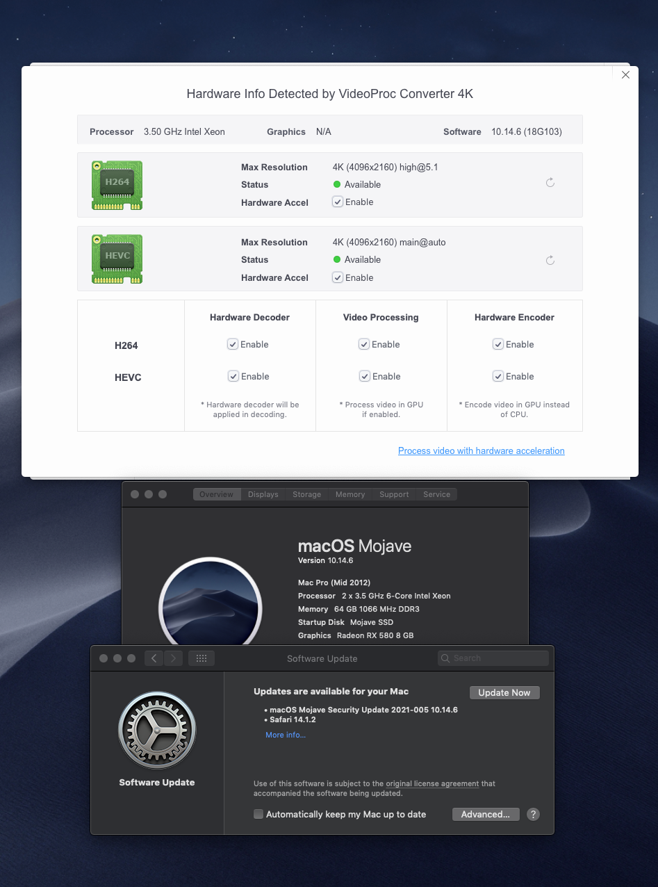

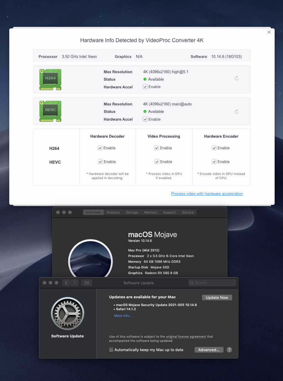

I finally did it with removing all drives then clean install Mojave then I used your older method with Opencore 0.5.5 you‘ve just posted in 16 Feb 2020 in post #594
now I have everything working ; simple Boot Selector
( not a fancy one like opencore 0.9.0 ) but it works and fully functional HW acceleration H264 and HVEC
thanks to you 🙏🙏🙏
I like this one better because it gives me Mojave Updates not Catalina which I don’t need and I can’t use because it lacks 32bit support that I need for my sound card and midi keyboard to work
finally I have a question is it safe to install macOS security updated or other updates that come in software update window ? Or I should Avoid it
I will post more results when I installed Premier pro , … and other video related software

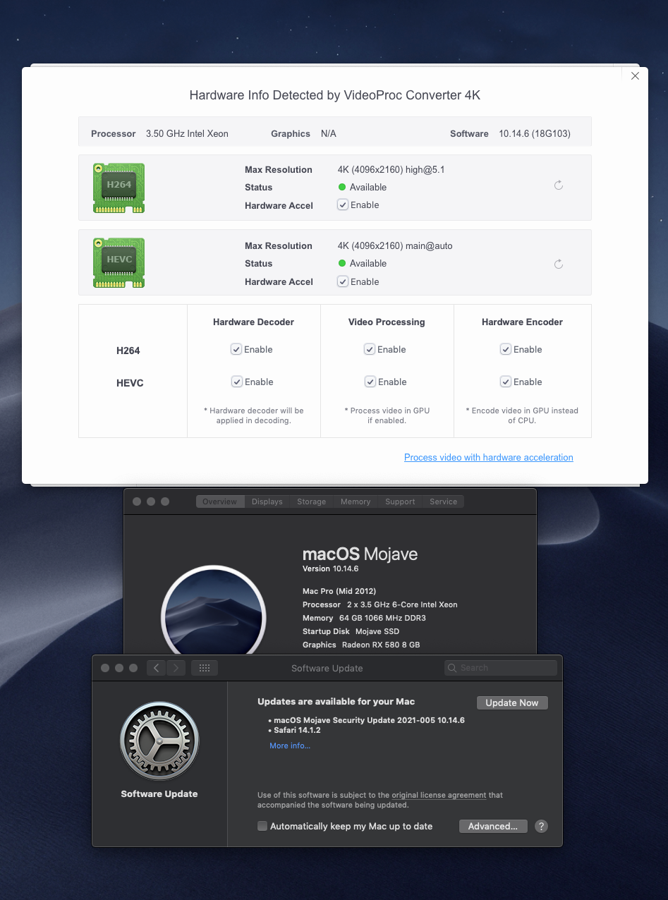

thanks to you 🙏🙏🙏
There is no more security update for Mojave, no need to worry about that.
And this lastest one is safe to apply.

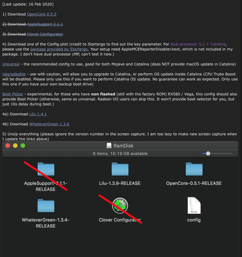

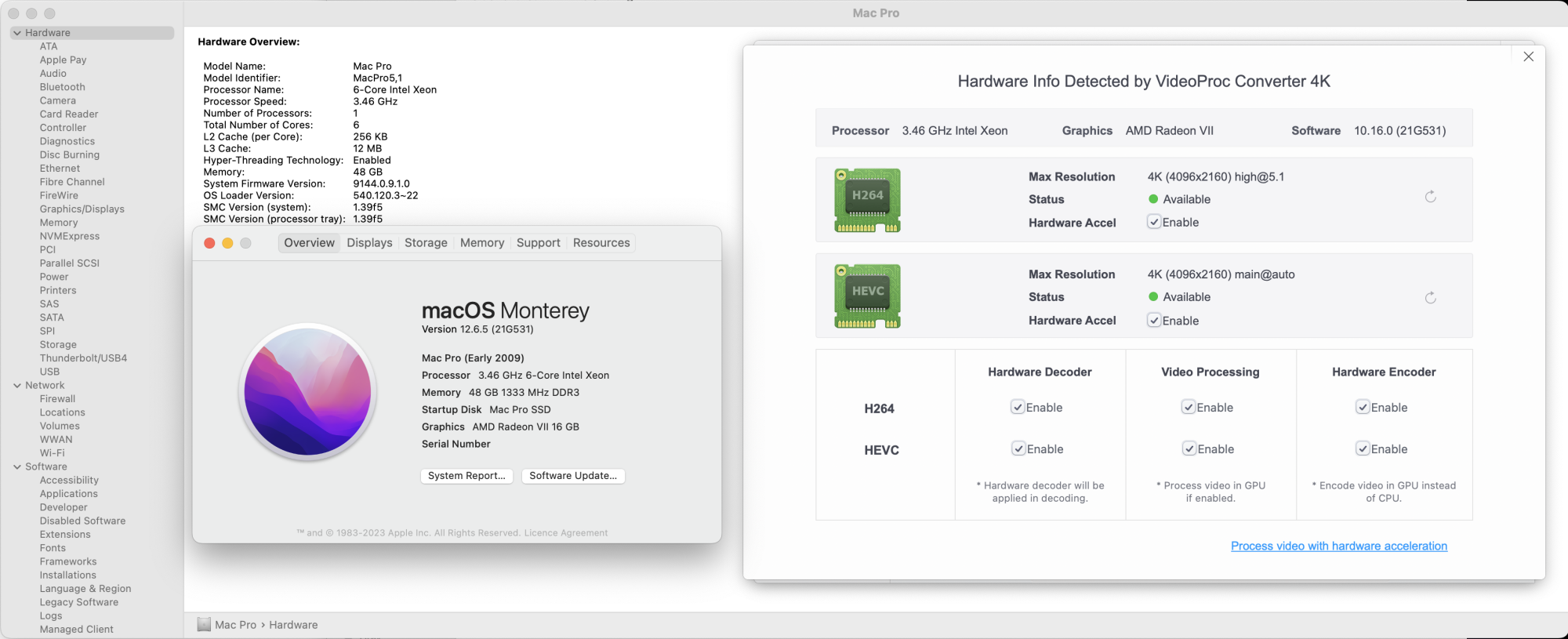

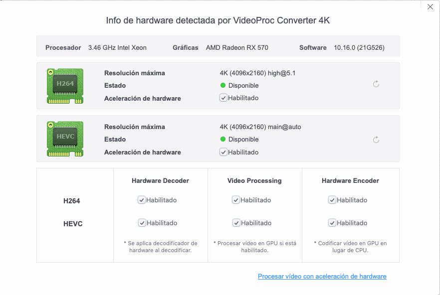

Monterey 12.6.5 atualizado com sucesso (como de costume, com VMM ativado, falsificação de SMBIOS desativado). HWAccel ainda funciona como esperado. Parece uma atualização de segurança muito normal desta vez. Seguro para aplicar.
I also managed to install Monterey and it has graphics acceleration working 100%. But my bluetooth nor Wifi is working.
