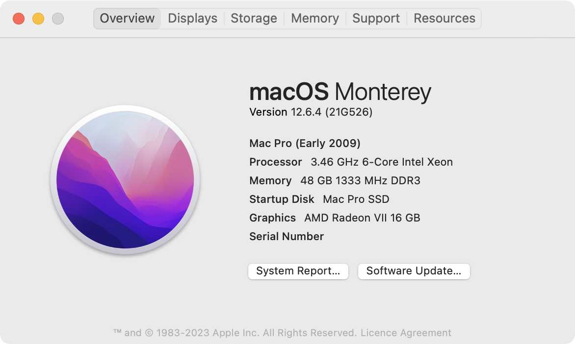

I'm on a Mac pro 4,1>5,1, with radeon VII on Mojave.
Currently trying to move up to Monterey or even just Catalina using Martin Lo's OpenCore 0.8.9 package.
I followed the video with the edits made in the code and downloaded Monterey from the app store, went to install and it told me i didn't have the correct firmware.
I can't figure out why and for some reason i can't download Catalina from the Appstore
any idea?
Thanks
There are two parameters need to be changed.
1) enable VMM by changing that A to C
2) disable SMBIOS spoofing by changing the true to false
It seems you only did 1 but not 2.

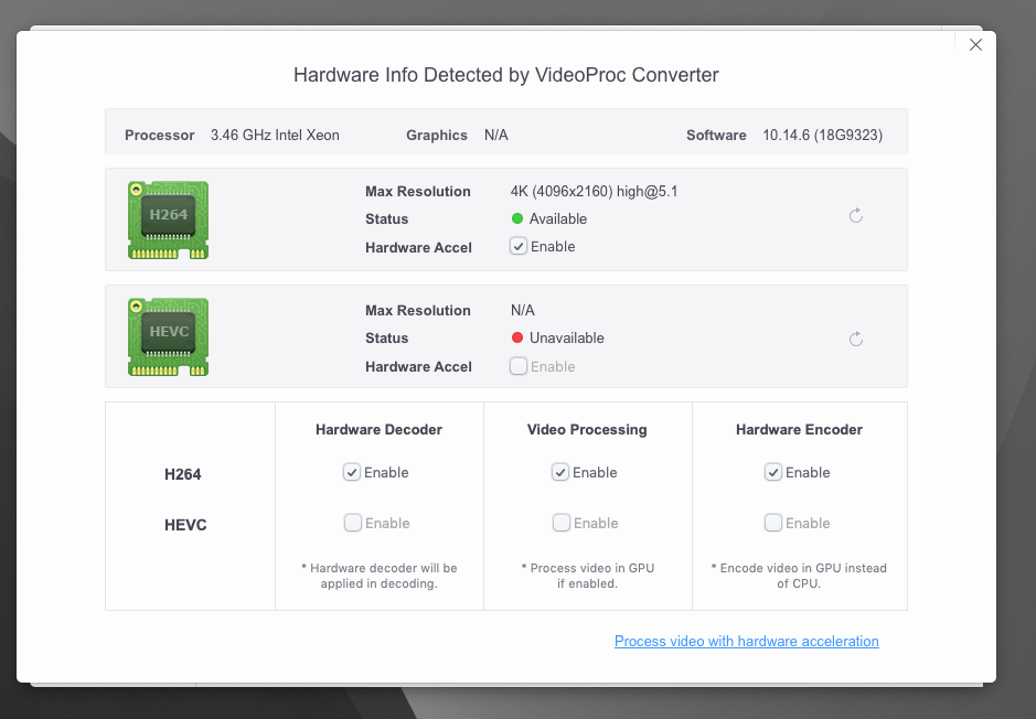

I have recently conducted a transcode process on a 300 seconds-long 4K H264 video file, and the output was successfully converted to High-Efficiency Video Codec (HEVC) without any noticeable rendering delays or system degradation issues. Although I did not encounter any rendering lags during the transcoding process, I do unfortunately experience major performance degradation when utilizing resource-intensive software such as Final Cut Pro X, Adobe Premiere, or Topaz AI Enhancer during the rendering process. I guess it's just me.
Thanks for the test and report. So, we now know your issue is not directly HWAccel related, but something else.
The first suspect would be some updated kext inside in the new package.

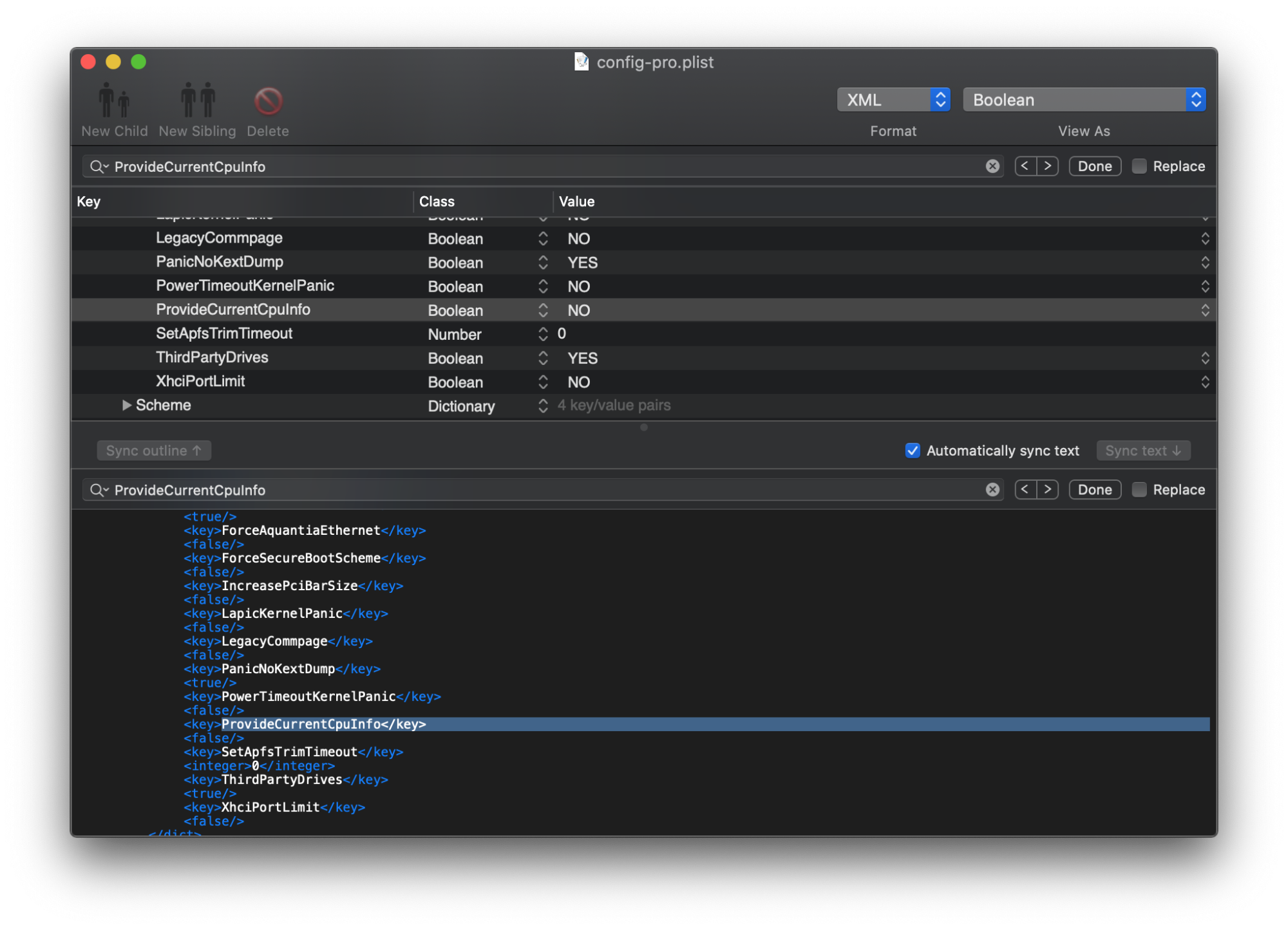

@h9826790 in the 0.9.0 config file the lines 658, 659 repeat the exact same <key>ProvideCurrentCpuInfo</key> from the two lines before.
Stumbled over this while comparing my currently installed 0.8.8 to your latest 0.9.0 config.plist to copy over some adjustments from my running configuration before updating.
Is this an intended hack or something that can be cleaned out while I'm on it without breaking anything?

Thanks for the report, will fix that on the next release. Interesting that ocvalidat tool doesn't count this an error.
Also interesting is that PlistEdit Pro app that I always use, automatically fixes the duplication error :
I've been using this App for a long time and never had issues with bad formatting. It takes care of all formatting has always produced valid plist files and so so easy to use. The App focuses the user on the content and not worry about formatting (like <true/>, ,key>, </dict>, etc, etc) as all that is done for you.
All I did was open you config.plist file in PlistEdit Pr App, simply saved it as config-pro.plist and re-opened in BBEdit App and the duplication was gone.

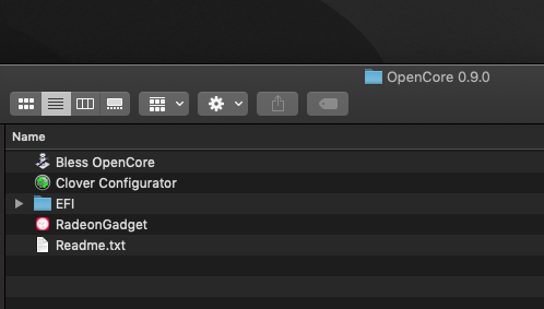

I created a new "easy to install package" as per many requested (based on the official OpenCore). [The attached package updated to 0.9.0]
For those who only need HWAccel, post #594 has everything you need. This new package mainly offer HWAccel + boot screen. Also, this package should work in Catalina and newer macOS for dual processor cMP.
I don't mind you guys discuss anything about this package, but I have no plan to provide any explanation about OpenCore at here. If you want to know more, please join cdf's OpenCore thread. For new joiners, please make sure read through the FAQ in post #1 before you ask anything.
The attached packaged included Clover Configurator (for mounting the EFI partition only, please do NOT use it to edit the OpenCore config) and a complete preconfigured OpenCore. All credits goes to the developer teams. If you want to show your support, please give them donation (declaration of interest: I am NOT in any of their developer teams)
For Clover Configurator and OpenCore developers teams, please let me know if you want me to remove the associated software inside my attachment in this post.
This is a "one package fit all" solution. So, it's designed to fit as much setup as possible, which may not be optimized for your setup (e.g. I haven't provide HiDPI boot screen, for those who are running 4K screen, the Apple logo may be quite small during boot). You have to do the optimization by yourself (details in the OpenCore manual, some info also available in cdf's OpenCore thread).
Anyway, for those who have RX 460 or newer AMD GPU, this package should gives you:

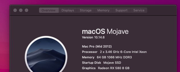

It had no affect on my Adobe Premiere H264 Export. A 10min export of 1080p video was still taking the same amount of time as before. Using Vega 56 card. There no encoder acceleration.
Specs:
OS Mojave 10.14.6
Mac Pro 2010 (5'1) -
2 x 2.66 GHz 6-Core Intel Xeon
96 GB 1333 MHz DDR3
NVME boot 2TB and NMVE footage drive 2TB -
Boot Rom 144.0
Specs:
OS Mojave 10.14.6
96 GB 1333 MHz DDR3
Boot Rom 144.0

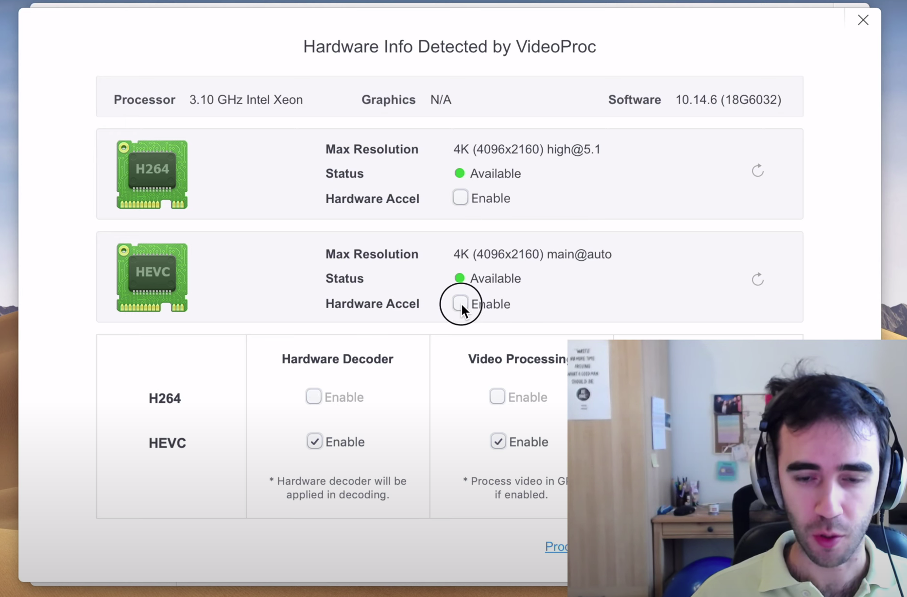

Did you check if H264 / HEVC HWAccel is correctly activated?
It seems you use the depreciated kext method, but not by installing OpenCore. Am I correct?

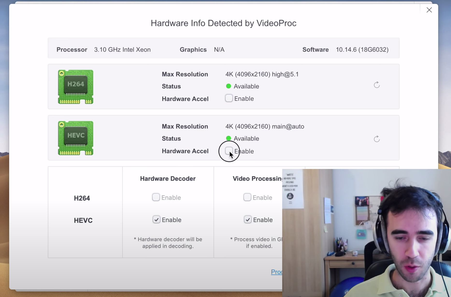

Hey guys just a quick question, I'm running the 0.8.6. oc package on my 4,1->5,1 running monterey no problem with the wifi bluetooth upgrade, the only issue i have it that if i go the the about this mac section the serial number says unavailable anyone know why?
@Macschrauber was 100% right the board did not have a serial number. I used the Blank Board Serializer and flashed the serial number that was on the sticker on the back of my Mac Pro and now it shows up correctly

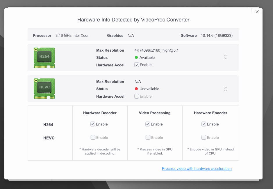

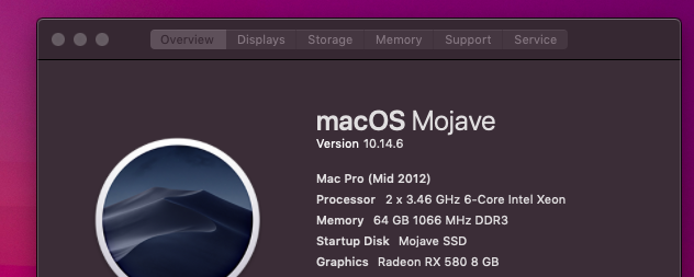

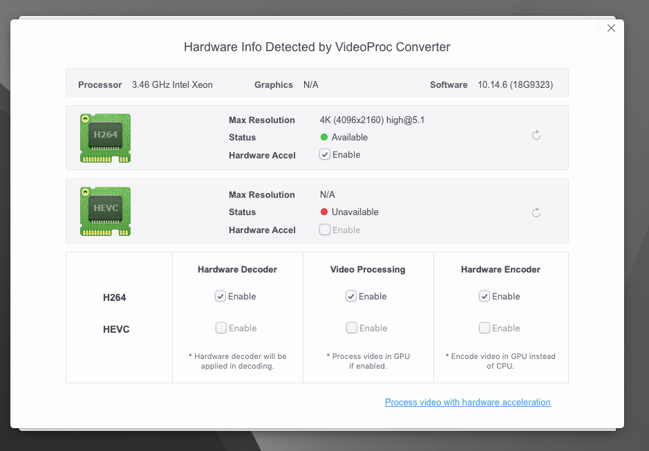

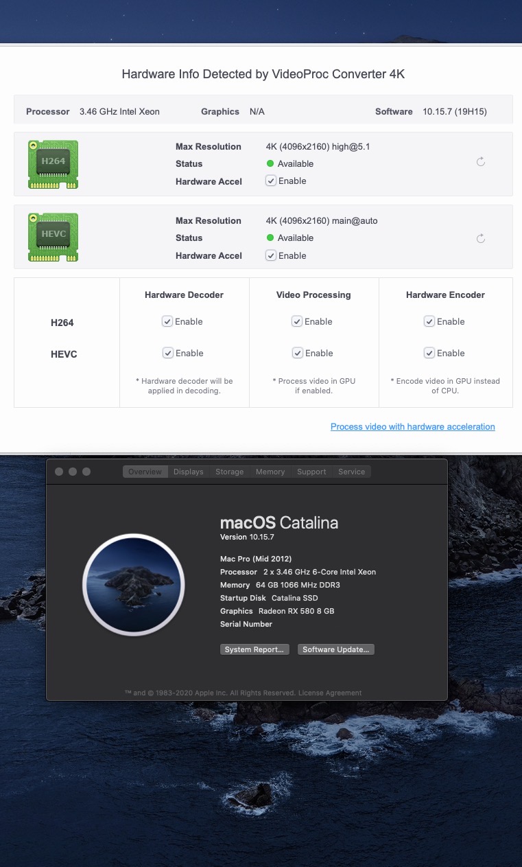

Hi guys I just finished Installing Opencore on my cMP 5,1. I have boot screen Menu, everything works fine but I have just H264 HW/A no HEVC , I saw systems like my mac pro even lower that they could activate HEVC
it should be like this
what should I do to get this?

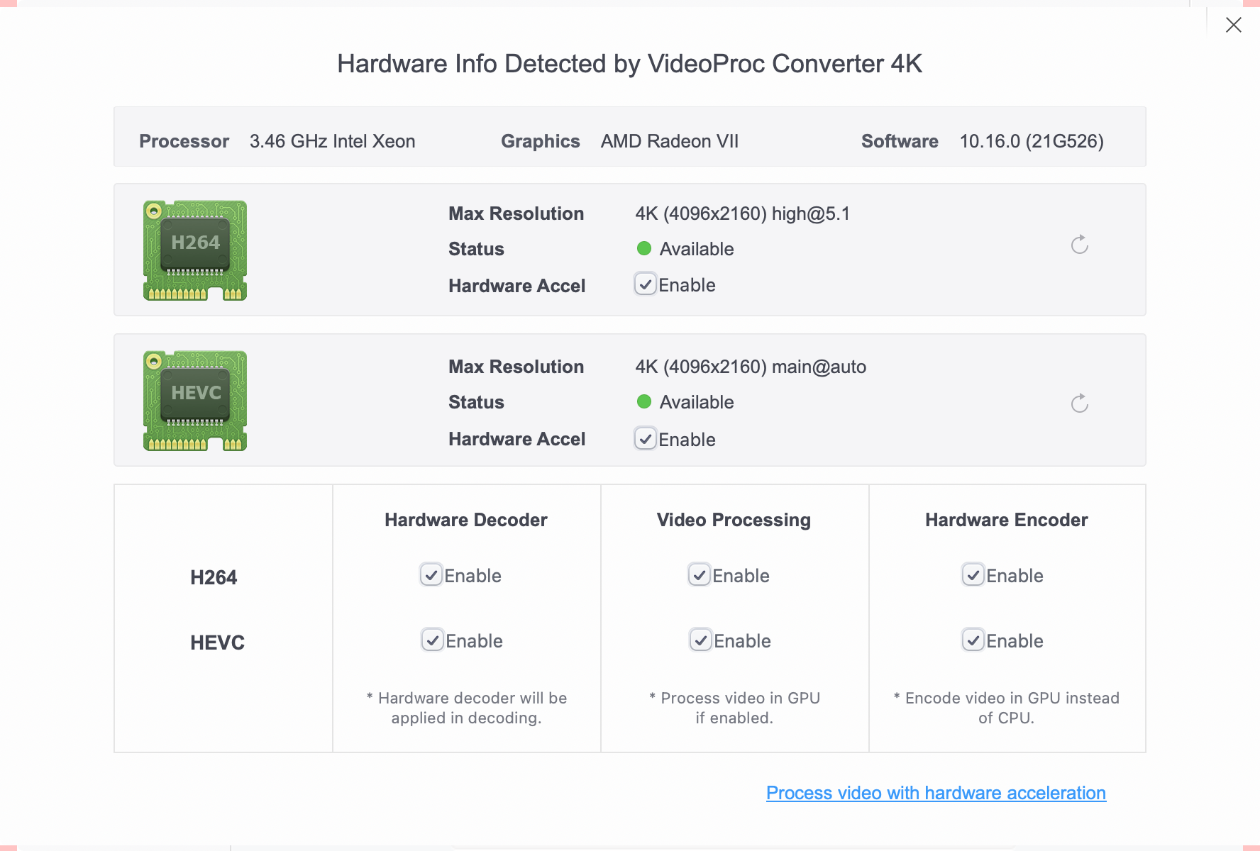

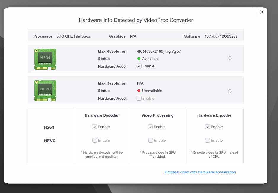

Did you try the little circular arrow on the right hand side to refresh the HWAccel status?
yes for both of them but in HEVC there is no action, and I used this version of open core :
ohh my god , after booting to my second drive which is high sierra and go back I double check if it is active! It became active, then when I double refresh the circle it became inactive again!!
You haven't mod anything in the OpenCore config plist, and never patch any system files, install extra GPU related kext etc?
No I just 3xNVRAM reset then disable sip - copy efi from open core to efi/efi then bless it , then restart , everything is fine except HEVC
The package in post #1314 should take care all required spoofing and kext injection.
Of course, you can still follow the discussions in older post to enable HWAccel.

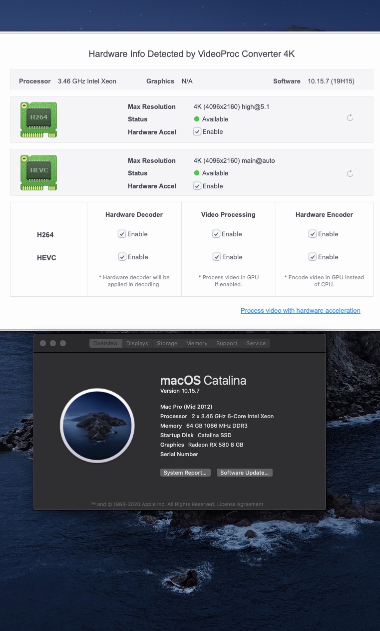

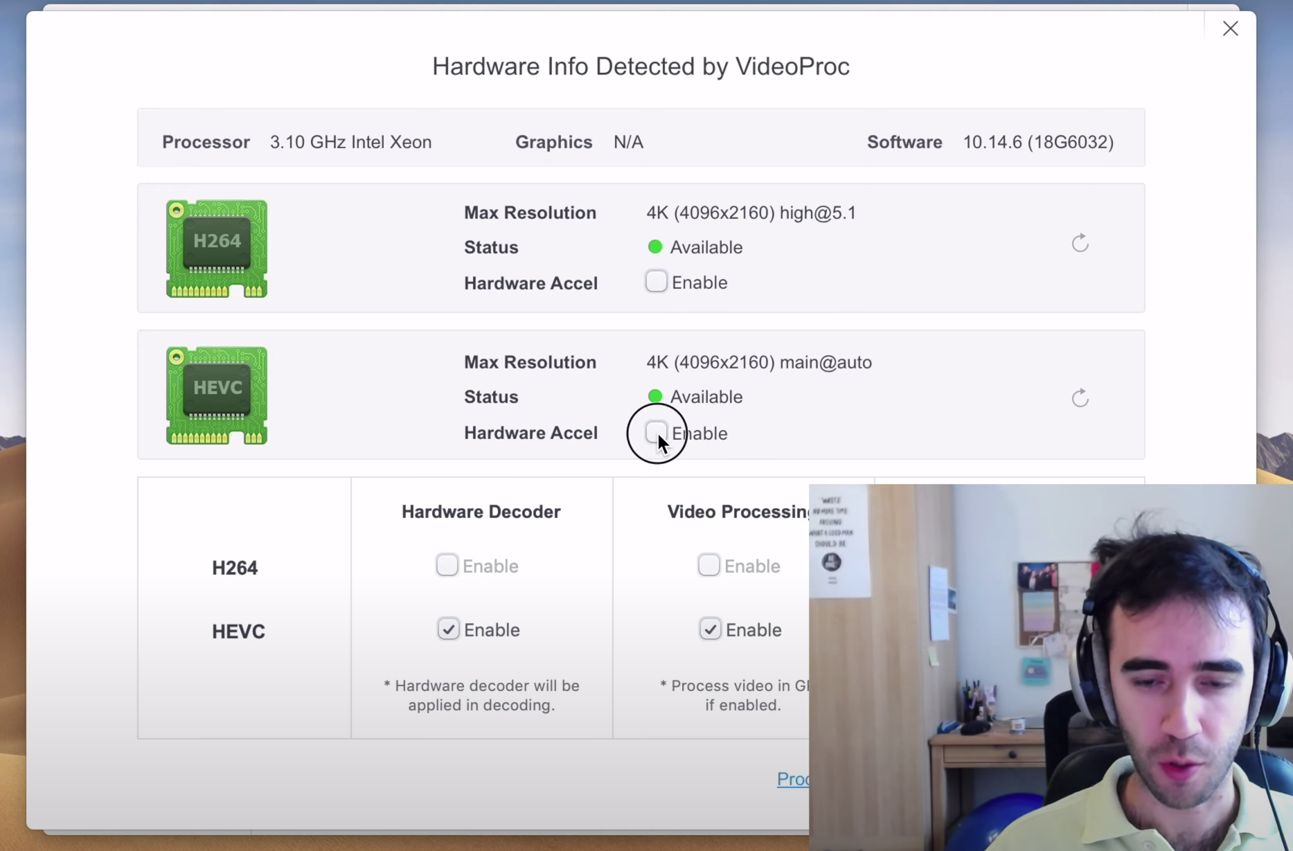

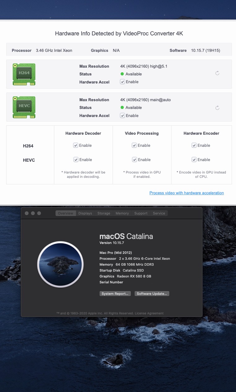

thanks again I Installed Catalina in "Opencored Mojave" (that didn't gave me HEVC support).
finally I have everything working without even re-installing Opencore in Catalina , but I need it (HEVC) to work on Mojave because my Avid Mbox Pro Sound card and M-Audio midi keyboard don't have 64bit drivers so I have to work in Mojave. Could you please help a musician here and figure out a way to make HEVC work in Mojave?

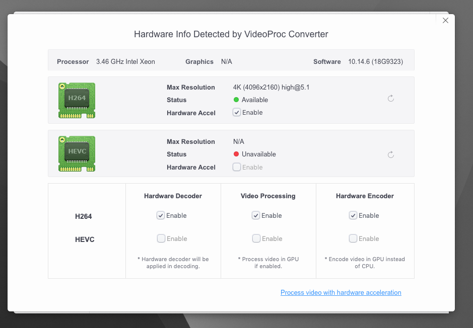

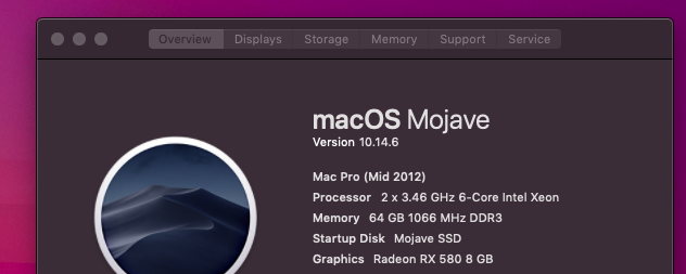

I want to start my youtube music channel. so I'll be doing a lot of encoding/decoding.
maybe I need to Change something in config.plist to be able to have HEVC in Mojave
regards
but in Mojave Still :
regards
I suggest you try re-installing Mojave first (just cover on top of your existing Mojave, no need to remove any user data). This can effectively unpatch / recover all system kexts (if any).
Your Catalina test suggest you did the correct steps and the OC package is functioning correctly.
So, if doen't work in Mojave, most likely due to Mojave itself has issue.
If still doesn't work, then the next test will be get a spare drive to install a clean Mojave. And see if you can get full HWAccel in that clean Mojave.
