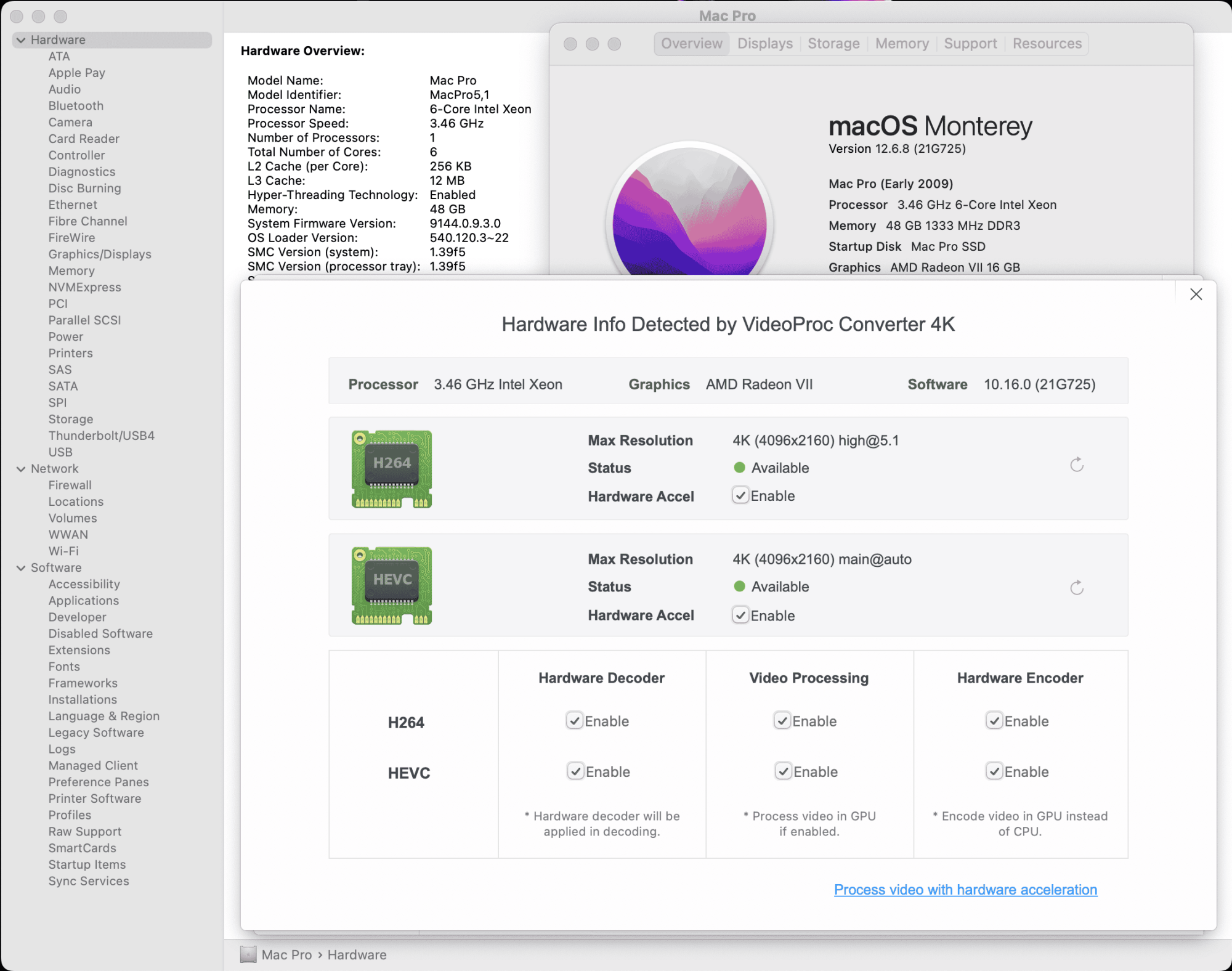

FYI no issues updating from 12.6.6 to 12.6.7 using standard software update and procedure outlined in post #1314.

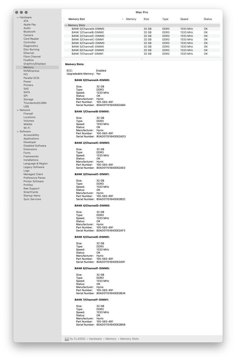

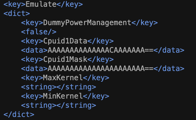

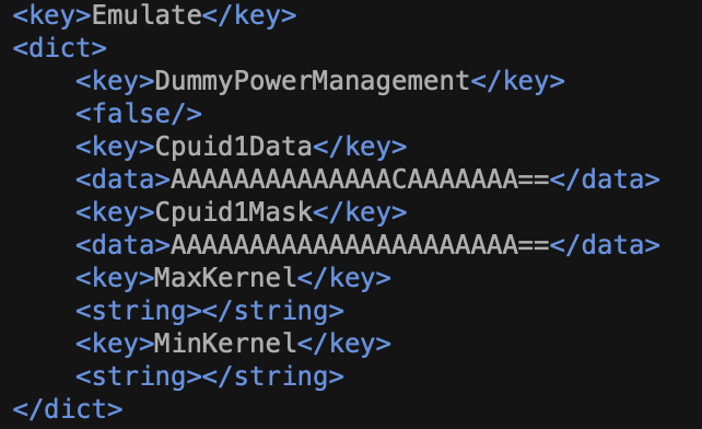

Possible to run 8x32GB RAM in macOS (user need to mod the config.plist manually. Replace the false below CustomMemory to true)
Two questions to this:
1. Is this sufficient to get the 32GB-sticks to work right now or are there still exact specs (size, speed) to be entered in addition?
2. Does this any harm to systems where no "custom memory" (32 gig sticks) is installed? Any reasons not to keep it set to "true" by default?
Thanks in advance for enlighting me! 🙂
1) Only some 32GB DIMM can work, not all. So far, it seems only the 4Rx4 RDIMM can work. Speed shouldn't be a problem. The cMP should auto select the highest possible clock speed to run them anyway.
2) There should be no harm to do so. In fact, that memory spoofing is quit cosmetic, you can set that to 12x128GB etc, and the cMP will still run. However, set that to spoof with 32GB DIMM somehow magically make the cMP can really boot to desktop with 32GB DIMM in macOS.
The reason not to enable that by default is mainly because to keep the system info as accurate a possible. Once turn that on, no matter what the actual memory config is, the system will report 8x32GB. Which isn't true for absolute most cMP. So, I make it optional.
If you only care about function, but not any other cosmetic issue. My understanding is that you can keep it enabled.

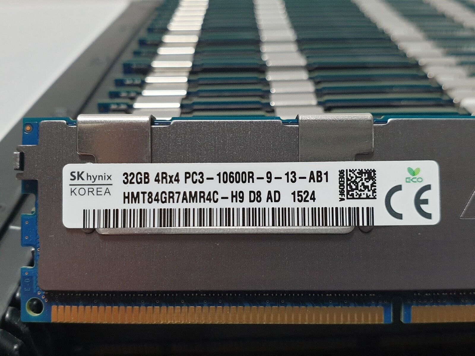

Thanks for your reply!
1) Only some 32GB DIMM can work, not all. So far, it seems only the 4Rx4 RDIMM can work. Speed shouldn't be a problem. The cMP should auto aelect the highest possible clock speed to run them anyway.

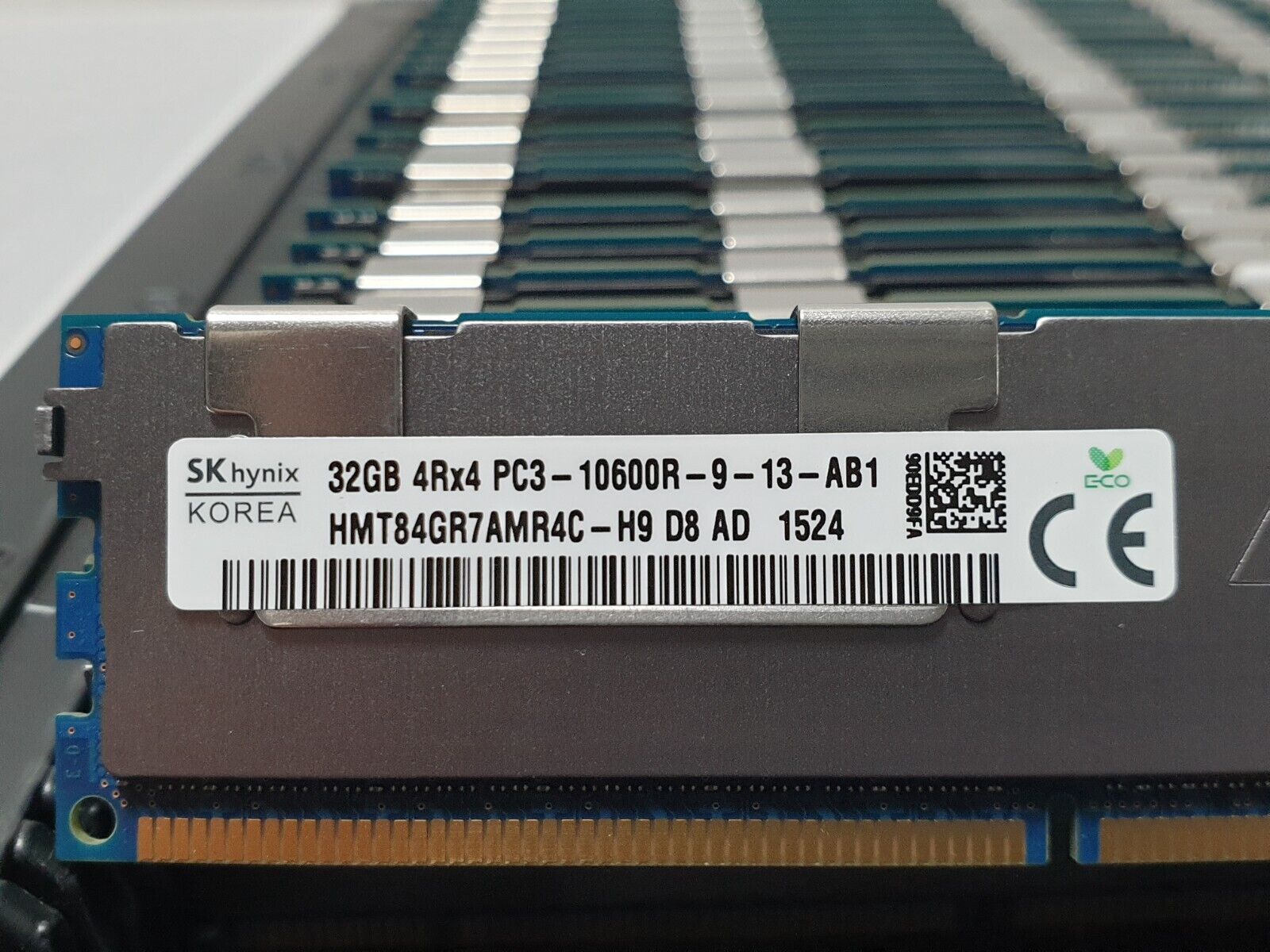

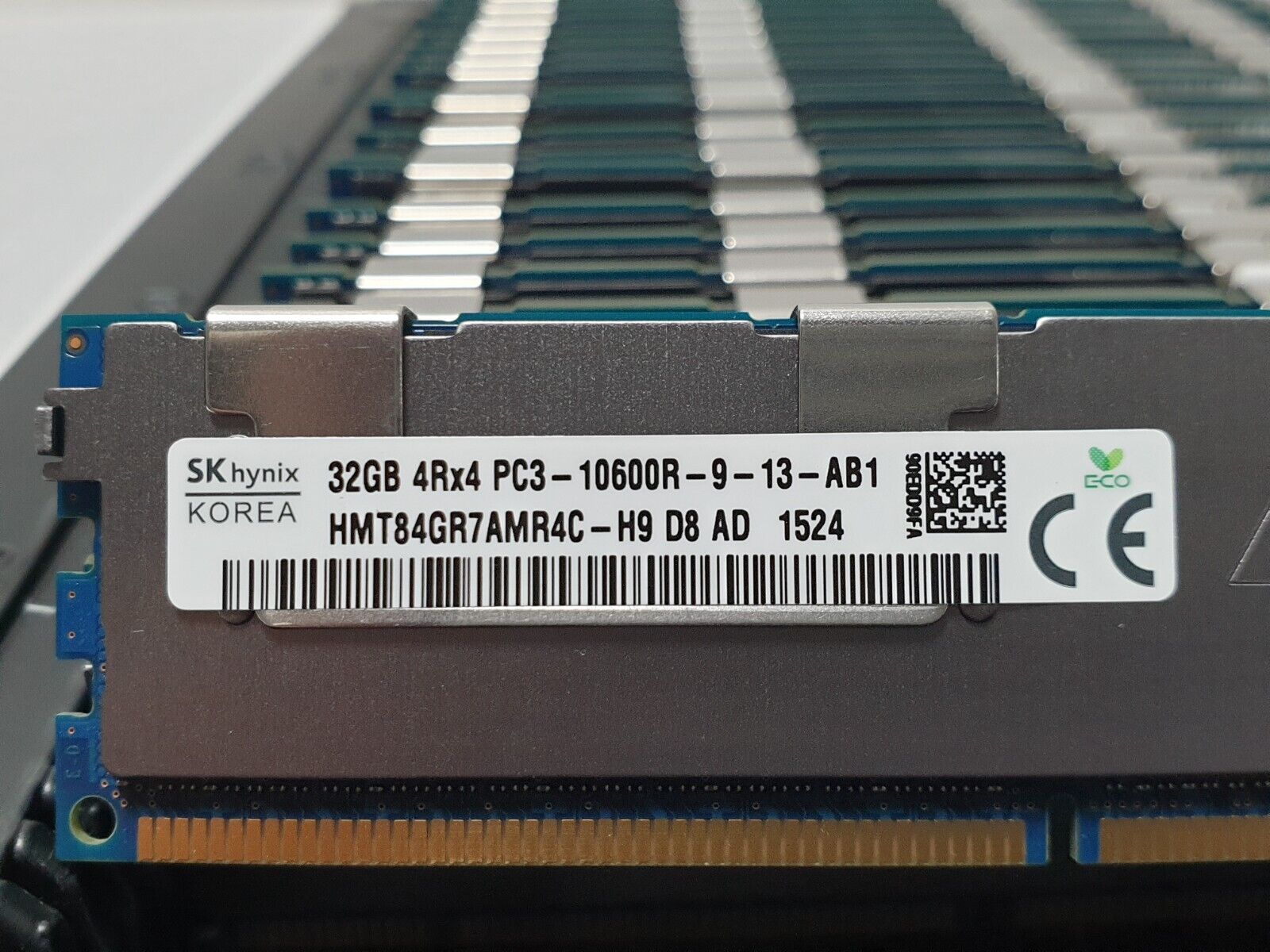

I ordered what (i think) some others had success with. So i hope from the hardware-point the modules should work. Will likely arrive today!
2) There should be no harm to do so. In fact, that memory spoofing is quit cosmetic, you can set that to 12x128GB etc, and the cMP will still run. However, set that to spoof to 32GB DIMM somehow magically make the cMP can really boot to desktop with 32GB DIMM in macOS.
So it does, if only "CustomMemory" is set to "true" and no other edits are made? And also the full amount is really made use of?
So far, no tester can make the cMP crash by spoofing the memory config (as long as the RAM itself can actually work). And apparently the cMP can use all memory regardless you spoof it to higher / lower capacity.

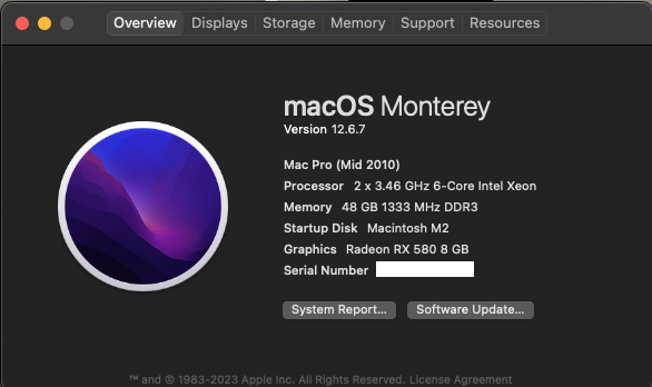

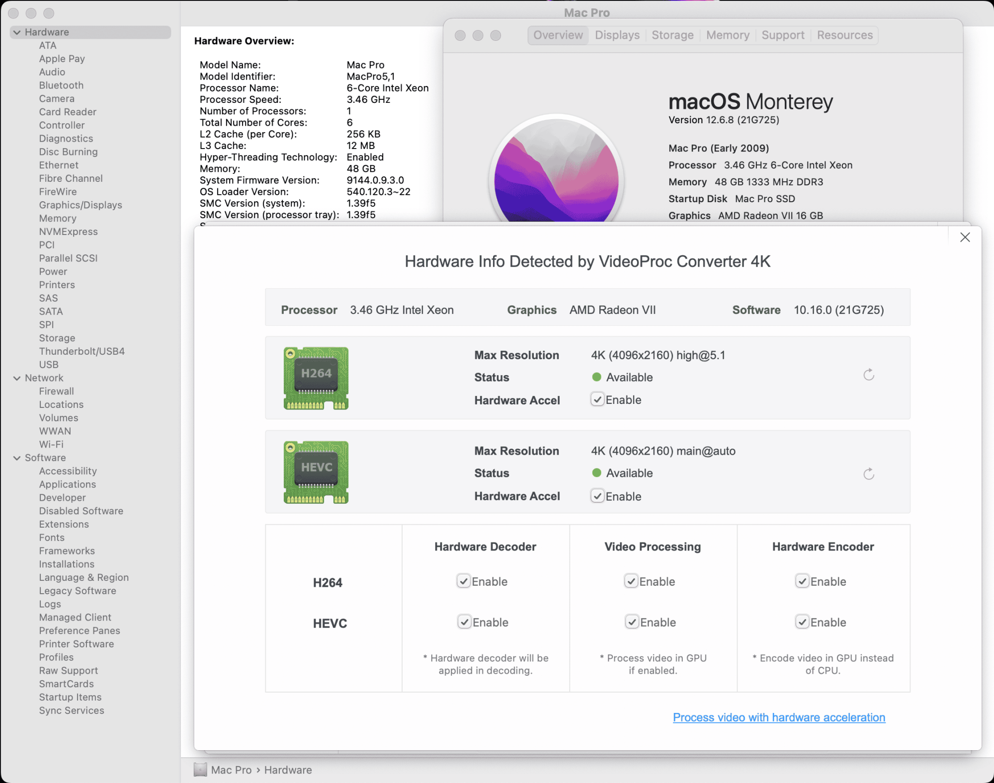

Everything works just fine!

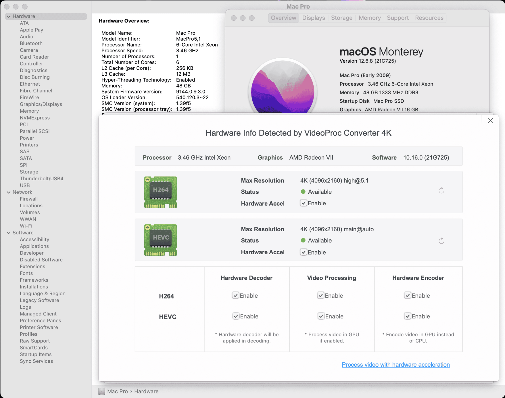

Meanwhile i reduced to 192GB, which gives much better memory performance (according to GeekBench). Also with all of the slots populated, even with no issues in functionality, i had two of the red LEDs on the CPU-board lit up, which are off again with the triple channel configuration.
Nice to have this working now!
Hello. I have a MP 5.1 with a 5700xt, Monterey and OCLP. I noticed it is unable to encode HEVC 10bit through HW accelerate, either in Compressor, Resolve or Quicktime. Did I miss something?
Yes, the macOS API that provides direct access to hardware encoders and decoders that enable hardware assistance for video decompression/compression/colour grading and pixel moving, Apple VideoToolbox, does not support 10bit compression with AMD GPUs, but the hardware itself is capable since the first generation of NAVI GPUs and there are patches for ffmpeg on Linux.
Apple seems to only support 10bit compression with Apple Silicon Macs and Macs with T2, correct me if I'm wrong
Reactions: zazaki and h9826790
