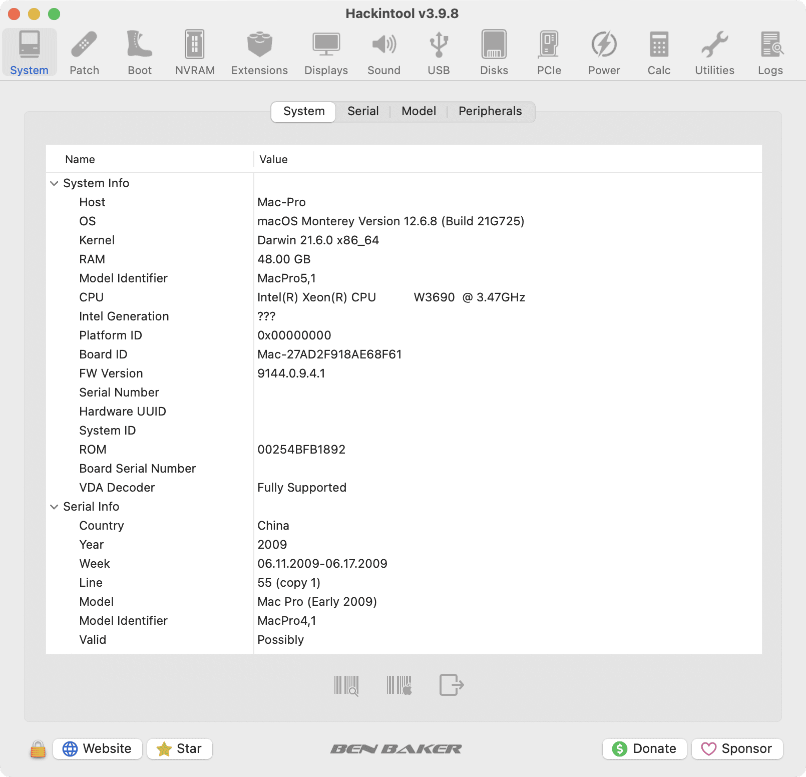

Even changing the board-id, as suggested in the spoiler on the main page, doesn't make any difference (and weirdly, Hackintool still reports the Mac-7BA5B2D9E42DDD94 value after changing the plist).
I suspect there are multiple OC copies on different hard drive, and you modded the inactive one. Please mount the EFI partitions one by one, and check all of them if more than one OC is installed.
After you mod the board ID (and reboot), Hackintool should able to read the spoofed board ID correctly.
After you mod the board ID (and reboot), Hackintool should able to read the spoofed board ID correctly.View attachment 2253050
I only have one drive with one OC install in my Mac…
Just to be sure, when I search the old board ID in the plist I get two results. I have to change the one under PlatformInfo, right?
Edit: I changed both and now it’s working. Thanks!
