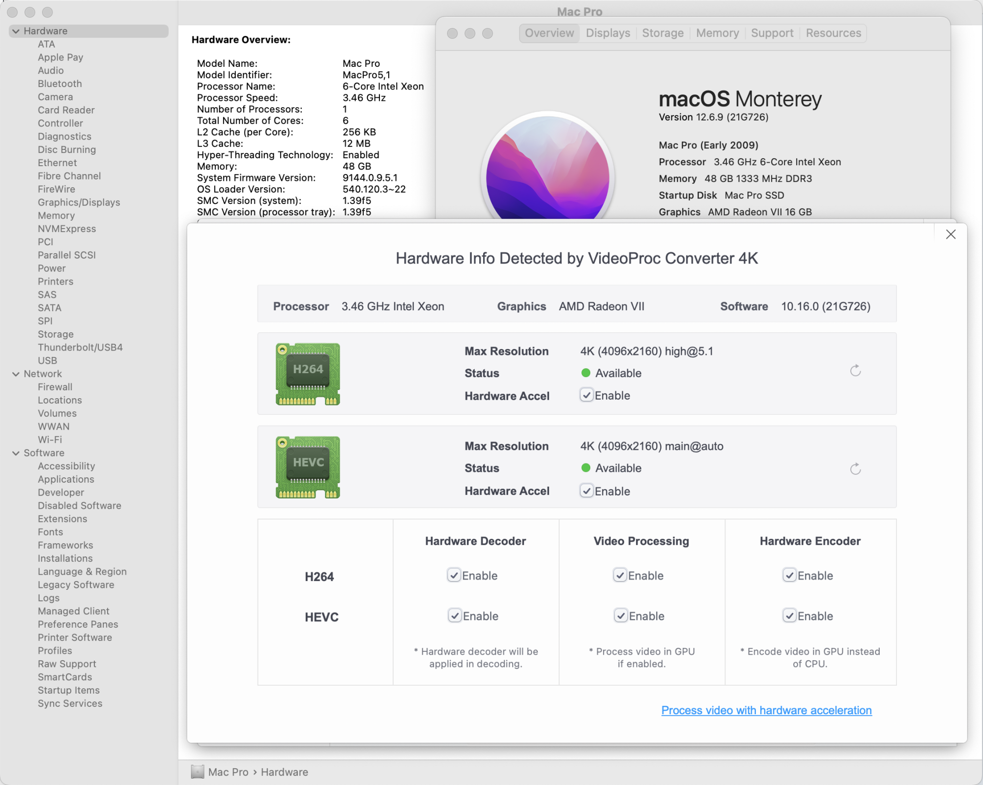

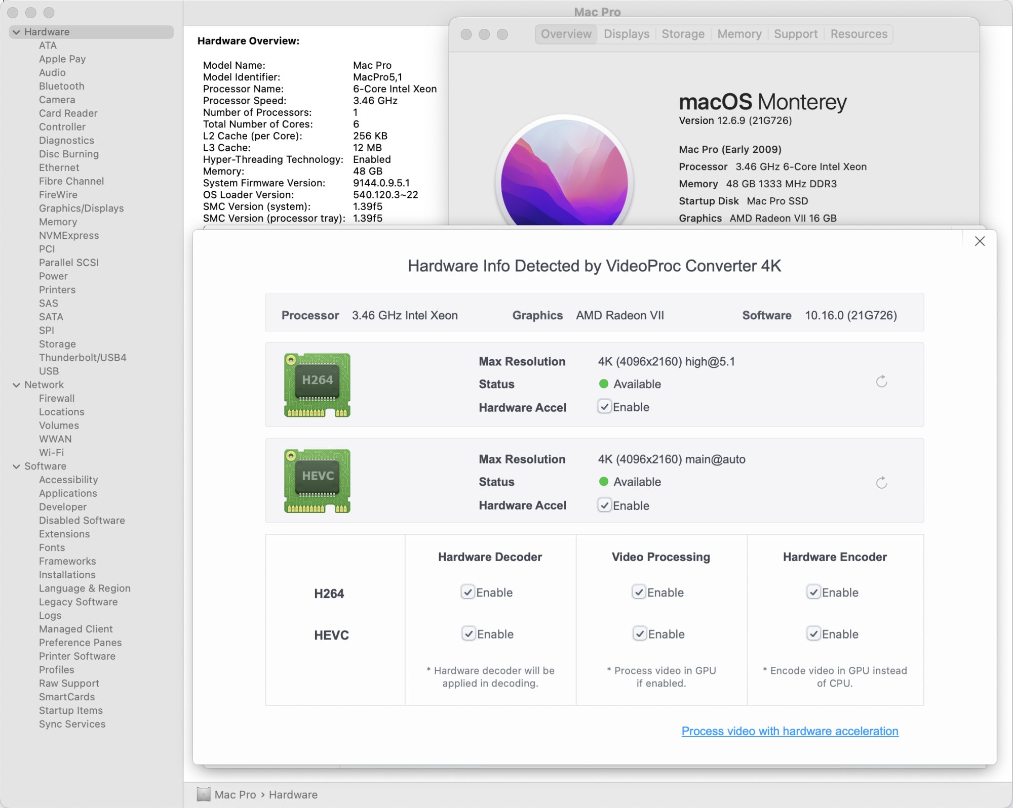

12.6.9 updated successfully. I am using my own 0.9.5 package now. This package is under internal beta testing at this moment. However, due to no change in Monterey support between 0.9.4 and 0.9.5. Therefore, existing 0.9.4 users should be safe to update to Monterey 12.6.9 with VMM on and SMBIOS spoofing off.
Just confirming, using 0.9.4 package and running 12.6.9. Updated successfully with VMM on and SMBIOS off.
Reactions: h9826790

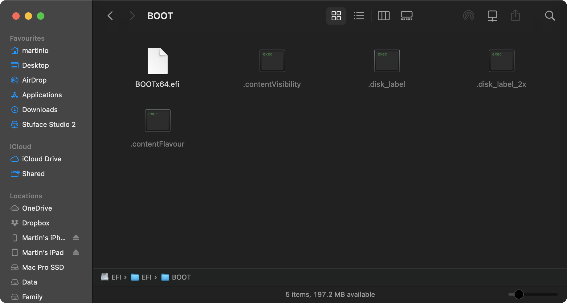

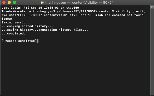

Please help me to hide the EFI drive in Boot Screen.
If you install OC correctly (e.g. copy the whole BOOT folder into position, but not manually moving the files inside), then there should be a hidden file .contentVisibility inside the EFI/EFI/BOOT folder.

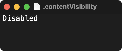

And if you open that file, there should be just a single word "Disabled" inside it.
This is the file to control if that EFI entry show up in the OC boot picker.
I see what you said. However how to solve the problem. Thanks

Did you check all EFI partitions? If more than one OC copy installed, then the other one will also show up as an EFI entry.

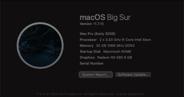

any instructions on how to do this "in your case i would download and build on a second mac a OCLP usb stick with BIG SUR and reinstall it onto your NVME, it should be possible that you overwrite your existing MAC OS install disk NVME and you will be left with the remaining Data; please correct me if am wrong." i did the dos dude a long time ago...and i don't remember
update! i was able to fix my mac installing Big sur into another drive, and i was wrong on my original post i DID NOT use DOS DUDE...i used the instructionson this thread using: https://forums.macrumors.com/thread...n.2180095/page-53?post=28255048#post-28255048
Using, Clover Config, then coping the EFI files into the correct section, then blessing...thats how i got the this to work on my original set up. THe thing is now, i tried monterey again..to no avail. Wouldn't be the same, of just getting the latest attachments on the threat for the open core, and follow the same instructions?
So what im doing is getting Monterey from the app store. Following the Clover Cing ect instructions. The computer looks like its updating. Once it restarts, it logs right back into my big sur set up. I remember when i did this the first time, the normal big sur just updated.
2009 flashed mac pro. NVME via pcie
Thanks again in advance. This forum is AWESOME!!

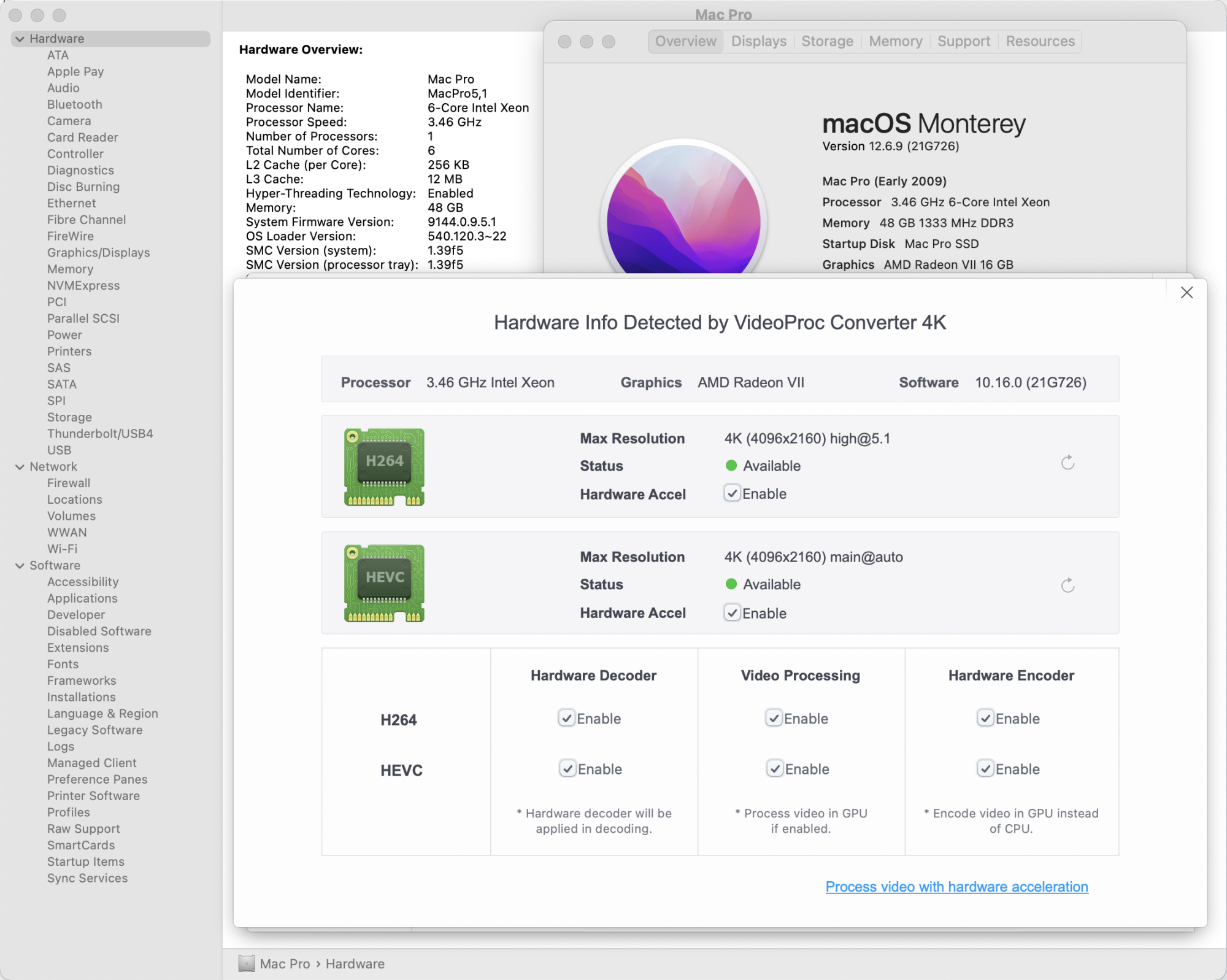

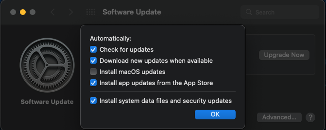

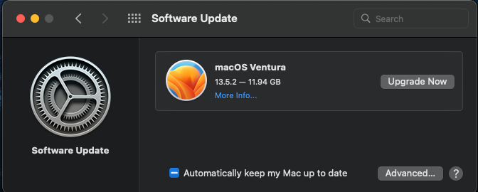

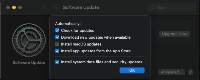

I'm still not seeing the the update?

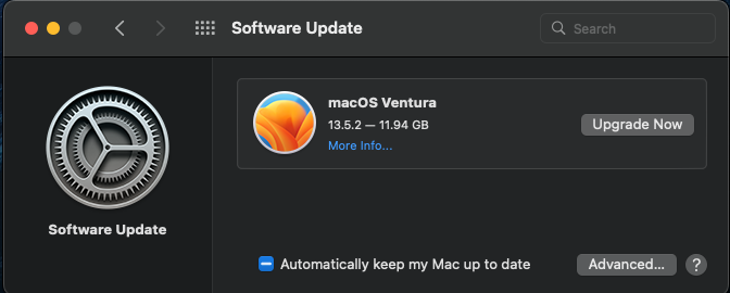

I see the update from the app store (Monterey)
I did use the 0.9.4 Package. No cigar. after "updating" it asks to restart. Once it restarts it just boots up into my Big Sur setup. Its like something is blocking it. I did update the Boot Rom firmware back when i did Big Sur, is that something that has to be done again?

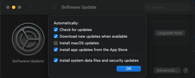

Configuration needs to be setup to be able "see" the updates.
There are two options.
See this thread in Post#1 and scroll to the section "Clean install or update"

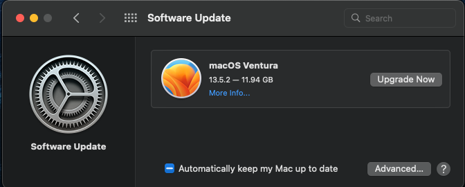

Yes i see that update "ventura," But since i don't want to go all the way up to Ventura (Music Production Software). I search for Montrey via google/app store and download it: https://apps.apple.com/by/app/macos-monterey/id1576738294?mt=12
so yes i see the updates! after clover config, EFI files copy, and bless. But again, once it restarts after "installing" Monterey, it just boots up into my Big Sur set up, like nothing happened.
https://forums.macrumors.com/threads/manually-configured-opencore-on-the-mac-pro.2207814/Yes i see that update "ventura," But since i don't want to go all the way up to Ventura (Music Production Software). I search for Montrey via google/app store and download it: https://apps.apple.com/by/app/macos-monterey/id1576738294?mt=12
Even if you wanted, you cannot install Ventura using the Manual OpenCore method on the cMP.
The only way to install Ventura is to use OCLP which is not covered here.
Anyway, regarding Monterey, I am not sure what you mean by "after clover config, EFI files copy, and bless".
Not even sure what process you are following in trying to install Monterey.
If you have working Big Sur booting via OpenCore, then you should be able to Upgrade to Monterey by following the link I posted above.
I not sure the App Store download is the FULL installer. If you follow the instructions in that link, you will be able to install Monterey.
