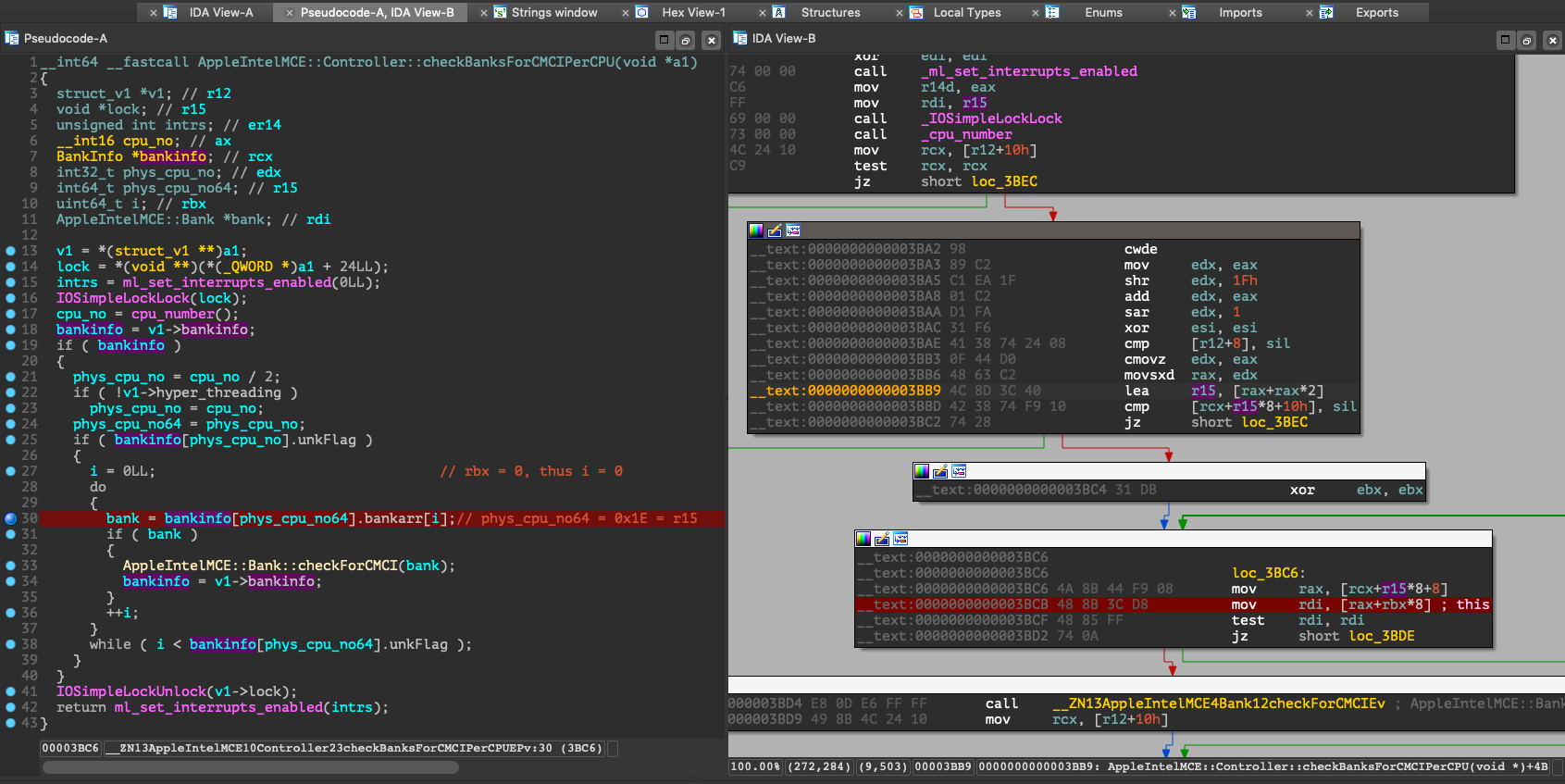

Has anyone successfuly been able to get a dual socket Mac Pro work with smbios spoof under Catalina using method on Post 594? Mine worked under Mojave but can get the computer to even boot up properly when using this method on Catalina. Standard OpenCore install works fine, but when i download latest Lilu 1.4.0, WEG 1.3.5, and config.plist from post 594, everything just breaks when spoofing SMBIOS at iMac Pro.
When i turn on the machine, i get no boot screen and 2 minutes later the computer just turns off (is this a kernel panic?). Only way to recover is PRAM reset and boot into a backup Mojave drive.
Any feedback regarding what others did to make this work? FYI I’m running dual X5690 CPUs, 96GB Ram, NVME PCIE ssd, and Vega 56 (Pixlas Mod).
For dual CPU's :
"The crash itself is caused by out of bounds array access:
this driver does not support 2 CPU's , and does not allocate enough memory, see __ZN13AppleIntelMCE10Controller4InitEv"
The solution is to remove AppleIntelMCEReporter.kext
By the way you need to get the latest opencore, WEG and Lilu.

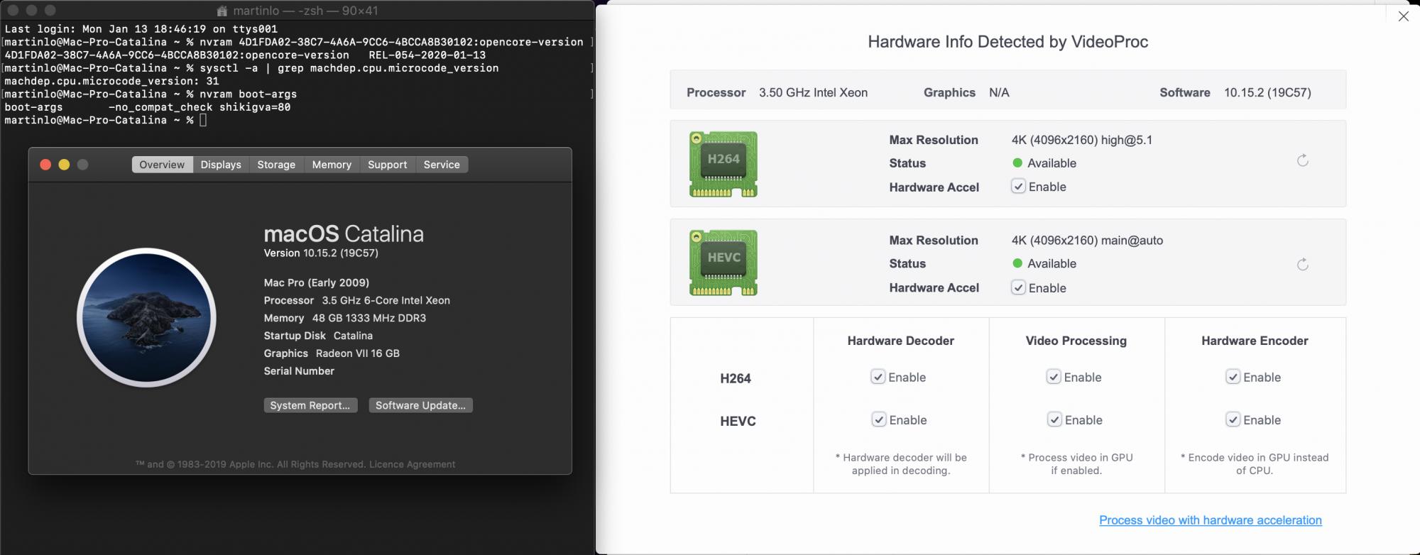

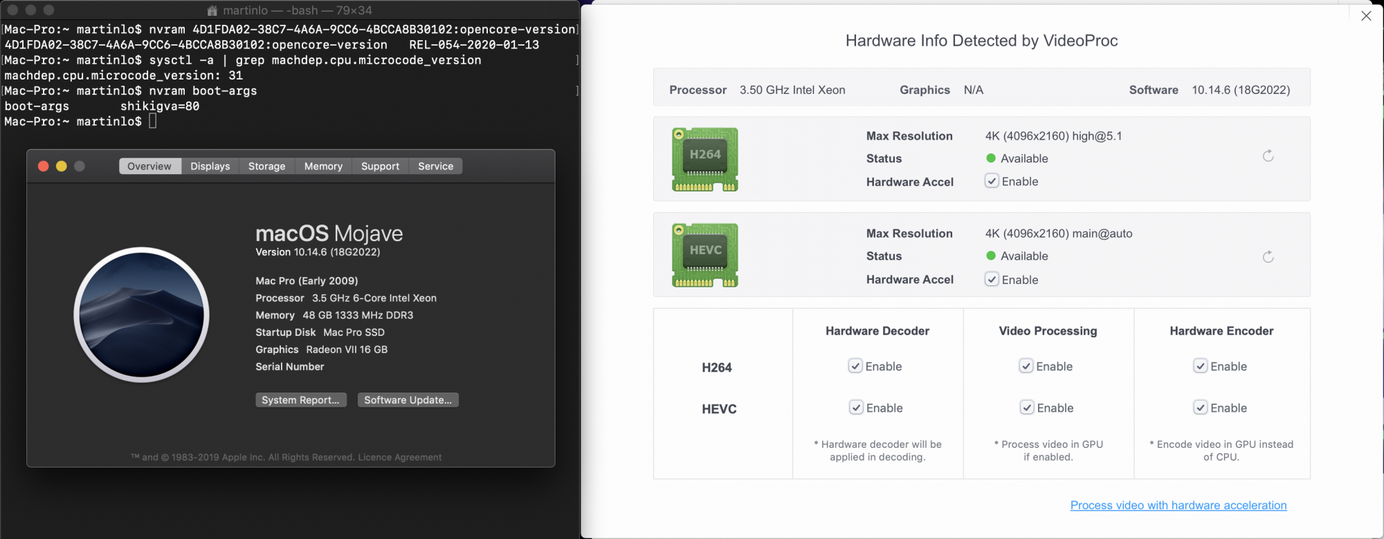

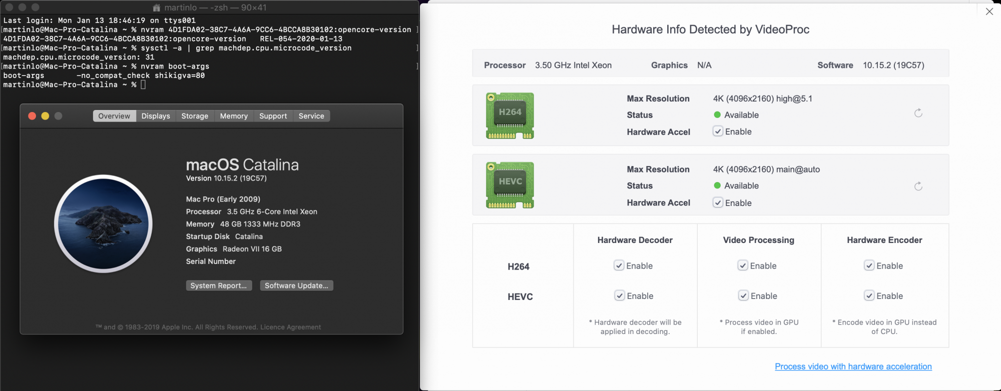

OpenCore 0.5.4, Lilu 1.4.1, WEG 1.3.6 just released. CPU microcode can now display correctly.
Checked can work on both Mojave and Catalina (only tested on my W3690 + Radeon VII system)
Post #594 updated accordingly

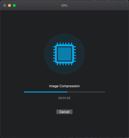

startergo
macrumors 603
Sep 20, 2018
5,021
2,283
4) Run GB5
I ran the test twice and both times I had a system freeze around this point:
I am only able to provide a screenshot because of the remote screen sharing. After reboot (I asked my daughter to unplug the cord) there is no recorded KP.
