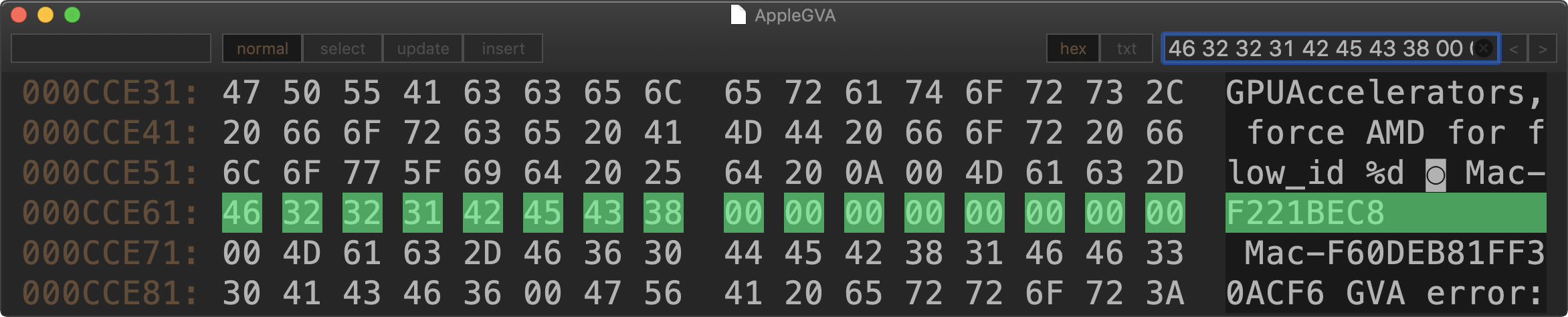

9) double click the current AppleGVA.framework, you should able to open it.
10) continue to Version -> A, and locate “AppleGVA” (this file has no extension)
11) open this AppleGVA file with a Hex editor.
12) find 37 42 41 35 42 32 44 39 45 34 32 44 44 44 39 34 (should have TWO match result in Mojave. If you want to try this in 10.15, you may find only one result)
View attachment 841940 View attachment 841939
13) replace BOTH by 46 32 32 31 42 45 43 38 00 00 00 00 00 00 00 00 (make sure you replace the original byte, NOT insert).

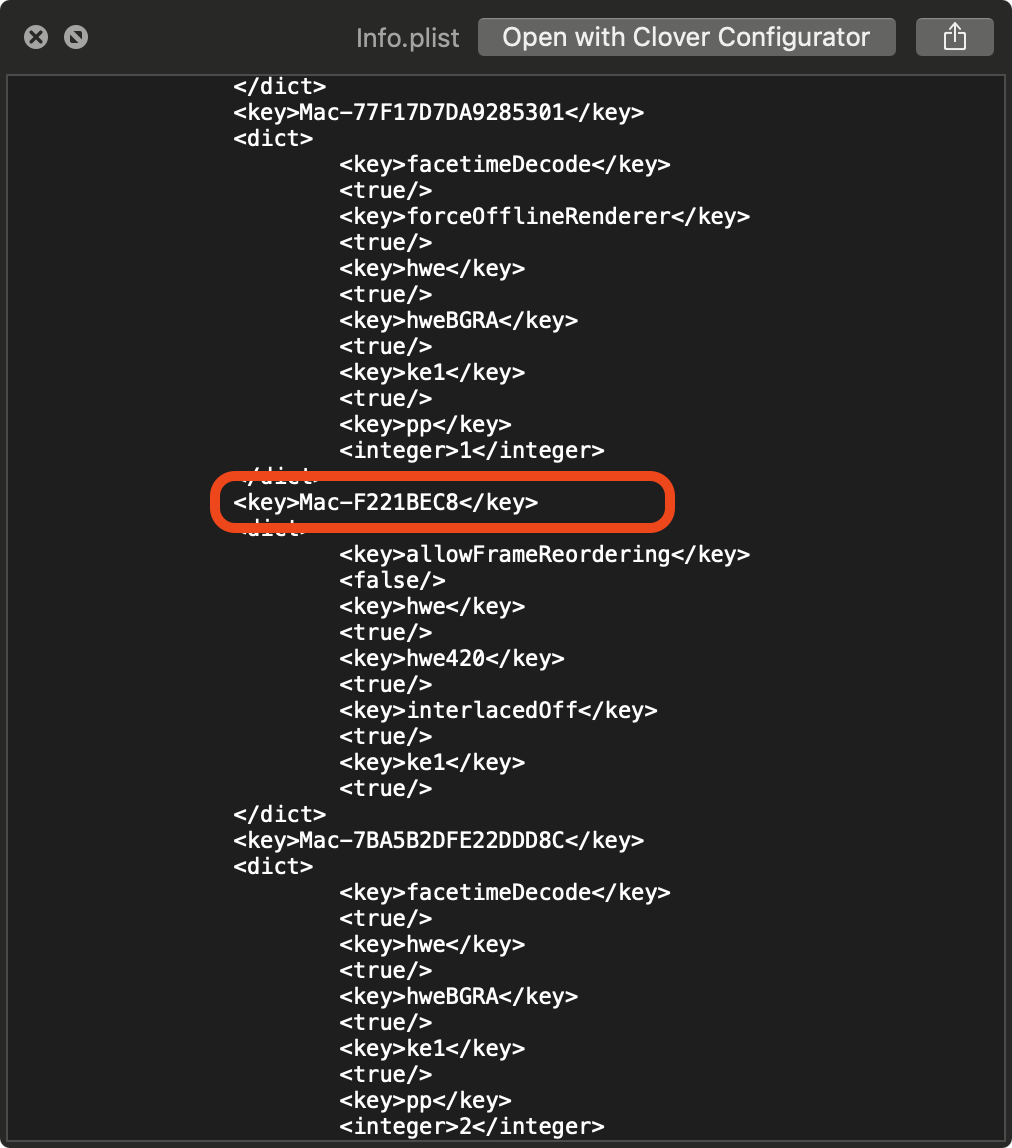

View attachment 841942 View attachment 841941
14) save the file
15) open terminal
16) enter
Code:
sudo codesign -f -s - /System/Library/PrivateFrameworks/AppleGVA.framework/Versions/A/AppleGVA
17) in Finder, in that folder “A”, continue go into folder “Resources”
18) open the info.plist with text editor
19) search 7BA5B2D9E42DDD94
20) replace that by F221BEC8
21) Reboot.

Hi I'm French . I would like to know which hex editor you use?
Thank you very much Startergo, but I already tried with this one and I can't find the lines modified ... Can you give me the name of the one you use in this tutorial. Thank you
I was able to use Hex Fiend as follows -- it was very easy and worked great:
Open the AppGVA file as instructed. Invoke "Edit > Find" (Command + F). Copy hex string #1 from the instructions ("37 42 41 35 42 32 44 39 45 34 32 44 44 44 39 34") and paste it into the "Find" text box. Now copy hex string #2 from the instructions ("46 32 32 31 42 45 43 38 00 00 00 00 00 00 00 00") and paste it into the "Replace" text box. Click the "Replace All" button.
Then save the file, and continue with the instructions.
I have H264 hardware-assisted encode/decode working, and HEVC decode, on a dual-processor cMP 5,1 with an RX580 running Mojave 10.14.6.
Reactions: JedNZ
Thank you very much I finally understood. But I cannot modify the .Plist file. It is locked: /
You must disable SIP first. Type “csrutil status” in a terminal window to check the current setting.
If SIP is disabled and the plist file is locked, perhaps you have it open in more than one editor window, or in a different terminal session.
Reactions: ZeroKool79

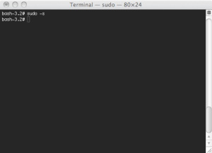

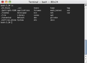

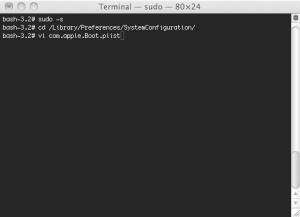

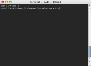

The Easy Way To Edit .plist file
Step1:
Open a terminal session: Finder –> Applications –> Utilities –> Terminal (See Figure 1.)
Figure 1.
Change to super user by entering the following command: sudo -s and then enter your password and press enter again. (See Figure 2.)
Figure 2.
Change to the required directory (cd /Path/to/file) then hit enter. (See Figure 3.)
Figure 3.
Edit the .plist file file by typing: (nano filename.plist) then hit enter. (See Figure 4.)
Figure 4.

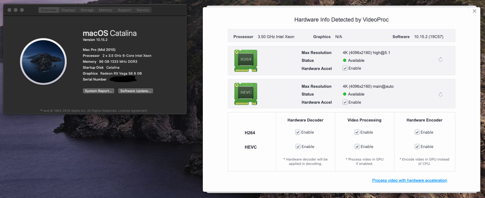

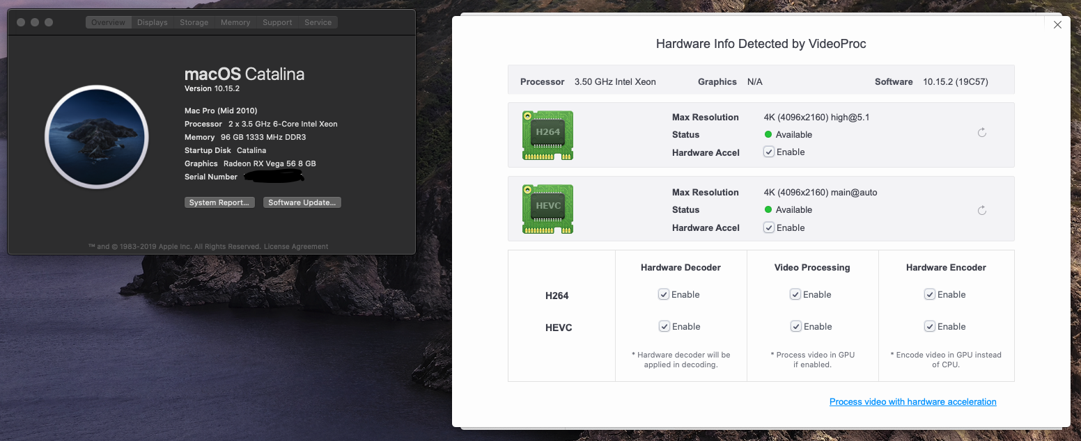

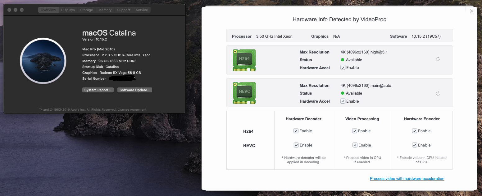

@h9826790 I'm on Catalina and using the latest config.plist that you've uploaded which achieves hardware acceleration without spoofing the iMac Pro smbios. While I'm able to get havoc encode / decode to work fine, I'm unable to get appletv + or Netflix to work. What is weird is that in Apple TV+ the video plays and I hear sound but image is black. I'm on a Vega 56 dual processor system btw.
Sorry, don't know how to use Hackintool. When encording a 1080p h.264 video to HEVC using VideoProc, CPU is at around 50% (very low) and GPU hovers around 30-40% when monitoring using OpenGL monitoring tool.

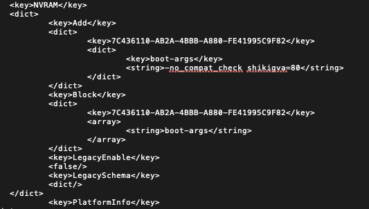

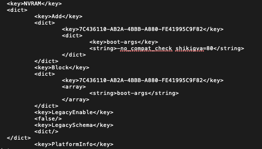

No you are wrong. It is still spoofed (partially). That is why the frequency is reported 3.5GHZ and the CPU idling is broken. As I said, with unpatched smbios your CPU will report 3.46Ghz. This is what we have been trying to work on lately, but cannot find a solution until this moment. If you set shikigva=80 as a boot argument (or 144) you should also get Netflix in Safari, Prime video and Apple TV working with this config.
Thank you for the clarification!

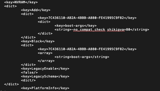

Regarding the boot arguments are you referring to this portion of the config.plist. I tried both 80 and 144 but neither made a difference and video is still black.
You have the latest WEG and LILU kexts right? Is your video card attached under GFX0 in the registry? I had the black video once in a while too. Try signing out/in Appstore. You may also try 208 (80+128) or 16.
Changing the shikigva values makes no difference and neither does signing in/out of app store. When you mention that video card should be attached under GFX0 in regisry, where do i check this setting? I it under the AppleGraphicsDevicePolicy.kext?
