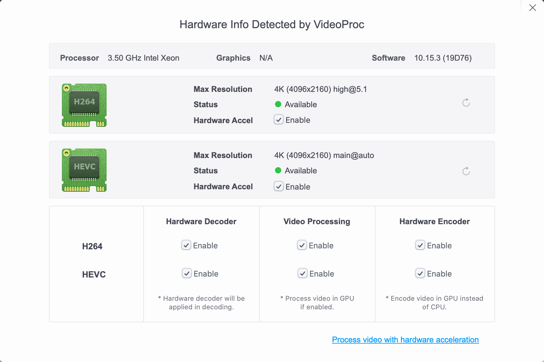

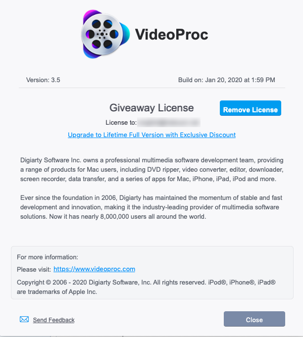

VideoProc is giving away a free license - must register the " giveaway license " before Feb. 14th 2020.
Just activated my license.
LINK https://www.videoproc.com/giveaway/?mail=JanGV00

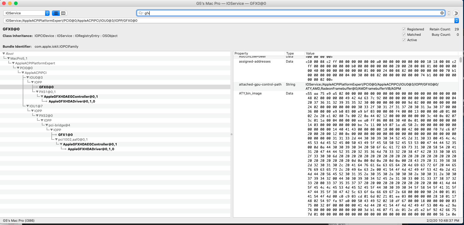

If I add a second Radeon VII into the machine, will it provide hardware acceleration automatically? Or is there a part of the process that needs to be repeated?
I don't think so.
All HWAccel is done via VideoToolBox, which the user has no control at all. Which means, for HWAccel, we have no way to assign one GPU for task A, and the other GPU for task B.
Also, I believe only the GPU that has PCIe name GFX0 can do HEVC hardware encoding.
Reactions: Grumply
tsialex
Contributor
Jun 13, 2016
13,454
13,601
I don't think so.
I'm hoping that Apple will refactor the VideoToolBox code to enable multiple GPUs hardware encoding. Makes sense for multiple MP7,1 GPUs and DUO MPXs.
For now, just GFX0 is working, like you said.
