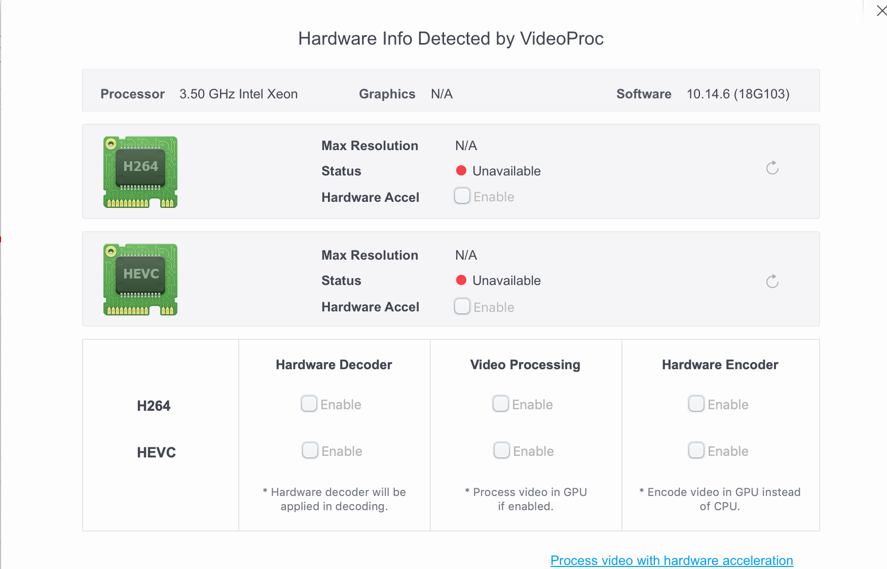

I went through all the steps again, and didn't get an error this time after blessing. I rebooted. Still no HW access visible in VideoProc.app. But, about this Mac shows 3.5GHz CPU's, so something partially worked.

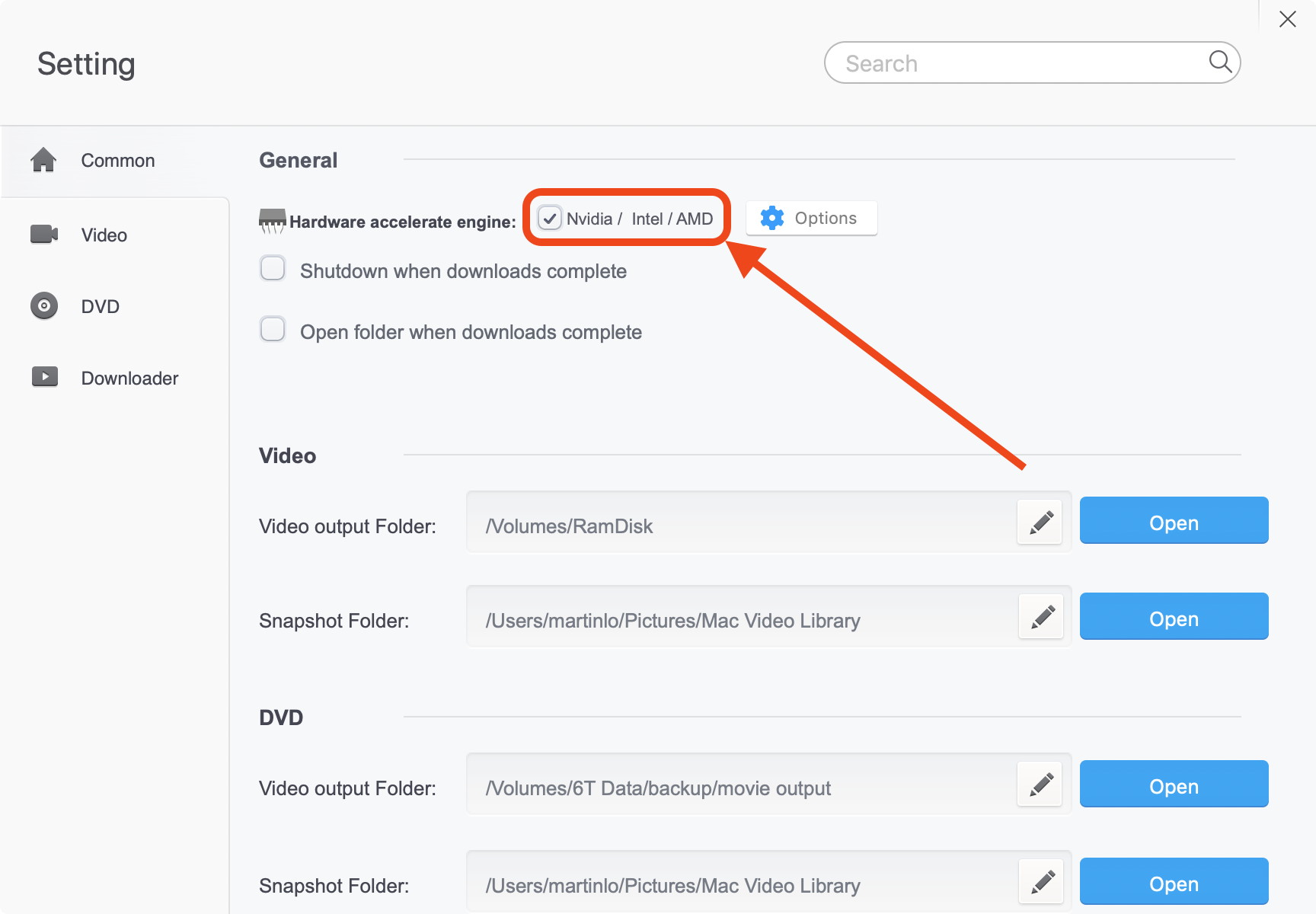

You can't see this tick?
I see that tick, yes. But when I go to the options page to its right, it says "unavailable" for both H264 and HEVC. I tried downloading that sword 4k video file in post #1, but google says too many people downloaded it, and to try again in 24 hrs (had the same message yesterday).
I see that tick, yes. But when I go to the options page to its right, it says "unavailable" for both H264 and HEVC. I tried downloading that sword file in post #1, but google says too many people downloaded it, and to try again in 24 hrs (had the same message yesterday).

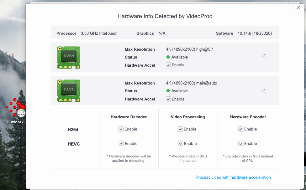

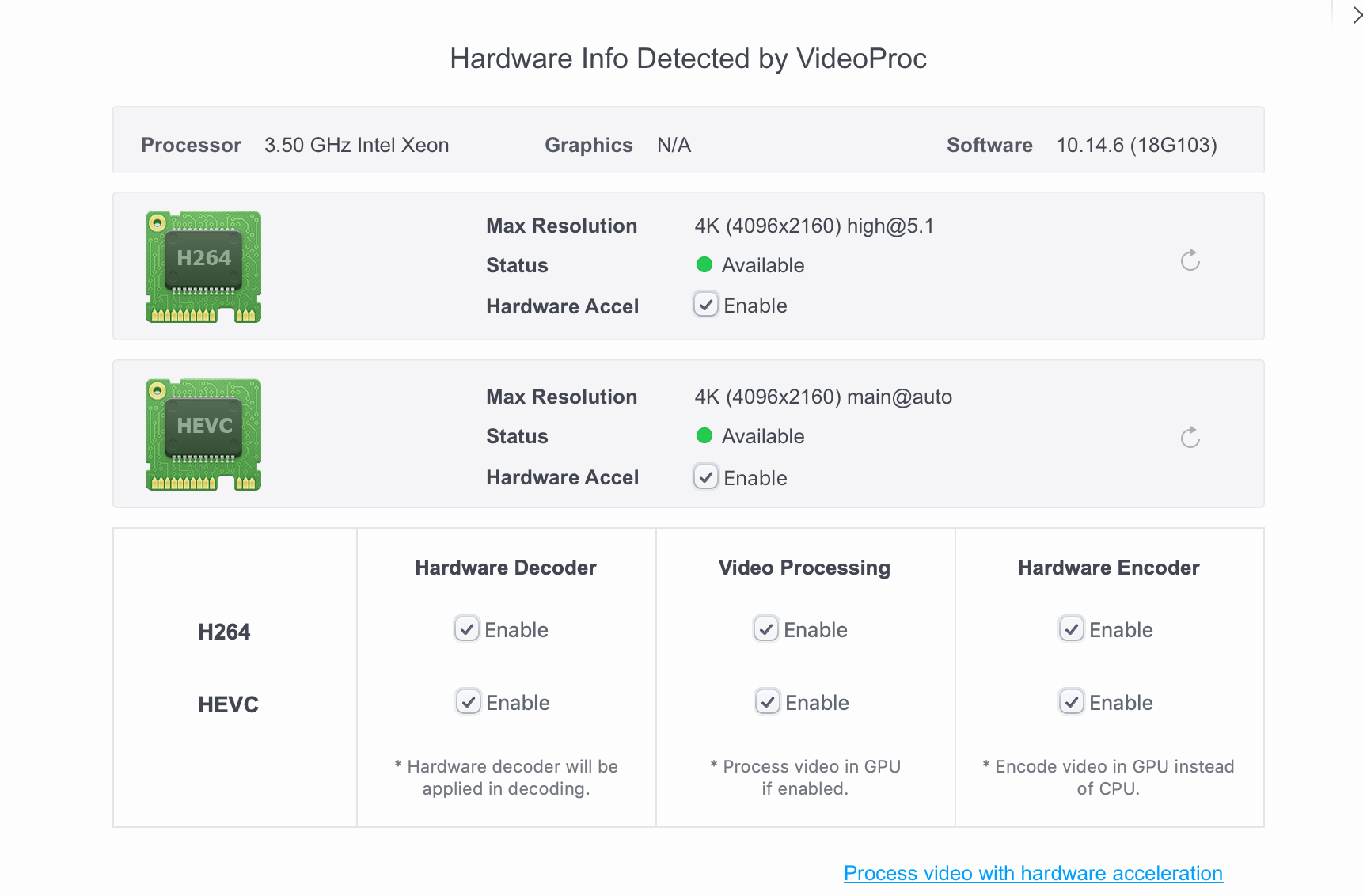

It's working.
Please read post #1 Q29
You can use the jellyfish test video
Reactions: kohlson
[automerge]1580774128[/automerge]
Wow! You were right. Now it works:) Sorry for wasting your time! And thanks for hanging with me:)
Reactions: h9826790
I downloaded the biggest jellyfish file from the post above. WOW, it looks amazing!

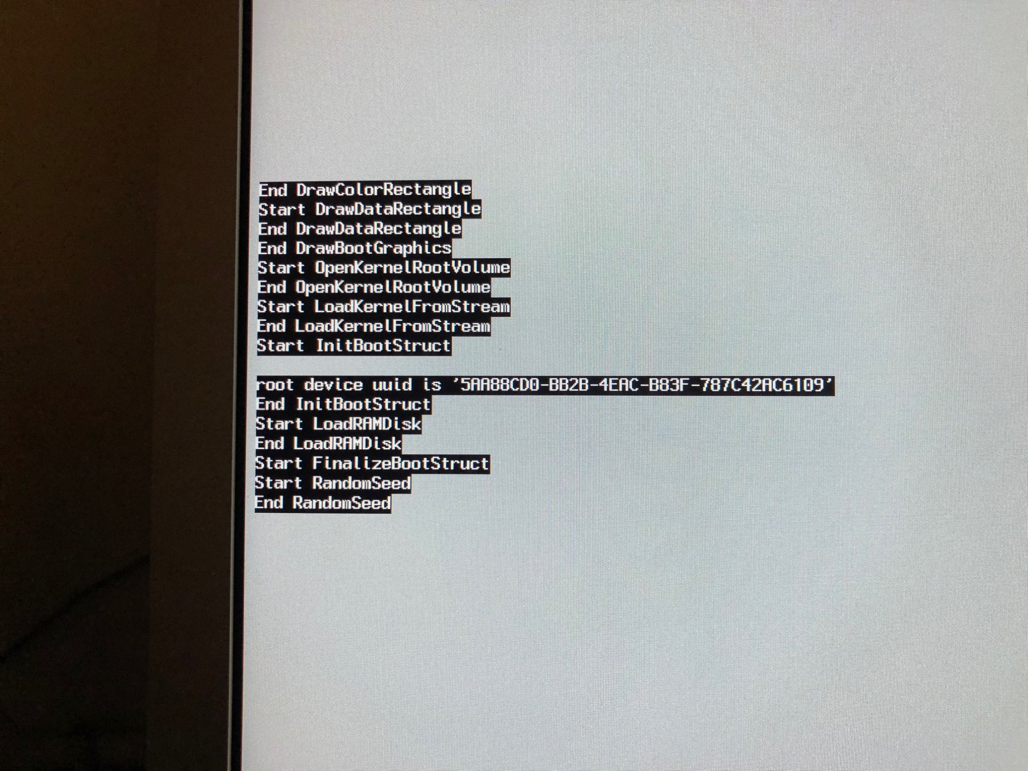

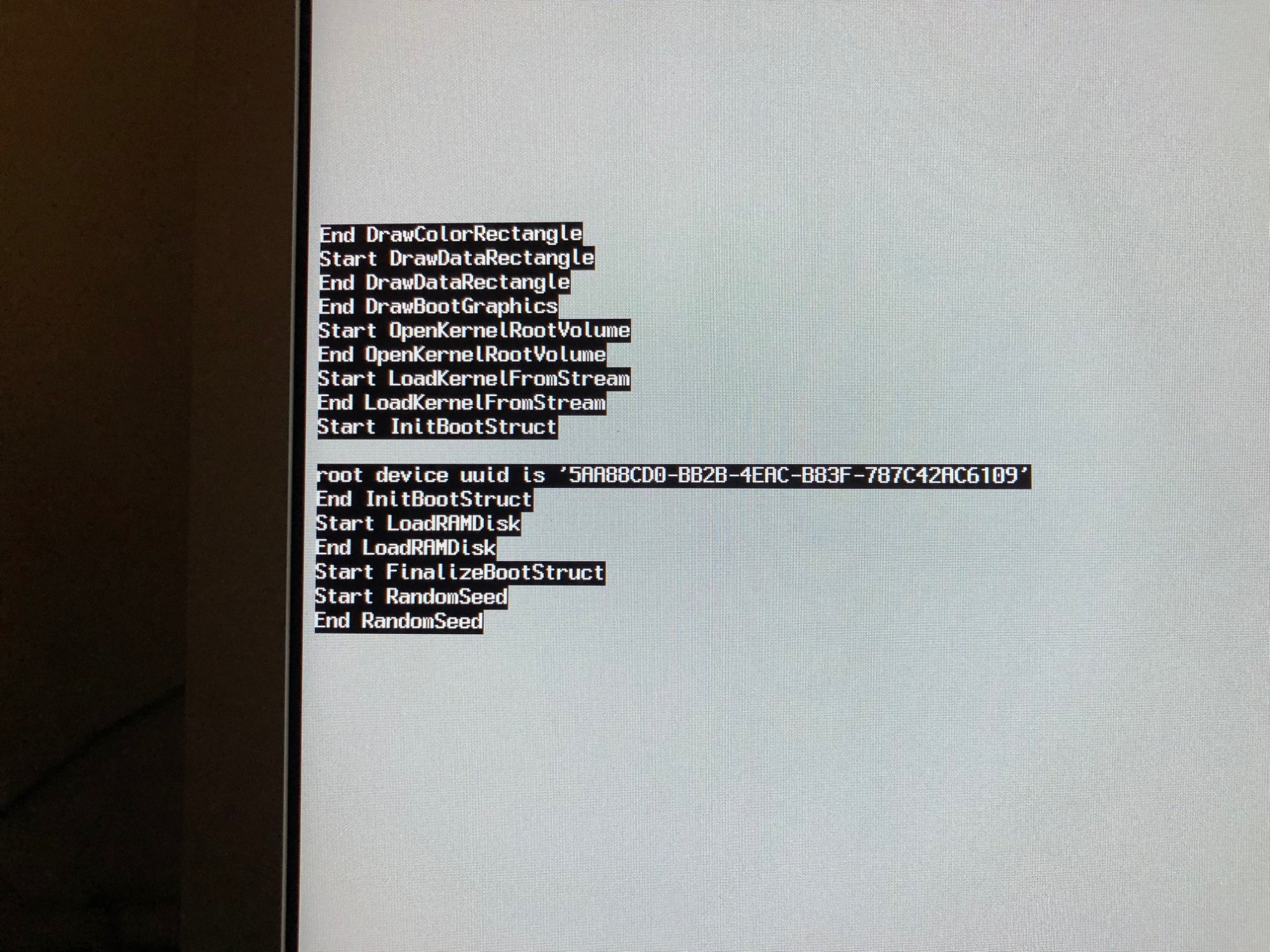

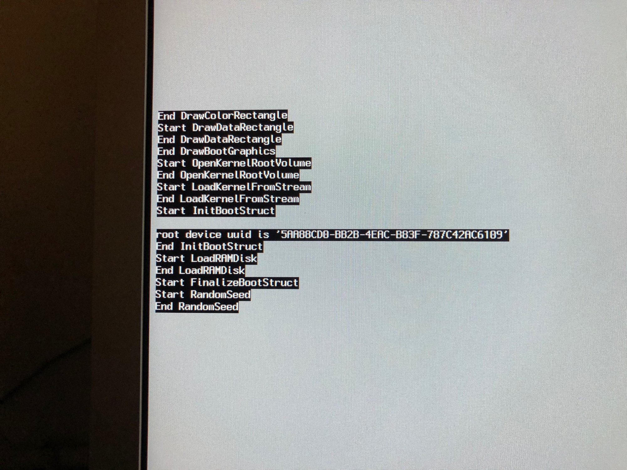

on reboot I see this:
You GPU is MVC flashed? If it is, disable ProvideConsoleGop.
What do you mean, please?
I don't know if my Gpu Rx Vega 56 is mvc flashed.

If just that cometic error, you don't need to touch anything.
I tried to make the procedure "one size fit all", it isn't that easy, and may produce artifacts during boot stage for some setup.
As long as the cMP can boot to desktop, work stably with HWAccel. Then nothing need to be changed.
I am also experiencing the exact same error. I was able to boot into my backup disk and delete OC from my EFI partition but I am not sure how to proceed getting this working.
As noted in my sig I have a 560. I used the Universal config file. This sort of thing may be out of my wheelhouse but any help is appreciated.
Your cMP hang at there?
MacManu77's cMP can boot to desktop and use HWAccel.

If no boot picker, you better use the Universal config plist, that cut the boot time by 10s.
cdf just provided the fix for this issue.
I updated the Universal config.plist in post #594 already. You may download that, mount the EFI partition, replace the config.plist, and see if it helps.
Thank you so much, as soon as I get home, I'll try the updated file and let you know.
Hello,
I confirm that updating the file now starts without that screen of post # 1,186
