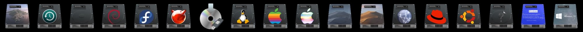

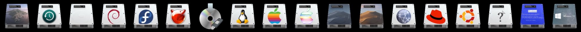

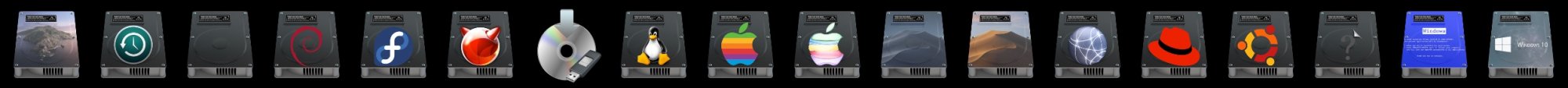

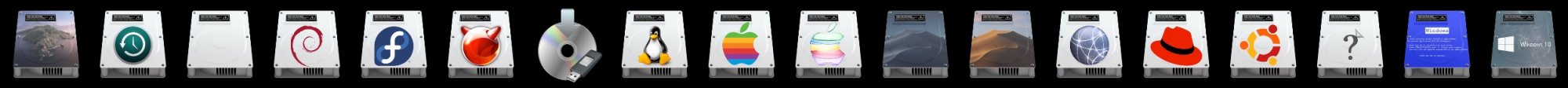

Do you know if there is existing repo to put our creation icons for Opencore?
and could you give me all label for icns used in Opencore?
thank you
bellow my 2 themes dark and light for Opencore
Reactions: octoviaa and zoltm

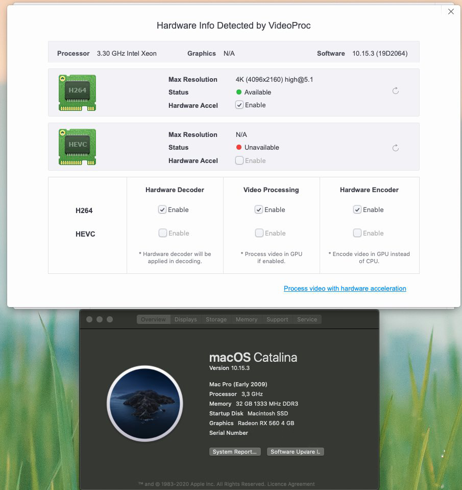

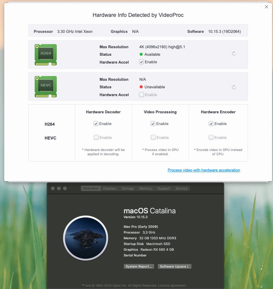

Hi,
my friend has problem with HW acceleration. He instals Open Core from post #1314 and everything works. After that he edits config.plist base on post #1326 to install Catalina. He upgrades to Catalina and he misunderstand something about HW acceleration because he tried to activate it HW acceleration base on post #1 by adding Lilu and WhateverGreen to Library/Extensions a he enter code to Terminal too.
I told to delete kext in Extensions but nothings change. Catalina works, h.264 works but no HEVC encode.
Also in "About this Mac" he has Unknown CPU.
He has Mac Pro 2009 update to 5.1 with 144.0.0.0 firmware with Xeon W3680, GPU is RX 560.
Thanks all of you for advices!

Hi,
So we done NVRAM reset and start from scratch. Now we have Catalina and Only h.264. Still no HEVC. We use package from post #1314 with OpenCore 0.5.7.
Any idea where we done something wrong? I use same package on my dual cpu Mac Pro and everything works fine and I absolutely love it!
Thanks for advices.
Thanks for advices.
Please update to 10.15.4. Even that's not a requirement, but that may able to fix some "broken" system files.
