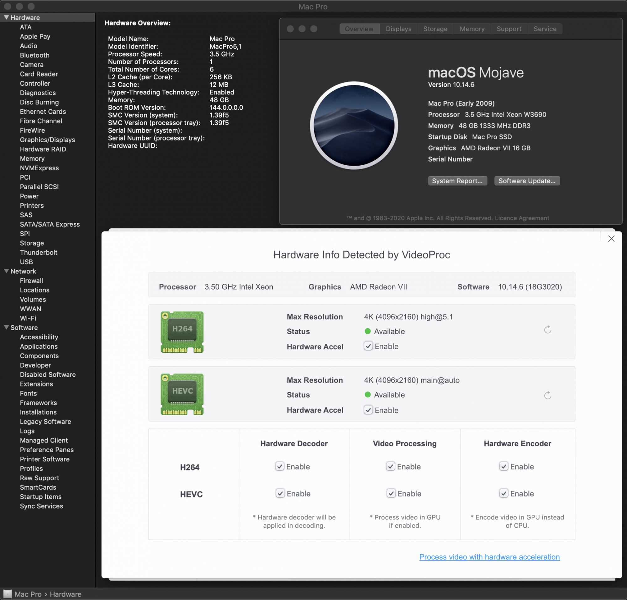

Full HWAccel achieved now!

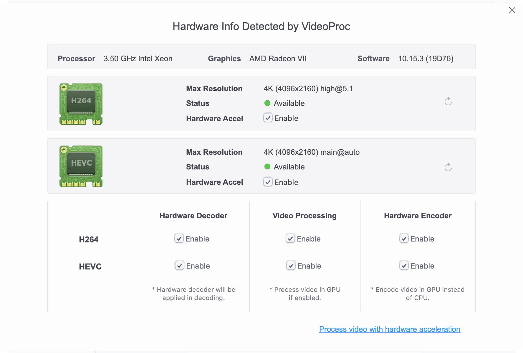

10.14.5 is now official. And I can confirm that AMD card users (Polaris or above) can enjoy H264 hardware encode / H264 hardware decode / and HEVC hardware decode.

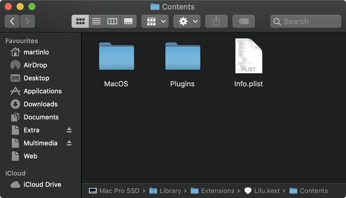

4) open Lilu.kext (right click -> show package contents)
5) enter Contents
6) create folder "Plugins" (N.B. This folder is INSIDE Contents, please do NOT miss step 5)
7) Copy the WhateverGreen.kext into Plugins
8) Copy the whole modded Lilu kext to /Library⁩/Extensions/

Q7: Can this work in 10.15?
A: Not as good as 10.14. Only Lilu method, or OpenCore method work. Also, in 10.15.2, Polaris (e.g. RX580) HEVC HWAccel support is removed by Apple (WhateverGreen should fix this Polaris supportability issue. But I haven’t test it personally)

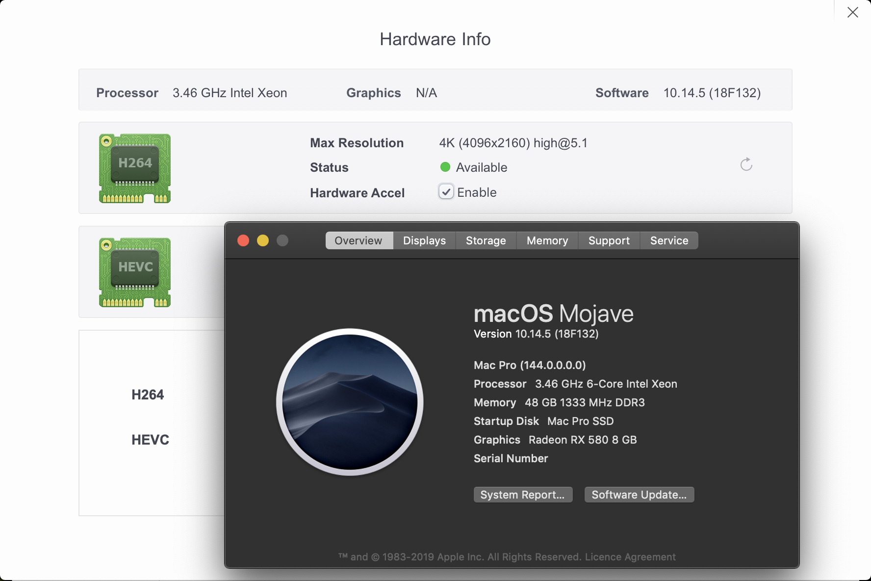

Q19: Why VideoProc shows no HEVC decode after the mod?
A: I don't know why, but this is normal in this case. My recommendation is to download demo HEVC video from the above link, and play it via QuickTime (or simply via Finder preview). As long as the CPU usage only stay around 20% (but not 800%), that means HEVC decoding is working properly.
For those who use OpenCore method, you should able to see HEVC HWAccel avail. If not there, please click the little reload icon.

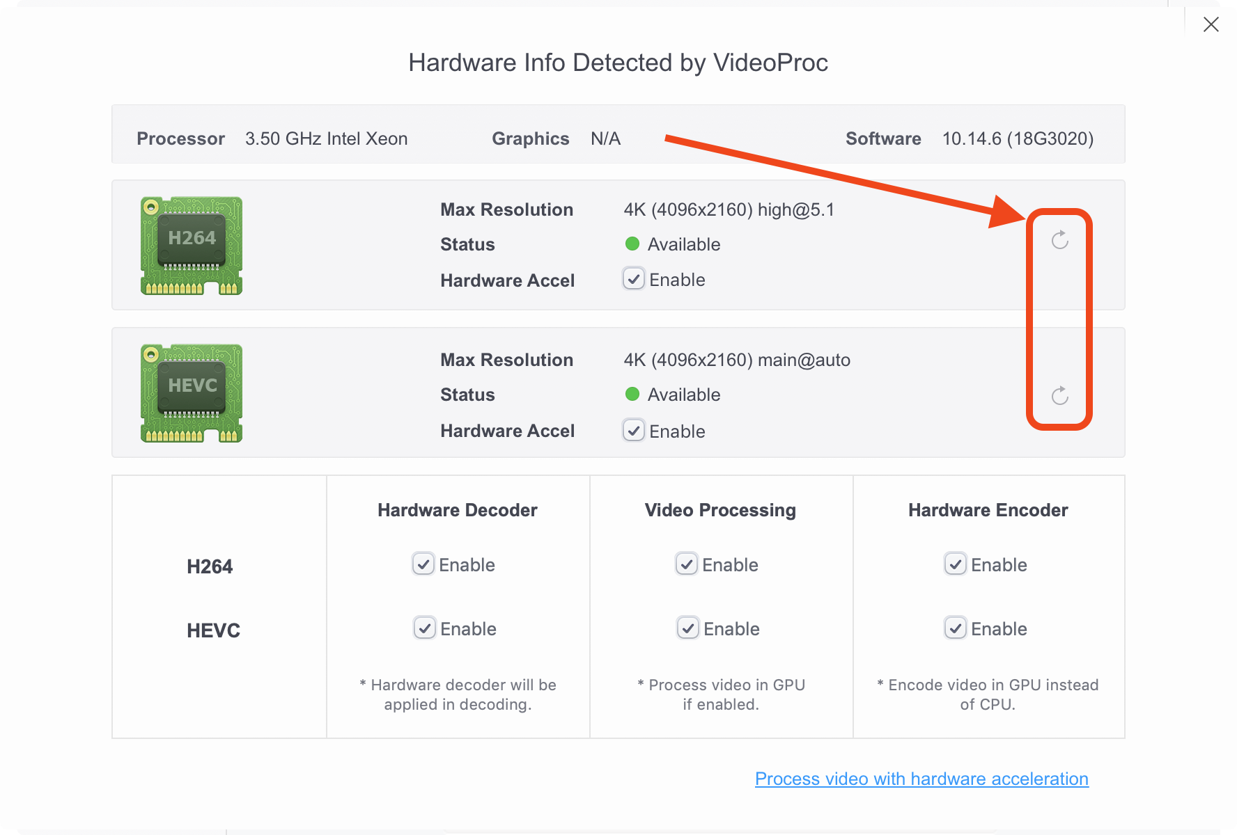

Q27: Why the "Graphics" in VideoProc HWAccel page shows N/A?
A: No idea, but it's just a cosmetic error in this case. (Update: It seems VideoProc looking for the key word "AMD". e.g. If the card ident as AMD Radeon VII, VideoProc can show it properly. But if the card ident as Radeon VII, then VideoProc can't show its name)
Q28: Why VideoProc shows that I am use "Intel "HWAccel when converting videos?
A: Also no idea, but again, it's just a cosmetic error in this case.
Q29: Why VideoProc shows nothing activated but everything seems working as expected?
A: As long as you can see this tick, which mean HWAccel is activated. From my observation, this tick always change automatically.
For the Hardware Info Detected page, please click the little reload icon in order to let VideoProc to show you the latest status.

For Catalina installation, you have to turn on the VMM flag and turn off SMBIOS spoofing.
Also, please make sure you don’t have another copy of Lilu or WEG installed.
Option boot often won’t work with TempoSSD card
I have Mojave installed on an NMVE, and Catalina installed on a separate NVME from a clean install on a MBP and the no_compat_check boot-args. Mojave boots fine from OC (0.5.7), but Catalina hangs at the Apple load screen with no boot progress bar. Could Lilu+Innie installed on Catalina cause this hanged boot phenomena from OC?
Yes, please remove them, my OC package already has Lilu included.
I'd been really struggling w/this one. I'd gotten OC installed on a USB EFI, and Mojave booted fine, but Catalina would hang. This particular system is a bit of a PIA because it is a headless/inputless media server that I admin through Remote Desktop, so in order to disable SIP or reset NVRAM I have to pull extended USB & HDMI cables for physical inputs and video.
Well I did that this AM, removed Lilu/Innie from the Catalina /Library/Extensions and rebuilt the kextcache. Reformatted the USB and put OC (0.5.7) on its EFI and blessed it using the tool. On reboot, both Mojave & Catalina properly loaded from the picker. So I dropped the picker timeout to 5 sec., and set Catalina as the default. Rebooted a couple of times to make sure it acted as intended, and now its good to go. Instead of Innie in the Lilu.kext, I set the NVME drives as internal w/the Device Properties setting in OC. I also created a secondary config.plist to have VMM flag ready for updates so now I just have to rename the plists as necessary and reboot in order to apply Catalina updates.
Thanks to all the members of this group for helping me work through these issues.
