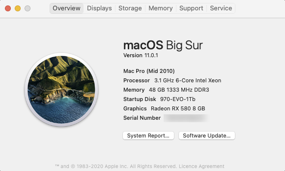

Well I am gob-smacked ; I've owned this MacPro 5,1 for 10 years and today thanks to MartinoLo @h9826790 I am running Big Sur, a PC Asus RX580, with a proper boot screen omg ; and right now exporting HEVC h265 directly out of FCPX 👏🏻 - extremely easy to update it from OC 0.5.4->0.6.3.2 (just swapped the OC and BOOT folders) and installed Big sure natively up from Mojave... cannot believe it! @h9826790 is a legend.

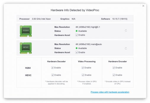

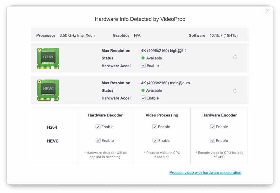

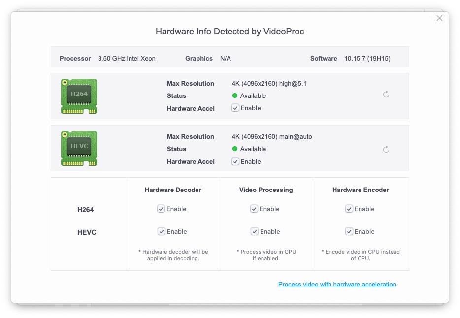

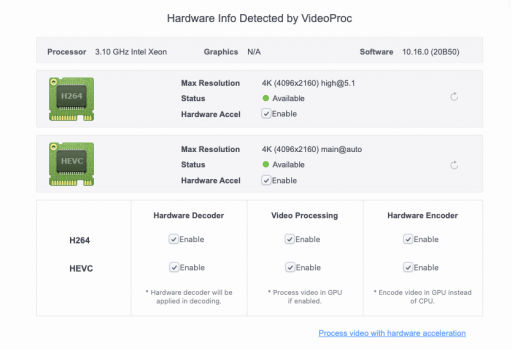

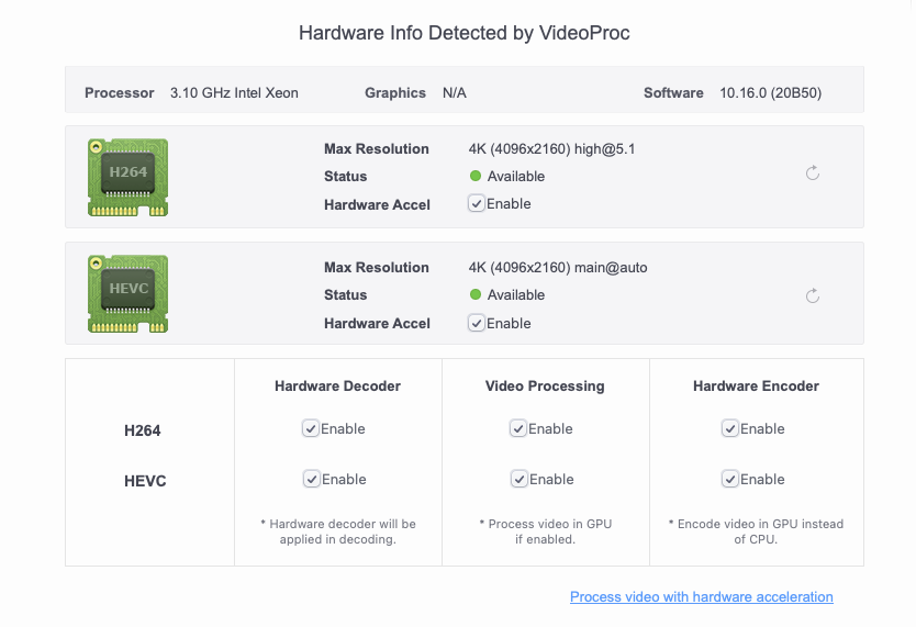

@h9826790, question, in Video Proc app, I noticed when I clicked on "Options/Hardware Acceleration Engine" , the "Graphics Card was NA" {not detected} instead of the graphics card that was installed, in my case an AMD Radeon HD 580X. when I encode a video file, it shows using "Intel" GPU was used for hardware engine instead of AMD?
Post #1 Q14 & Q27

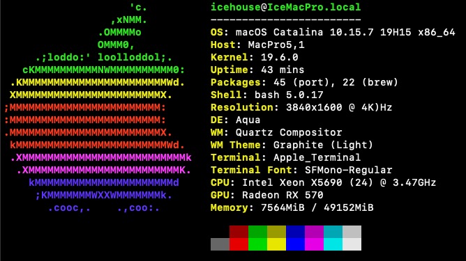

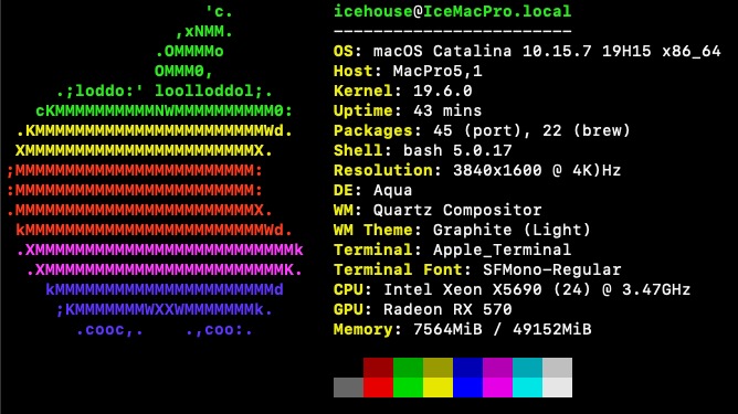

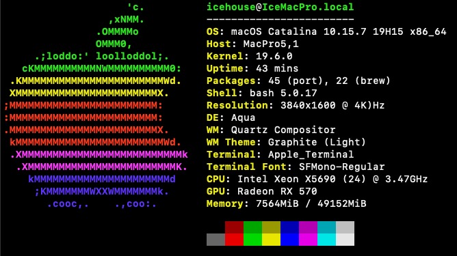

Hi Martin,
as you know, I use your 0.6.3 package of OpenCore. I had update 10.15.7 to (19H15) and all works fine...
Yesterday I run GeekBench 5.3.0 and stumple into a (maybe only cosmetic) problem or maybe I did not understand all. Your package has included RadeonBoost and I had it installed also with 10.15.7 (19H2) the formerly version. So I had chanched nothing at OpenCore - only macos update.
macos 10.15.6 (19H2) (machine details see attached JPG)
Geekbench 5.3.0 Metal: 44052
Geekbench 5.3.0 OpenCL: 40141
macos 10.15.7 (19H15)
Geekbench 5.3.0 Metal: 25068
Geekbench 5.3.0 OpenCL: 25406
Unfortunately I have no idea what happen...
Thank's for reading and stay healthy...

My package only has that included, but disabled. You have to turn that on by yourself.
Reactions: IceHouse
You'll find this in your config:

Below the key 'enabled', change <false/> to <true/>
Martin, what can I say... 😳🤪
Unbelievable, the moment when you recognize that you don't see the wood because of the trees...
I saw the key (Enabled) but don't recognize the value (false). I wish it would be often more easy to fix something like that. 🖖

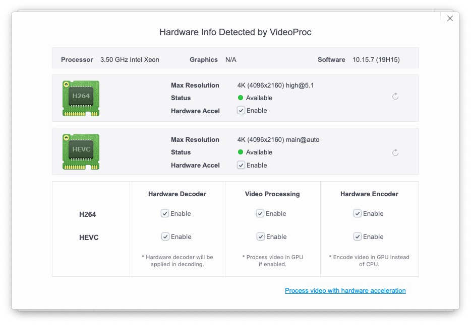

Just installed a Radeon RX 580 to replace my GTX 680- Wow Martin, the 0.6.3 package worked like a CHARM, all acceleration VideoProc confirmed-Thanks from all of us! One thing, can anyone point me to steps where I can change the name of my GPU to “AMD" Radeon RX 580” so VideoProc shows it in Common "engine options”?? I know it is just cosmetic but would love to see it-

Enabling Radeon Boost doesn't improve those benchmarks.
Read post #1, part 2 carefully, then follow the Add the device properties section to add the required code
but after you find out your PCIe path, use the following code to only inject the GPU's name
