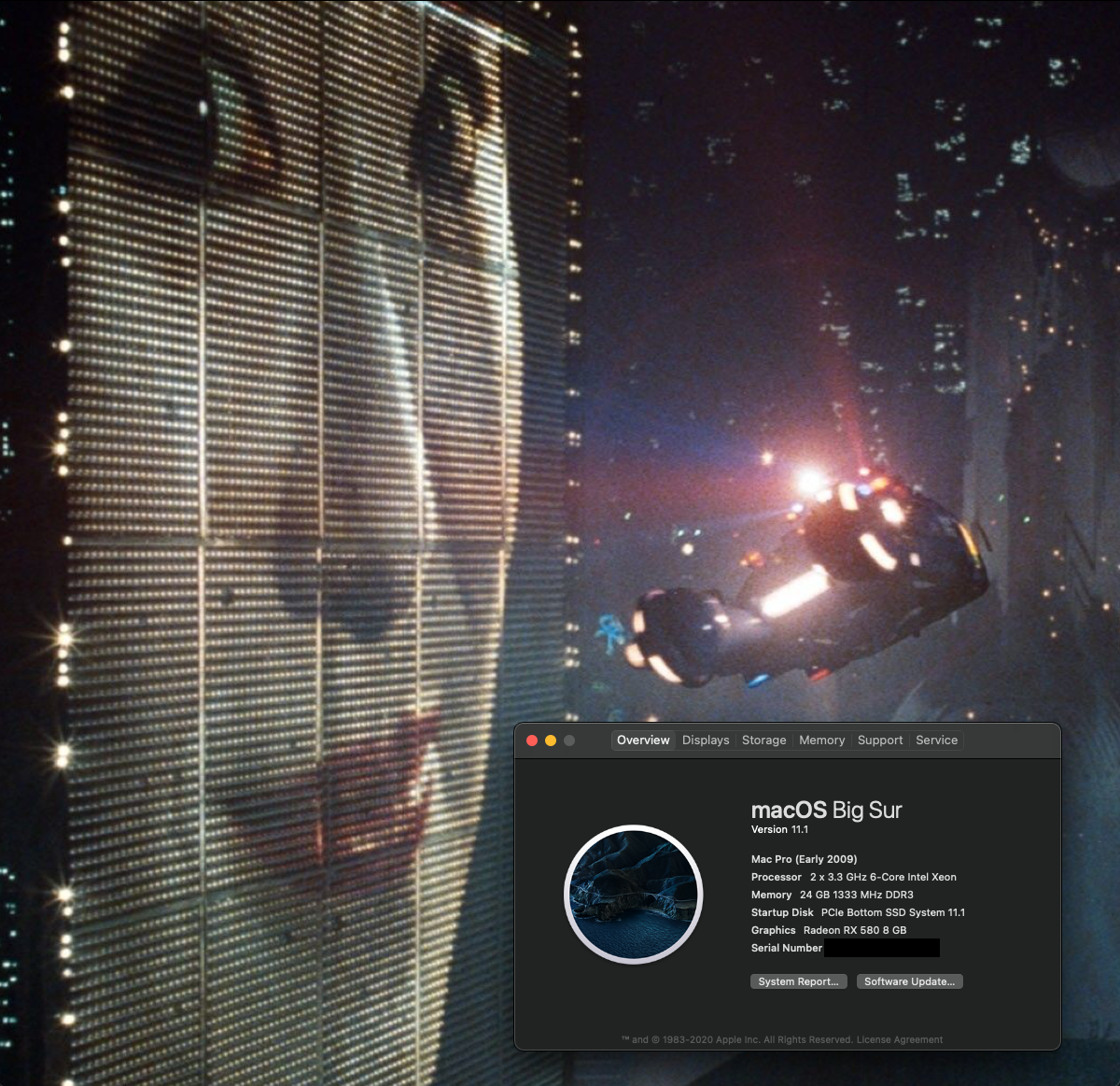

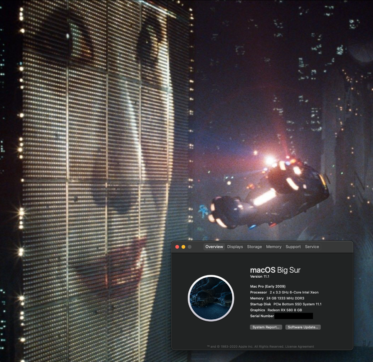

Followed the above instructions and was able to fix the issue as you expected. Thanks very much h9826790!
Big Sur is running fine so far (screenshot attached), but I need to test more applications etc. For what it's worth, ran Geekbench 5 with Big Sur and, compared to Mojave, got very similar results for CPU and a better result (+10%) for Metal.
The only issues I encountered so far (all previously reported in this thread):
1- The boot screen works well, but only shows names for recovery partitions and not for the actual OS partitions. I have several backups/clones (1 High Sierra, 2 Mojaves, 1 Big Sur) so it can be a bit confusing when switching boot drives without the text reference. Will review mor carefully previous posts with instructions on how to inject the names, although it sounded a bit intimidating to me!
2- I can confirm that the RX580 own fans are running at faster speed than with Mojave. Not sure if others have found a solution for this at this time. Or maybe it's just the nature of the upgrade, this being a more GPU-intensive OS?
3- I still have the original cMP 4,1 Wifi-Bluetooth internal card. I did not have to edit the plist to activate it (as shown on the video) - it was active and functional from the first launch of Big Sur. On the other hand, a Hideez 4.0 Bluetooth external dongle that I used with Mojave does not work at this time in Big Sur. The manufacturer states that there are issues with Big Sur. I might finally look into replacing the old card once and for all!

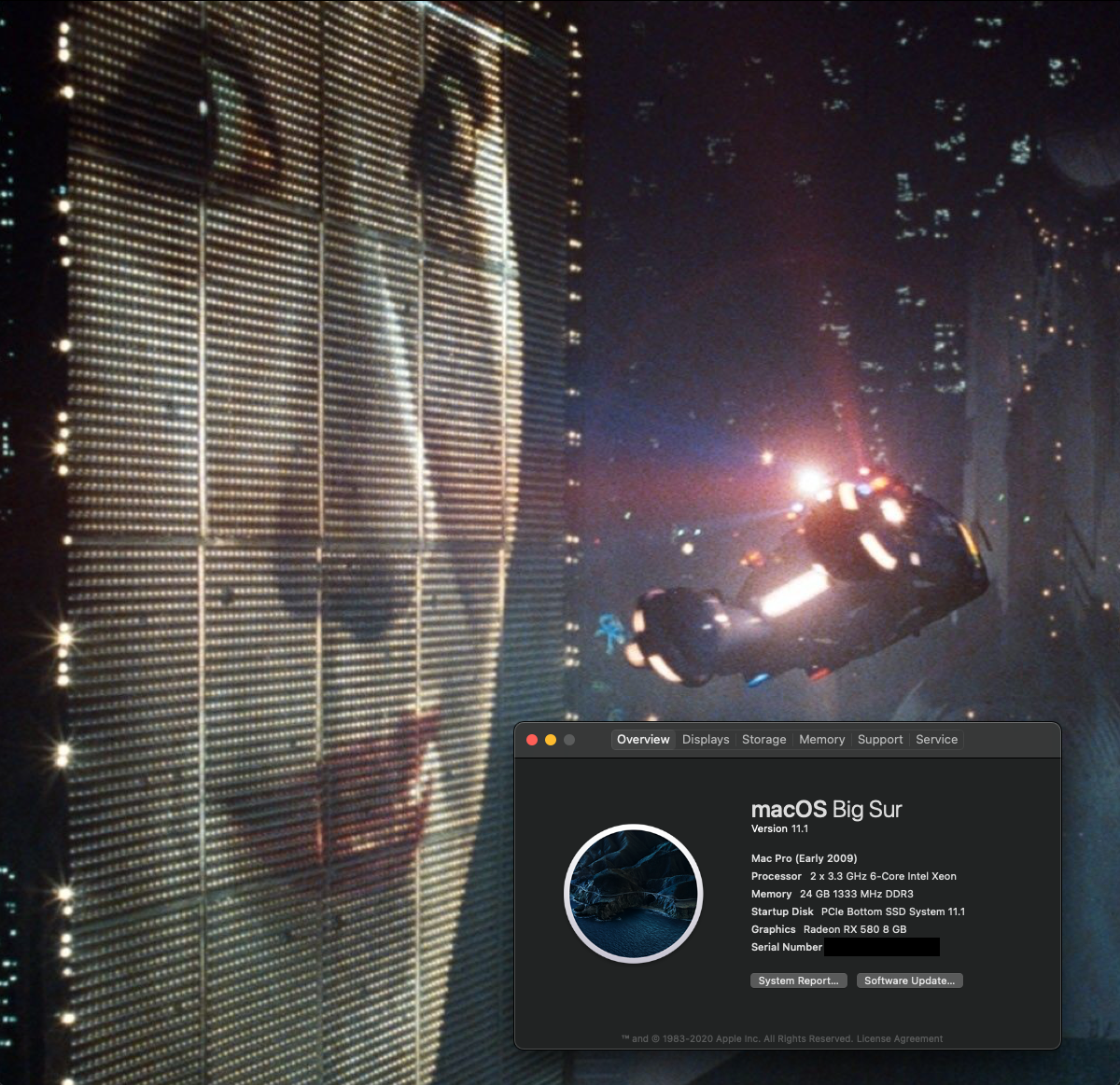

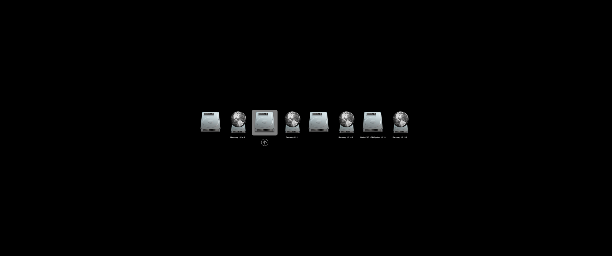

1) You can press F10 (you may need to press Fn + F10, depends on your keyboard) to capture the boot picker. Then the screen capture will be stored in the EFI partition.
Please post the picture here, so that easier to understand your problem.
2) My RX580 is in the box now (may be I should sell it now, the price seems quite high 😎), and I never use it in Big Sur. However, from memory, you are not the only one to report this issue. May be driver related.

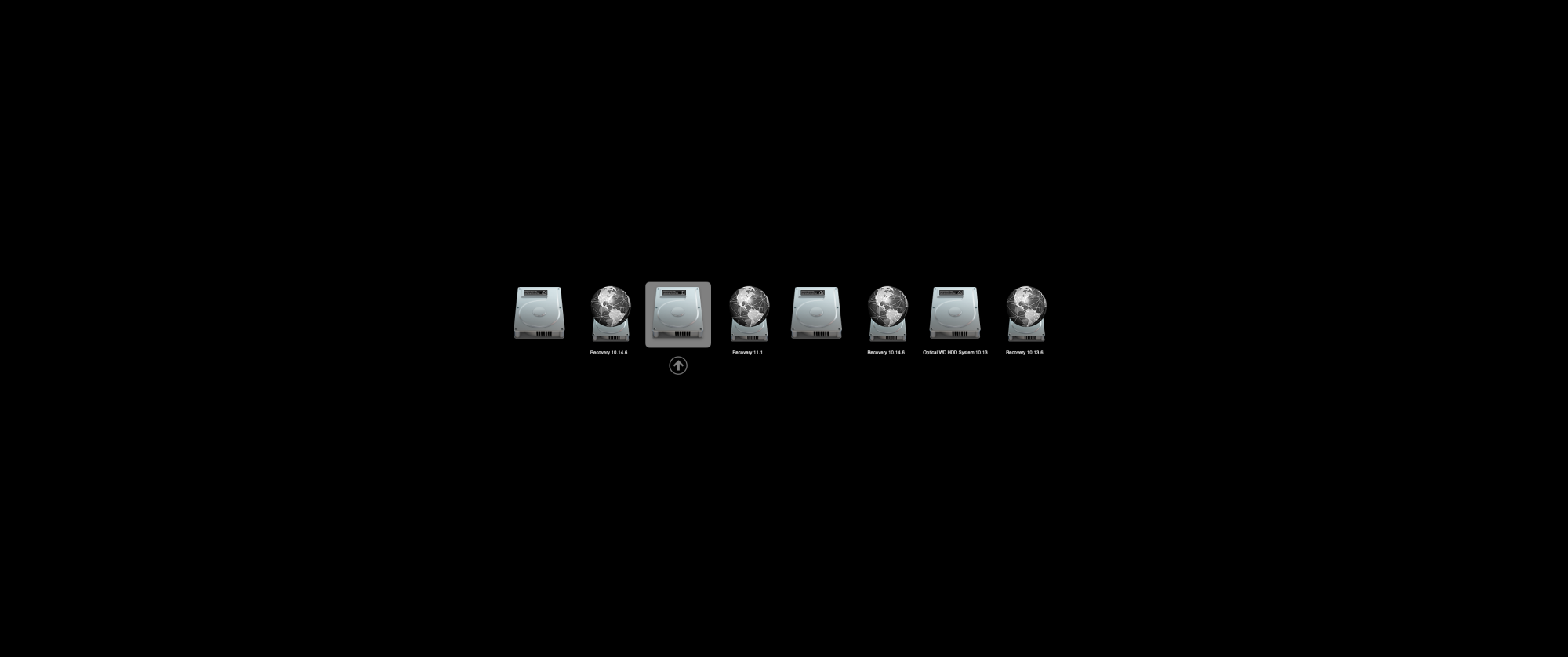

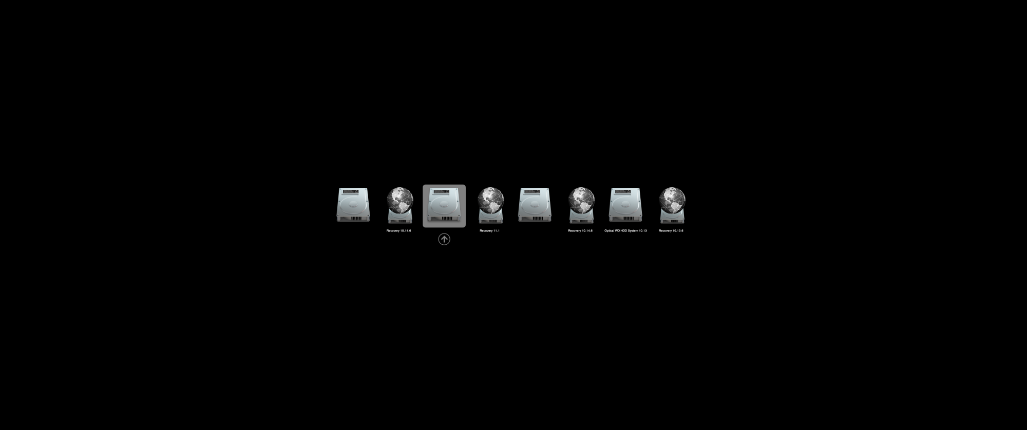

Screen capture of Boot Picker attached here.

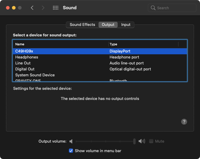

I also just found out that audio over Displayport is not working. I have two monitors connected via Displayports. Should I to try the multiscreen suggestion from your video in post #1314 to see if it fixes the audio issue?

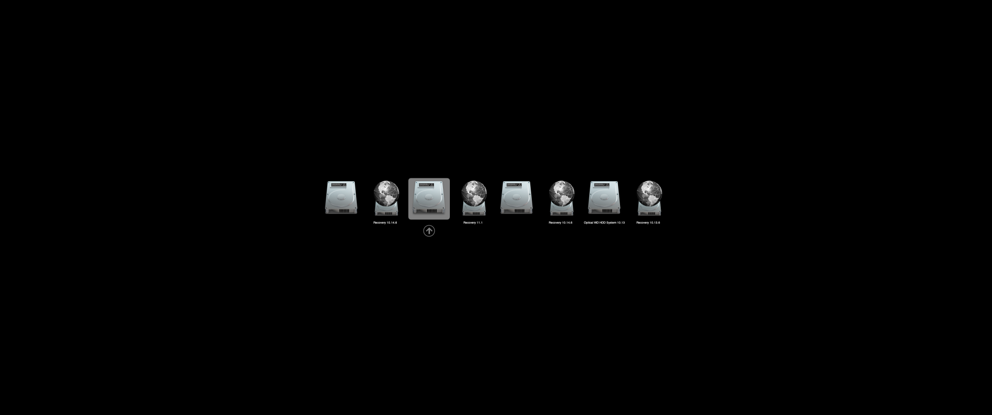

Please try the following steps and see if it helps to fix the boot drive's ident.
1) Keep your Mojave drive in the cMP
2) Follow the steps in this video to properly uninstall OpenCore
3) Reboot to Mojave natively without OC (make sure SIP is still disabled, if not, please do that)
4) Follow the steps in post #1314 again to install the latest 0.6.5 DRM fix version
Let's see if the boot picker will able to show the correct disk name.

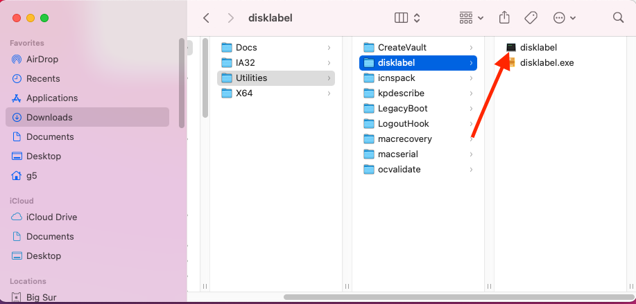

If not, then we may need to use the disklabel tool. That may be considered more complicated for most users.
You mean the DisplayPort audio option isn't avail at here?
Can you see if the driver is loaded for your graphic card?

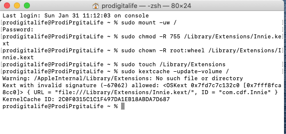

I have tried several times to install Innie 1.3.0 following the guide but without success!
I have tried with both Catalina and Mojave but nothing!
Any suggestions on how I can fix this problem?
Thanks in advance!
Thanks in advance!
Sorry, I can't assist further. I installed Innie using MyBootManager via RefindPlus. I suggest you ping the author of the post I linked to, or drop a line via GitHub.

Any ideas why I can't switch between drives and partitions too boot from in the boot picker all of a sudden?
Forget it – my keyboard wasn't connected on the other end. 😆

As far as your answer to my question about the Displayport audio issue I had - sometimes after startup (cold boot I think it is referred as?) that option is not present at all under sound-system preferences. But when I do an immediate restart (warm boot?) the Displayport option shows correctly and works properly. Not quite sure why, but the restart seems to make it available.
