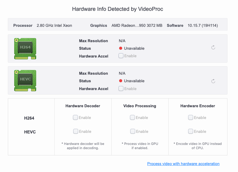

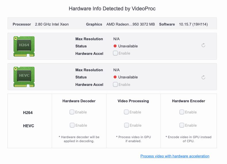

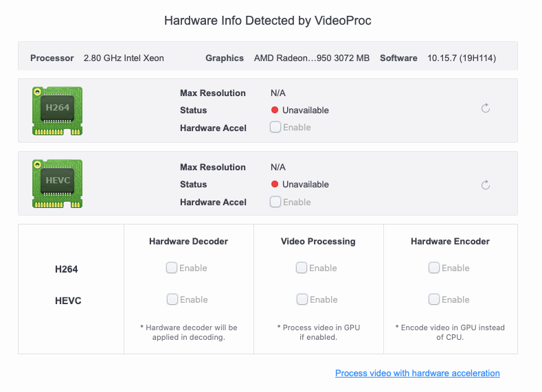

I've searched this thread and saw a few mentions about the 7950; just wanted to confirm that VideoProc cannot use this card for HW acceleration? I have a Dosdude v1.4.4 patched version of Catalina running on my 3,1 with a flashed 7950 and this is what VideoProc tells me:
This is repeatedly answered, it's even on the first post FAQ (Q9).
The first AMD card that have VideoToolbox API supported AVC/UVD are Polaris and Baffin (RX 480/RX 580 - RX 460/560).
Older cards are not supported even if the card have an older AVC/UVD version, like the R9-380 that have an almost identical AVC/UVD of Polaris/Baffin but it's not supported by the VideoToolbox API. The cards need to be GCN4.0 to be supported.
Well, it has been a year and the VideoProc website says it has support for AMD 7XXX cards... hence the question in 2021.
macOS is not Windows. It's not Videoproc that interacts with the hardware at all.
It's the Video Toolbox API that talks to UVD/VCE/VCN hardware units, Videoproc talks to the API and not directly to the hardware itself. If the Video Toolbox API supports a GPU family, Videoproc then supports it.
Videoproc is a very dumb way to check if Video Toolbox API is working, it's just parses the name of the card.
