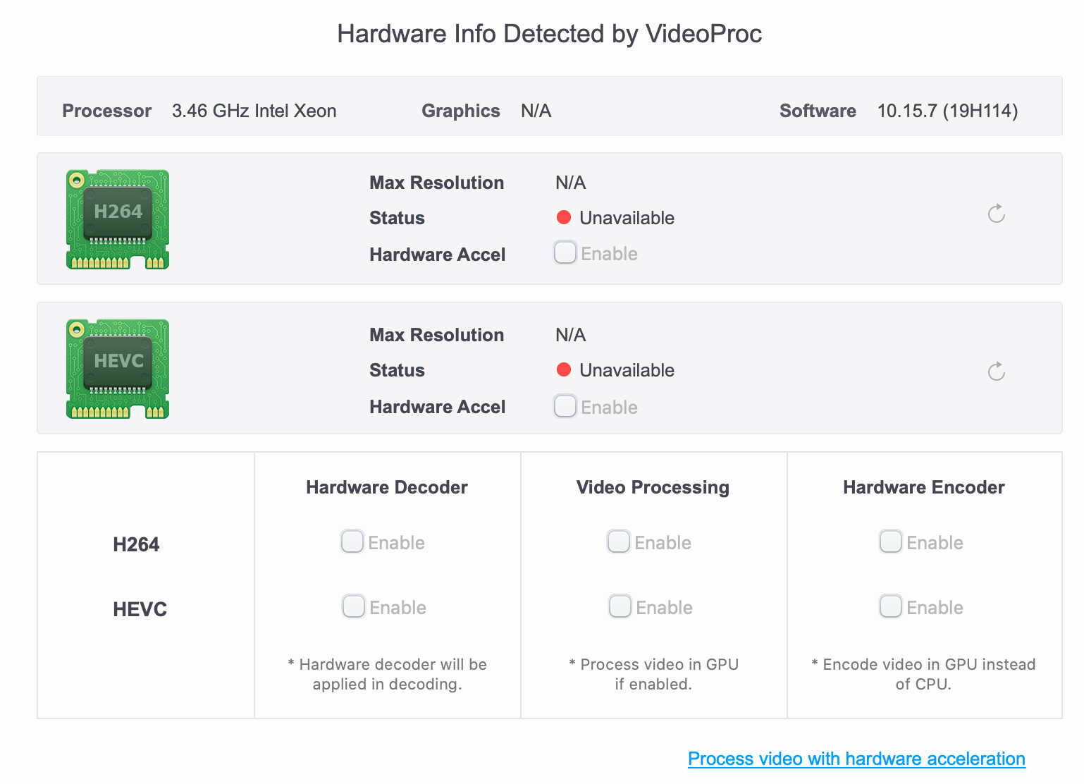

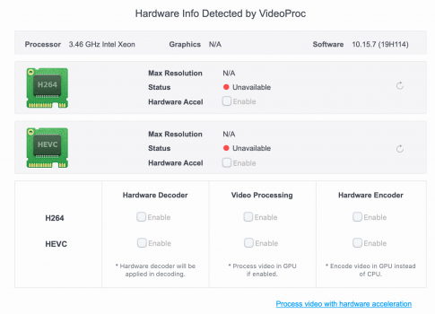

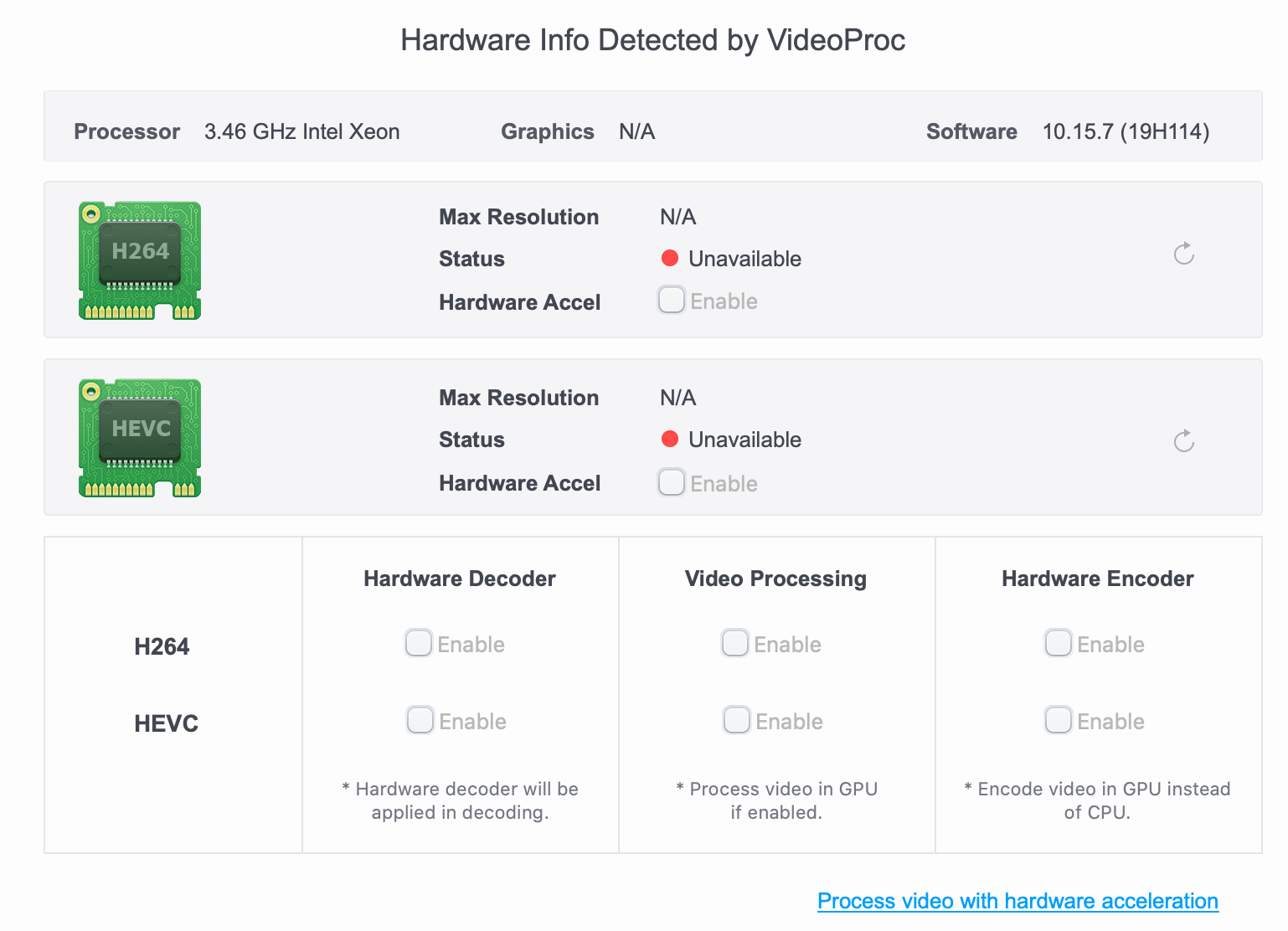

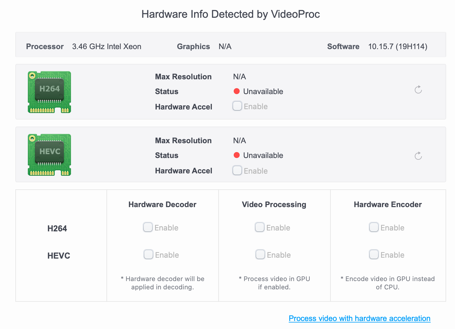

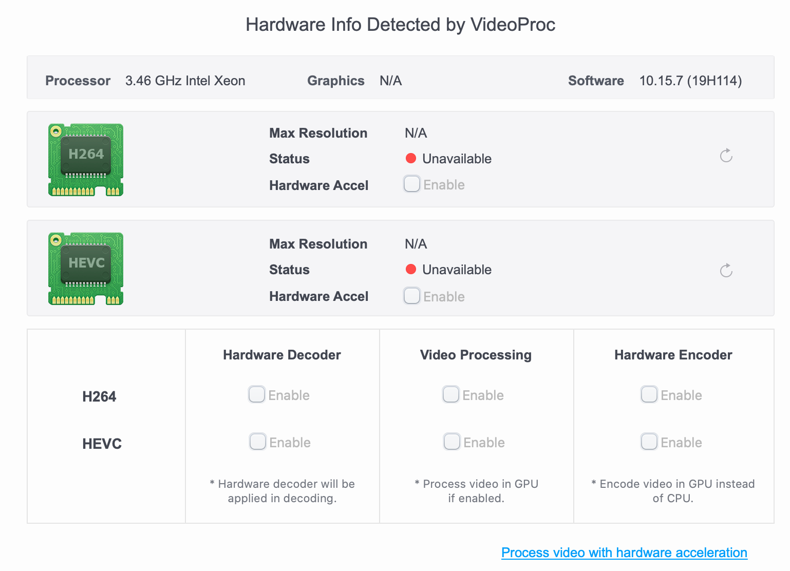

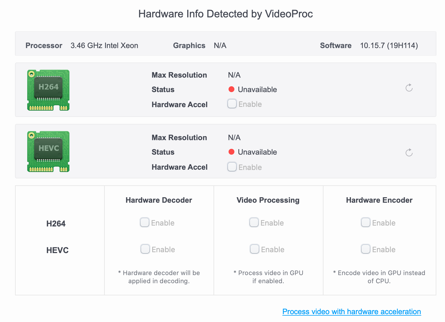

@h9826790 , "HWAccel Video" not indicated by VideoProc.
Noob here... OC 0.6.4, MacPro 5,1, Dual 3.46, MacOS 10.15.7, Highpoint SSD7101A-1 NVMe RAID, Booting 1 Slot Samsung 970 1TB, and GPU a Vega 64 (MacVid Flash). The VideoProc Check box to select GPU enabled does retain a checkmark, but hitting the refresh icons, neither H264 or HEVC is enabled.
System does Boot up, goes to Grey blank screen for few seconds, then Black OC Screen.
Read the posts, I didn't see one that would help me with this one.

This is exactly why HWAccel doesn't work. You have to turn on VMM and turn off SMBIOS spoofing to install Catalina (that's the additional option no.3 in post #1314).
And after Catalina installation, you should turn on SMBIOS spoofing again to re-gain HWAccel ability.
If in doubt, download and re-install my OC package from post #1314 should always able to re-gain HWAccel ability.
Confused, mentioned post #594 for HWAccel within #1314... Swapping the #594 config.plist does activate the HWAccel options correctly, returning to #1314 config.plist returns to disabled & not available.
I'll reinstall OC Package as suggested.
Thanks!
Then it should be with the factory ROM already.
So, for the same OS (e.g. 10.14.6), if you boot via OpenCore, it has fan issues. But if you boot natively, then no fan issue?
Did you activate RadeonBoost?
Ah ok thank God for that! That's correct as you describe. I have not activated Radeon boost. Should I?
Thanks!
You can't just change config, should re-install the whole package.
Each OC version has it's own config, can't be cross used with other version's OC.
Anyway, if you figure out your own way to make it work on your cMP, then you can use your own combination. There is no way for me to tell what you've done on your cMP. So, my suggestions not always the best solution.
You may try Radeon Boost, and see if that helps.
