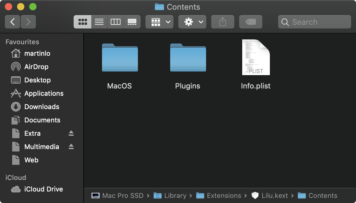

4) open Lilu.kext (right click -> show package contents)
5) enter Contents
6) create folder "Plugins" (N.B. This folder is INSIDE Contents, please do NOT miss step 5)
7) Copy the WhateverGreen.kext into Plugins
8) Copy the whole modded Lilu kext to /Library⁩/Extensions/

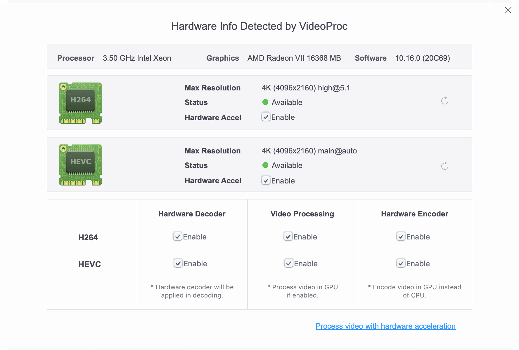

Q19: Why VideoProc shows no HEVC decode after the mod?
A: I don't know why, but this is normal in this case. My recommendation is to download demo HEVC video from the above link, and play it via QuickTime (or simply via Finder preview). As long as the CPU usage only stay around 20% (but not 800%), that means HEVC decoding is working properly.
For those who use OpenCore method, you should able to see HEVC HWAccel avail. If not there, please click the little reload icon.

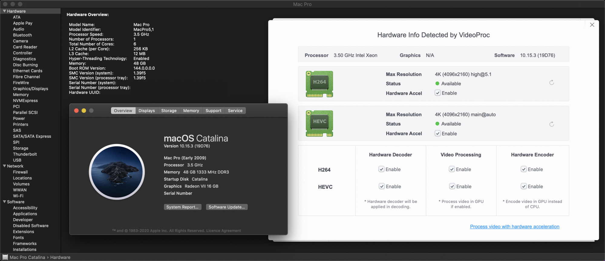

Q22: How do I know if hardware acceleration is really working?
A: My suggestion is by using Terminal. Detail info in post #273. You may also use OpenGL Driver Monitor to observe the UVD / VCE activities (link).

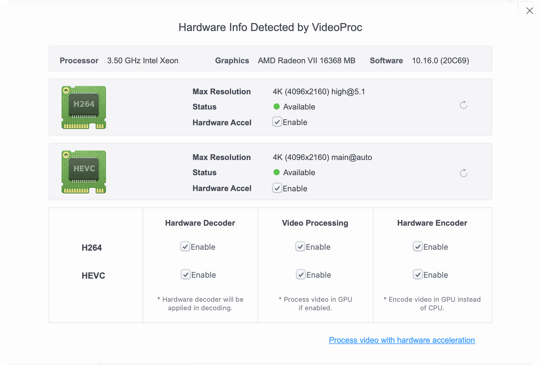

Q27: Why the "Graphics" in VideoProc HWAccel page shows N/A?

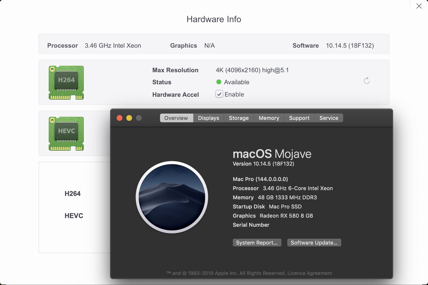

A: No idea, but it's just a cosmetic error in this case. (Update: It seems VideoProc looking for the key word "AMD". e.g. If the card ident as AMD Radeon VII, VideoProc can show it properly. But if the card ident as Radeon VII, then VideoProc can't show its name)
P.S. For those who want to add the prefix AMD in front of they graphic card's name, please join the OpenCore thread. We can rename the graphic card to whatever we want in OpenCore.
Q28: Why VideoProc shows that I am use "Intel "HWAccel when converting videos?
A: Also no idea, but again, it's just a cosmetic error in this case.

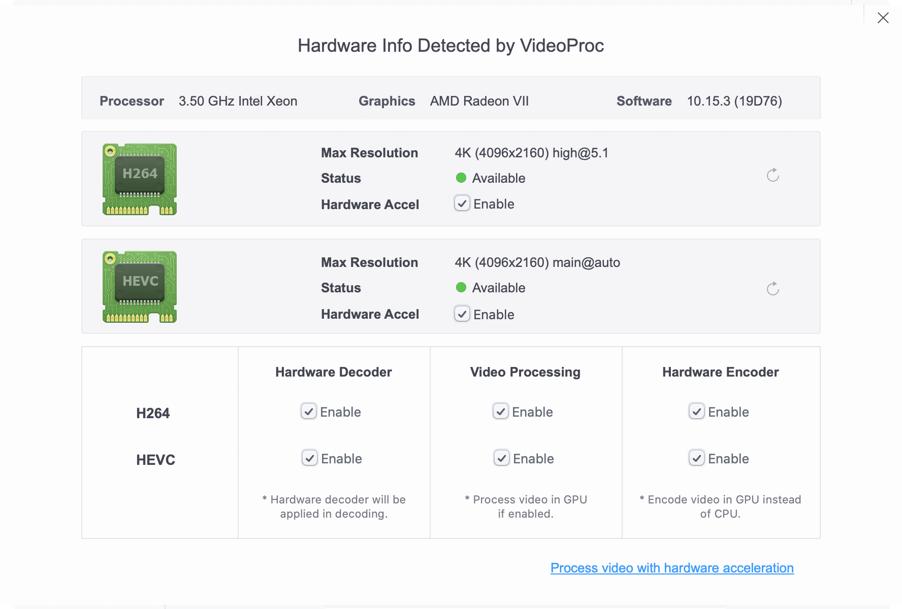

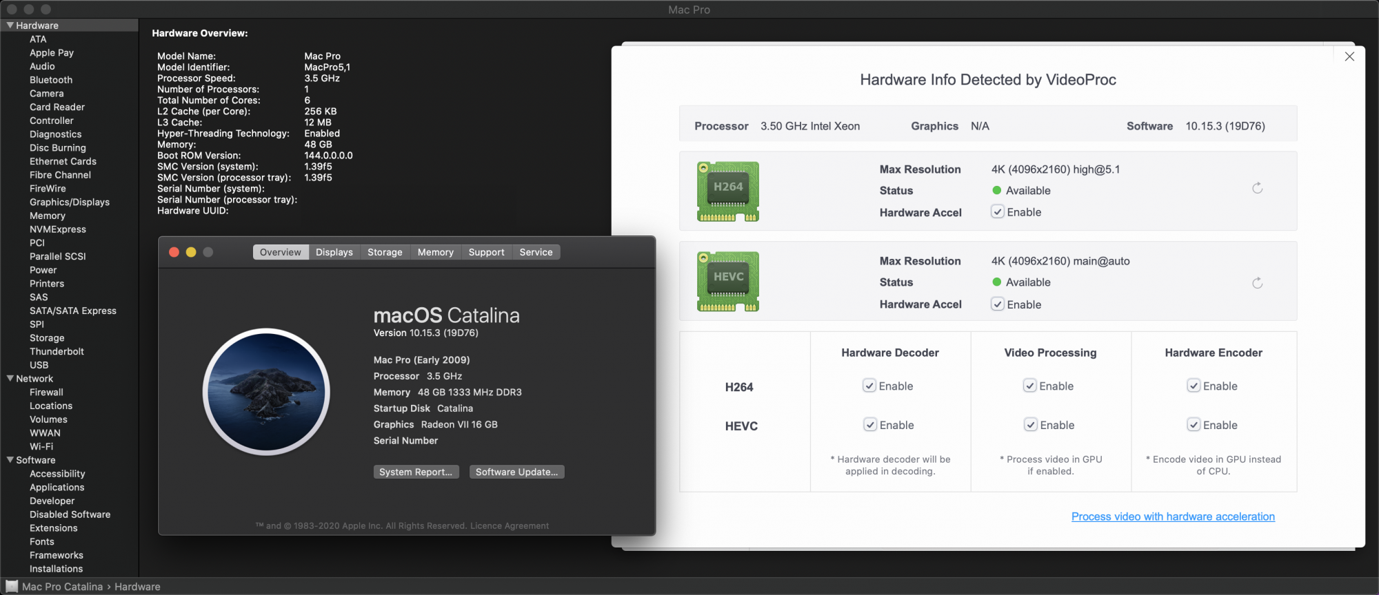

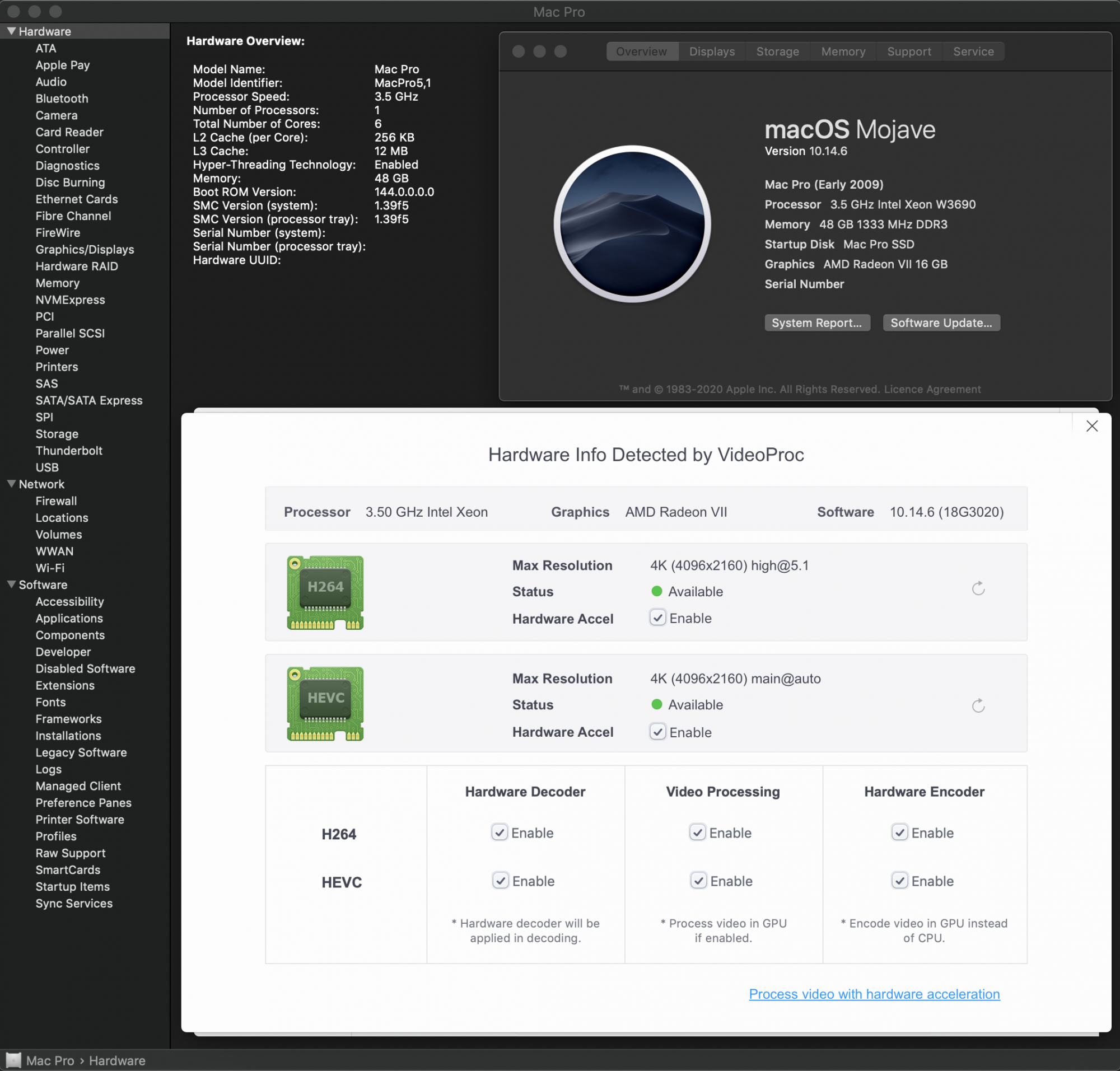

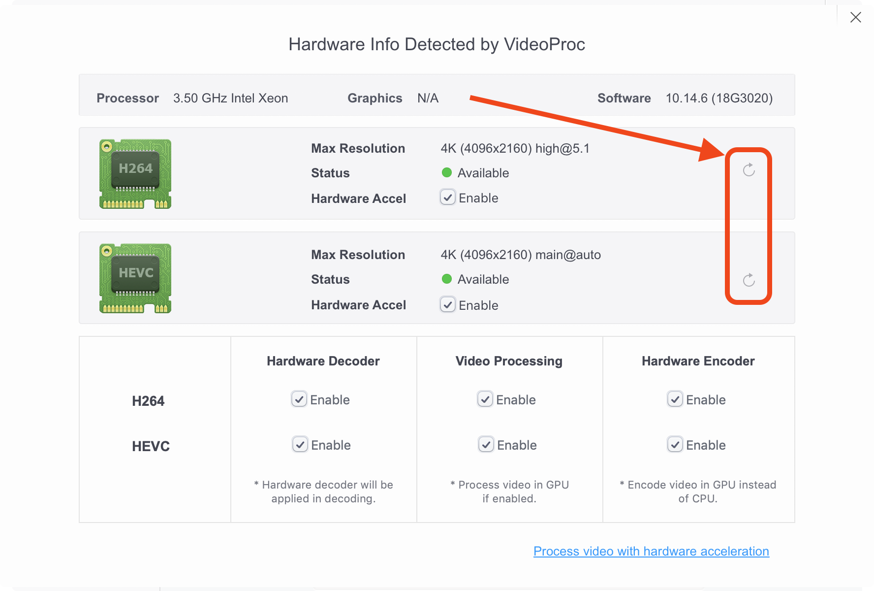

Q29: Why VideoProc shows nothing activated but everything seems working as expected?
A: As long as you can see this tick, which mean HWAccel is activated. From my observation, this tick always change automatically.
For the Hardware Info Detected page, please click the little reload icon in order to let VideoProc to show you the latest status.

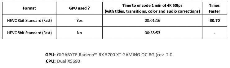

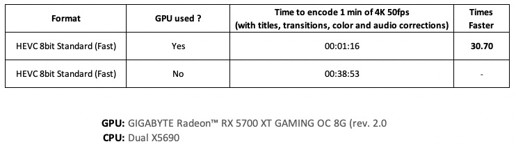

May I know the HEVC export performance different in your case? (5700XT vs dual X5690)
Yes, here it is:
I've checked if setting other HEVC profiles (8bit High. 10bit) with frame re-ordering off would give GPU acceleration but unfortunately it didn't 😕
FYI, CPU is not used at 100% during encoding (even when GPU is not used).
Hope this is what you were looking for. Thanks for your opencore package for CMP 5.1 and your help ! Next thing for me is to try it on a late mac mini 2012 as I see you have added the wifi driver ...
Cheers.

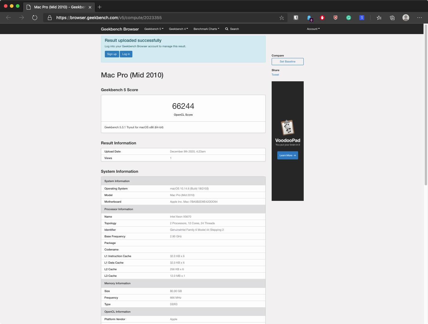

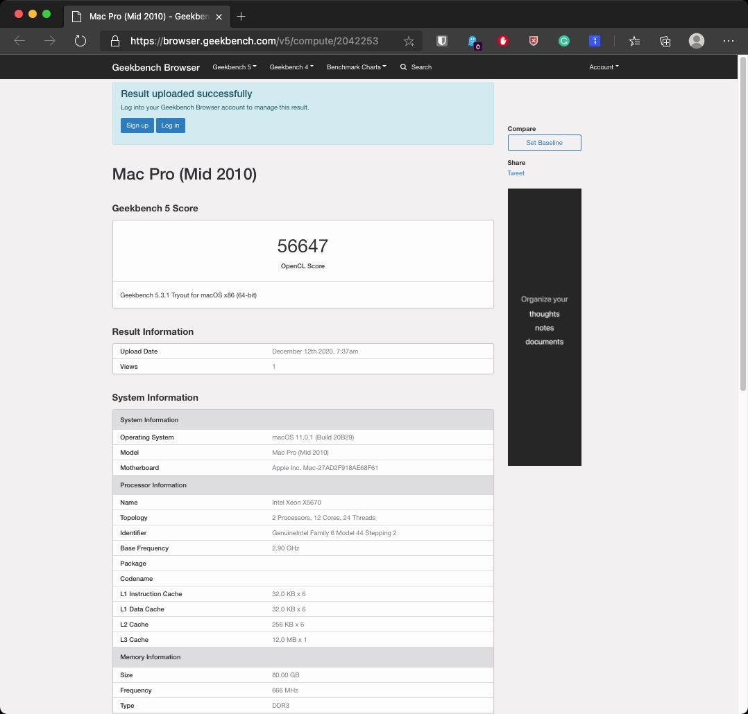

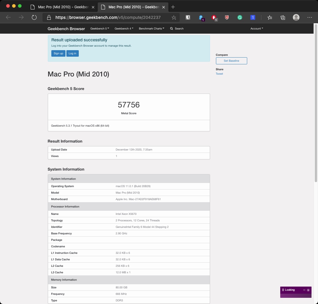

I updated to 0.6.4 for Big Sur but used my slightly modified config.
I did not add the airport or wifi elements as they stopped that from working from working.
The key thing I have noticed is a slight drop in geekbench 4 and 5 score from Mojave. 10.14.6

Yes, here it is:
Cheers.
Yeah, this is what I am looking for.
Because I only with a W3690, so, can't quite use my own figure as reference. But your number will be good. Therefore, the others can have some idea how much of the possible gain is.
At the moment I tested using a Vega 56.
Not sure what I have done wrong so have added my config just in case there is something I have missed.
GB scores never that consistent. If you keep running it for 100x, then I believe you will eventually hit the same score again.
For me, that's actually "at the same range" if comparing GB scores.
