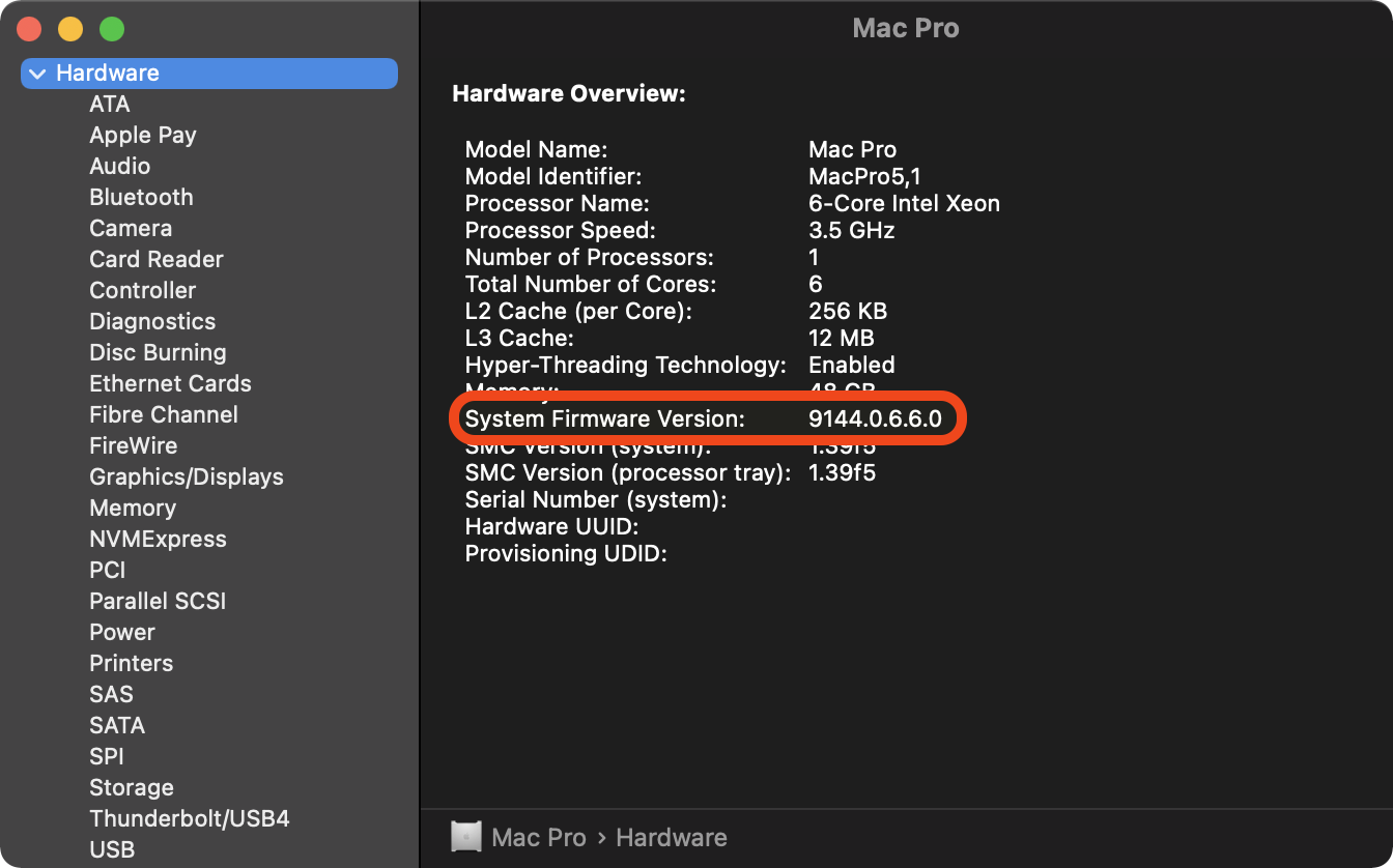

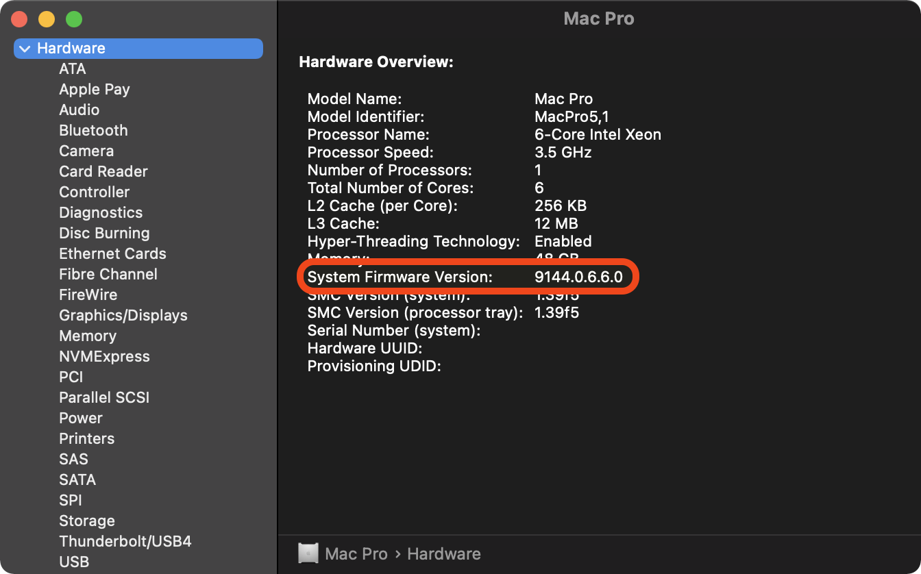

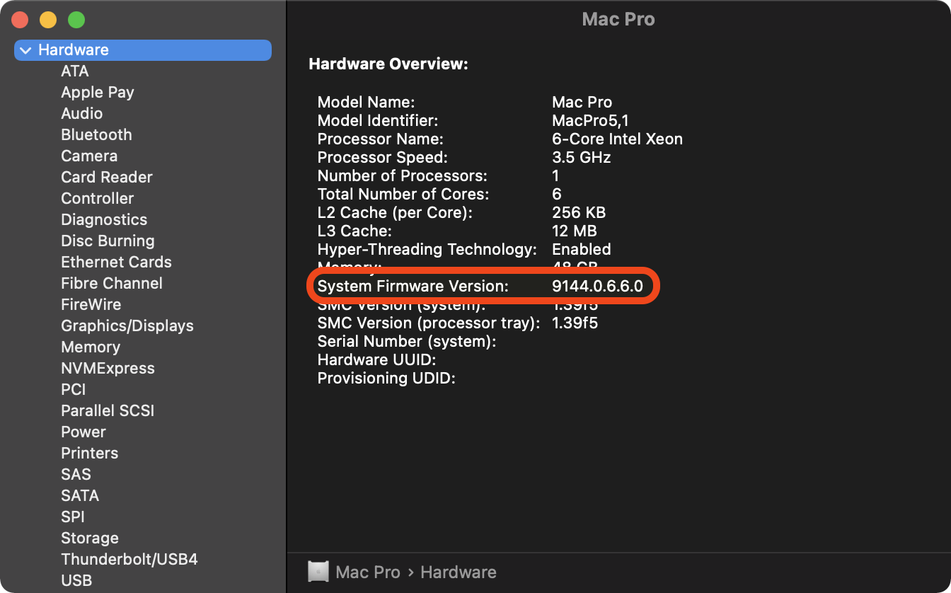

Hi, @h9826790 I'm on Catalina and RVII. Today I replaced 0.6.4 (I followed the OC thread instructions and Hardware acceleration instruction from here with sudo and shikigva=96) with your package 0.6.6 but the drm is still not working. I wonder if I should do something more like 3xNVRAM reset or something? What I'm missing here? Also the pcie drives are still shown as external.
Hi, @h9826790 I'm on Catalina and RVII. Today I replaced 0.6.4 (I followed the OC thread instructions and Hardware acceleration instruction from here with soda and shikigva=96) with your package 0.6.6 but the drm is still not working. I wonder if I should do something more like 3xNVRAM reset or something? What I'm missing here? Also the pcie drives are still shown as external.
What's your firmware version now?
Please re-download the package from post #1314
And follow the "how to update" video in that post to update your OpenCore.
You aren't running my 0.6.6 package at this moment.
If that doesn't work, then I suggest you follow the 6 steps in that post to re-install OpenCore.

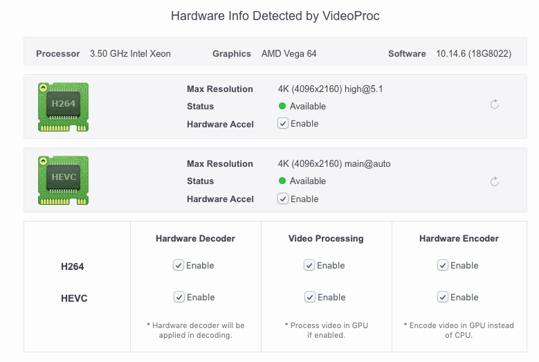

Seems I've lost HW video encoding even though VideoProc says H264 and HEVC HW support is detected and enabled. I've gone from 180-220 FPS to 50-55 FPS when converting a 1080p MKV to a 720p HEVC MP4. That number remains the same whether or not HW acceleration is enabled in VideoProc.
Only thing that's changed since the last time I converted something was installing the supplemental update to SU2021-002.
OpenCore is running:
Also confirmed via iStat that GPU isn't getting loaded at all. At least when HW encoding was working at ~200fps, I'd see a load of roughly 3% on the Vega 64.
Any suggestions on what to do / look for?
EDIT: I just remembered. Also updated VideoProc to v4.1 and OC to v0.6.6 about a week ago (which in turn updated LiLu and Weg).
EDIT #2: Sony Swordsmith video plays back with HEVC decoding active. I can see GPU getting loaded to about 3% and GPU fan kicks on. I'm wondering now if VideoProc 4.1 has a problem.
EDIT #3: Disregard. Ended up being the source material for some strange reason. Tried another MKV file that I created two weeks back and VideoProc 4.1 crunched that at roughly~225 FPS or so.
