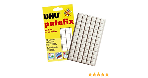

Has anyone tried cleaning the vents with adhesive putty?? I am wondering if using this to clean the vent grill would be affective. I am going to try using this every couple dahs and see if it keeps the issue from occurring. Would also show if it is a valve issue or a clogged vent.
Uhu Patafix helped cleaning since AP (1) and also with the APpro – revitalizing the inward-NC and that is approved with passtest…
I would not do this. I almost got some blue tack stuck in them. Since then I’ve stuck to a little alcohol and q-tip to clean them
With Patafix there ist no blue tack – its proved.
I would not use alcohol because the coating will get damaged.
