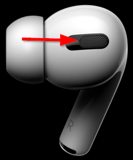

Where exactly are people applying the "suck" remedy (ear-side, or outside on one of the 3 black panels?) and what exactly is it supposed to fix that causes the seal to fail? I can't pass the tests anymore either.
Suck on this!
(LOL look at the language we've resorted to fix this on our own...)

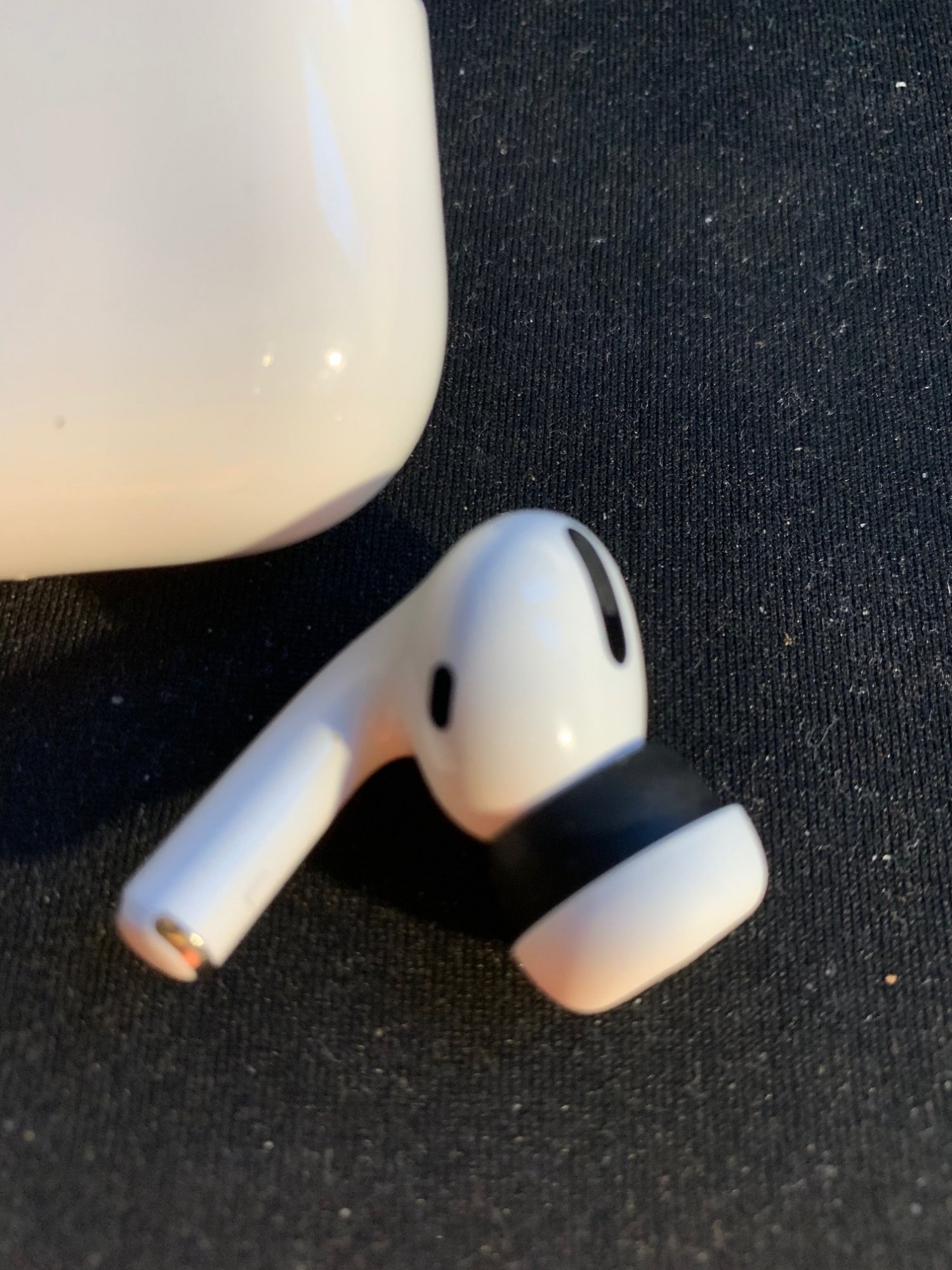

Thankful I found this forum and joined as I could not get the test passed. My ear canal opening is simply too big for the largest size tips. No bigger size available so improvised by adding another set beneath the apple ones before attaching. Perfect fit and sound quality and noise cancelling is massively improved. Test results show same but, Eh, who cares. The difference is significantly improved sounds and ANC.
